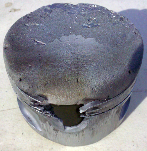

    Heat is a huge problem with going five miles with the tubocharged flathead. After going 280 normally aspirated, setting two records in 2009 without pulling the heads - running the turbo with water injection on alcohol with water injection, the #7 piston burned; the block cracked from water jacket to exhaust ports on many cylinders.
    BTW: Jimmy Stevens is currently working feverishy to get the block fixed so the Costella - Yacoucci - Pappas - Stevens 788 entry can compete at El Mirage. They will be switching to unblown gas to finish out the season at Elmo, then bring the alcohol fueled turbo back to Bonneville for the World Finals.
    Check out a couple pictures of the turbo flathead, the burned piston. My visit with Jimmy repairing his block and more.
    C. Stevens

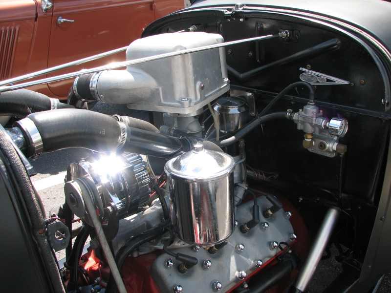

    Here's a local car with a V60 and turbo. Runs nice.

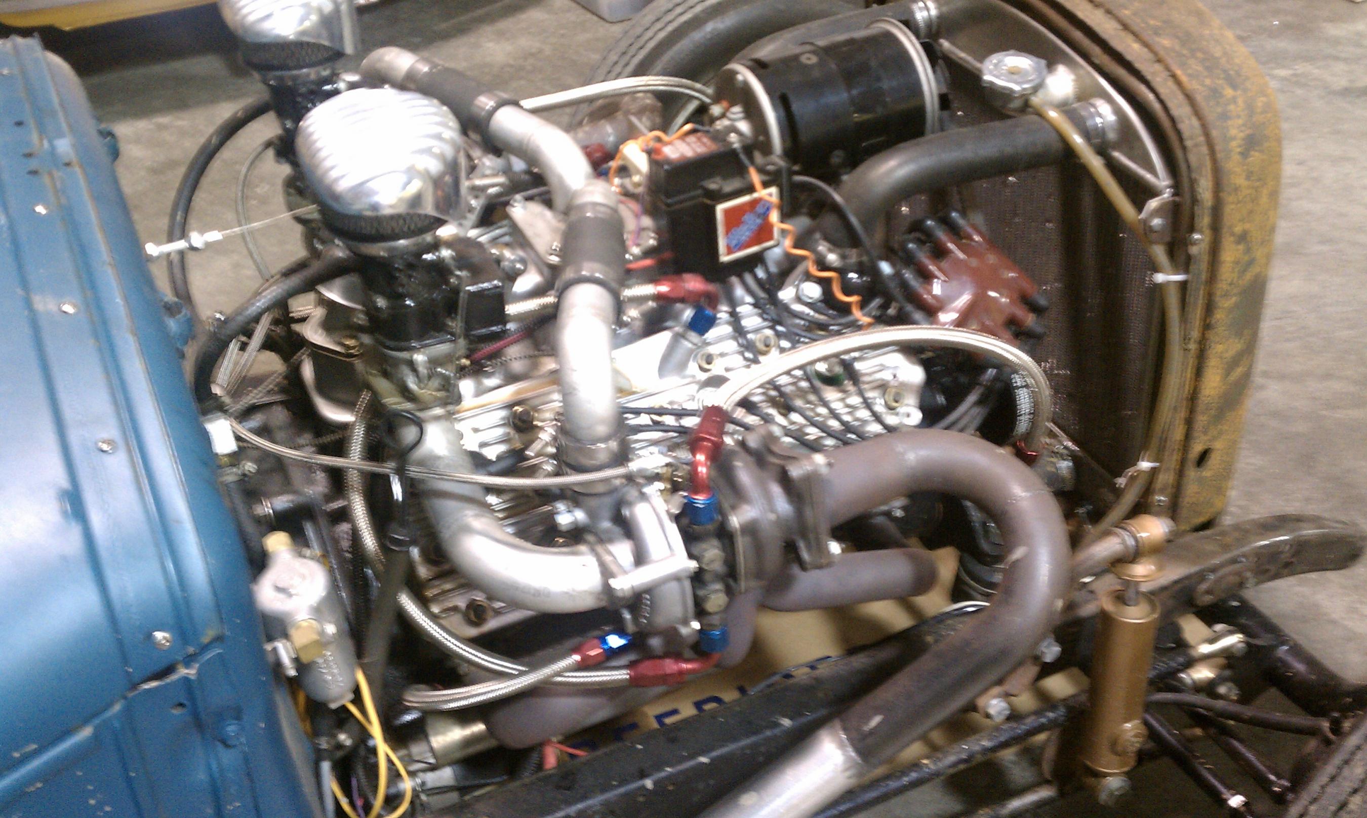

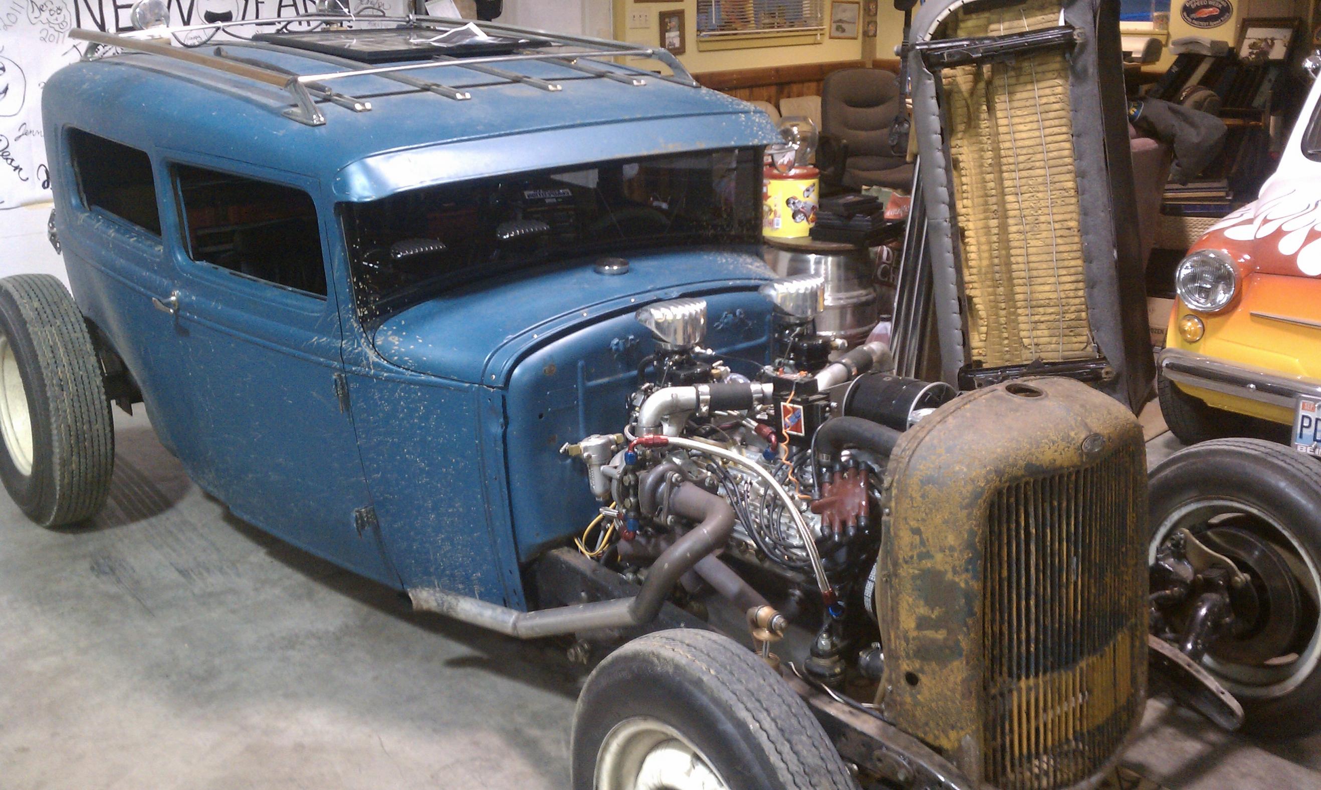

    Here are a few updated pics of my car. These are water cooled turbos. I have not had any problems with overheating in fact it is the exact opposite but it is winter time here. That might change this summer but so far I have been running it without the fan.
