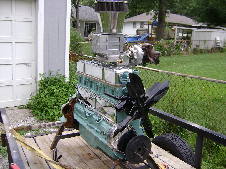

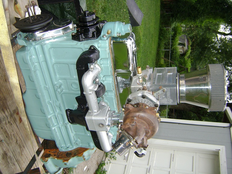

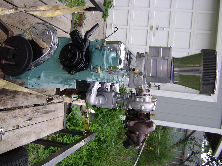

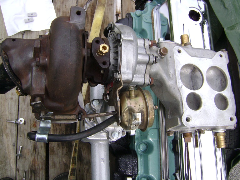

  19. rollinrust
    Joined: Oct 12, 2008
    Posts: 41
    rollinrust
    Well I got the 261 back from the machine shop. I also got the turbo intake fabbed up and thought I would show you how it looked. For those of you following this and want to maybe do this to your 235/261 I may be selling this set up. I am about broke and still need to buy a hei distributor. clutch set up and a few other parts. I am dying to get this on the road! This would fit under the 49 chevy hood if I took of that ridiculous Predator Carb and put on a regular one.

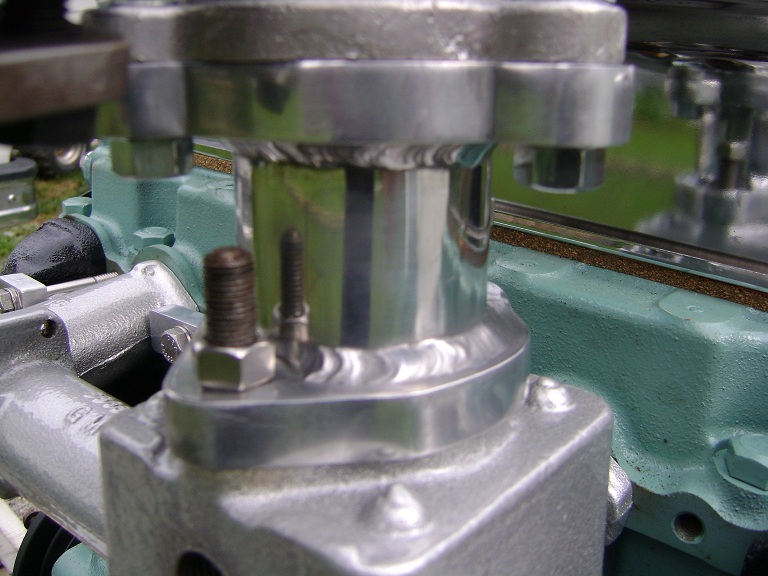

  20. rollinrust
    Posts: 41
    rollinrust
    picture of the adapter
  21. 29nash
    Joined: Nov 6, 2008
    Posts: 4,542
    29nash
    from colorado
    I agree, an EGT gauge is a definate ***ett.
    That comment attributed to a Clifford Performance tech sounds like the guy is delving into a subject he has absolute no understanding of the concept at all. I have done a lot of troubleshooting/maintenance on turbocharged aircraft installations, including what would be considered 'add-on" installations with Rajay turbos on Continental and Lycoming engines. A motor known for it's lugging performance, downright bullet-proof workhorse motor, like the 235, would be a prime candidate to turbocharge.
