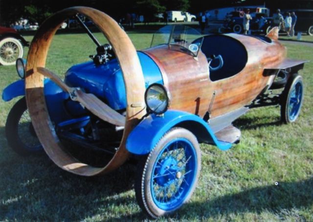

  9. You mean like this......................:D
  10. The radial bike with a few tweaks would be pretty slick, it looks like a whole bunch of knuckleheads welded together. ;)
