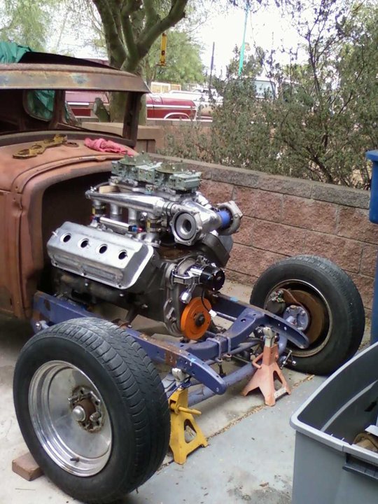

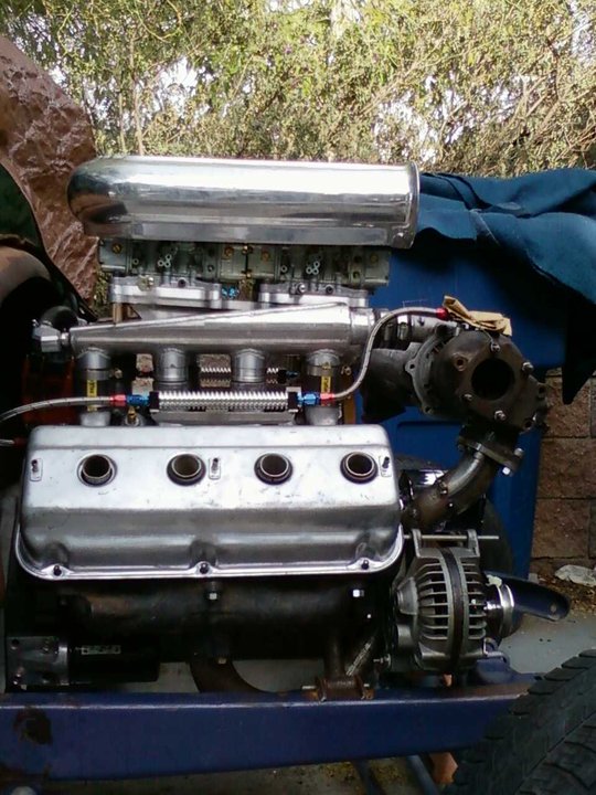

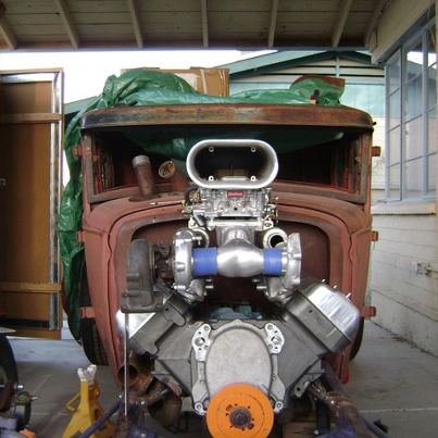

    This is it. Still being built. I aim to light a fire under his *** to get this thing going. I made some molds and had the intakes as well as the turbo connector cast using the lost wax method. The plenum is welded. I believe the carbs are 450 cfm. The rods are Pontiac chromoly H-beam with 7'16" bolts and the pistons are 8.6-1 Ross. The turbos are from the single turbo Nissan 300ZX from back in the 80s. They have the proper seals for which the draw-thru systems can be used. The heads are ported and have 2.02" Chevy intakes and 1.77" Pontiac exhausts cut down to 1.73". The exhaust seats are Pontiac.
  6. Glad you posted pics of the 31, Bill. I was wondering how you did draw-though with "a carb" and twins...

    I don't know the designation of the turbos. All I know is that they are much larger than the ones on the twin turbo cars. They're from the 300ZXs from the mid 80s and had just 1 turbo. The engines were the 3.0 and were about 187 ci. They made 222 HP at 7 lbs boost and had a compression of 7.5-1. The setup on John's engine used to be mine, but we did some horse trading and it's his now. I have a couple of the same turbos that have been rebuilt. I plan to do another one for myself someday. I've been gathering up what I need to build a small foundry in the back yard. Hope to do more castings then. Bill

    I was based in Hawaii while in the Navy back in the mid 70s. I picked up a Petersons book on Mopars and saw that photo of the Gene Adams car with the turbos. After picking up my Desoto 341 I thought I might try and duplicate that 392 in some fashion. I tried to do it in my 67 Valiant, but there wasn't near enough room. I'm doing the best I can with the room I have and am close now. It has TPI injection to make it streetable and intercooling to help with these balmy Tucson summers.

    Here's one of em.

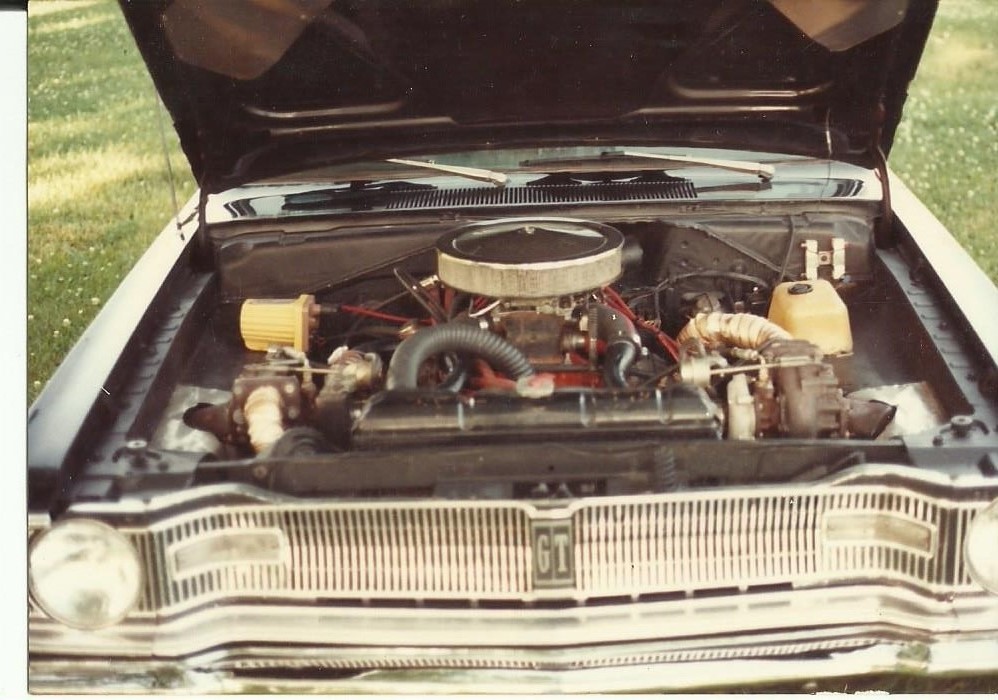

    My brother put a pair of the 300ZX turbos on his 340 Dart. Draw-thru with single carb. Looks kinda funky, but it worked. The turbos were far away from the carb, but he had no problems. It was bone stock and ran like a ****d ape until it didn't.
