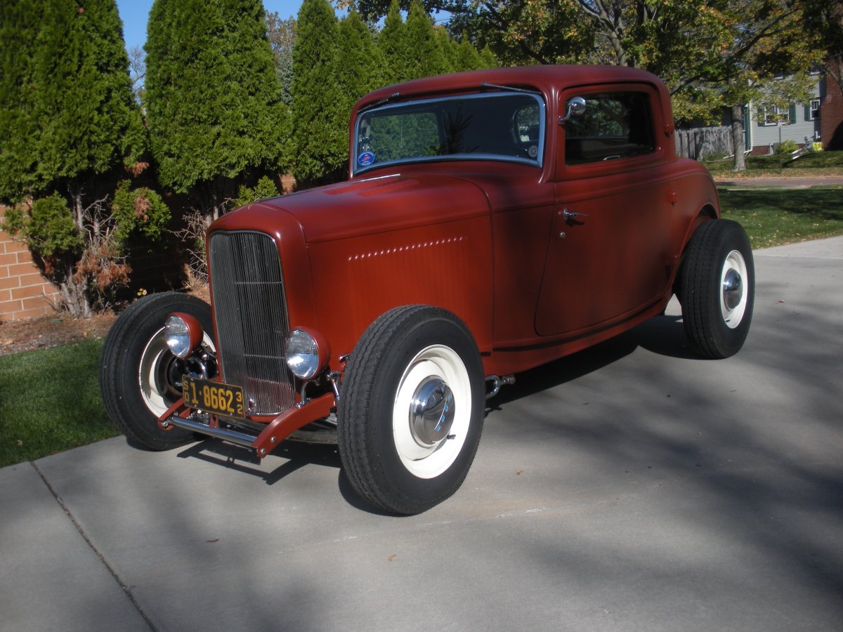

    1932 Ford 3W, took out Th350 put in 200R4. Every thing size wise was the same except rear trans.
    mount. All the other info you need is from previous responders except lockup. Because original
    use of this transmission was on a V6 the vacuum lockup will not work very well. The best thing to
    do is put the lockup on a toggle switch. You will gain 200-300 rpm using lockup. Do NOT drive
    with the trans locked up under 40 mph, more toast. I went from 14mpg to 23mpg 16 inch tires,
    .350 rear gears, 1900 to 2000 rpms at 80mph. Oh ya speed limit in South Dakota is 80mph.
