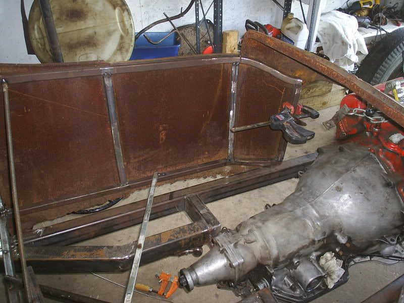

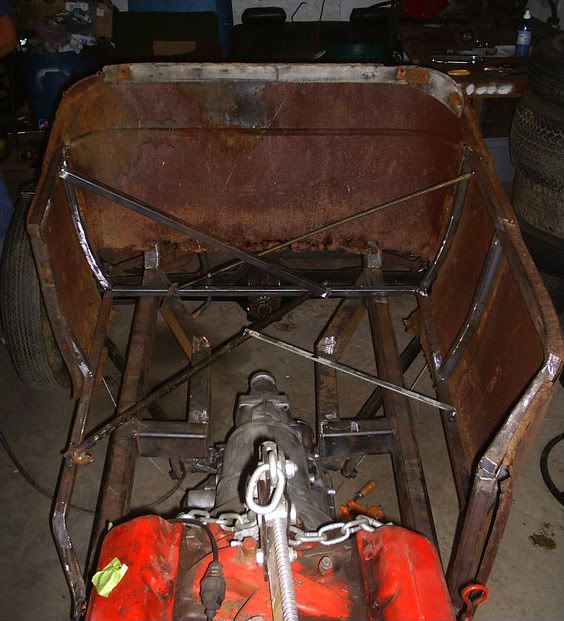

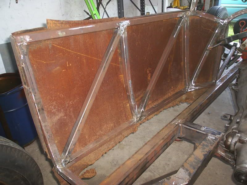

    Well, Matt's been working hard making all the steel pieces to replace the wood in the body. I went up the other day and helped him start to ***emble and square everything up. We still have more pieces to make for the dash/firewall, floor, back, and door opening but it's coming along nicely.
    Matt also decided against the original T shell that came with the body and bought a filled steel '32 shell and insert that someone had already mangled the bottom on. He also ordered some P&J chrome shocks that we'll be installing this weekend. Stay tuned!

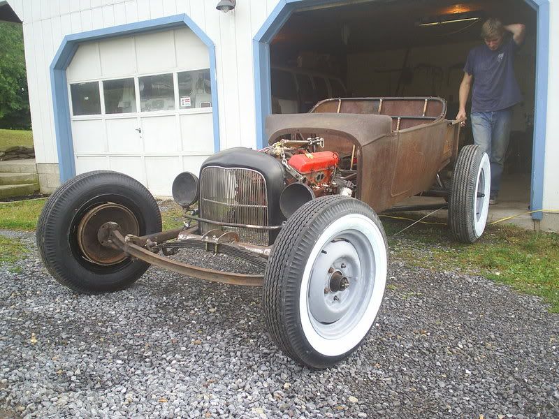

    We spent a "few hours" working on the T today. I started by chopping up the grille shell and insert to fit around the perch. The perch is gonna get a stainless cover to hide the fugly nylocks and smooth up the front end a bit.
    I didn't want the bars flopping around in the wind, so I cut the lower support and "z'd" it and recrimped all the bars back to it.
    It will get a little strip of stainless trim to cover the bottom edge. While Matt was furiously grinding on the dash support pieces, I cut up a model A headlight bar, broke out the hot wrench and coaxed the two pieces into shape. I welded studs into the frame and the mounts will get some nice shiny acorn nuts to secure them. Pretty basic stuff, but I think it looks a hell of a lot cooler than 1-800-hot-rod-parts.
    Speaking of 1-800- hot-rod-parts, after hours spent searching for a decent light duty shock absorber that wasn't gas-charged for a 5000lb vehicle, Matt broke down and ordered some chrome Pete&Jakes shocks. I cut the discarded ends off of the rear wishbones and made a lower shock mount off the rear axle...
    ...and a couple pieces of plate offset to follow the frame Z worked great for the uppers.

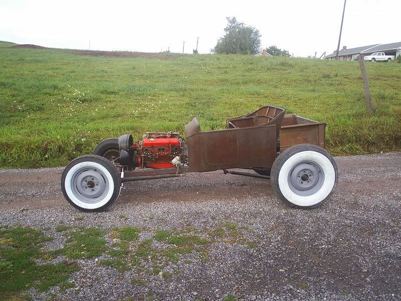

    Finally, we couldn't resist clamping all the body panels on and rolling it out of the garage for a look-see! We chopped up the T bed and precariously balanced it on the rear crossmember. Anyone need the front 3/4 of a nice T bed?:D seriously?...
    Overall I'm very pleased with the look. The front end seems a bit high, but it's hard to tell on a bumpy gravel road. Right now the rollers that are on it are taller in the front than the rear too. The new rubber from coker should be here this week and nose should come down a bit. We might end up reversing the front spring eyes, but we won't know until the new tire are on and the rubber rake is in full effect. I do love the way this thing looks from the rear, though!

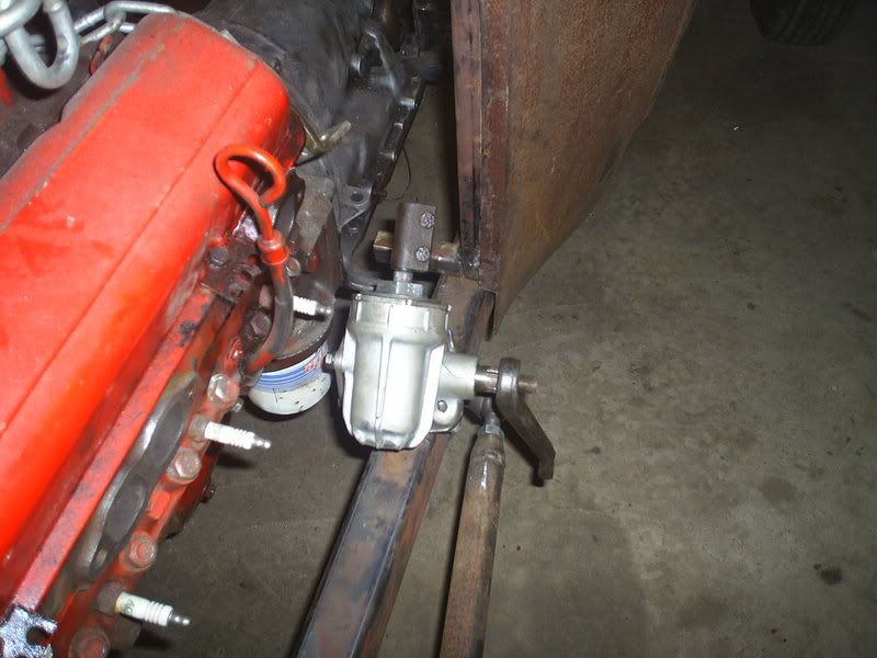

    I made a little mount bracket for the steering box and after playing with the steering wheel position a bit using a round rod and old wheel, I tacked it in place. It will get fully welded and gusseted once the column drop is made and we're sure it's in the correct location.
    We also got the master cylinder and brake pedal hung. We're using an early econoline jar that has a built in pedal boss. Nice and easy, just cut out a few brackets from .25" flate stock, drilled a few holes and tacked them in place. Again, they'll be finish welded once we're sure there's no interference with other stuff.
