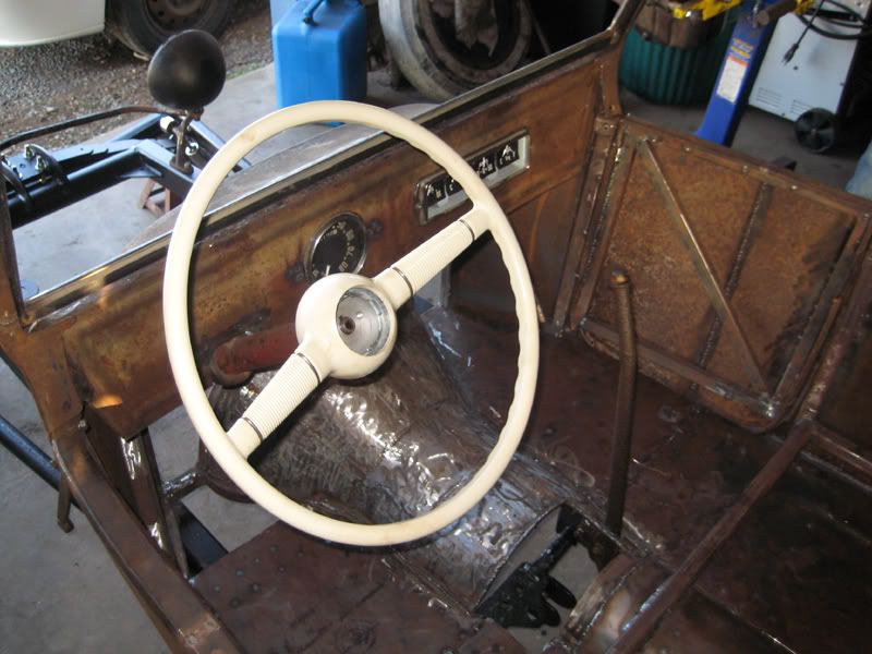

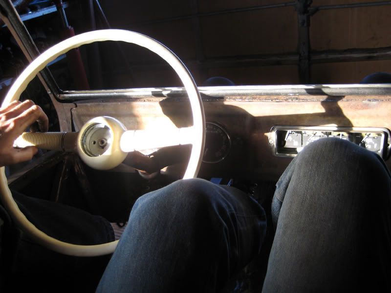

    Using the top piece of a f-1 column drop, and the bottom mast clamp, we located the column mast and clamped it in place. We sat in the car and figured out the most "comfortable" position for the wheel and welded the brackets on. Matt's using a 50's MG banjo wheel so we still have to find a steering shaft to donate the correct splined end to fit the wheel. I happen to think this steering wheel is about the coolest thing I've ever laid eyes on. He picked it up dirt cheap on ebay cause it was listed "old steering wheel" or something stupid like that.
    Matt had the idea to use the bottom part of the discarded seat riser for a dash. It has some attractive beadlines in it and we agreed it would look cool with a bit of work. Plus we're all for recycling old tin however we can. We rolled the bottom edge with a hammer and dolly, added a little piece to each side and trimmed away a notch for the column mast. It will get a set of early 50's mopar pickup gauges. They look clean and simple
    We also got the gennie shifter installed and adjusted. Needs a new handle as he picked it up used and the PO heated and bent it, but it seems to do the trick.

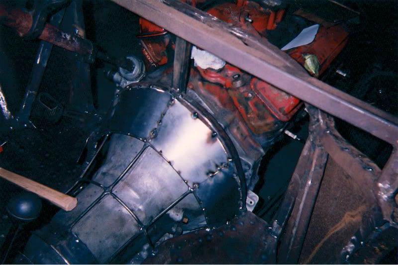

    Wow, seems like it's been a while since the last update! First off, these pics **** and they're old too, but matt Finished the trans tunnel. He made a skeleton of 3/8" rod and skinned it just like how he sews his home-made quilts.:eek::D
    Underside view...

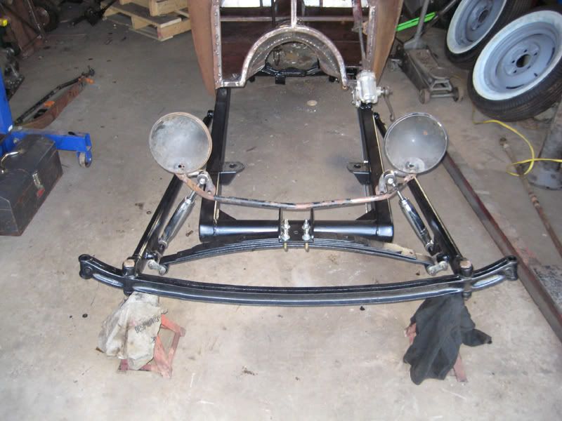

    Ch***is is painted and partly ***embled. We're waiting on the spindles that are out having the kingpin bushings honed. Once they're back and the rear is ***embled, it's a roller for good!!!:)
    We also chopped and fit the stanchions and built a windshield frame from some tubing. I've really been slacking on the "in progress" shots but basically we cut the stanchions down till the windshield was about 12" high. We wanted it chopped but still high enough to offer a bit of protection from birds, junebugs, and bumblebees. We laid the stanchions back a bit too. Not sure how much, but till we reached a balance of it looking good and still being able to fit our fingers between the wheel and the gl*** with a bit of room to spare. The frame is just some tubing that we slit lengthwise and welded up. I have a feeling the slot will need to be opened up a little more, but we'll know when we get the gl***.

    And we rounded out the day reminding ourselves why tall people shouldn't build T roadsters. Nothing like a couple full grown men taking turns sitting in a half finished hotrod up on blocks pretending to rip down the road.:D
    Me and my shiny golden locks glistening in the sun. oh yeah...
    Matt's getting ready to tell me a secret that I already know... Shhh, don't tell!
    We may have to contact KIRK! and see if we can start an east-coast Snugglers chapter if we both have to ride in this thing together. Snuggle up, It's cozy!:D:D
