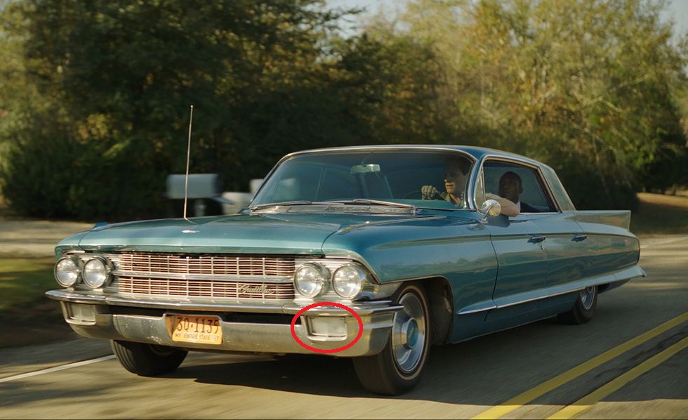

    this light, with the red circle around it?
    or do you have fog lights added to your car? The light in the red circle is the turn signal and park light. Not a fog light.
    Connect a piece of wire from the outside of the bulb, to a the bumper. This will be a temporary ground, so you can test the light. If the light works now, then the problem is that the ground connection for the bulb is not working. The ground comes from all those metal pieces making electrical contact, from the car body to the light bulb outer sleeve, that means no rust, no paint, etc between the parts.

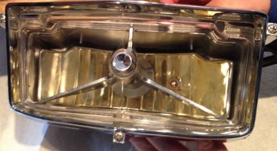

    Does your light look like this?
    joseangel_1976 likes this.

    Hi yes u are correct its the one listed on your red circle exactly that one. That lamp has two connectors. I was thinking of ground the negative side of the connector to the bumper like u said then plugging that little connector (square) that has 2 female connections back to the 2 male connectors to see if it works. Just trying to figure out where exactly to put that ground
