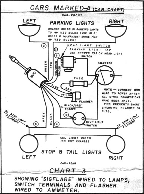

    Taken from Google..........

    If you only have 6 wires, you should not connect the car's hazard circuit to the switch. But the diagrams I find online for the 900 show it has 7 wires.
    Something funny is going on here, maybe you have a different switch? or someone messed with it inside?
    Anyways, you need to connect the white wire from the brake switch, and you need to connect the turn flasher wire, to get brake lights and turn signals working properly.

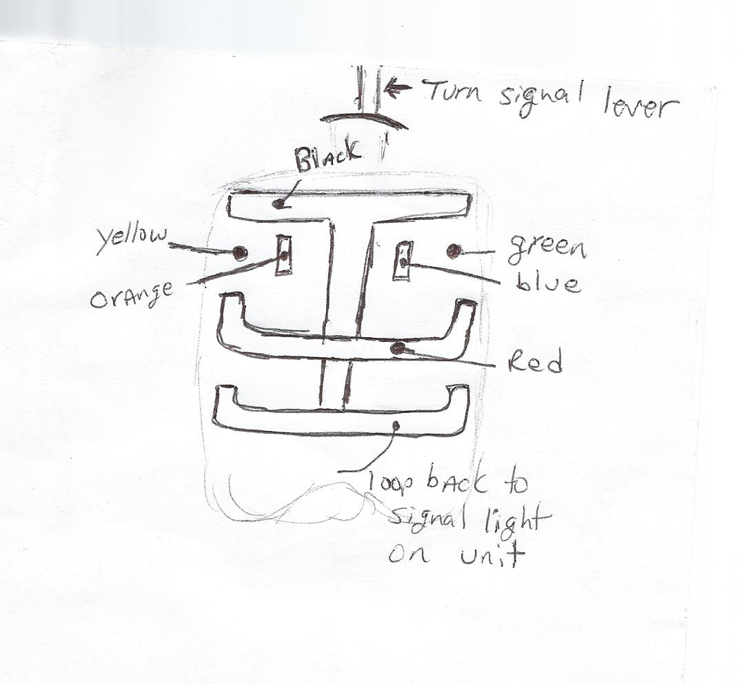

    Ok this is where I'm at, I took the signal stat apart to see what is what. I have attached a diagram and also rerouted a couple wires after viewing the circuit board.
    I switched the yellow and orange around which is only for front and rear left side. The key was when I switched the blue and black wires around. After looking at the circuit board I could see that the black wire controlled the flashers and the blue was only for right rear.
    Now I have both left and right signals along with hazards but still no brake lights. The red wire out of the switch is still hot all the time and is not connected currently. I tried jumping the left rear off the brake light wire and got nothing, that wire was still hooked to the signal switch orange by the way.
    I again tested the brake light wire with the ohm meter and it provides current when the pedal is depressed.
    The turn flasher power (purple) out of the harness is still disconnected also.
    Any ideas which wires out of the signal stat to hook the white (brake light) and turn/flasher power (purple) to ?

    You need to connect the white wire from the brake switch, to whichever wire on the turn switch is connected to both rear lights when the switch is "off" (centered).

    When you look at that sketch I did, there are only two places where the circuit is on both sides at once. They are the black wire and the red wire.
    Since the red wire is hot it turns on the flashers as soon as you plug it into the harness flasher wire. If I plug the black wire from the switch into the brake light wire from the harness it turns the flashers on once you push the brake pedal.
    I even jumped the brake light wire over to the right tail light wire and still got no brake light on that side.

    It's hard to figure out what's going on looking at your drawing, because I can't tell what moves where when you move the turn lever to one side, or when you turn the hazards on or off.
