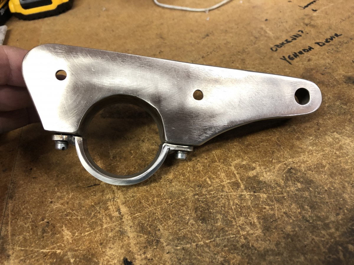

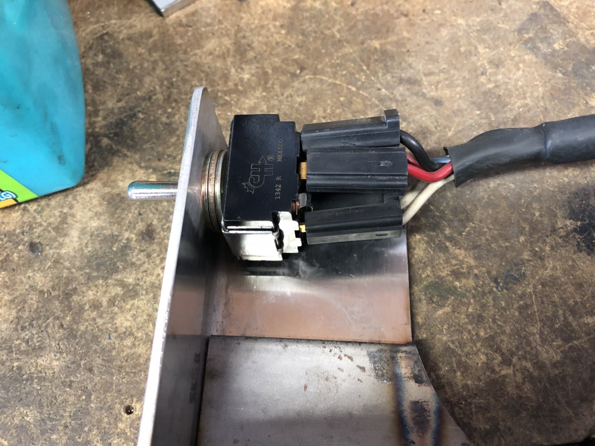

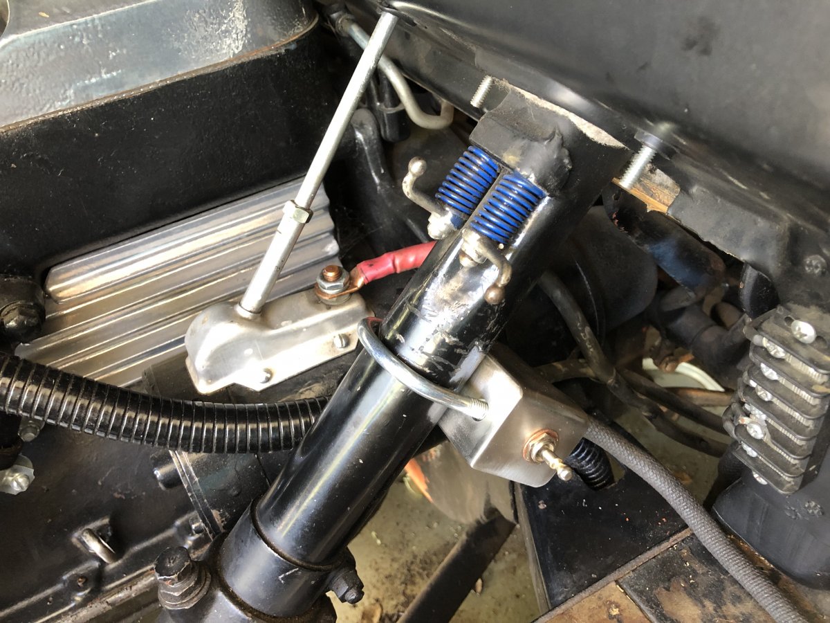

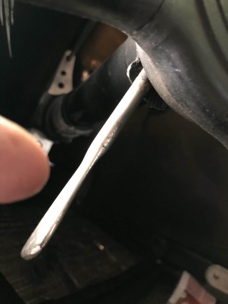

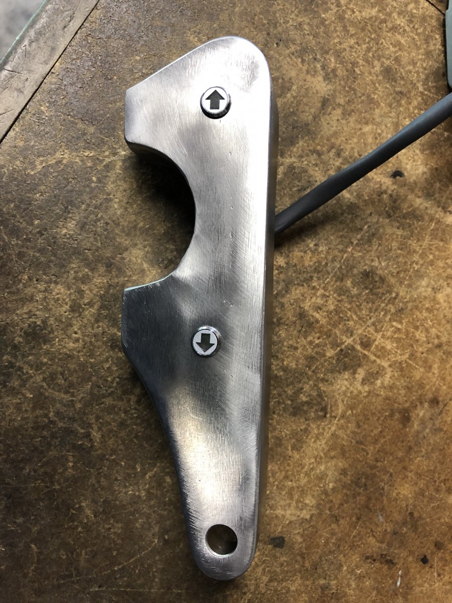

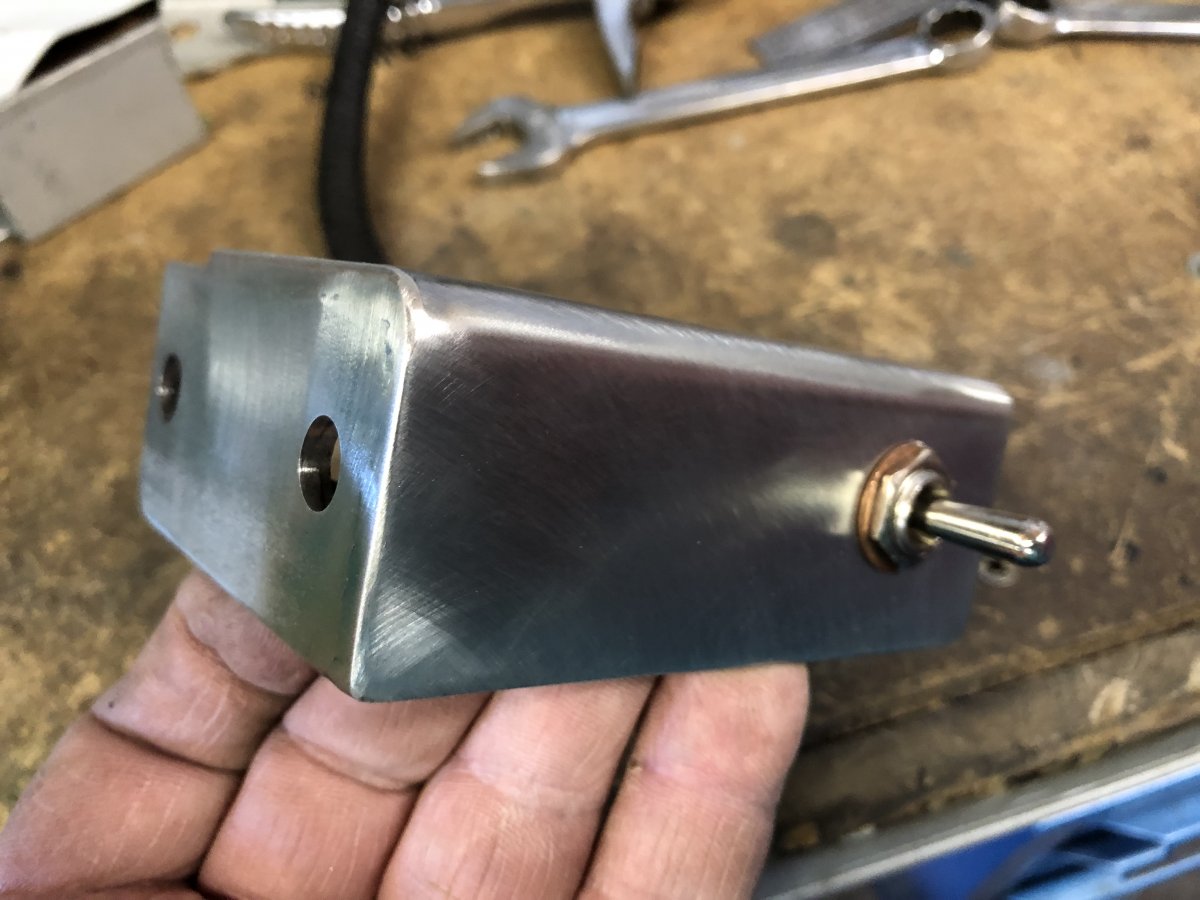

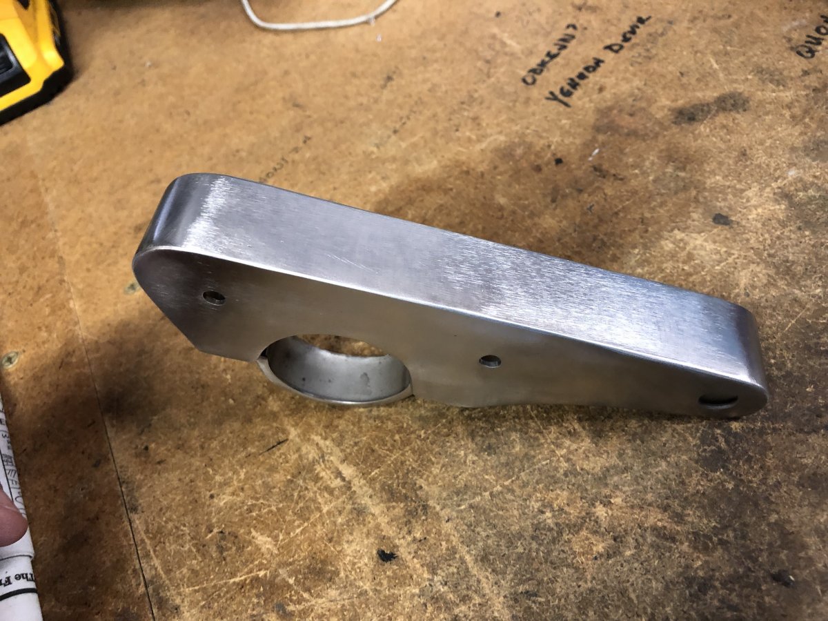

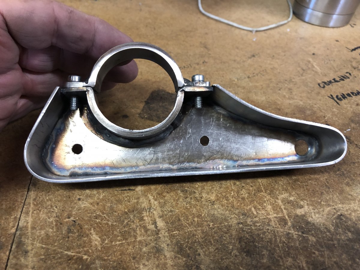

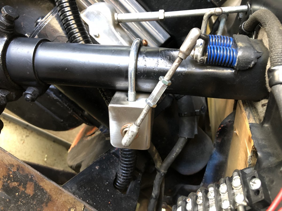

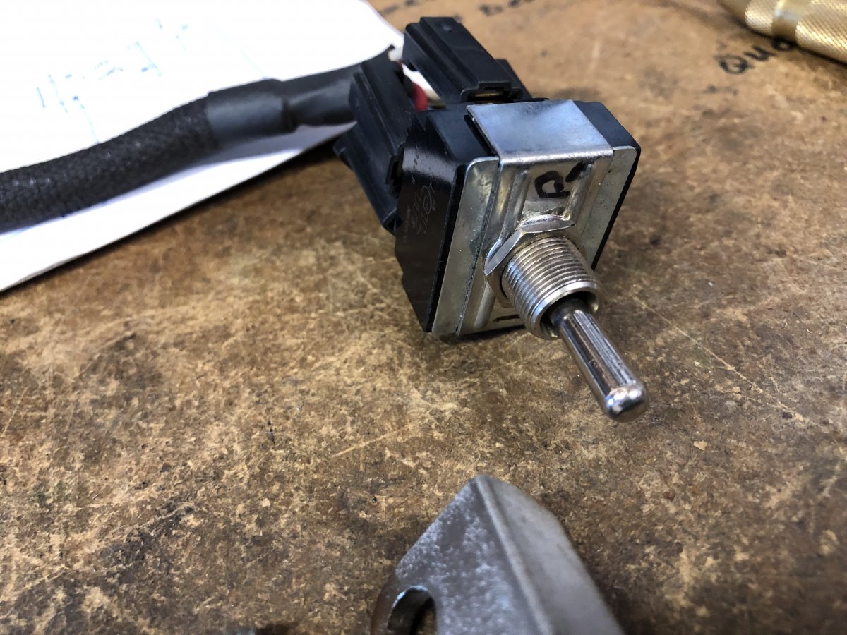

    D6348629-96F3-4BB9-AFE5-EC62B33342E7.jpeg 15C8D6D7-476D-49F3-B879-317B81959DB5.jpeg C118A9D0-3120-48BD-A059-8B884D9C30EF.jpeg B1BFDB31-2CE2-476E-85A8-0202920AE19B.jpeg 2C9709A3-E7B9-4FF5-BB88-ACBF8C9D4FF8.jpeg 3D32BE4B-07DA-484A-9A26-956065CB05BF.jpeg B3A5588F-7CB0-435F-A018-693DD290C80B.jpeg 4D6AF676-8969-49DC-B649-7D281B2E9158.jpeg 46CF19CC-802F-4508-81C8-22E97F1FC391.jpeg When I first built my sedan I installed turn signals by installing LED lights inside both headlight buckets wired to a flasher/toggle switch mounted on my steering column to tank brace...worked well but reaching around /thru the steering wheel became a pain in the ****...after cleaning the garage and looking for something productive to do I decided to see if I could utilize the old spark advance lever to work as a turn signal lever...here is what I came up with... the stainless box I made with s**** metal I had laying around, the actuating link I made from an old factory control rod that I cut to length and coupled back together...the switch I cant remember where I got it but I found the EXACT same one from Walmart (believe it or not)... used a die grinder to shape the toggle switch lever into a ball end.....I'm sure I'm not the first to try this and some probably much better than mine but I can tell ya....this was a great little project that works exceedingly well...Just make sure clutch and brake pedal arms clear when done...mine cleared easily.......got indicators coming so will be working on a way to install them inside...somewhere.

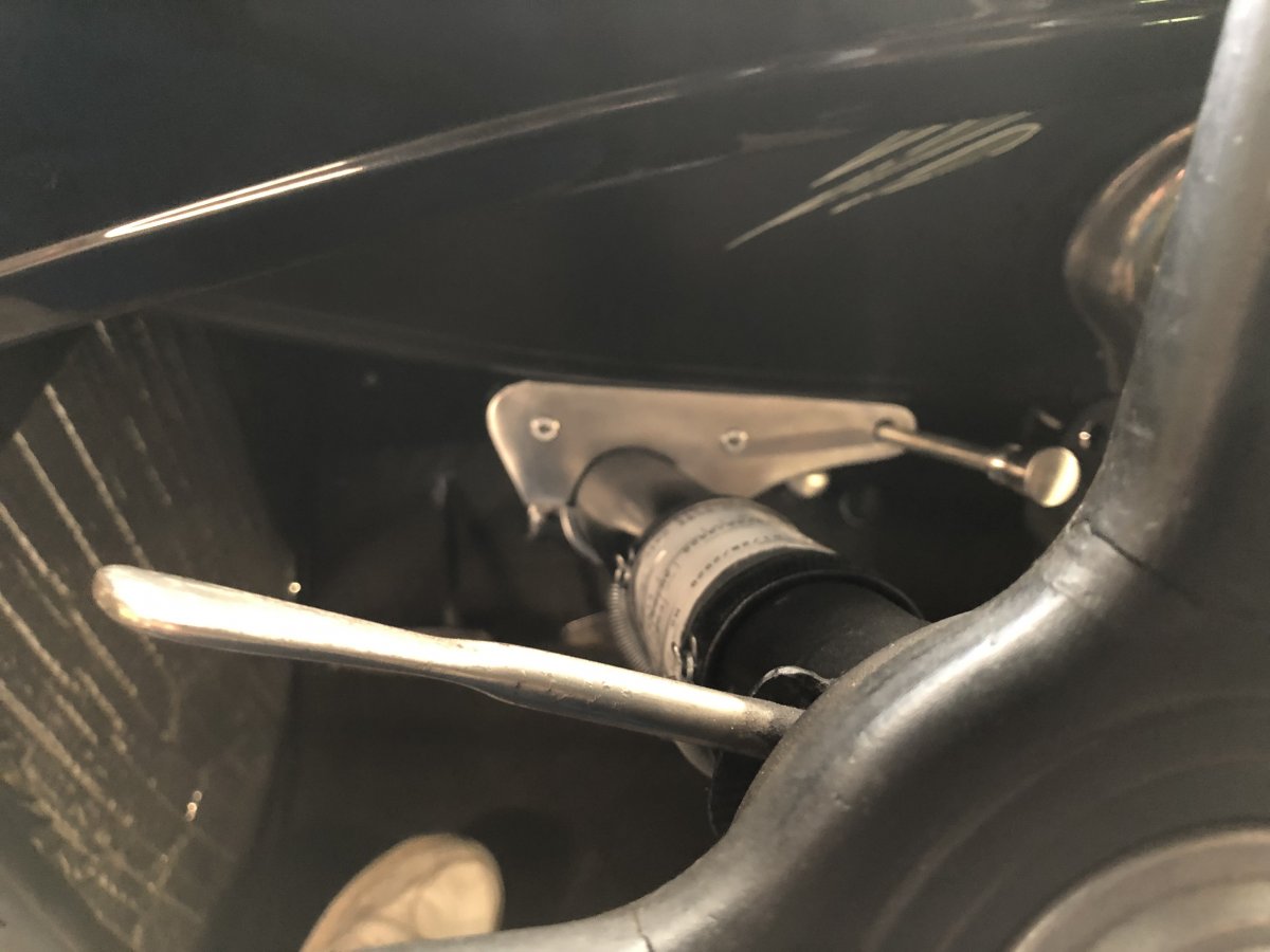

    @Ron Brown a great mechanical solution with a direct connection to vintage innovation...
    I take it there is a lever aside the Column near the wheel as a Factory/Aftermarket style? Can we see a pic of your driving point of view? I ***ume they do not self cancel...My Aftermarket inspired definitely doesn't. Again great mechanical sense and genius on your part and thanks for sharing.
    What is the other sprung lever for? My only other question is strengthwhen pushing up or down to actuate the switch...is there a need for stops to minimize breackage at switch level...I will say signals as a rule are handled fairly gently.

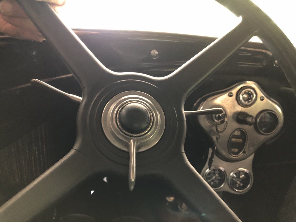

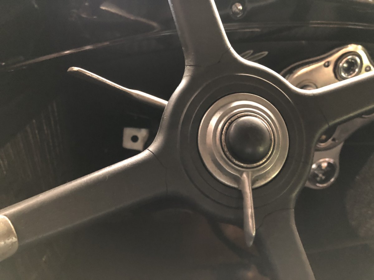

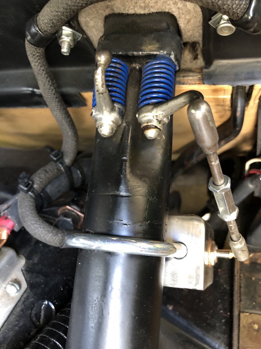

    Stogy...The Model A has factory spark advance lever on left and throttle lever on right. I never removed them and they are right where you would normally find a turn signal lever. They attach to a pair of long rods that go down the steering column and terminate at the two springs you see. A linkage goes from left lever to distributor and right lever to carburetor. I am running dual Strombergs and electronic distributor so no need for the linkage. Nice thing is the lever at the steering wheel comes out of the column thru a port that only allows it to move up and down a very short distance and actually creates it own stops, so no need to worry about breaking the switch, no matter how hard you pull on the lever. They are not self cancelling.
    here are a couple pics from the drivers seat...the lever on the right is not used so I may find a use for it later, like maybe a drag chute release...

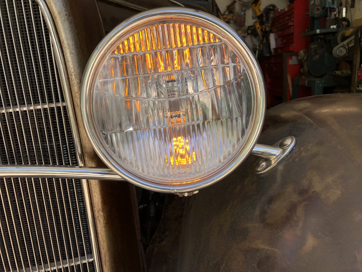

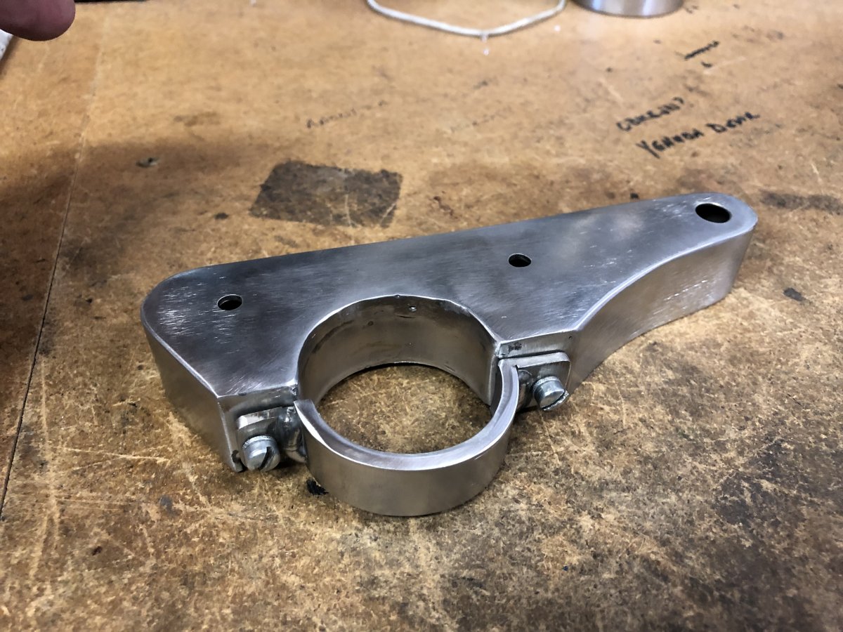

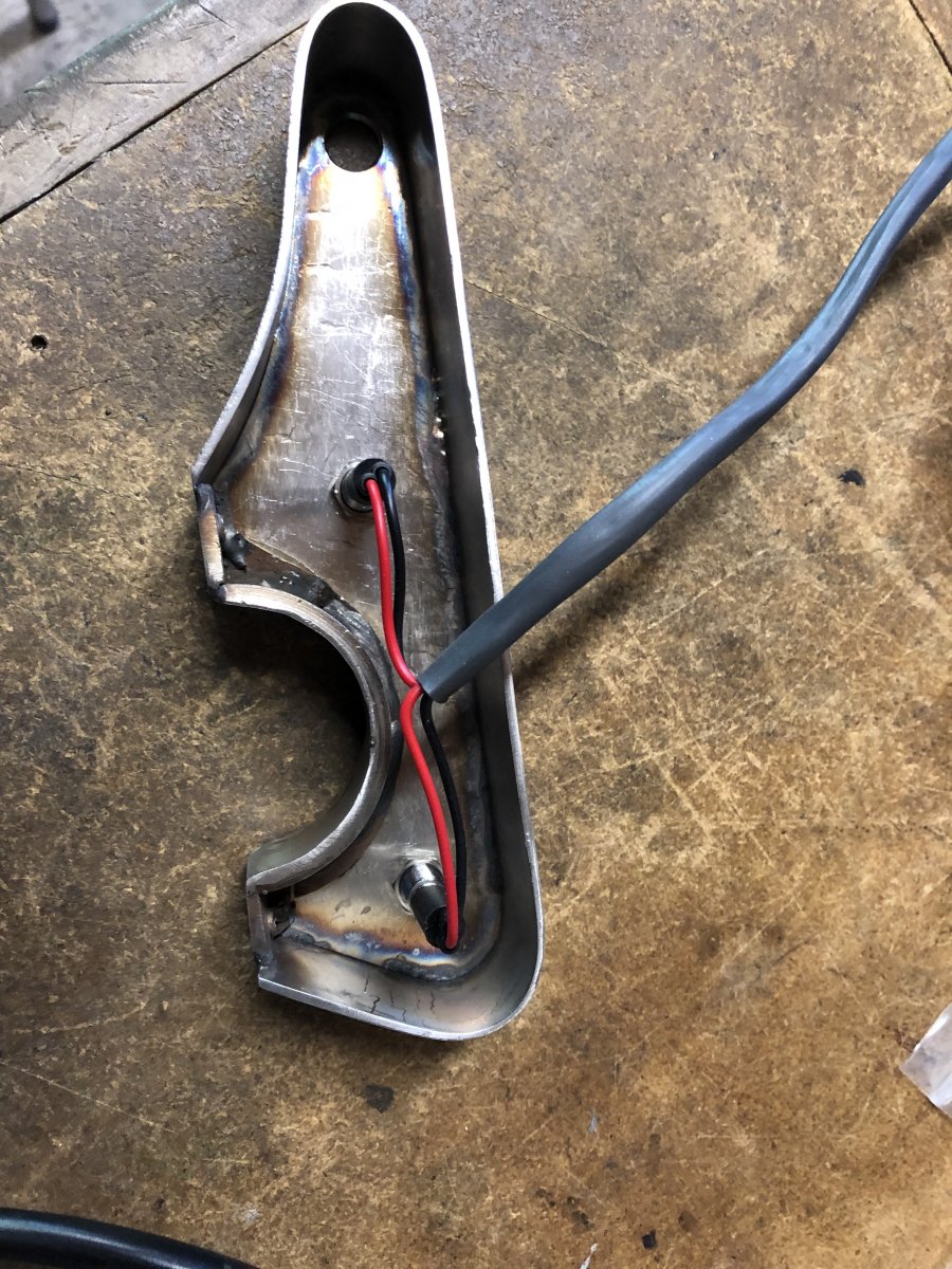

    CA1EB925-B679-4338-AAED-703D3EE8A1E0.jpeg 7DB23970-7BF6-4DBD-B5DB-4119AB15F56E.jpeg DDB8C319-2727-4FA2-BFD4-50E246C17704.jpeg DA90D97E-ECD0-4BAD-A0AA-F96AB6C3DDC8.jpeg 8E741E75-754F-46F2-8880-71549A3D4F97.jpeg 70733A67-F615-47CC-B9D6-BF3A37231ED5.jpeg ED8C8F76-8219-4602-824C-DD3D64791E28.jpeg Final chapter...finally got the turn signal indicators...built a bracket, again out of s**** stainless I had, to hold them and installed...wired up and everything works well...
