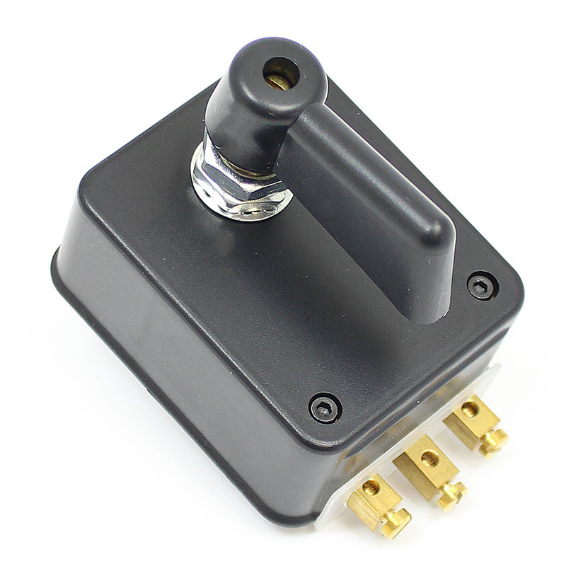

    You can get automatically cancelling dash switches, either clockwork or vacuum.

    Sparton self cancelling switch as mentioned in posts 19 & 21. Uses a rubber wheel that rolls on the hub. No electronics, and usually cheap when you find them.

    On the Model A hot rod, the turn signals are in the head light housing and on the banger the turn signals are in the tip of the horns. Can't see either. The little green lights on the turn signal don't mean much to me either other then the fact that I have left my signal on too long. I have been looking for the unit with the rubber wheel for over 2 years and haven't found a working one yet and also they don't really work with the Model A steering wheel. I remembered seeing the self cancelling dash switches on British sports cars back in the 60s but could not find them on recent searches. I just prefer that they shut off after use.
    Oneball, I'd appreciate if you could supply name of distributor or name or number of product.

    https://www.ebay.com/itm/3919971069...=2047675&ssuid=&widget_ver=artemis&media=copy"https://www.ebay.com/itm/3919971069...=2047675&ssuid=&widget_ver=artemi***edia=COPY"
    Image search showed this in ebay. Didn’t see the other one right away.
