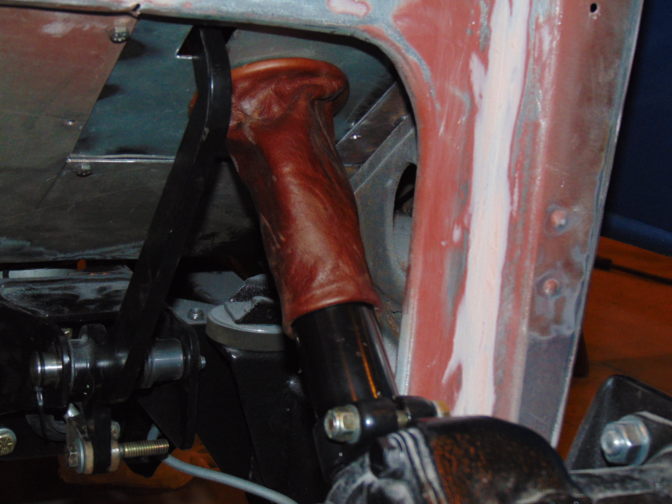

    It's been a few weeks since I've posted anything, but that doesn't mean I having been working. I made a transmission tunnel and a brace to hold the steering column. The trans tunnel took me the p***ed two or three weekends to finish up, but the column brace went together pretty quick. I even took the time to take out my cowl braces and straighten them out. They are welded back in place. [​IMG]

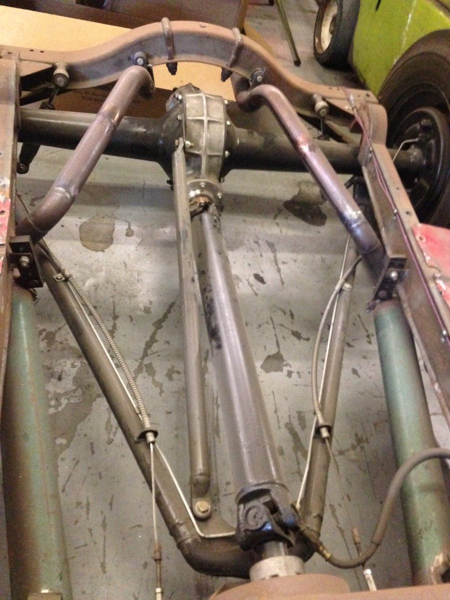

    Just found your build. Very interesting approach, will be tagging along. Am curious about those rear trailing arms being attached at the outside of the frame while using a buggy spring out back. Been a lot of posts about the "twist factor" when mounted on the outside. Might consider rethinking this and connecting them under or near the ****** ujoint.
    Here is the traditional way most of us do this

    Ahhh yes the twist factor... The rear suspension was taken from a rod and custom article many years ago. At the time I thought it was really cool and had the parts on hand via a junk pile at work. When I originally started working on mocking this car up I was 24 years old and had zero guidance, in fact I was so intimidated by the HAMB back then I didn't even post on here. So almost a decade later and lots of reading I realized it's an awful idea. I'm in the process of gathering the parts to totally rework the rear suspension. I am going to use ladder bars in a triangulated setup, putting the pivot point towards the center of the car and allowing more twist.

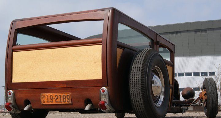

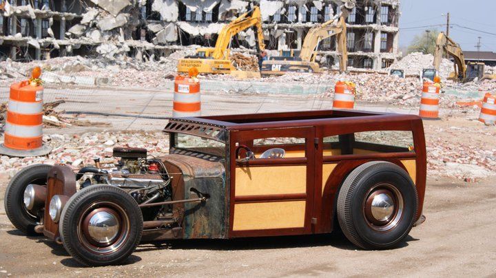

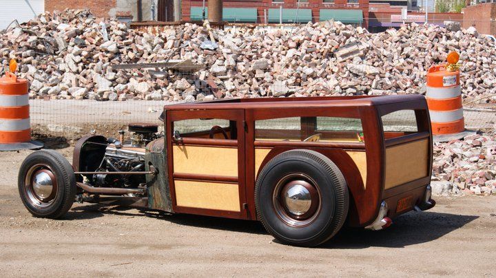

    8F3E6EF2-9E5B-4F9D-8356-6A79D7F69141.jpeg D48543F5-2D76-423E-B1B4-591A7FB2D7C5.jpeg D8E52C56-EE0A-465F-8D17-12430A661D6B.jpeg I like where this is going.....heres some inspiration for the body (they couldve finished the rest of the car better but i like how they did the body)

    I found an article about that car somewhere a while ago. Its really well done, I think the guy was a cabinet maker or some kind of master wood worker. I agree, if the wood is that nice why not make the metal nice too? Thanks for the pictures.
