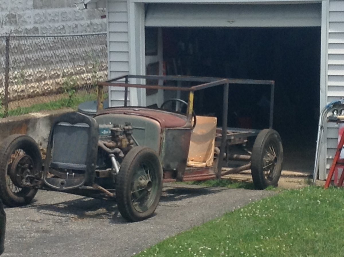

    Haven't had much time to work on this thing lately, but I picked up a compressor last weekend. Today I filled up the tires and pushed it out of the garage for the first time. Overall I'm pretty happy so far. I feel like I the roofline captures the at***ude is was going for in my sketches. At this point I really need to move my rear axle forward to get the look right. I picked up another rear crossmember on craiglist, and I have a line on an early 9" rear, but I need to trade the guy some welding labor for it.
