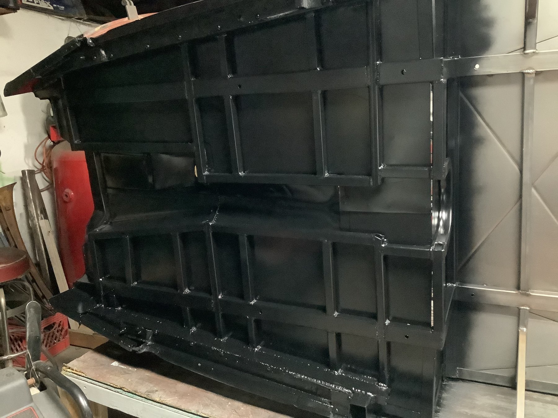

    After having trouble logging onto the H.A.M.B. I gave up. But I got it all straightened out so now I’m back. The winter took out my harbor freight tent garage, which then turned into a nasty letter from the city, so I had to take it down. This resulted in a garage that was too full of **** to work in. Plus I got distracted by trout season... but I cleaned up the garage and now I’m back! Finished up my last pieces of floor. Took the body off and I’m now painting the underside.
