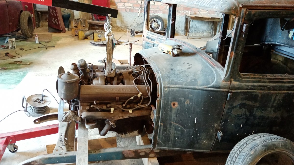

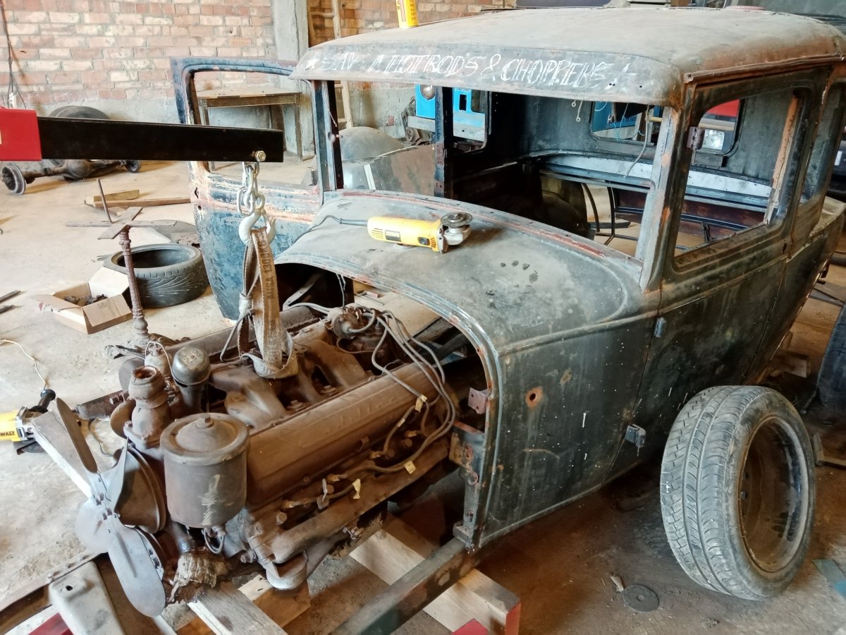

    ok so picked up the caddy motor..****** monster!..its now placed until we decide on preferable height etc..i reckon i need to extend the ch***is about 6cm (2 inches and a bit)otherwise the valve covers will be behind the cowel which is ugly..ive seen install with the motor way up above the ch***is rails and others way lower..any advantage over either? IMG_20201222_123859.jpg IMG-20201222-WA0003.jpeg

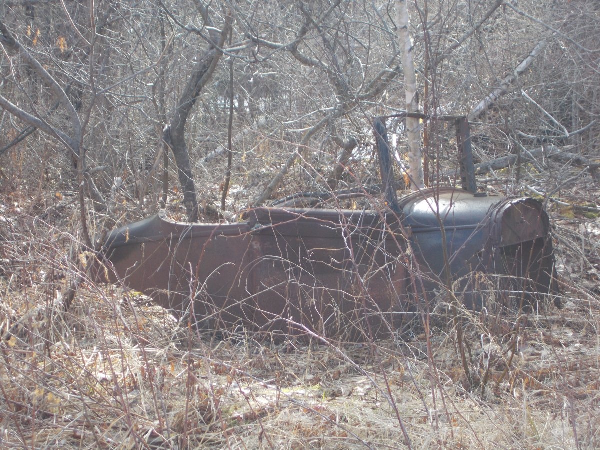

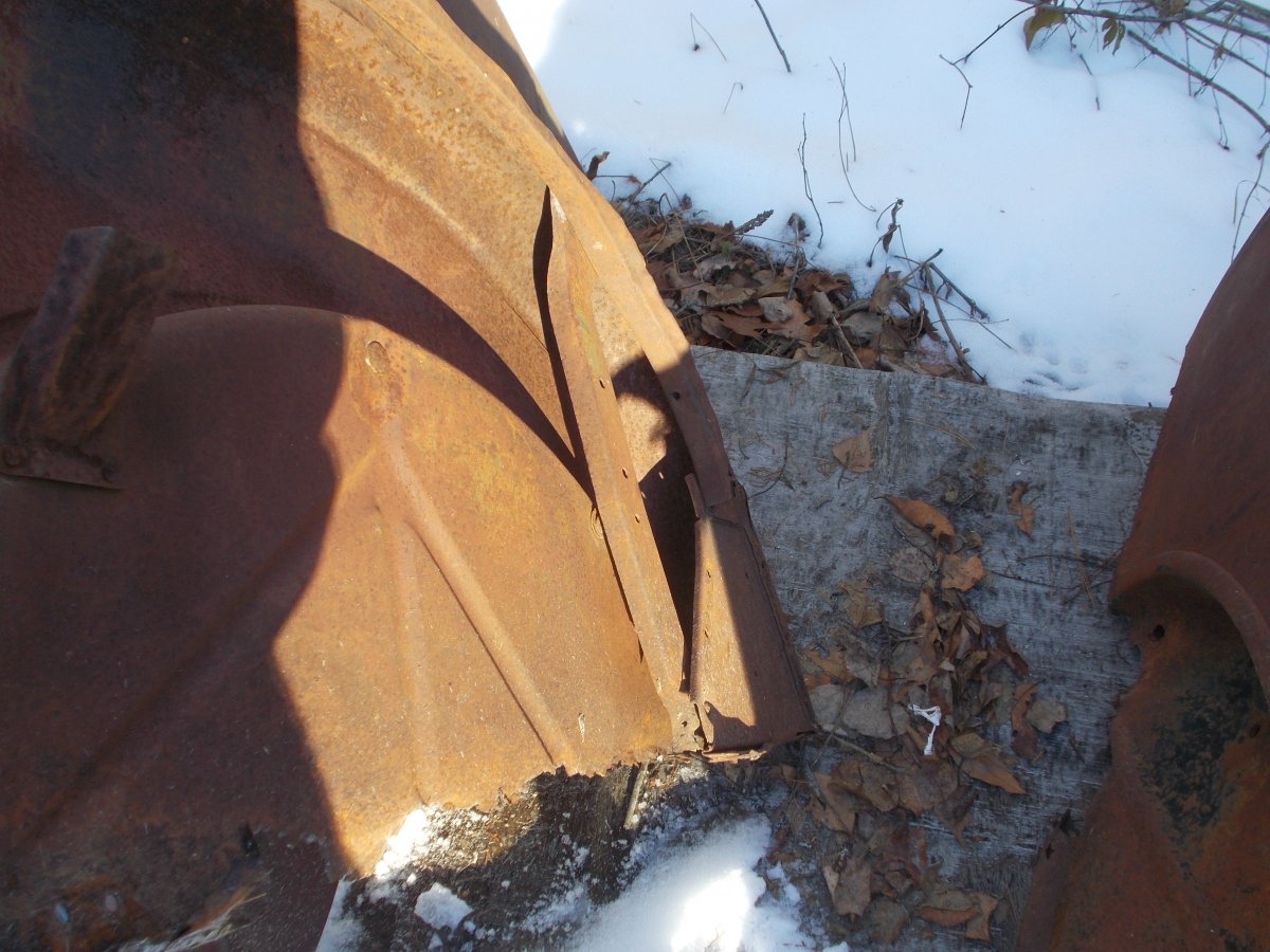

    Wish you lived closer, i have a '29 murray cowl with firewall tucked into the brush as a landmark...
    Free, if anyone can use it... tall gr*** hides it all spring, summer and fall... snow hides it all winter...
    note the gastank forms the top 1/3 of the firewall... loads from underneath...

    small up date..got the engine and gear box down..still plenty of room for carbs etc,,and hopefully enough space for some sort of steering under the headers!..that´ll be the next thing to sort out

    A Murray cowl, this one had a cowl band and the belt molding is an inch shorter to clear it.

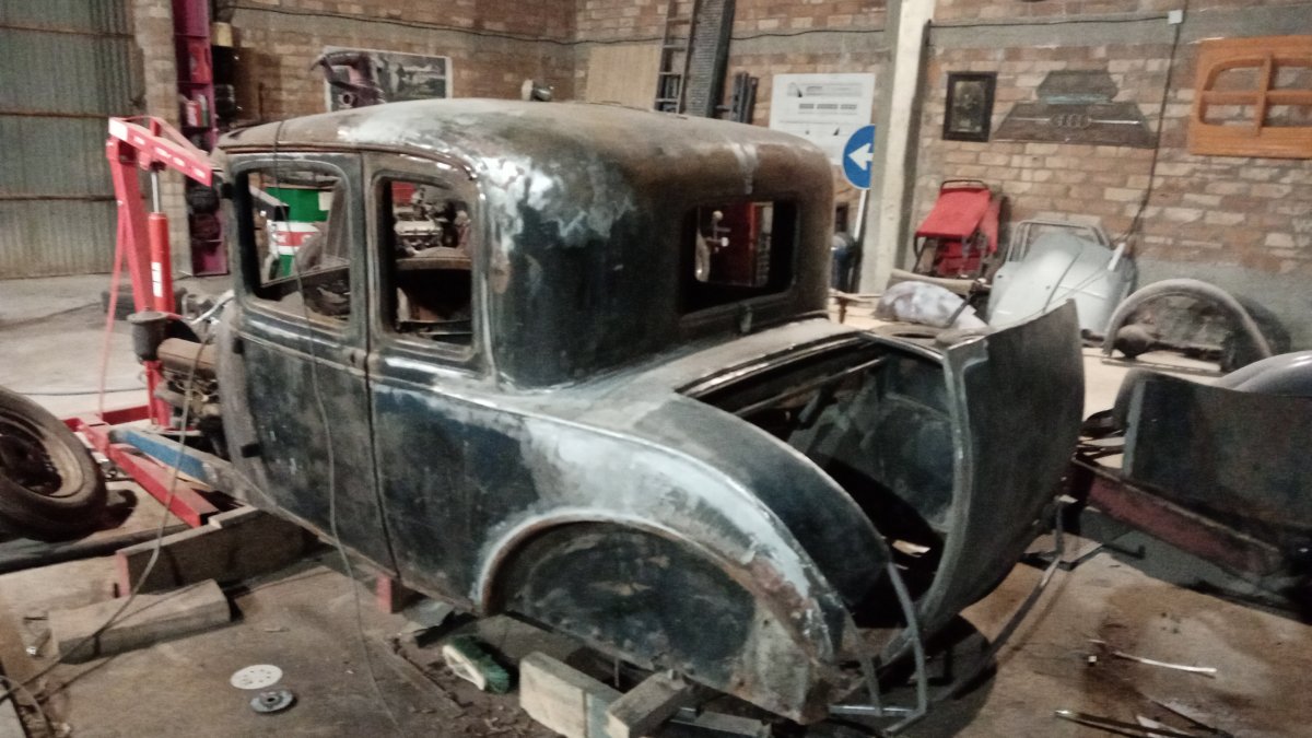

    ok sorry for the delays..christmas and all that..so today i´ve been given the go ahead to do a rumble seat..which is nice..but i´m not sure about how the hinges work and the details for the weather stripping (..like how to stop water getting in)..has anybody any close up images of the hidden details please?..cheers in advance IMG-20210107-WA0010.jpeg
  16. sloppy jalopies
    Joined: Jun 29, 2015
    Posts: 5,256
    sloppy jalopies
    Henry used a curved panel and let the water drain through holes stamped along the base...
    not using a rumble i will fab up something to extend the trunk gutters to the floor...
    i would think long and hard about running a rumble seat,
    the way people tailgate today a quick stop could get someone cut in half...
    inaford30, Blues4U and loudbang like this.

    Yep I'm pretty sure it's just a show thing.. I wouldn't ever put anyone in the back for more than around the block.. Clients wishes... Is the hinge at the bottom of the curve or a bit higher?

    When I read the ***le I thought you were crazy, when I seen it I really like it. Plenty of room and it just looks right sitting there, great fab work.

    Looks great, nice fab work. The proportions look right.

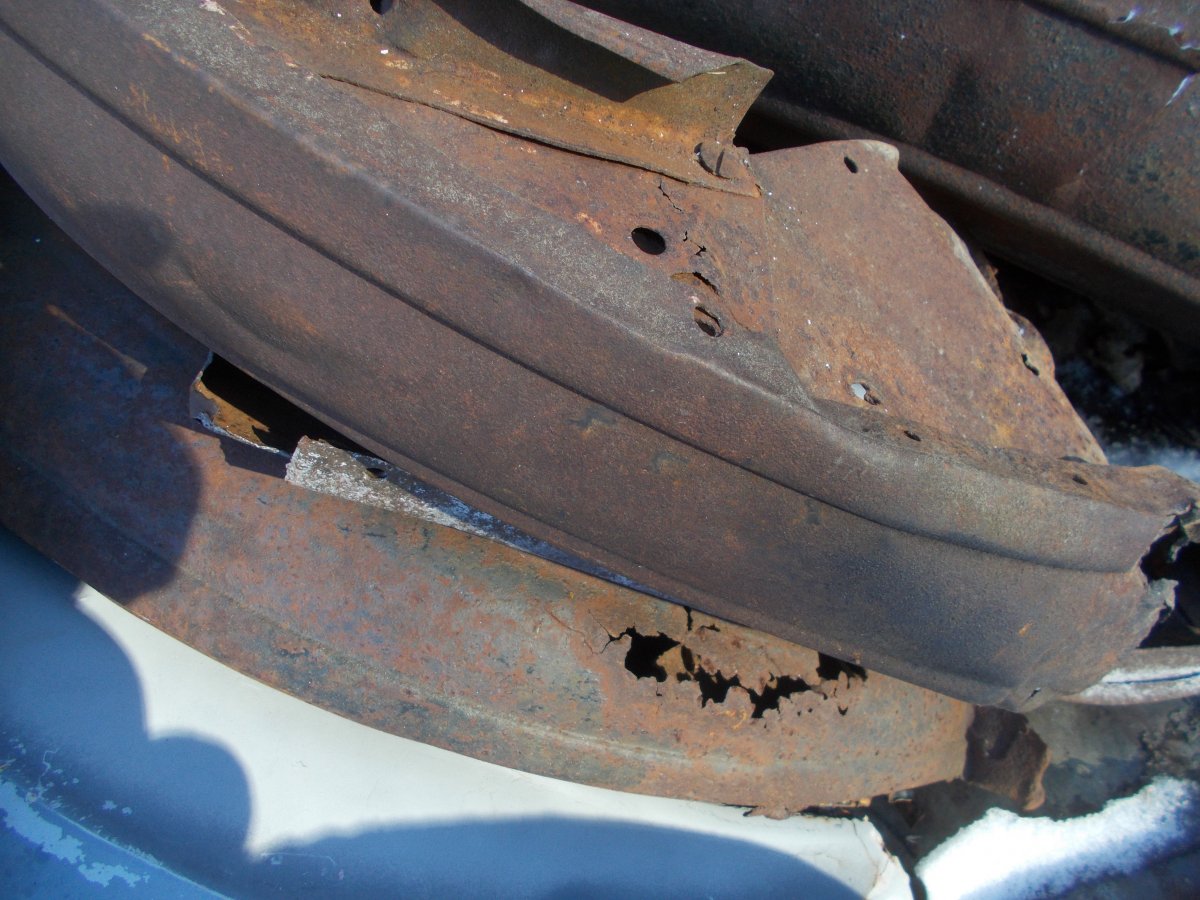

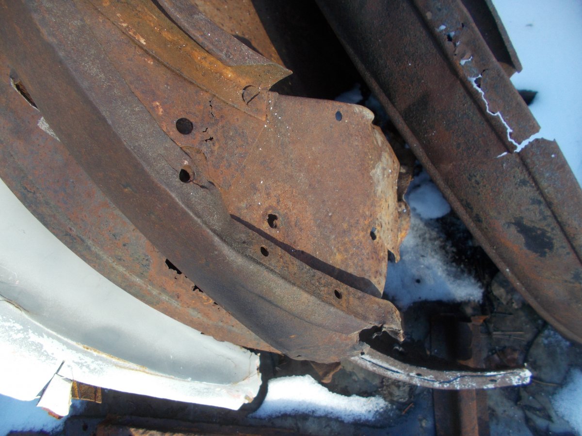

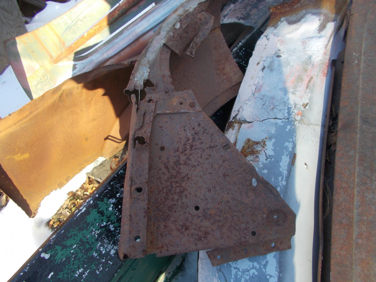

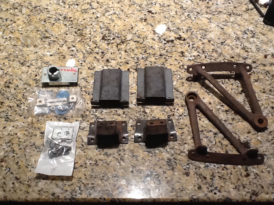

    Those A rumble hinges should be easy to find as they almost never rust out...
    they let the lid rotate under the rear panel, that is why the rain gutters stop where they do...
    bummer.... i got rid of the whole works last month...
    pic of someone's add...

  25. sloppy jalopies
    Posts: 5,256
    sloppy jalopies
    went out back for some snow pile pix... hope they help... DSCN7314.JPG DSCN7315.JPG DSCN7316.JPG DSCN7313.JPG DSCN7317.JPG

    excellent sloppy..thanks thats exactly what i need to see and what i´ll be doing tomorrow thanks o much

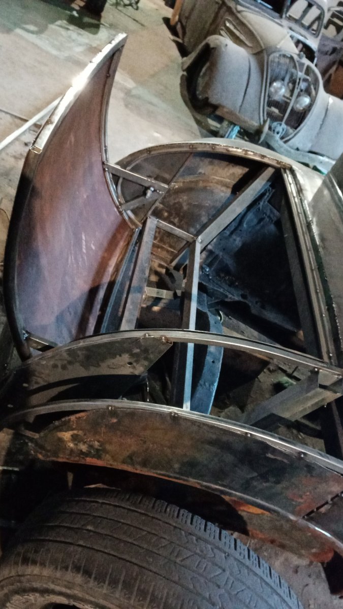

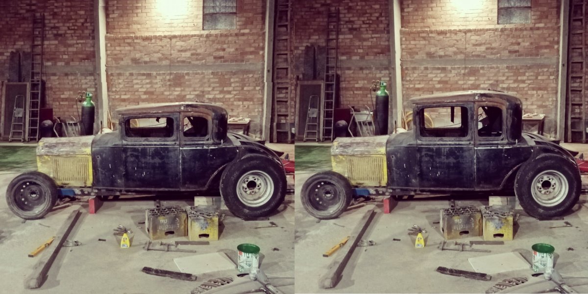

    A bit more done on the rumble seat.. At the moment mocked up.. But the geometry works and it closes.. I sat inside.. Its tight for a tall lad but will do I reckon
