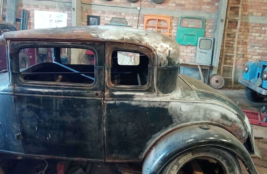

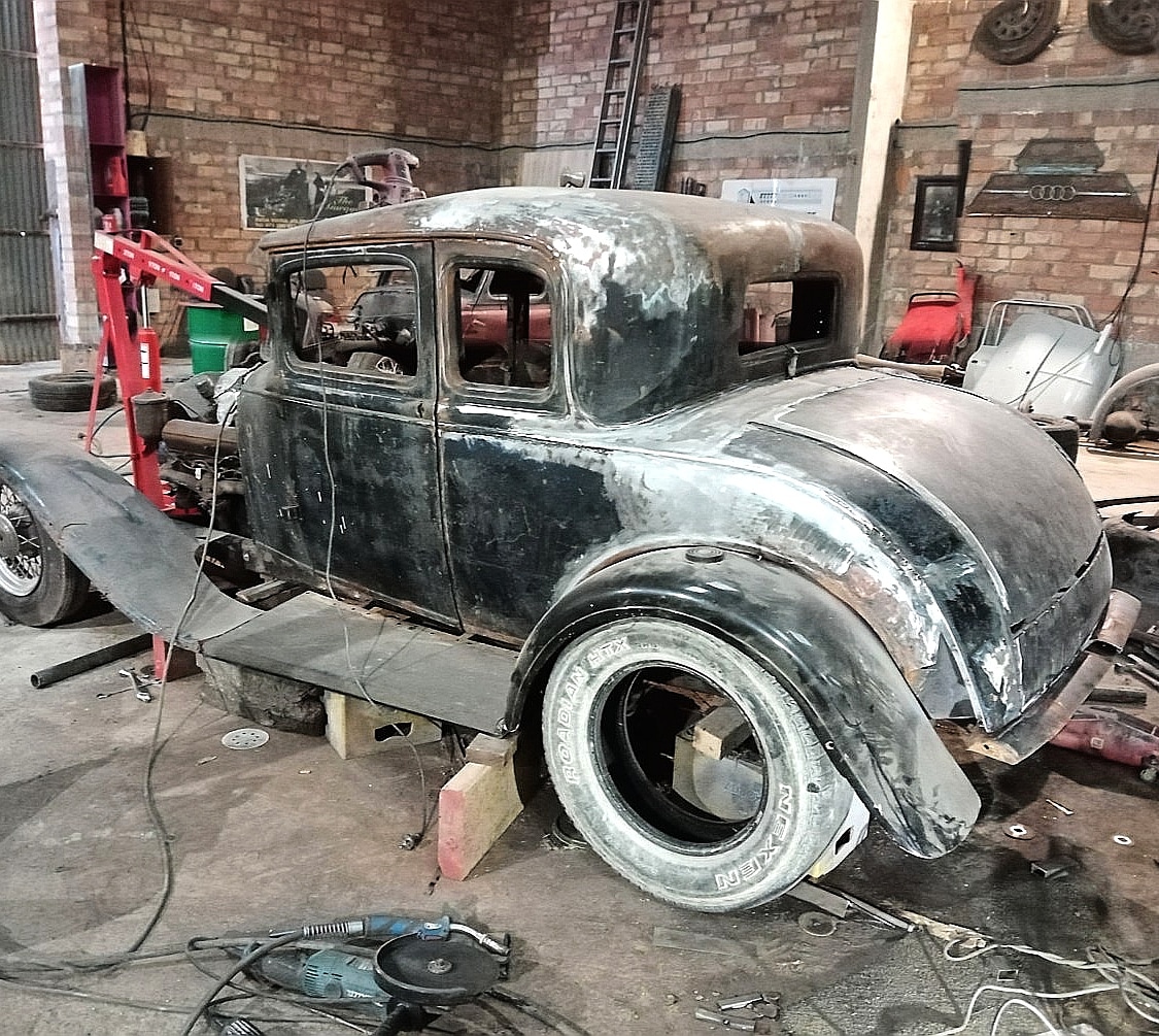

    OK small update.. Been busy welding some of the seams and cuts. The bodywork is now feeling a lot more solid in preparation for the roof chop.. The clients wife wants to use the fenders so I mocked it up to see if it would look decent or not. The back will have to be quite high to get the rear wheels under. IMG_20210112_130000.jpg

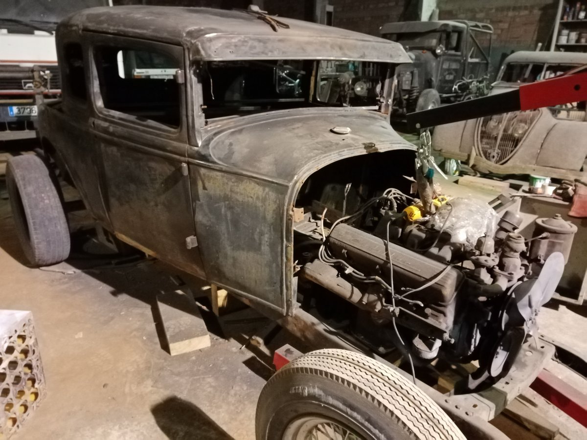

    So with a photo hop it should look something like this.. IMG_20210112_141201_200.jpg

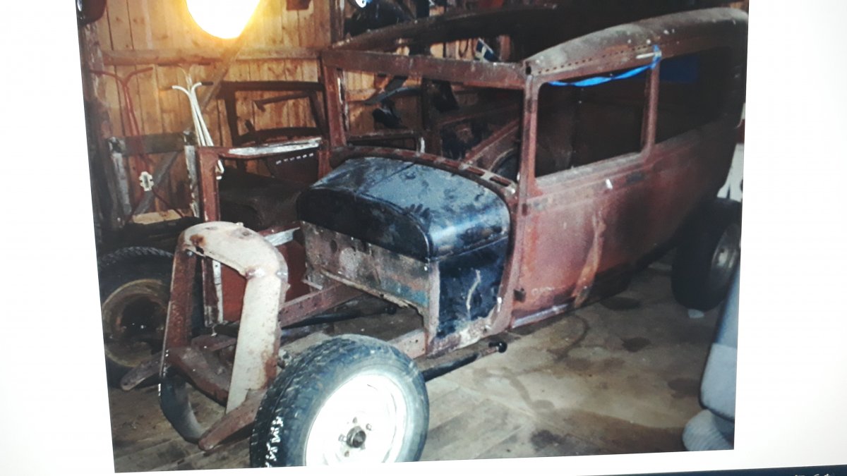

    Question for the experts.. The molding that runs up the side of the rumble seat. On some cars it's there and on others it's not?. I'm wondering whether the pictures without are fibregl*** cars.. Or is there something I'm missing? IMG-20210113-WA0000.jpg IMG-20210109-WA0004.jpg

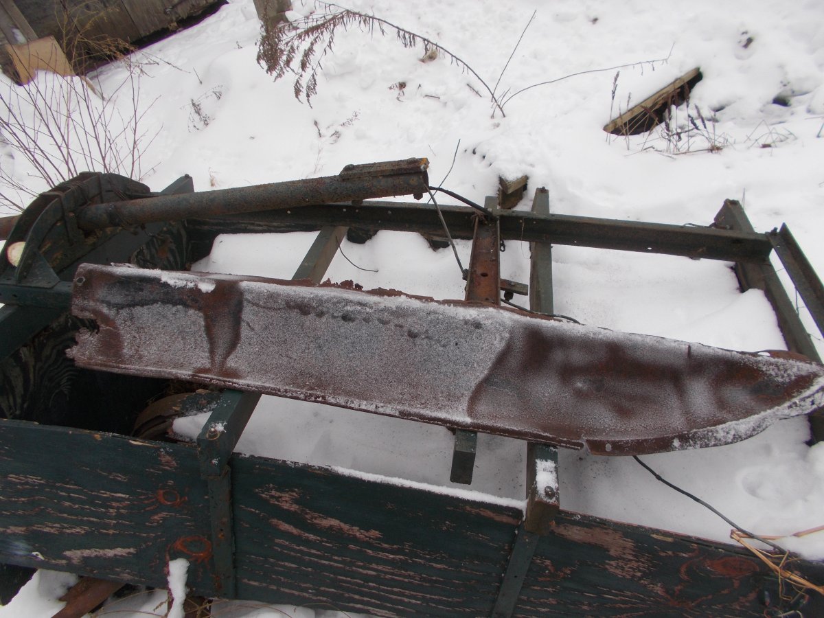

    As for sitting high you don't have the splash aprons... they hide the frame sides...
    about 6" tall... right side shown... '30 is 2 pce. and '31 is 1 pce... DSCN7339.JPG DSCN7337.JPG

    Good point sloppy.. I was building it thinking it would be fender less.. They just sprung this on me.. Its a whole different stylistic ballgame

    As for moldings [beads] '28-'29 did not use them they used a T strip, about 3/8" wide [were tacked on, i would screw them on for later adjustment]...
    '30-'31 used a slightly tapering approximately 1" wide stamped bead along the trunk gutter...
    except for the cabriolets... most'32s including the gl*** '32 roadster pictured also had them... '33 up no...
    where most of the body's styling is '29, maybe go that route, think it comes in a cardboard tube, you bend...
    snyder's sells the T strips if you choose to go that route...

    just spitballing but you could build a much shallower splash by starting with sheetmetal tube or sliproll one to fit...make the fender fit it...

    I actually dont mind the finders, a small splash apron would do the trick. Maybe backtrack all your work and raise the wheel arch a couple of inches :mad::confused:

    Nice project! Lots of slicing and dicing happening there. Just curious of the sub-frame & floor condition. I realize you have to satisfy your clients wishes but to me, what you have now is just screaming for a 2 1/2" chop and a channel the width of the frame with the rear fenders raised allowing for a 3" high splash shield That would put the kibosh on a rumble seat though. Then, narrow the front fenders 3", along with the running boards and narrowed rear fenders...sorry, went off on a tangent there. Carry on.:)

    Hehe OK.. That'll keep me busy for a couple of days A2B .. Yep the roof will be chopped.. The channel may also happen.. I've been asking him to sort out his choice of axles so I can see it sitting properly.. But he's busy buying shiny things . The fenders yes maybe.. They are super wide... Last week they took out my appendix and part of lower colon which was a bit of a surprise.. If I so much as go near the workshop in the next 2 weeks both my wife and mother will kill me! Thanks for the enthusiasm all the same.. I'll be back at it in no time

    The fenders do a lot for this car. Without them, my mind still compares this to a typical stock Model A coupe body. With the fenders (and no aprons) this car is its own type of coupe.
    I dig it.

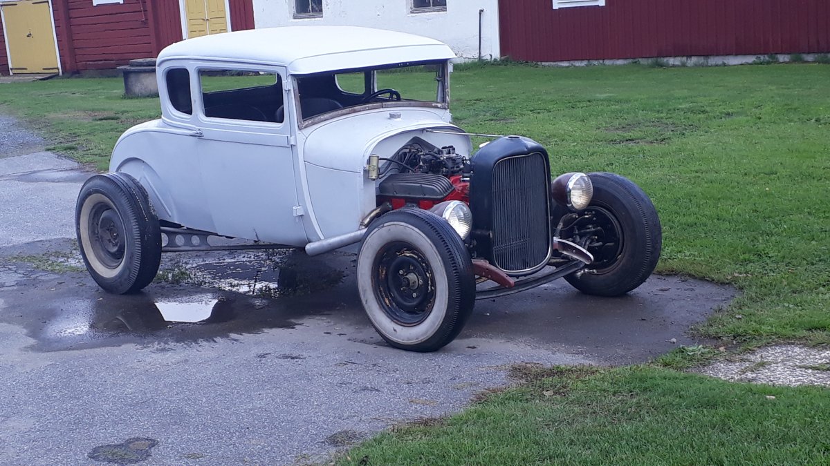

    Nice work ! I also did a similar project but started with a tudor body. 20190905_161534.jpg 20190918_185909.jpg

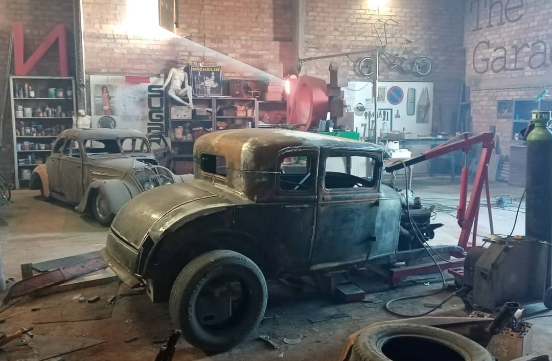

    Big day.. Apart from I'm out of my cage and back in the workshop.. Decided to cut the roof off to celebrate!.. About time too.. 10cm off the top.. 4 inches approx.. Stats to make more sense of the high **** in the air now.. I like it.. S***ching it back together this afternoon IMG_20210203_104638_368.jpg IMG_20210203_104638_377.jpg IMG_20210203_104638_392.jpg IMG_20210203_104638_443.jpg IMG_20210203_103606.jpg

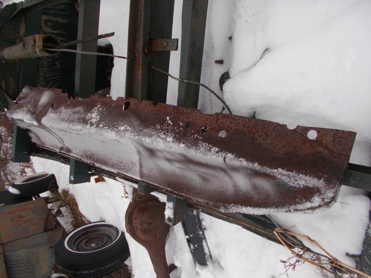

    Quick question.. Where do you get your rain gutters from.. Are they riveted on or welded?

    '30-'31 coupes are steel U channel , one piece...spot welded to the skin...
    'sedans are 2 pce. and nail into the header wood through the holes in the steel roof panel...
    if you buy coupe you can get straight or pre-curved... never done a sedan that needed them...
    buddy uses 1/2"x 1/2" steel tube [the stuff with rounded corners] bends it to flow along with any body
    [10 or so so far]...
    really adds strength, looks great, needs a few holes to rosette weld on from the inside, behind the wood...
