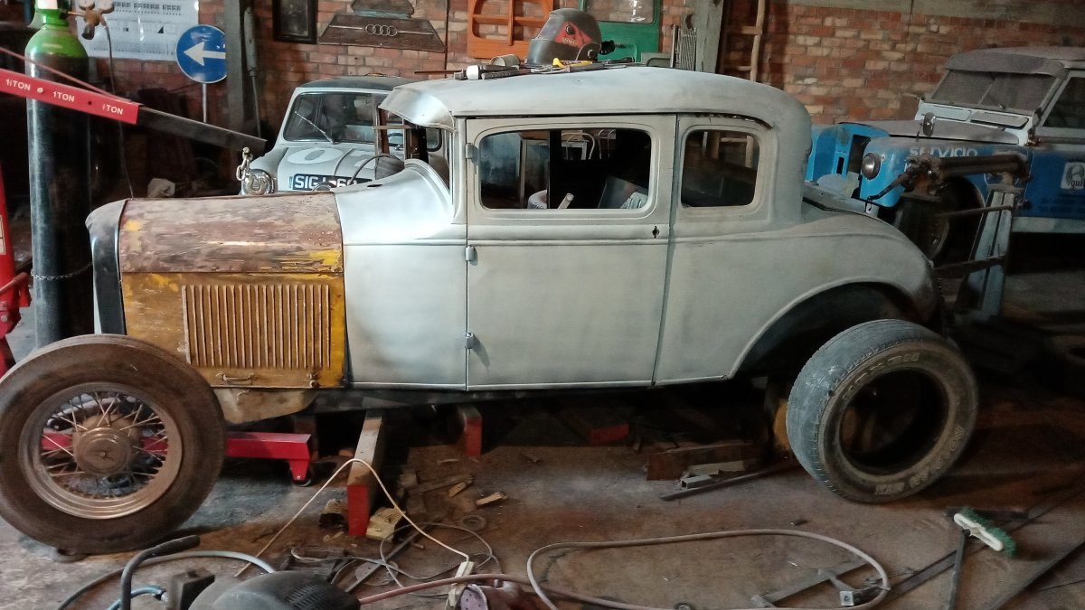

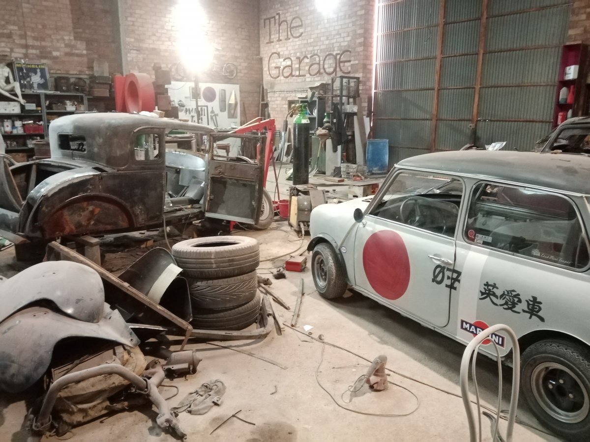

    Evening!.. The grill cowl arrived from the states.. So time to properly position the motor.. I was worried about having the horrible "long nose" look.. But also don't want to hide too much of the engine inside the bodywork. One of the tricks has been to flip.. Widen and move back the second ch***is crossmember.. Which has meant I can lower the gearbox a decent amount.. And thus the engine a bit.. I moved the engine about 5cm backinto the body and will have to entend the radiator support another 5cm (2 inches).forwards..the client wants to keep the original fan and water pump set up for the caddy v8.. Which is long.. Here's a couple of pix. I'll be working on reinforcing the wooden framework ready for floors etc tomorrow. What do people use for floorboarding over there?.. Pine or oak? IMG_20210220_230842.jpg IMG_20210220_122847.jpg

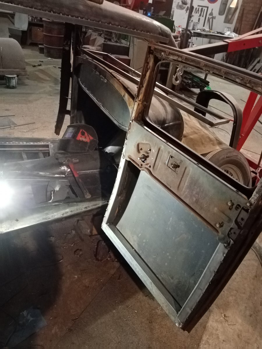

    Oak, Ash, or Maple subrails... plywood floors... was the way...
    I would use steel rectangular tubing and weld / rivet the a+b pillars and braces to them...
    IMO... don't spare the steel channel shaped verticals, they help support the body to frame's rigidity...
    x braces under the rear window and maybe a shallow X just ahead of the lower panel...
    oh, and i like the way the body is looking.... and from a fordor at that...

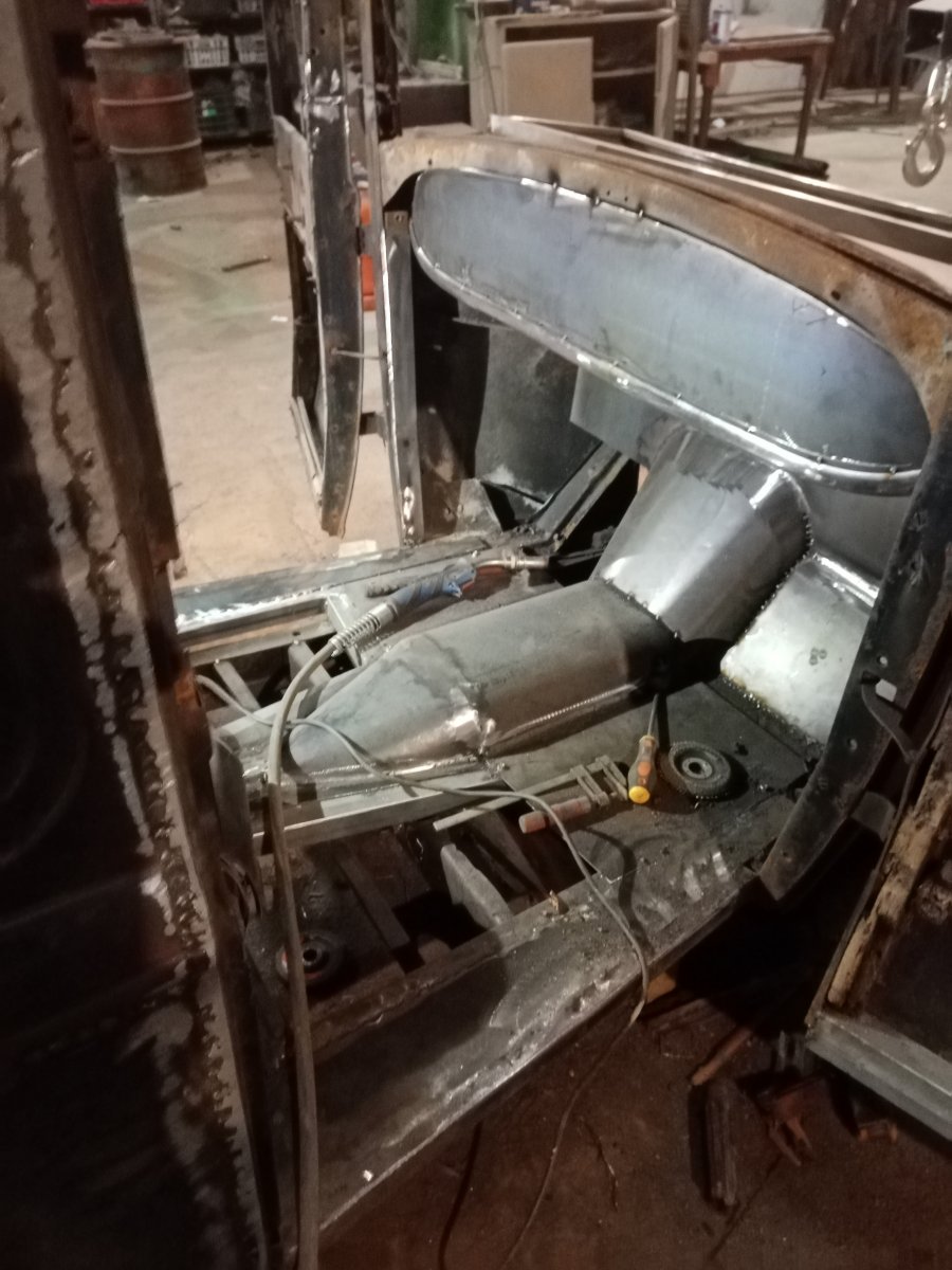

    .. Fuel tank is in.. Fits tight.. Don't know what car it came from.. B pillars reinforced.. A pillars on the way. Tunnel mostly sorted.. Drip rails on.. Rumble seat sorted out.. Rear firewall panel sorted and recessed front wall.. I need the client to bring the seat in to locate the ideal position fit handbrake and pedals.. I've been enjoying it.. I like this part of the process.. It seems more creative. Here's the pix IMG_20210320_111722.jpg IMG_20210320_164331.jpg IMG_20210320_174445.jpg IMG_20210320_164413.jpg

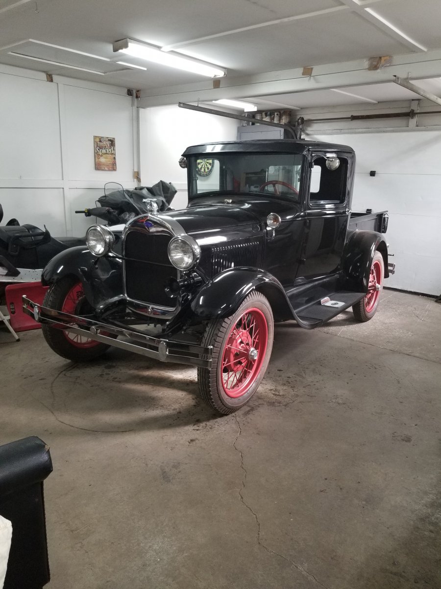

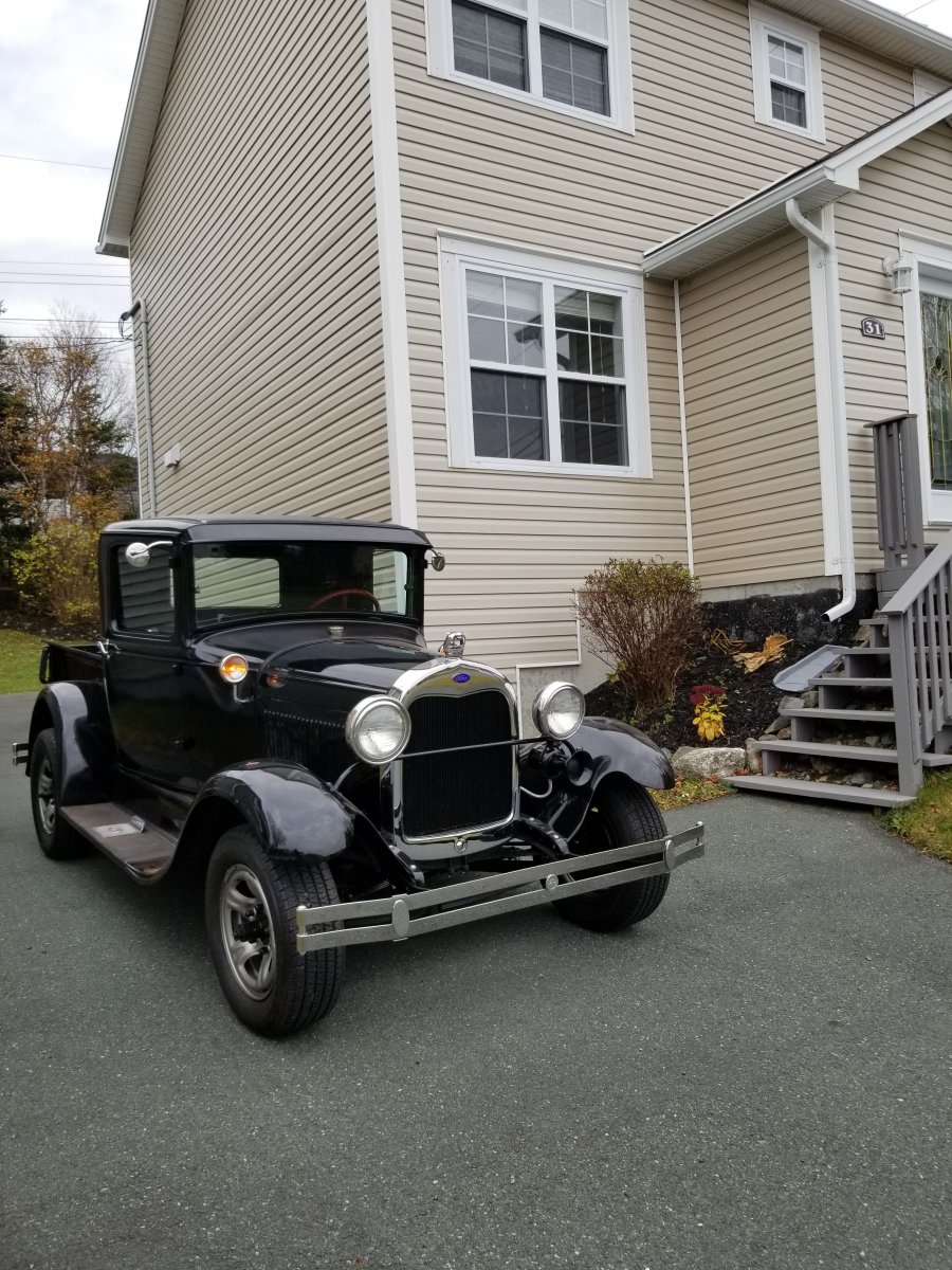

    been following your build, excellent workmanship. I built a pickup from a 29 Murray Fordor .
  8. sloppy jalopies
    Joined: Jun 29, 2015
    Posts: 5,256
    sloppy jalopies
    truck looks to be of Canadian manufacture... go pp go !

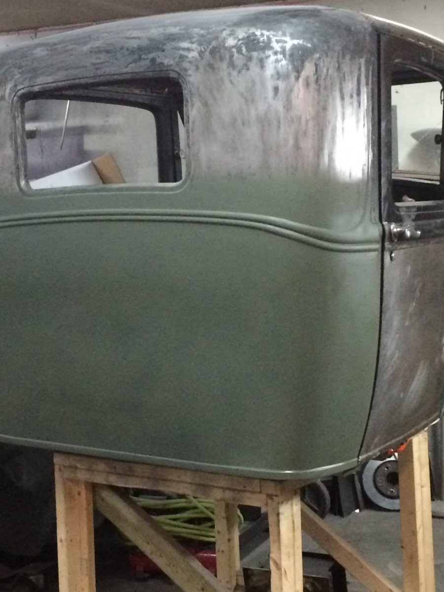

    I like the chop, how tall are the window openings now? Bob

    I took 8cm out.. As I remember.. I'll measure it when I get back to the workshop

    27cm inside the front window opening.. Nearly 11 inches in your money remember the frames are arched on this IMG_20210324_120434.jpg

    Seeing your mock up i notice that your grill and lights will mount forward of the front crossmember by about 4".
    prop some wheels where they will be to see if you like it...
    around here some guys will run a cheaper S10 frame, but unless you move the engine back it forces the grill and light too far forward of the wheels...
    a local '29 Es*** might be the prime example that we have seen around here....
    looked like a doeberman with its ears taped back...
    i am guilty of running a pinto front end, the rack bolts force the grill to be a few inches too far forward... pic...
    makes my coupe look a little nosy...
    i would change it "today" if it weren't so much work...
    if it bothers you, now is the time...

    Yep I know sloppy it my biggest worry actually.. I want the car to look squat and compact. Actually the 27 hood fits perfectly but as I remember my 27 had a narrower cowl which would explain why it fits.. The axle set up is ordered and should arrive in a month or so.. I can't push the engine any further back without it also looking dead weird.. It'll be a case of bending the rules but not breaking them I hope

    Mock up.. Pretty nosey.. But I reckon it still seems more or less trad!?? I think the grill needs to come down a smidge! IMG_20210324_170223.jpg IMG_20210324_170235.jpg IMG_20210324_170250.jpg

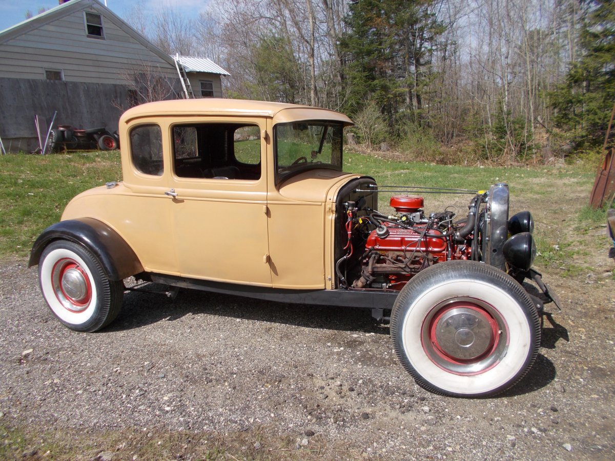

    You have the reverse of this car, you have a 28-29 Fordor cowl and normal hood, note the bead in the hood tops that mate to the cowl bead. Bob

    doesn't look nosey... the grill seems to sit over the crossmember, that's good !

    The cowl feels a little long, but not hating the car at all. Still putting fenders on it? Its really come a long ways, your're making great progress on it

    The 1928 - 1929 Fordor/Cabriolet cowl is the longest cowl in all of the Model A's. Just checked one of my doors and if I cut 3 1/2 inches out the windows will look the same.

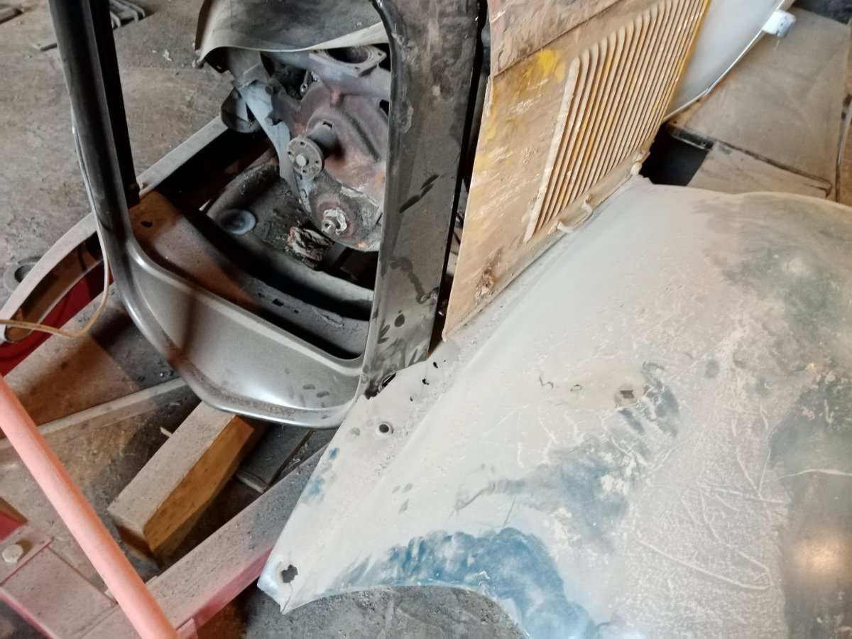

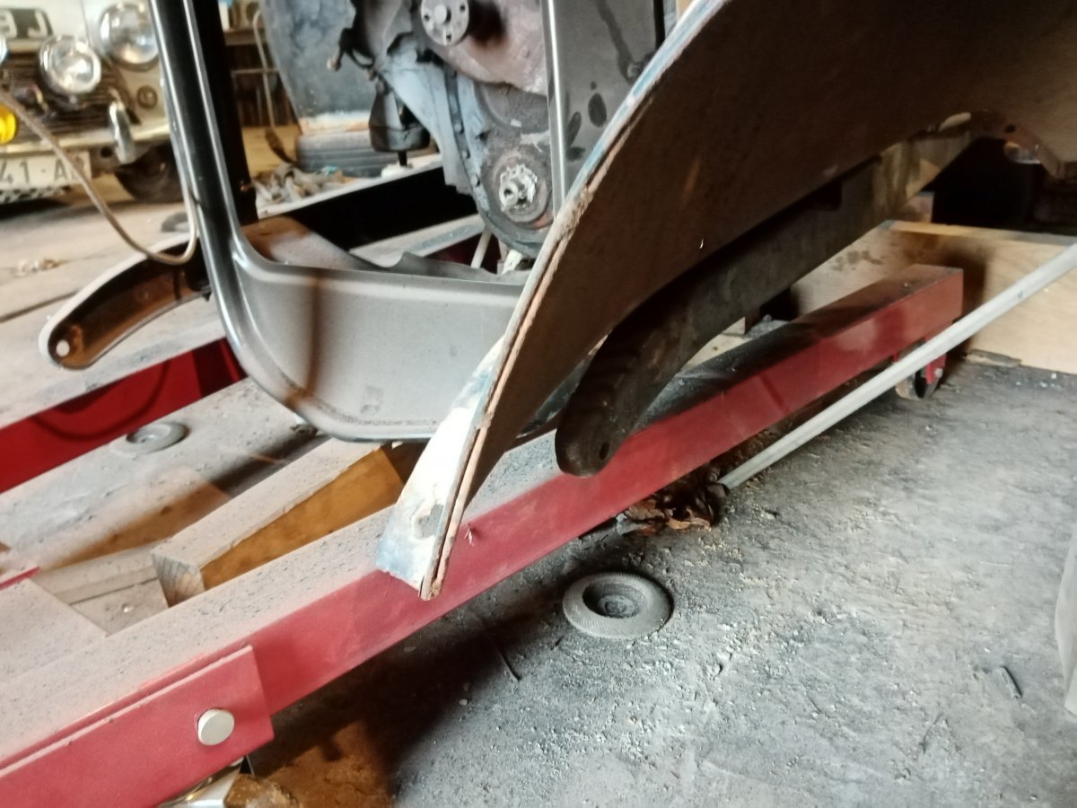

    OK I need some help from you guys please as I'm flying blind here.. The fender kit that was bought was not from this exact car also its quite bashed up.. So I'm trying to figure out how it should sit.. The rear seems straightforward.. But the front seems way too long. Bearing in mind its all set higher up towards the body.. Give me some clues please. What should line up with what...? IMG_20210326_094457.jpg IMG_20210326_094422.jpg IMG_20210326_094438.jpg IMG_20210326_094432.jpg
