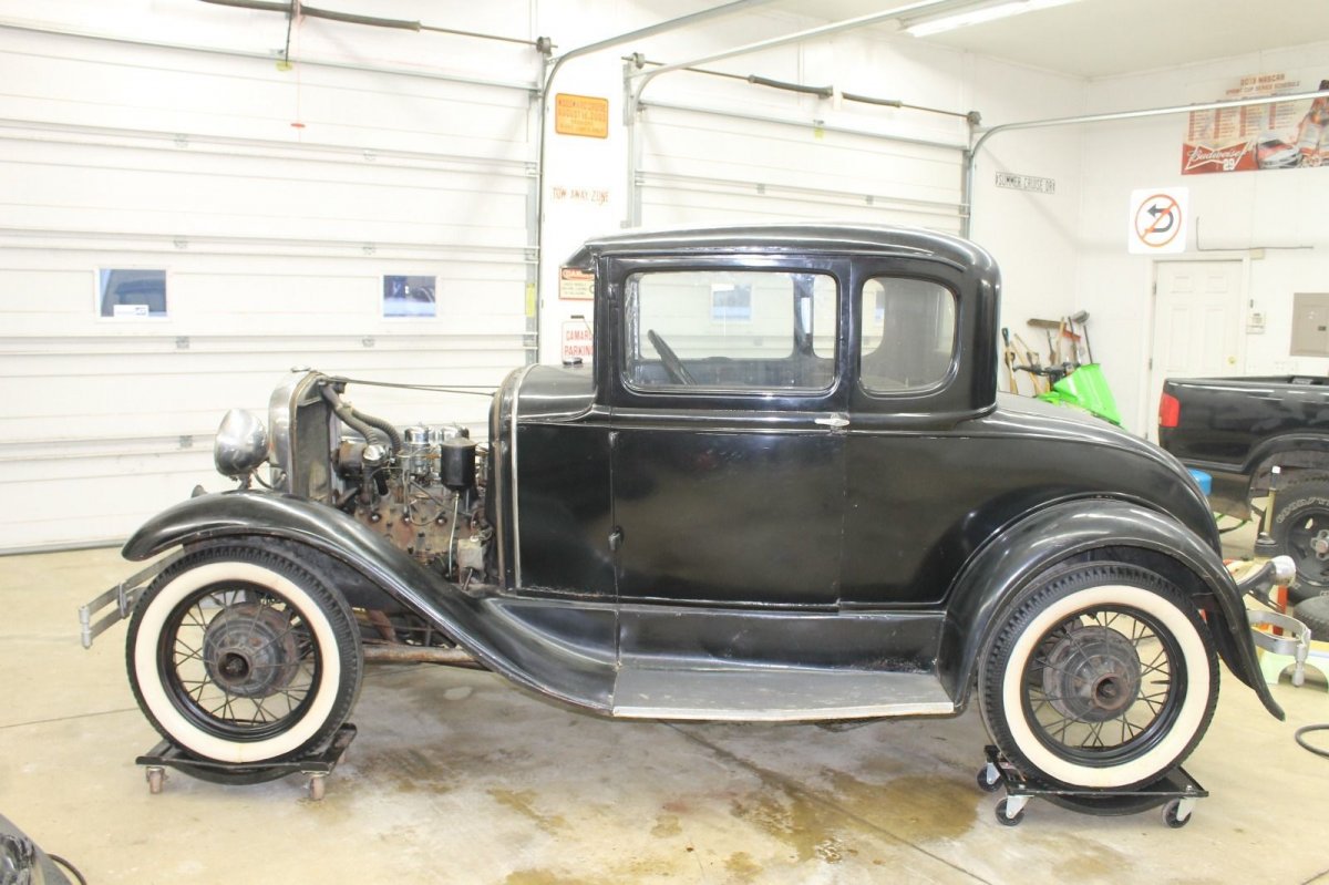

    30Coupe.gif Here is a pic of my My A 2.jpg 30 coupe. Not sure if that will help at all. You have created a whole different animal.

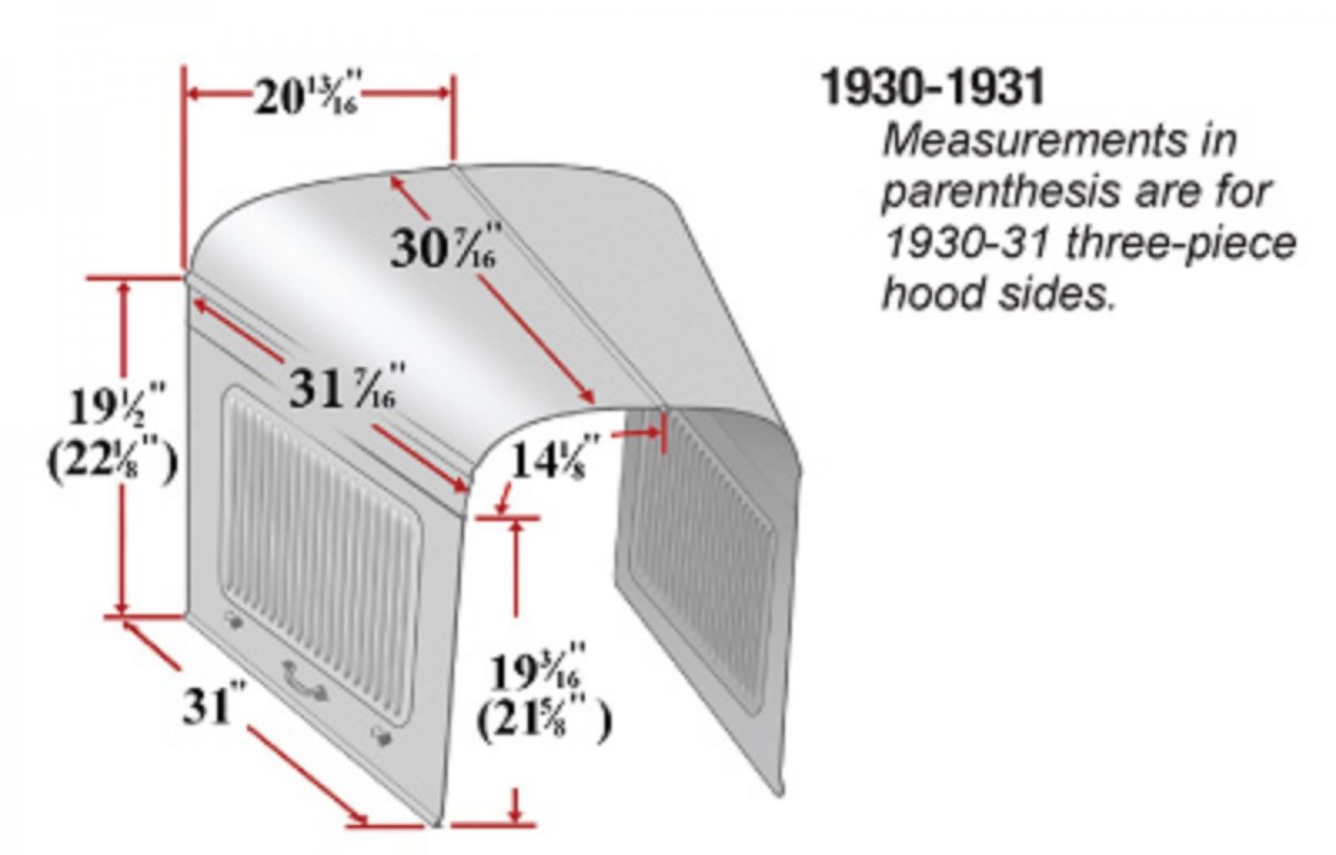

    Do not use the measurements from the top posting, i have that book...
    grab your tape measure and check it out...
    coupe doors are 27.5" at the beltline...the book says 26 7/8" at the top... the doors taper from the top down, no way the book is right !
    book is dated 1963 so no chinese tape measures involved...

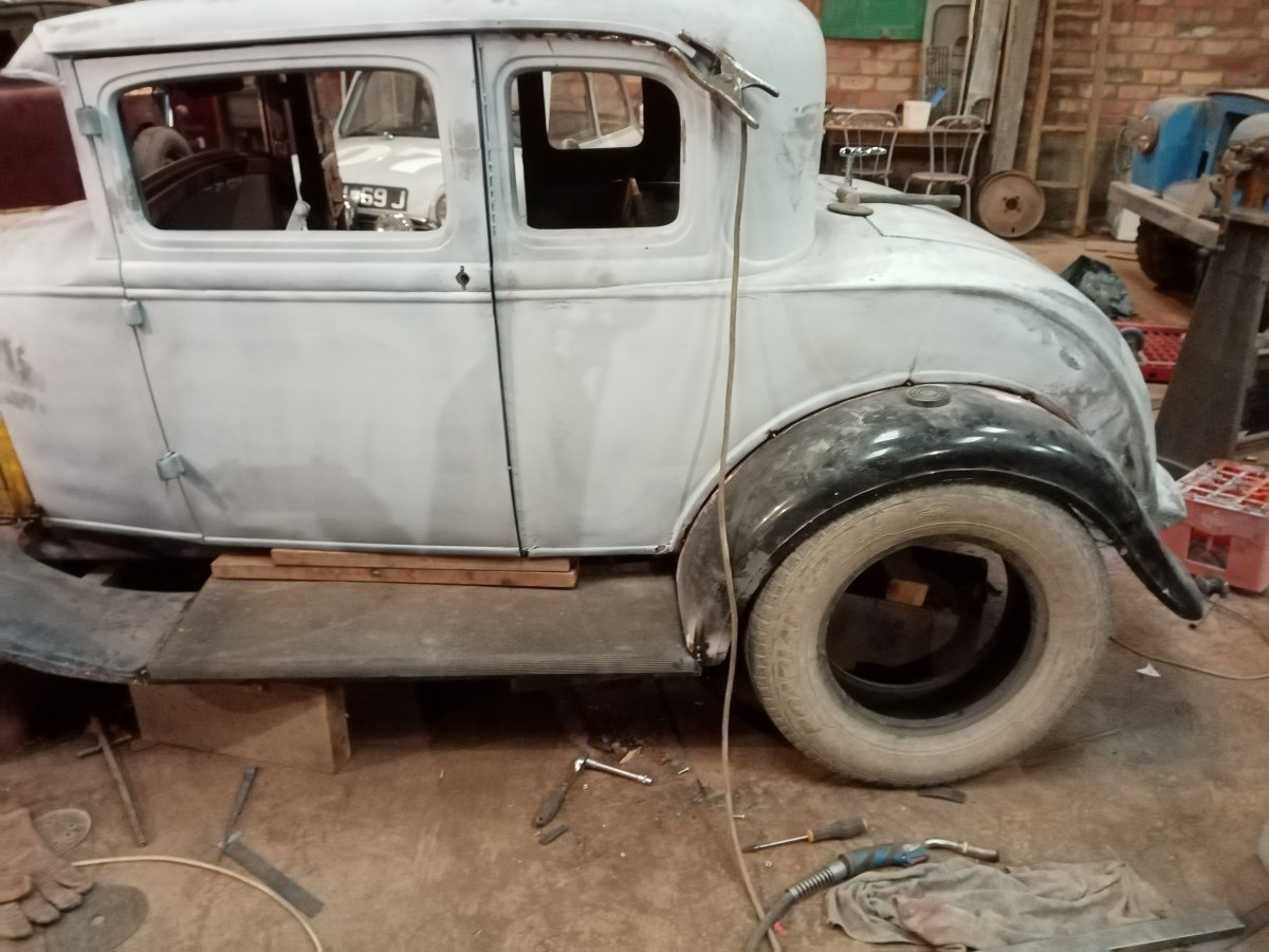

    And therein lies the can of worms!!
    Fenders are all wrong running boards also and rear fenders have been cut down by previous owner!.. (which he didn't mention).. I've spotted a temporary belt line on the mockup hood.. Lowered the grill an inch and cut the rear of the front fenders by about 4 inches.. Now its starting to look less hideous. The wire wheels weren't working either.. See what you all think now... IMG_20210326_165344.jpg IMG_20210326_165328.jpg IMG_20210326_165220.jpg

    Youre on it! Id take another inch out of that fender, so that the fender and door are on the same line, then proceed as needed. Youre doing an amazing job of making junk look cool!
    On the rear fenders, what if you rotated it up a bit, so the end of the fender is in about the 3 or 4 oclock position instead of the 5 its at now? Might help eliminate some of the shortness they have going on now.

    I am not a '32 guy,
    but ask some here on the hamb...
    your running board attaches to the splash totally different...[looks to bolt under the frame ?]
    looks to me like '32ish boards, no trim plate along the outside like As...
    the fender has the splash apron curve under the cowl... so it isn't a longer '32 fender...
    the trailing edge of the fender/forward running board should align with the A pillar door jam...
    the arch on '28-'29 fenders is a tighter radius than '30s...could be pulled back a little and look right...
    without splash aprons you could trim the trailing edge curve to match your frame...
    your work shows that you can pull it off...
    keep 'em coming !

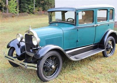

    OIP.jpg Too late to restore the Fordor, but this is how the 28-29 front fenders look. ;)
    loudbang and sigfurniture like this.

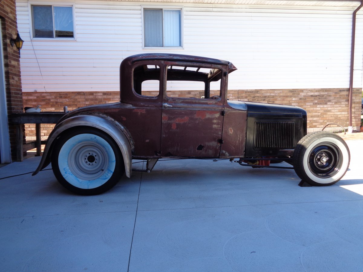

    The 30 coupe in my avatar when completed will have the front fenders narrowed 3", have a 3" splash apron, shaped like a rocker panel following the body curvature, narrowed running boards and the rear fenders will be moved in 3", as the wheel wells are tubbed with a narrowed rear axle.

    Sorted.. 4 cm taken out of rear of running boards which makes everything line up.. And rear fender turned anticlockwise a few degrees to give me 3 inch drop from running boards to body IMG_20210327_102701.jpg

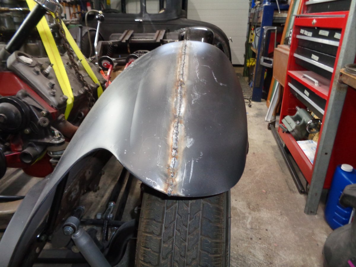

    That's great progress! If you did follow the Bad Chad example there are a few things I would do differently. If the length of pipe is cut in half before bending you will have enough material for both sides. Also, a little more finesse could be used to get the correct contour.
    Another thought was concerning the front fender width. I learned from experience that after cutting a 3" strip out of the fenders it was very easy to fit them back together for welding but be aware that after tacking them together starting from the front to the rear, the length of both pieces will not match up evenly at the running board. Not a big deal.
    I have also done something differently that I think is a little unique. I can remove the front fender, running board and rear fender all in one piece (with the help of a friend) and run the car fenderless. I did this by mounting the rear fenders with the bolts facing vertically into the top of the wheel wells. The holes in the wheel wells are elongated for in-out adjustment. Tailights are mounted on the rear panel instead of the fenders and the headlights are mounted on stands. There are a few other mounting considerations but was just a few things done to have the ability to achieve a completely different look.

    That's a great idea about the vertical holes.. My client is a bit special.. I doubt that he'll have the fenders off.. (apart from the fact that it's totally illegal over here). But I'm a fan of quick on /off conversions.. The same for my Morris 14
    Regarding the fender width I'm pretty sure he'll go for wide meat rather than skinny.. Again he's that type of guy.. Get your thread going mate I'm sure loads of guys would be interested
