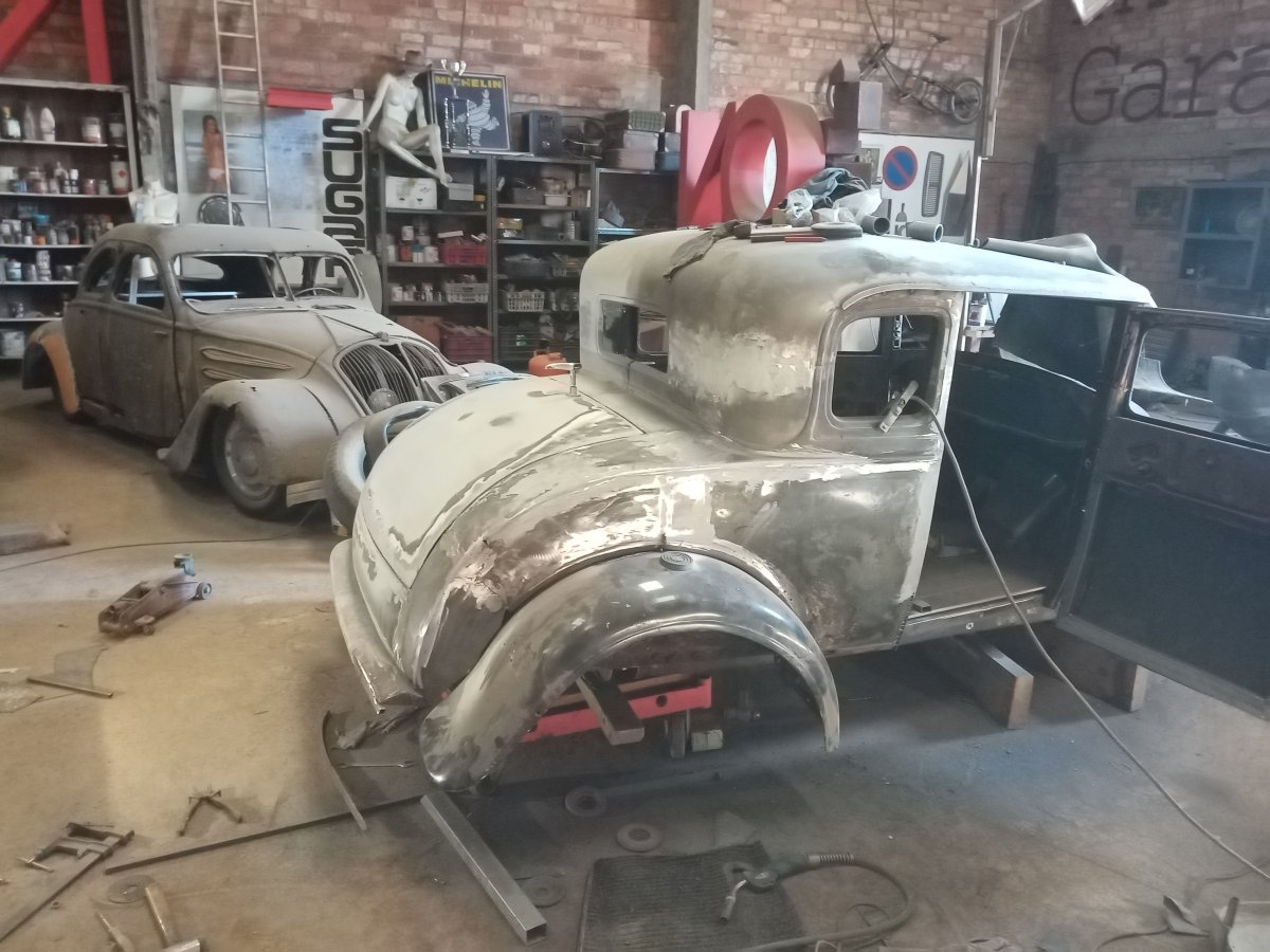

    Hey ho.. Back on the cars after furniture and sculpture jobs.. Actually quite missed it so started welding up the rear of the b-side.. And tidying everything up.. Also now it's moved slightly so I get to see what it looks like with the wings on from the rear.. I like it looks like a moustache a bit.... IMG_20210518_194820.jpg IMG_20210518_182929.jpg

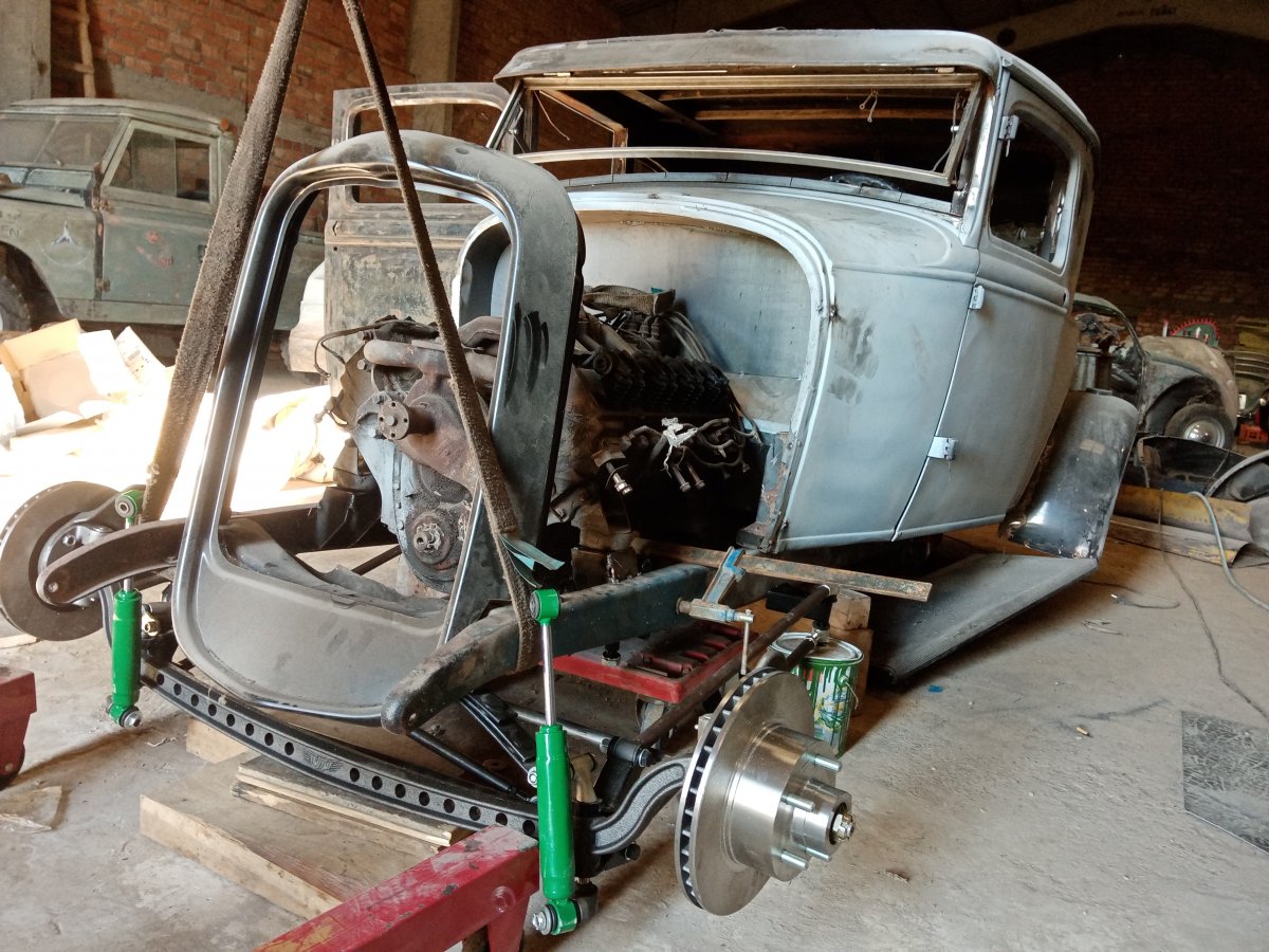

    Front axle kit arrived.. Well most of it.. For no apparent reason we're missing the inner disc bearings.. The pitman arm.. And some other stuff.. They sent the wishbone rear adapter instead of the 4 bar setup one.. A little bit frustrating.. But at least I can tie down the exact position of the wheels to set up the front wings etc.. And it's nice to see the nose taking shape.. IMG_20210528_183848.jpg

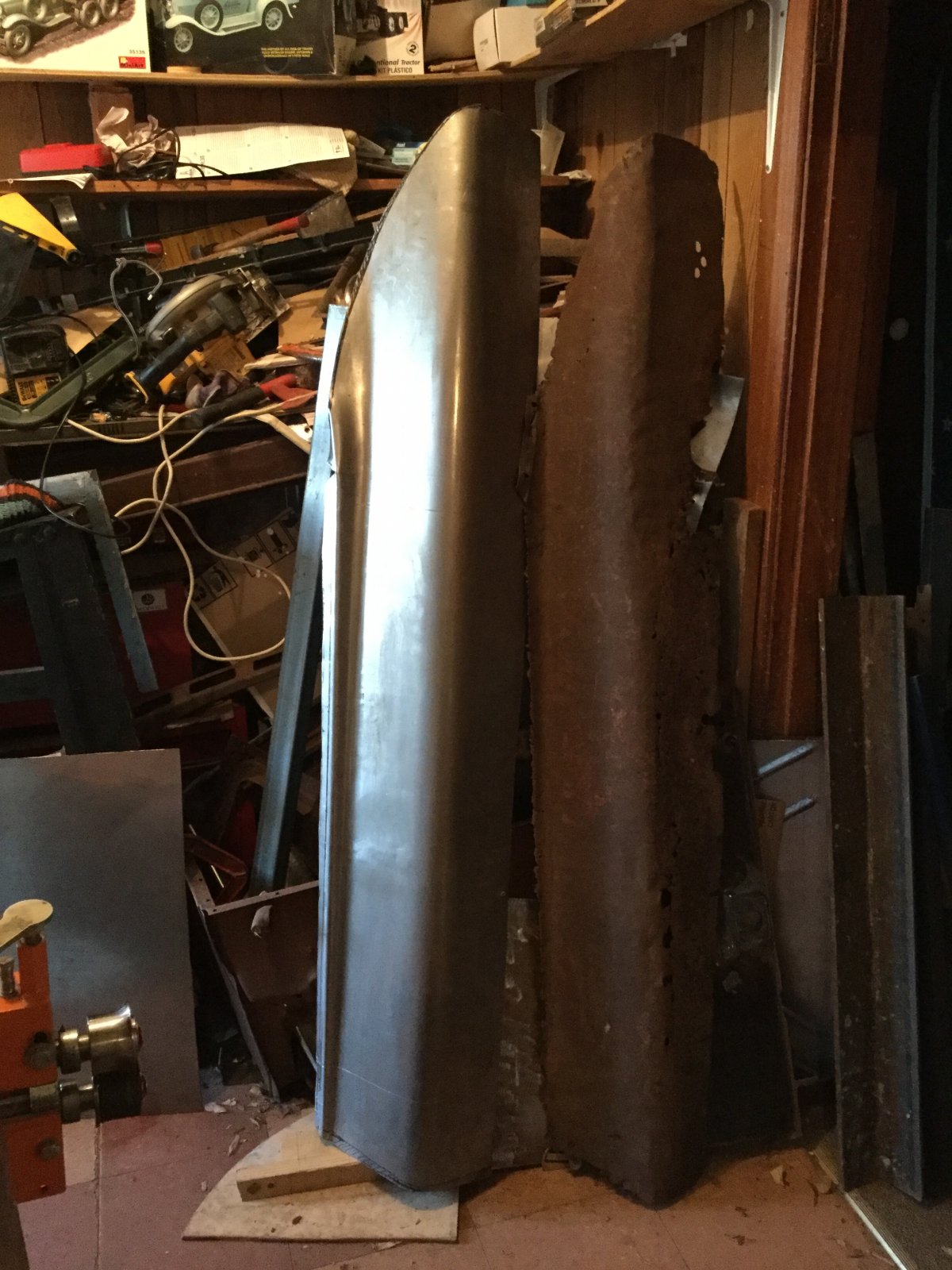

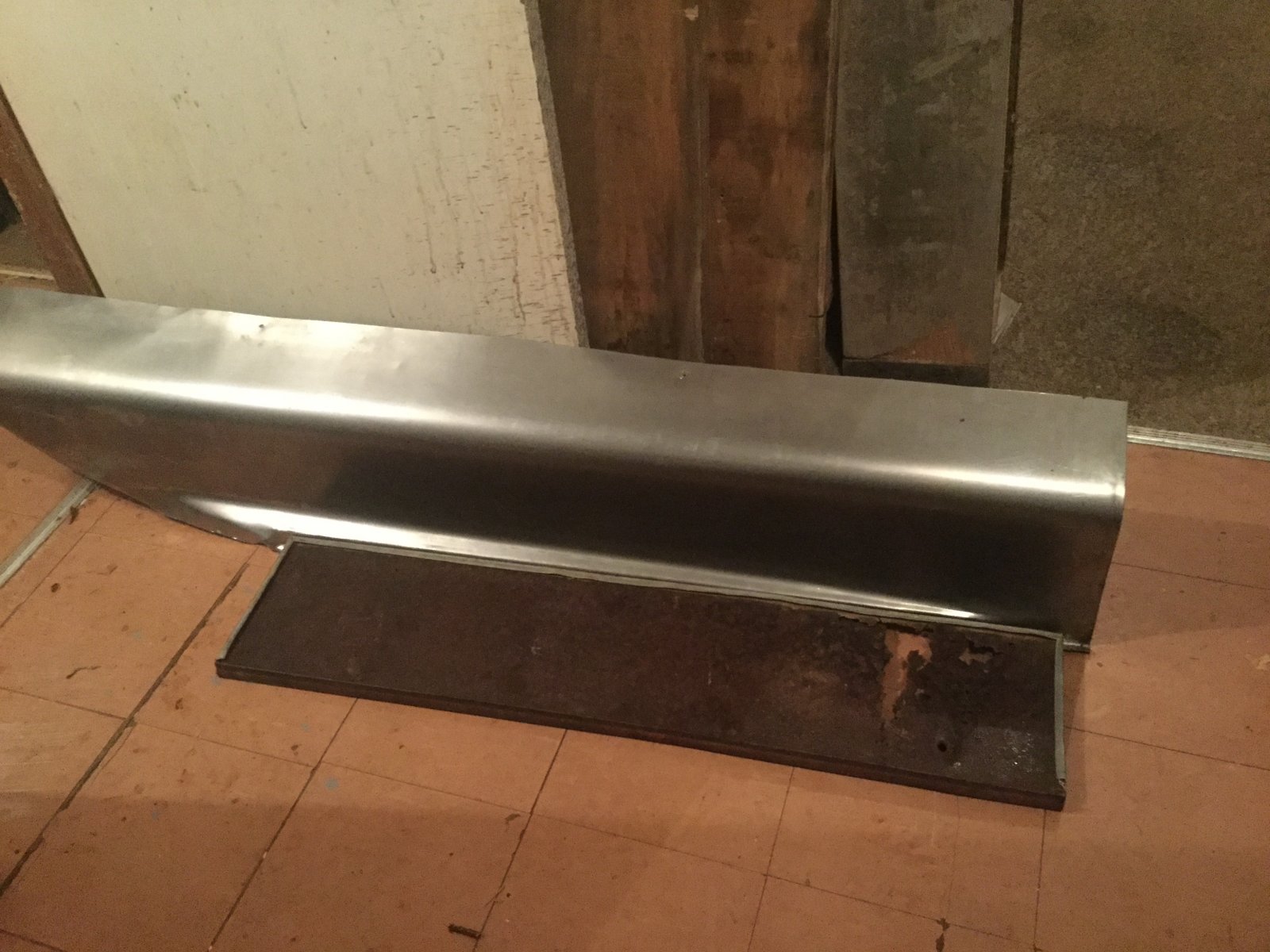

    I notice you have been having trouble with working out the depth of the splash aprons. The easiest thing to do would be to get some cardboard and trace it around a stock Model A valance panel and cut it out. This would give you a pattern from which you would be able to transfer onto a sheet of metal.
    You would then trace the pattern around the metal and cut it out. This is one I made up for my model A tourer a couple of years ago.
    The bending process is surprisingly easy. You build a wooden box out if heavy duty timber the length of the valance panel and you then get a length of thick walled pipe the same length. You position the sheetmetal directly over the box and push the pipe down onto the sheet metal forcing the sheetmetal inside of the box.
    The pipe gives you the desired contour and the box keeps the sides balanced.
    3C616A7A-0F42-4031-B6A0-2206776610B1.jpeg 00129572-FF60-43A0-B4E2-78DCF71EB85F.jpeg
