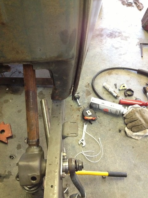

  1. Setting up my front end on my first build and need help with turning angles.
    As you can see, with everything set up as in the photo, the steering angle would be 24 degrees. Is there a number I should be looking for? Seems like it should be more.
    The only possible solutions I can see are a longer steering arm? Bend the drag link for clearance? Or, "don't worry it's fine"
    Input please. Thanks!

    No, it won't change much.
    Your pic shows what is wrong. Your pitman arm is way out too far, to clear the split bone. If you bring the arm straight down, you then need to move the bone inwards.
    I study every old build to see how they fixed the angle problems back when.
    I have 2 original 50's built chassis here and both have the bone mount different than todays typical build. They welded the rear bone mount "tapered bung" into the bracket, backwards. Then the tie rod end on the rear of the bone, comes into that mount plate from the backside, so the bone gets moved under the frame. Some cars also ran that main plate on the inside of the frame rail, not the outside, that gains more room.
    Some old builds had a slight bent halfway back on each bone, to gain more turning radius.
    Living with a car that won't turn enough, is not fun at all. You will hate parking at a show, or getting into some tight places.

  8. Move the bone to the inside of the frame and move the arm in as far as it will go and you will be fine. On my touring the tire rubbed the draglink at full lock but that was in the tightest of conditions and seldom an issue.

    Good Eye F&J and as always some good and solid suggestions.
    Crminal I think they pretty well nailed it. You need to bring the bones in and then bring the steering arm in to get the drag link in away from the tire.

    The stock 32 and 33/34 pitman arms have the ball on the inside, effectively under the frame rail. your bones are well outside the rail, the pitman arm is cranked to clear it, and the drag link is outside of the pitman arm. You have relatively wide tyres on 15" rims with not much offset.
    Every one of these things reduces your steering angle on full lock. Whichever of these you can change will improve the lock angle.
    As said above, I would try and get the bones as far inboard as possible, fit a straight pitman arm with he ball locates frame side and the drag link the other way to what you have now. That will probably be enough to make things acceptable.
    Mart.
  11. F&J, thanks for taking the time to help. I did bend the arm to clear the bones. Perhaps should have left the arm, did no know it was okay to move the bone so far inboard. I'll go play with that now.

    ^ this bit of info is often either forgotten, or we never had the stock pieces to know the original location of the pitman "ball".
    No matter what you do with the common Ford parts we use, the draglink will just about touch the tire on full lock to the left.
    That is because Ford used a straight draglink
    Mopar, for example, used a S bend in 2 directions on their forged drag link. The front inward bend, keeps it away from the tire. the other bend keeps the link from hitting anything on the front end, during full left, and on uneven terrain.

  13. Okay, played with it a bit using your suggestions. Reheated and straightened the arm, took out 1 1/4" of bend.
    Using Marts idea, mocked up the tie rod end to the inside.
    As others suggested, moved the bones inward.
    Now I have increased the travel to 30 degrees, thusly getting into better territory.
    It is obvious now that the drag link should not be parallel to the frame as it was before. Needs to start inboard near the frame, then out to the tire.
    Before ImageUploadedByH.A.M.B.1376680284.645269.jpg after ImageUploadedByH.A.M.B.1376680414.501002.jpg
    But look where the ends of the bones are! ImageUploadedByH.A.M.B.1376680474.578856.jpg
    Do I make a structure underneath to mount the ends like F&J referred to?
    Am I on the right track? Also what about a longer steering arm?
    Thanks everyone!
    (My first build)

    Yeah, good work.
    I just found this shot of my 33 setup.
    You can see the drag link mounted inboard of the pitman arm.
    Mart.

    One more thing to add. If at all possible, see if you can get the front drag ling joint underneath the steering arm on the spindle. This will keep the angularity of the drag link down, and help prevent erratic steering. I reworked mine below and it helped a lot.
    Here's a pic:
    Mart.

    You are getting closer, but in pic #2, it looks like the pitman can go inwards more. Rule of thumb; if you move one end of the drag link in 1/2", you gain 1/4" at the tire rub spot on full left. 1/4" sounds silly, but it gains a lot in radius.
    What I can't see in your pic, is if you do bring the pitman in to it's maximum point, will it hit the bone at some point of articulation/car roll, etc? You need to work all the goals AND consequences together, before deciding a compromise on one of your goals.
    Compromise means; how far under can you run the bones, and if you do/don't like the look, when it is in deeper...as well as how much radius are you willing to lose, and how many mods are you willing to do.
    Your question on longer steering arm on spindle top. Yes, that will help, but that changes ratio. Yeesh!...it all needs to be figured in; Tire footprint size and where the imaginary scrub radius line is with your choice of wheel offset. Also the weight on the front, and the caster angle which changes steering effort. Also steering wheel diameter...it does not end :)
    If you decide to mess with ratios; I doubt you will run into this, but if a steering gearbox only is capable of moving the draglink X amount of inches with your final pitman arm length, make sure that your mock up with wheels off the ground, has a little extra travel left before the stops hit. That extra is needed when the car is at full weight, and sitting on the ground. If you planned it to barely hit the stops with no load, it won't even come close to the stops at full weight on the ground. That is due to flex of all the pieces together. Rare situation, mostly happens with a quick ratio box that has very few turns when disconnected.
  18. Yep, I get it F&J, thanks. Gonna mock it up with the bones inside the frame rails. Been playing around with mounts for them and I think it gonna work bitchen!
    I'm ready to tack my steering box in place and start removing variables.
    So, with the bones out of the way and the box in position it will be narrowed down to getting the arm nice and close.
    Flipping the tie rod end was huge.
    I feel like 30 degree turning will be respectable for this car.
