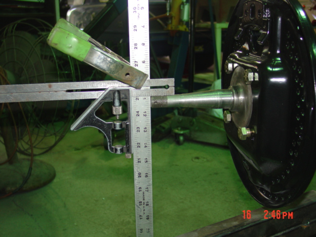

    Well, here you go. I mocked this model 'a' front end back up, the caster was 7degrees and I leveled an aluminum plate on the floor to measure to. My camera won't focus on closeups, but from right turn to left turn there is a 1/2" difference. Do to caster the spindle wants to go downhill, in real life it cannot because it is attached to the ground by the tire and that distance cannot change. What happens is the frame rises 1/2", you litterally raise the car when making a left hand turn.
    The first pic is the spindle at a normal right turn, the square is clamped. The 2nd pic is the spindle in a normal left turn and you can see the difference, its about a 1/2",

    I do not have bent parts, it is a simple demonstration. The axle really has nothing to do with it other than it holds the kingpin, I can cut the axle off just south of the perchpin and it will have no effect. The kingpin is inclined 7 degrees and that is what the spindle rotates around.

    Alchemy, I know you are an experienced guy, I can only assume you are misreading the nature of the thread and what I am illustrating. There is another current thread on the issue of caster and it's affect on being hard to steer. The thread is called something about 'positve caster'.
    Just to be clear, the spindle in the picture is the left spindle. The first picture is normal position for a right turn and then the same spindle aimed for a normal left turn. You are not looking at different ends of an axle, it is the same spindle in both pictures showing how is changes latitude as it goes thru its' right to left turn axis.
