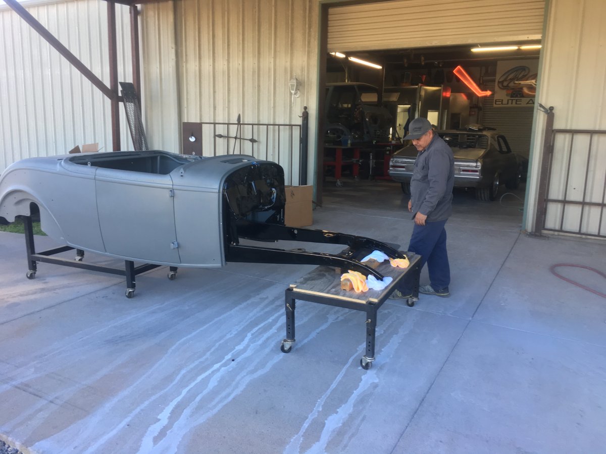

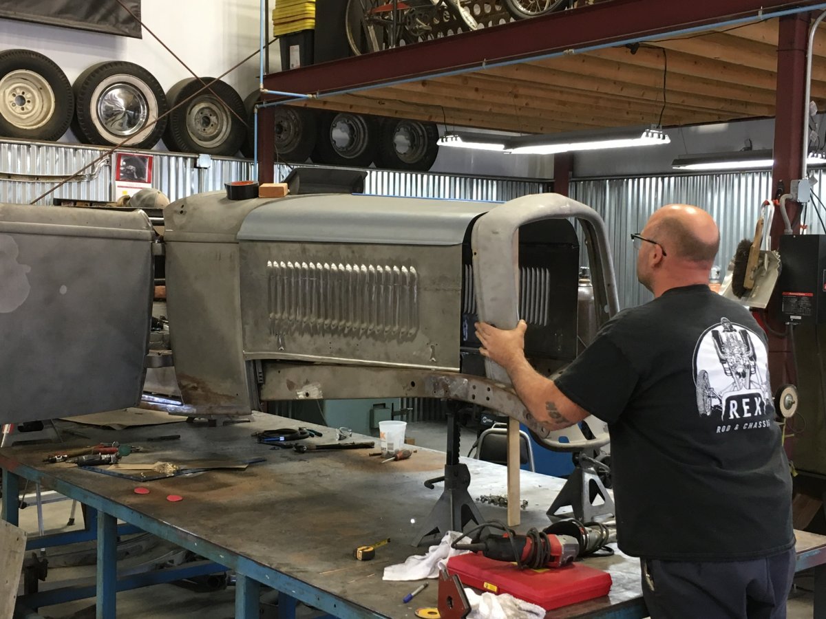

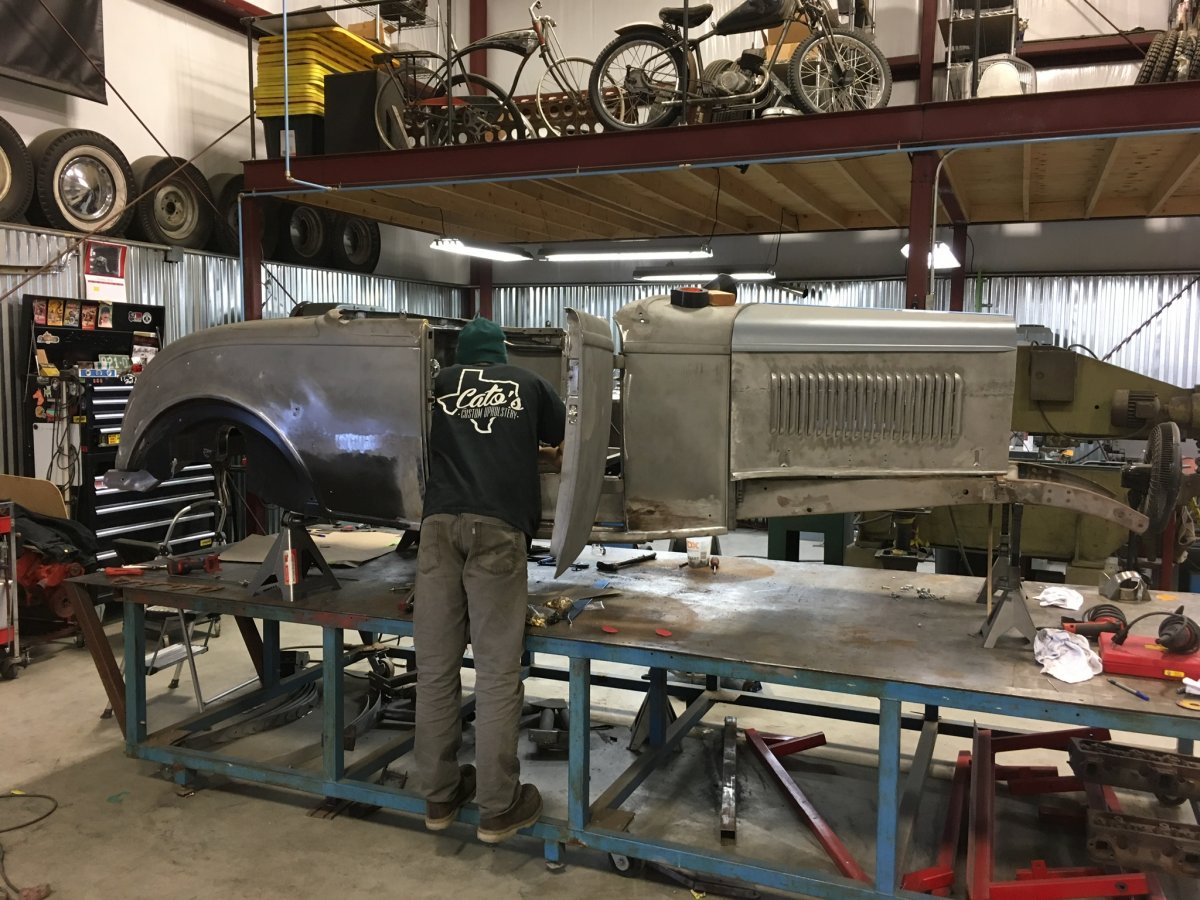

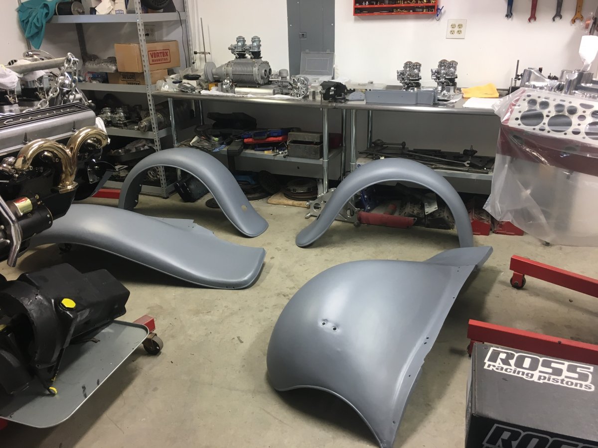

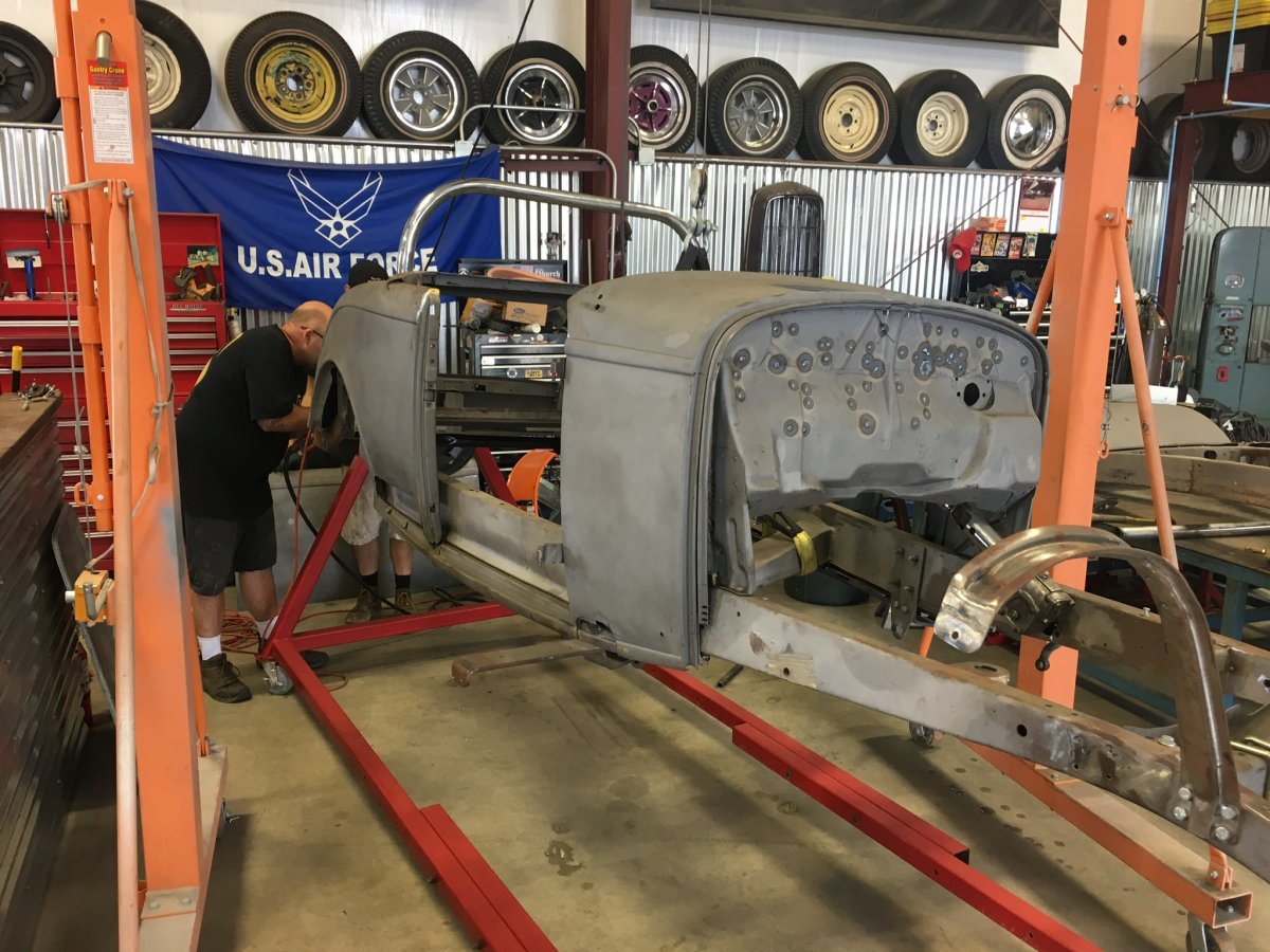

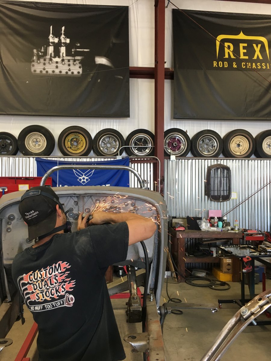

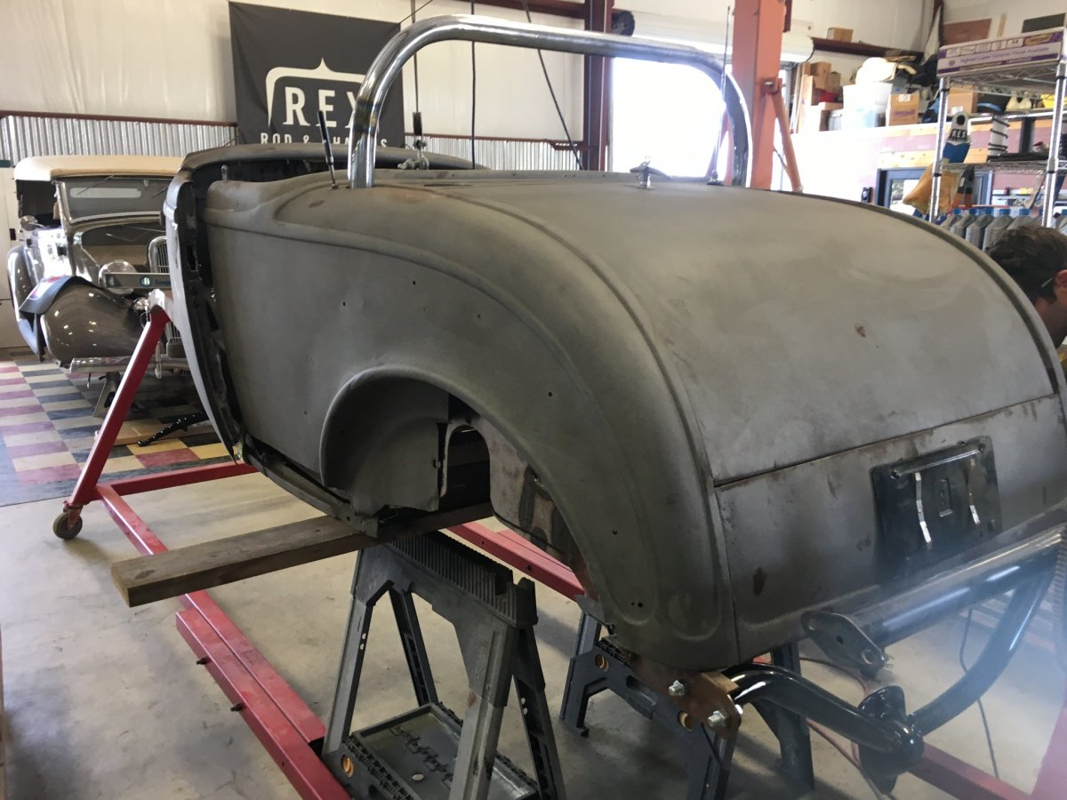

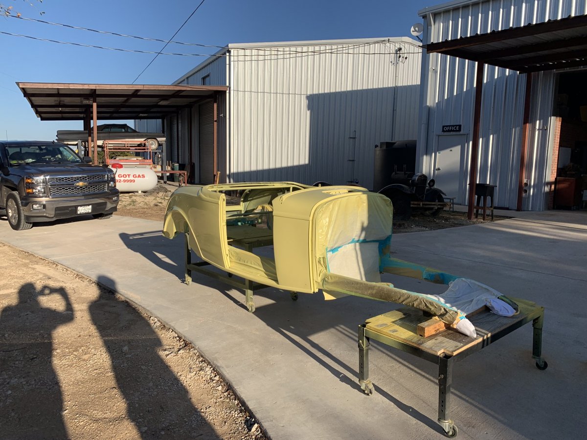

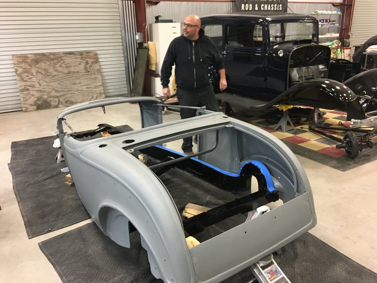

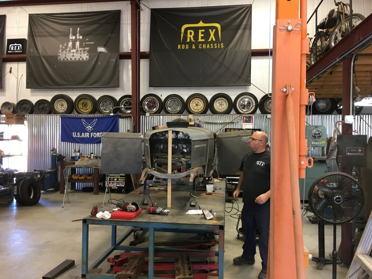

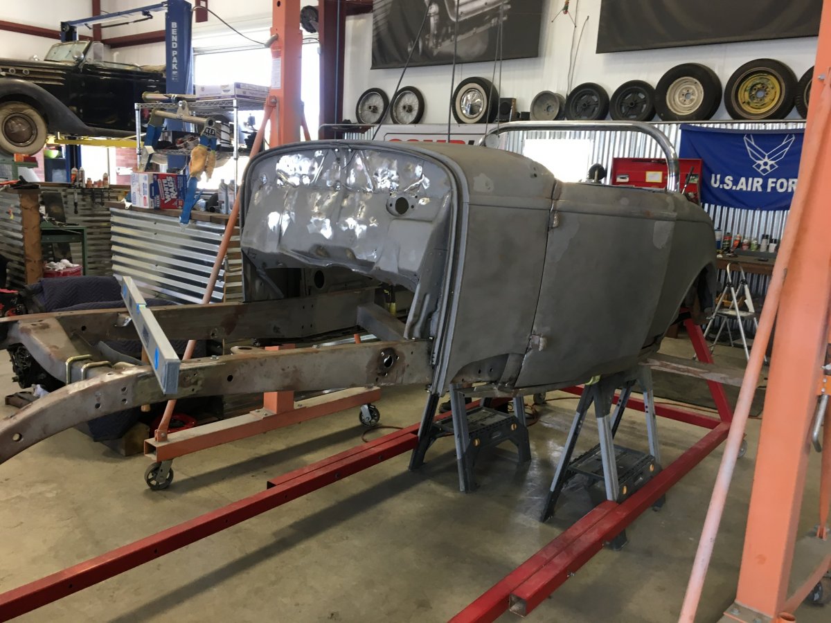

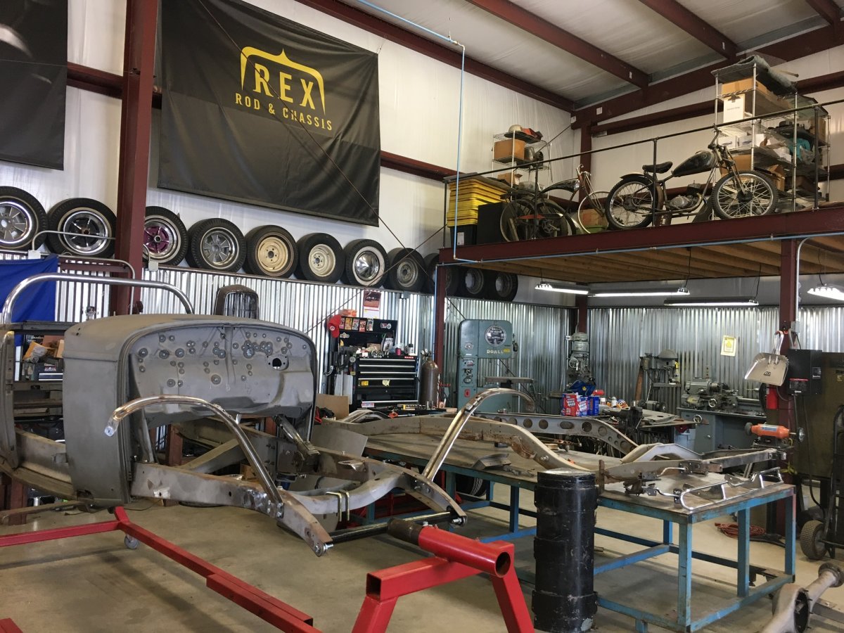

  4. 1C8E2A45-5E83-491B-BFB3-8641ADCF2A27.jpeg 6DC7CB7D-0EFF-493E-83AF-CD77530CB6B8.jpeg 0C3F261F-6810-4CD6-8CEF-B98E9EAC4CDB.jpeg BA935875-6803-4485-9DC4-C744FE517FD5.jpeg DFE14035-1E3D-469C-85B6-39BE25792D1D.jpeg 48323AB7-5A3C-4816-8500-8E30FA9FABAE.jpeg E9CBB5DD-7BB5-408C-8EAE-8598817920D4.jpeg Some progress has been made.

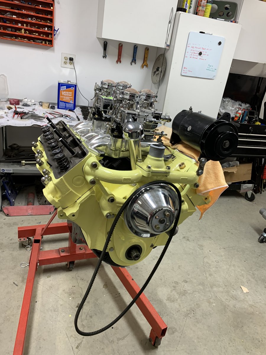

  5. Liking the progress so far - dig the 4 deuce intake with polished carbs!

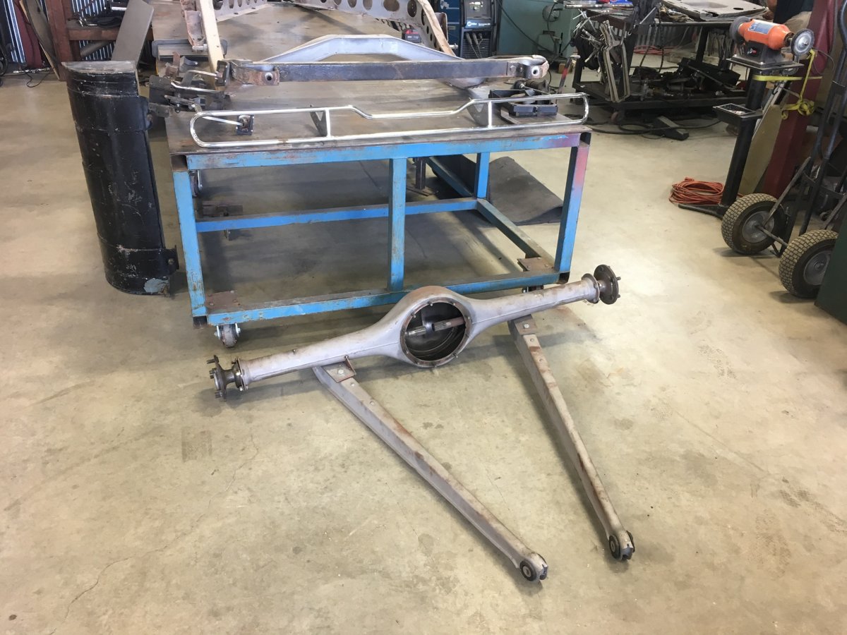

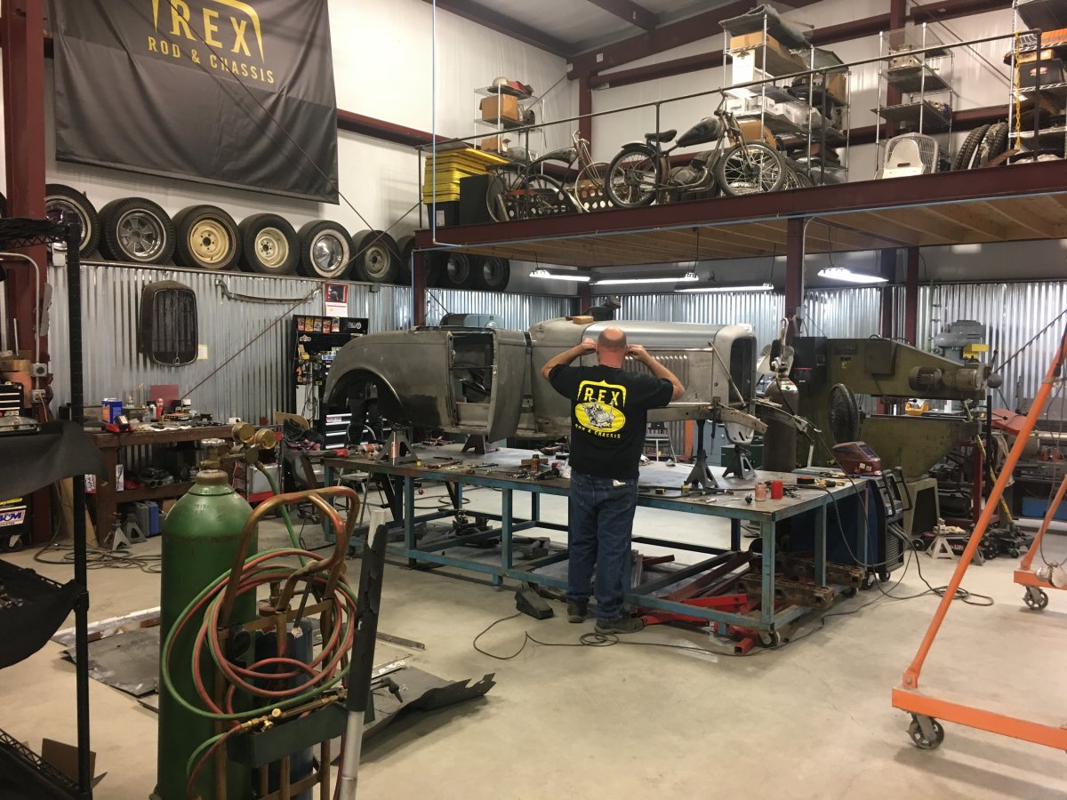

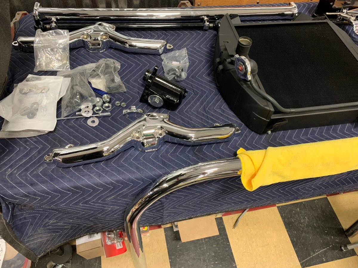

  7. Kieth, Jeff, and Rudy are the most awesome men. Heart and soul hot rodders. 42C2A242-9732-4979-992B-43C94B0779DF.jpeg C8CB4193-869B-4713-BAC1-ED74C8C5F3FF.jpeg B099DED8-D933-425A-BB02-B681C5DA8BF3.jpeg 5B425661-92AA-46D6-A4D8-D6A5EEAF9A19.jpeg BB13E817-845A-4069-9DE2-00CE53439D41.jpeg A086D4DB-A0CA-4F11-8566-CAADAB0162C8.jpeg 374AAE4A-4396-4475-9C29-9A414E1992D6.jpeg 64C779A1-F788-4DBE-9560-3FE9F1624113.jpeg 8E244321-3BAC-4375-8B9A-ECFEA897AAB3.jpeg B6F12594-F60B-43A0-8CBD-7103F75E0125.jpeg 96A53877-8C63-445C-97D3-58A859810282.jpeg E37DF516-6943-44F8-89B2-F283ECFF7020.jpeg 57A0B8BD-2C9D-4754-8102-DDA32E9F1515.jpeg 813F6A3A-EFE7-4CA1-83C6-65FC6F782E25.jpeg 4AB747AD-FBEE-432C-BB0E-055DFD1CE94D.jpeg

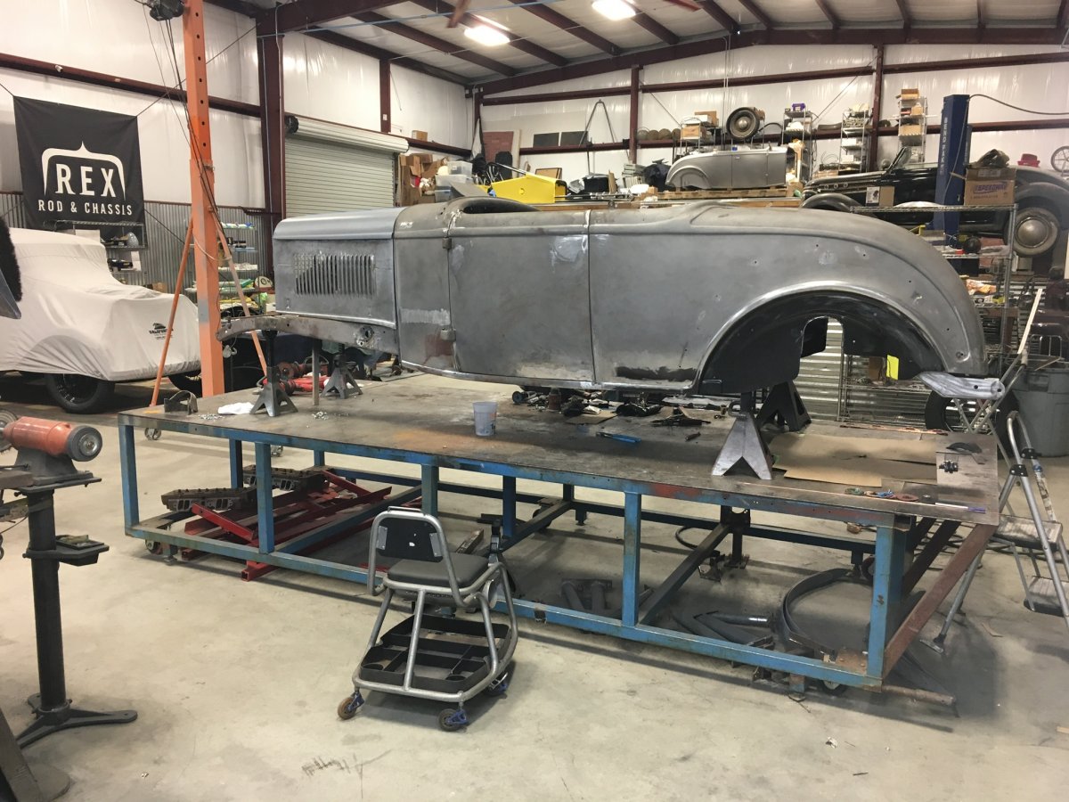

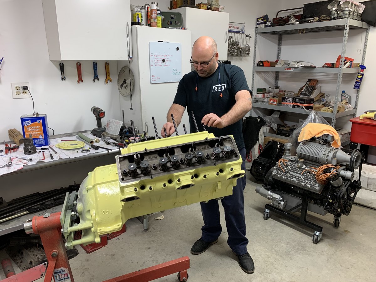

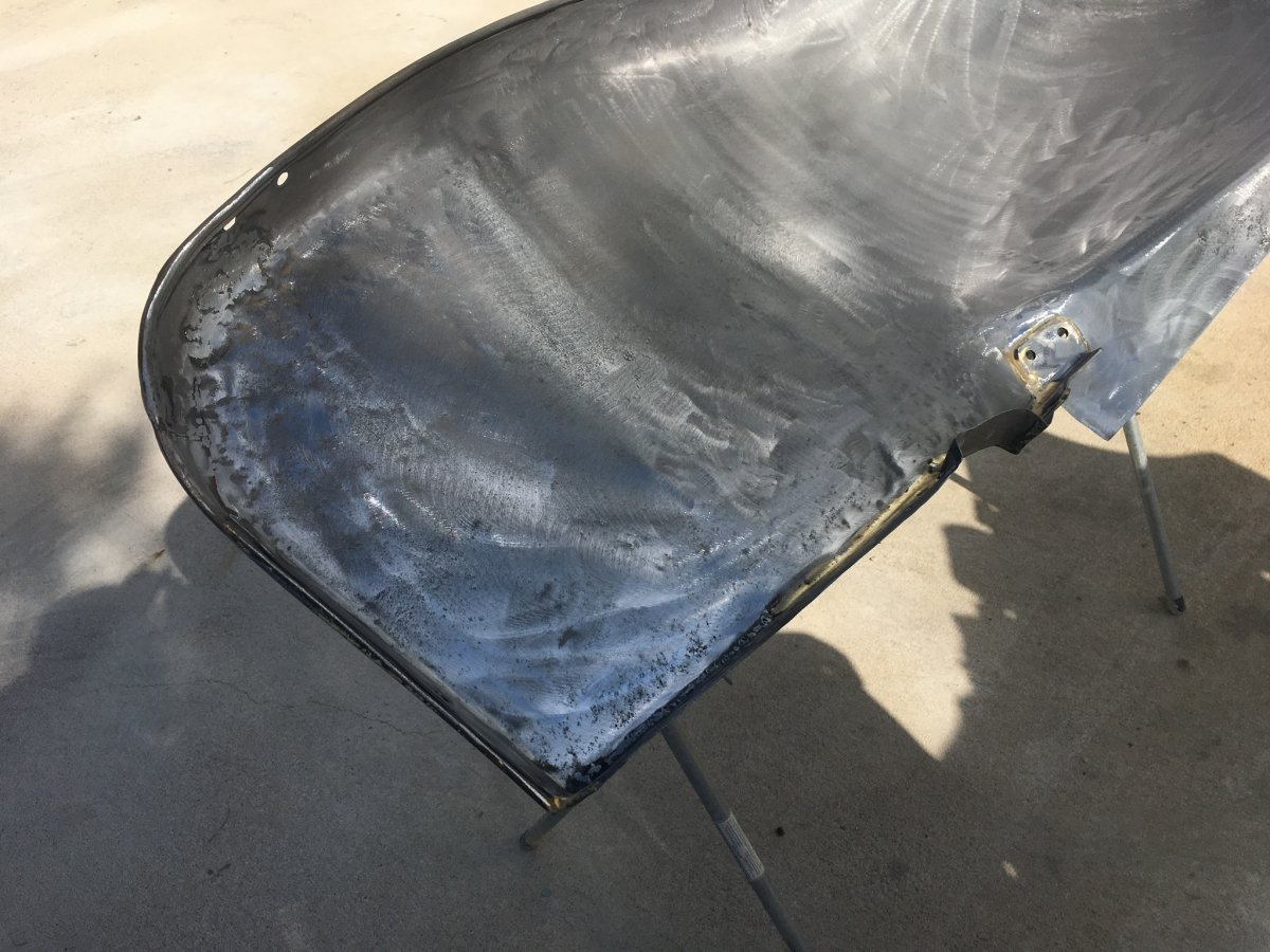

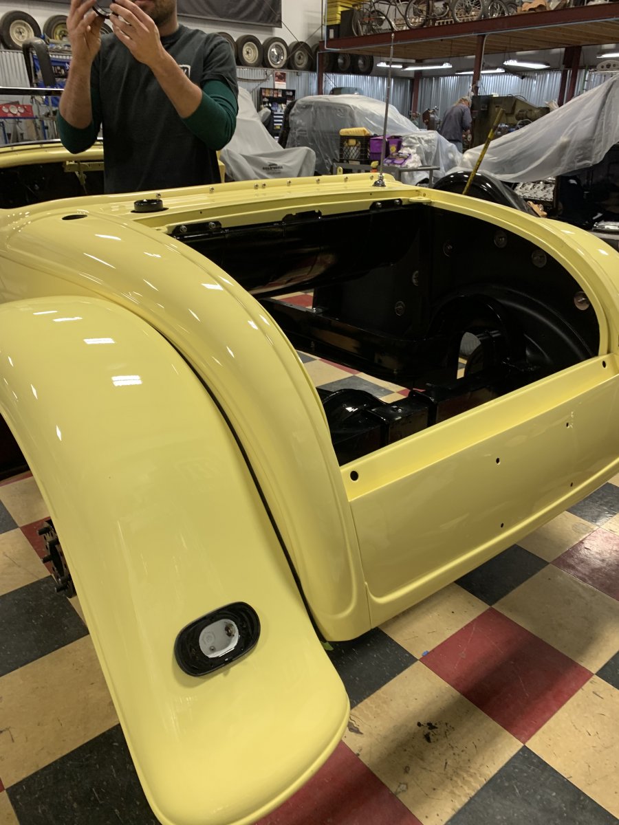

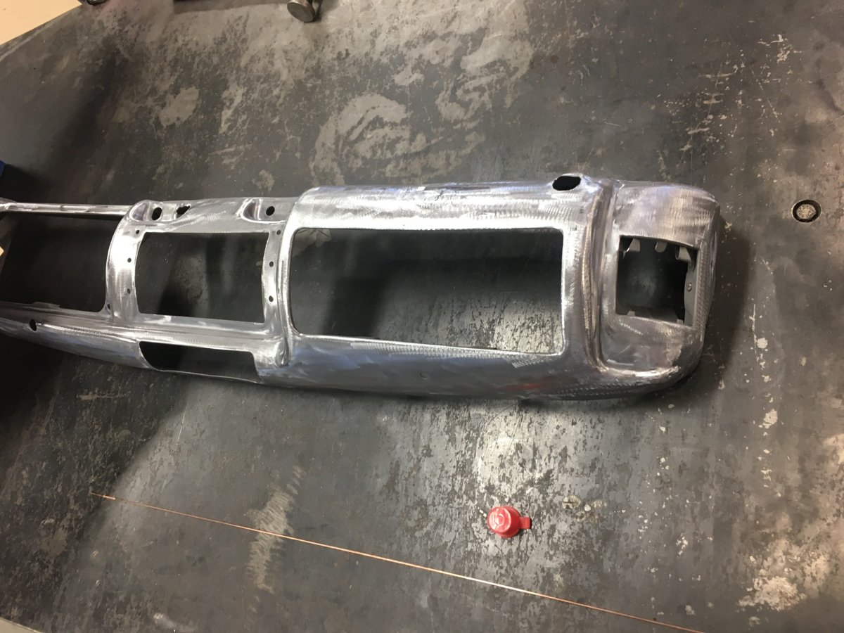

  10. So maybe a little more has been done. 9C1D8C5F-0D5A-450E-BF38-DC516AA20D4C.jpeg 46D14FD6-3439-4AE6-9A6D-82CE344FA1DB.jpeg 01A91CE1-451A-477D-A700-DF7F072DC6F6.jpeg 5366418F-50AE-4BE0-8D54-CB4EE4158F8D.jpeg 3A2DD93B-BC70-40A7-956A-D6DAAA94E1E9.jpeg DF4AA657-1550-4E93-A58B-326C5F7EE6EF.jpeg F0435647-C3D7-4508-A30D-F1D8F7B52D63.jpeg 2D458E13-88E7-4E5C-B63C-6402F7A10784.jpeg 271871F4-663E-4B71-83EF-65B65EC6FCC8.jpeg 6A955F84-9A4D-4233-9587-51D822EE32F5.jpeg 6CA910C1-58E2-45AA-BB6E-71C51C165DF4.jpeg 1E349FEA-1179-4494-BFAF-F47DA7F4122B.jpeg

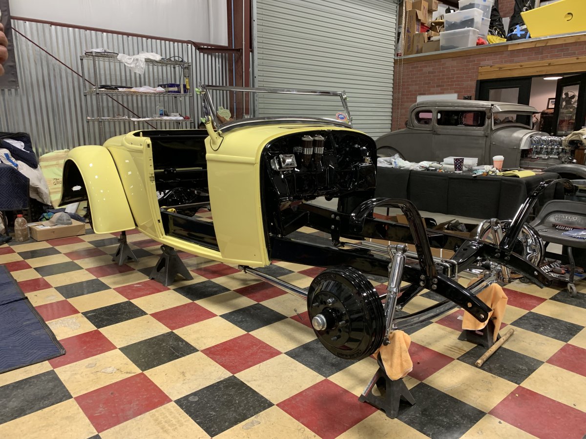

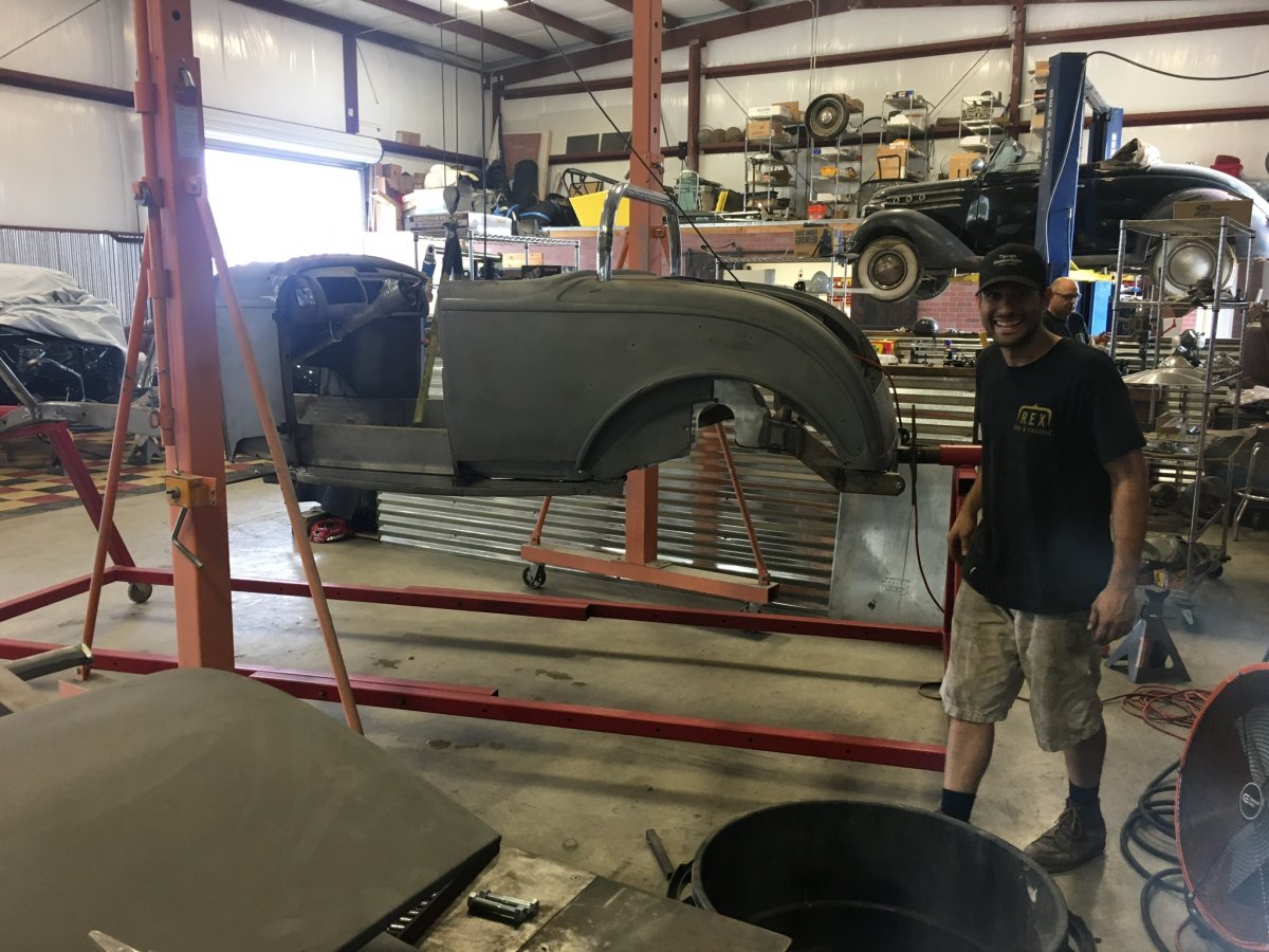

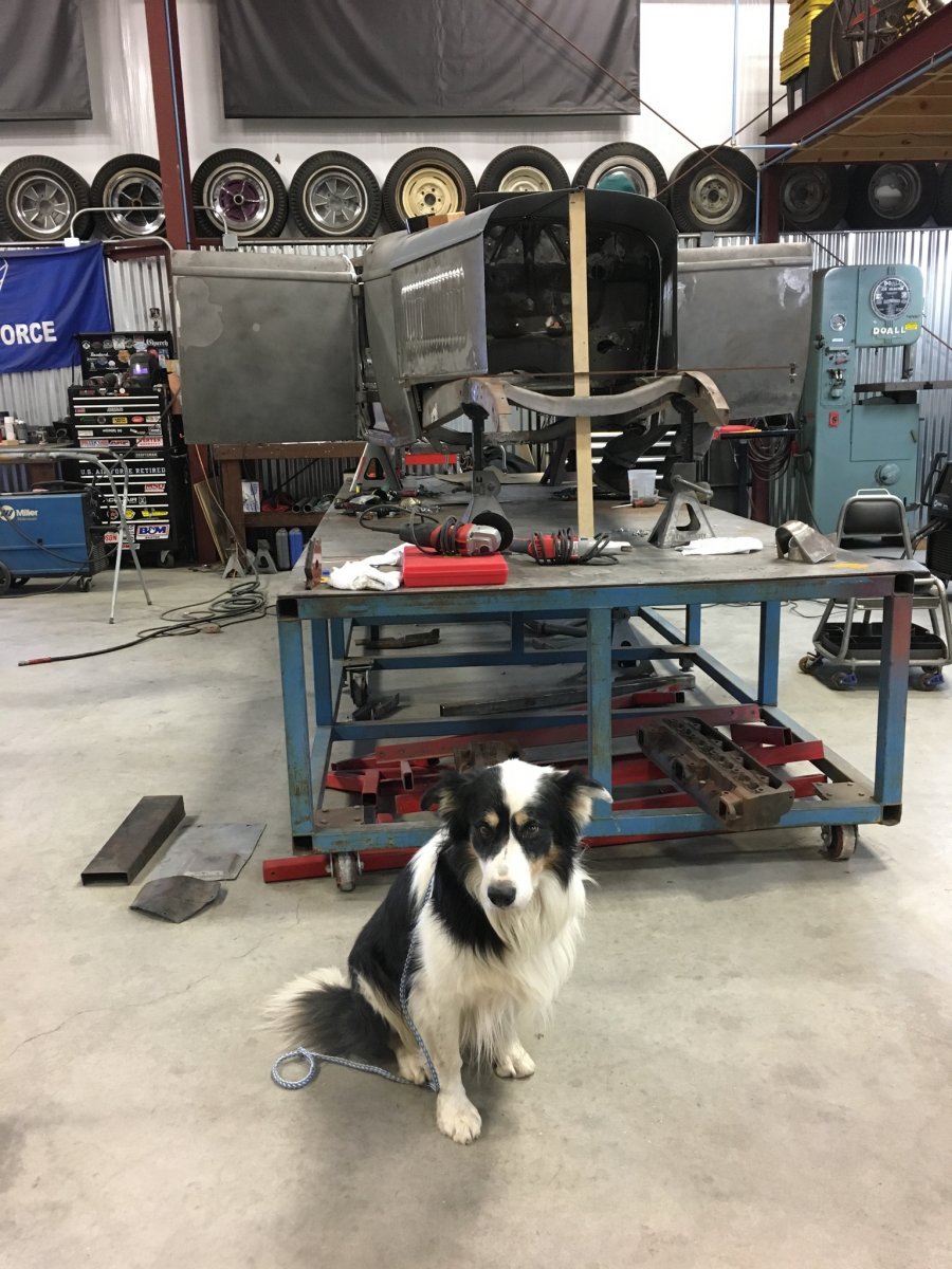

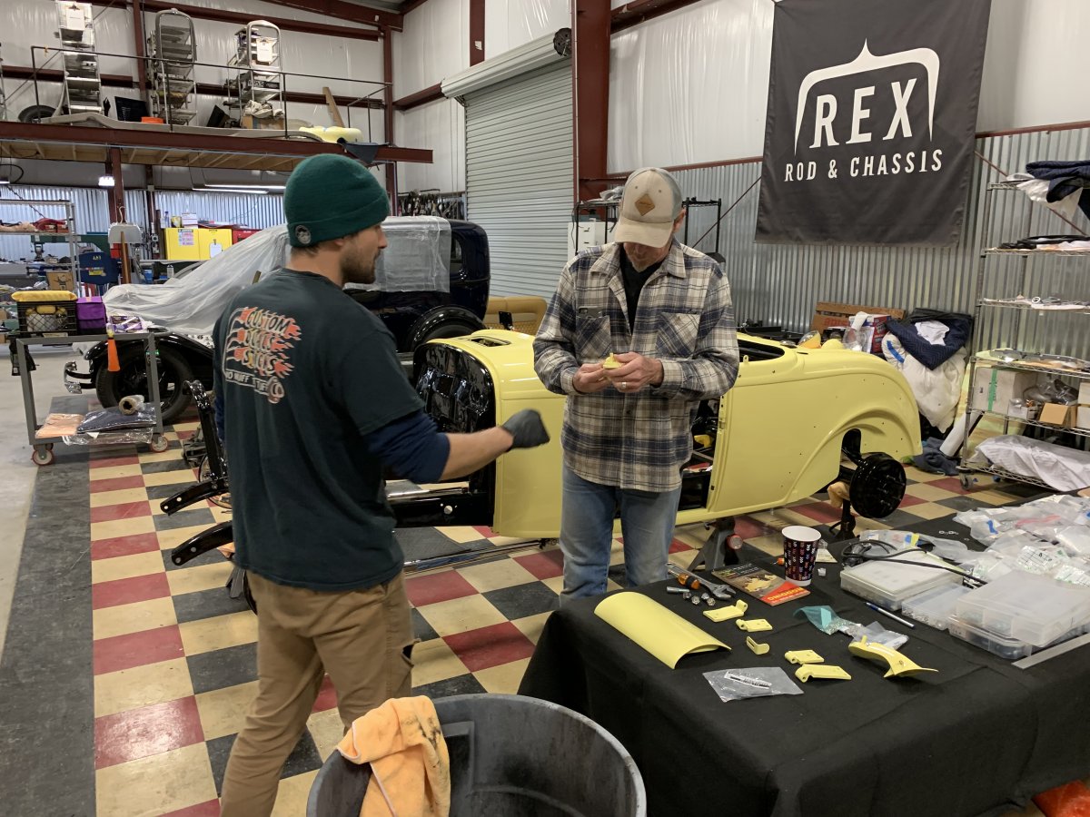

  11. 0D28BC53-29A1-4906-8317-29AF8C9B3E6C.jpeg Things are really happening fast. Duncan has been helping every spare moment he has. To think back in September 2017 at the Hill Country Rally for Kids was a milestone for this bird. John Tullis did such a wonderful job on the design of the Bad Bird in Tweety. WOW

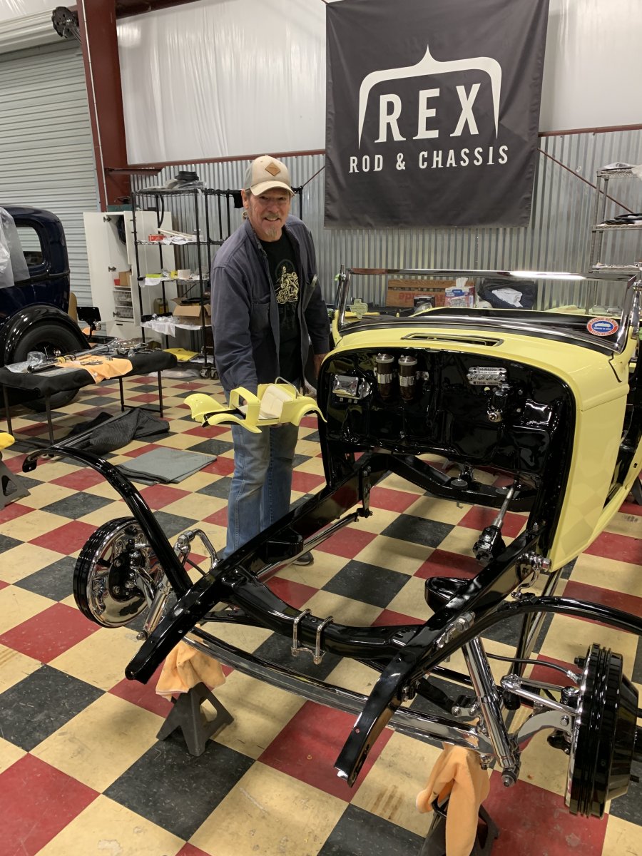

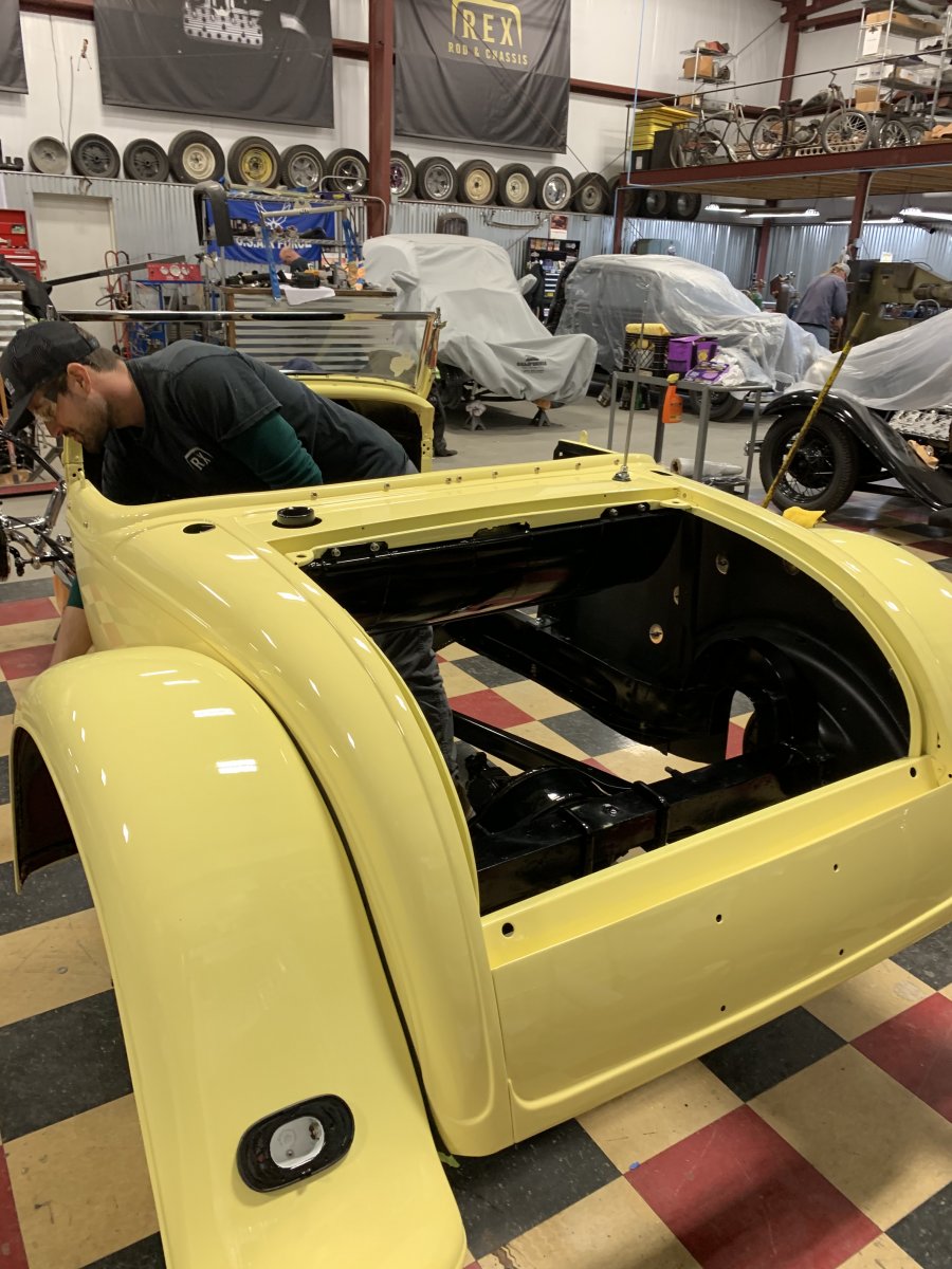

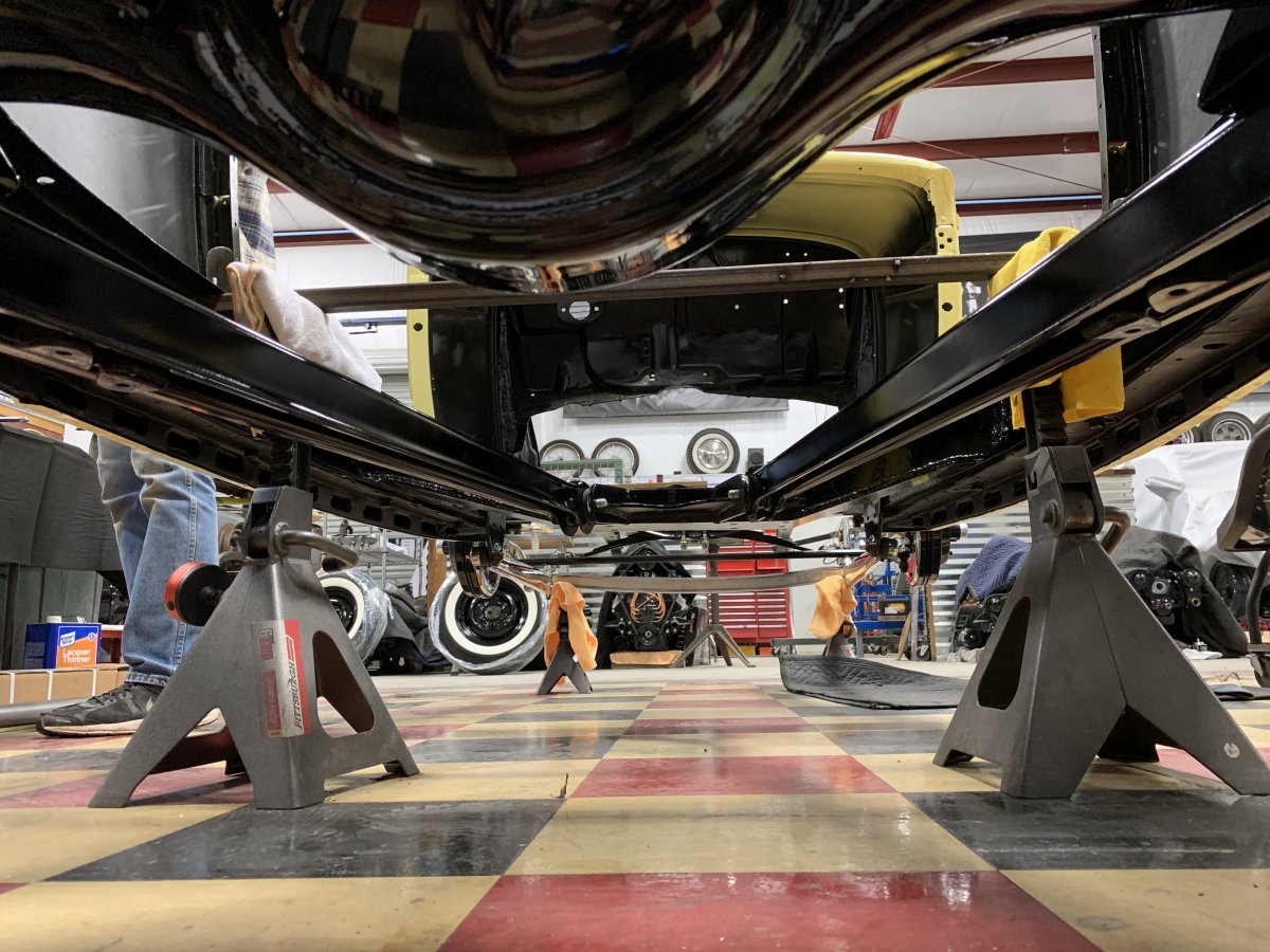

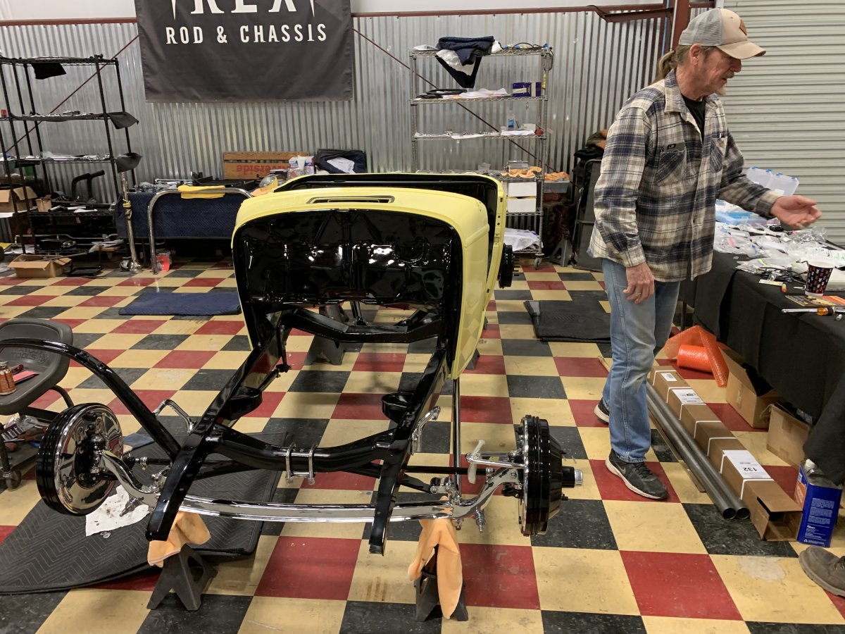

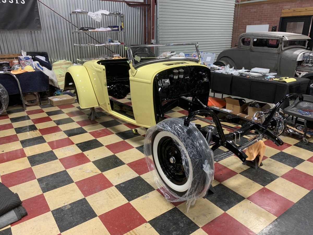

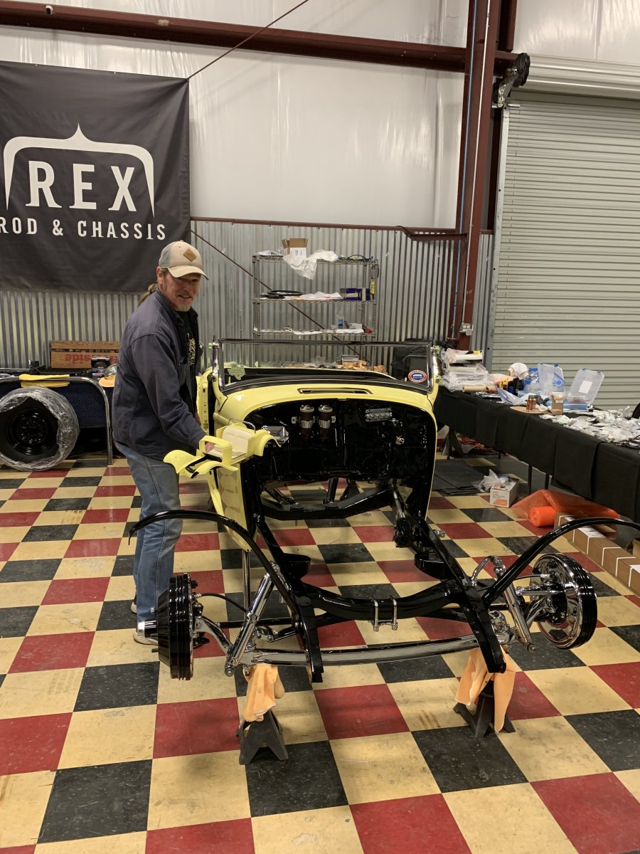

  13. AB40D271-1728-4D64-93BE-1175DEA2AF37.jpeg 69C446F1-409F-4910-8E71-7B3296358903.jpeg 5C3145BF-00FC-45B4-BDA7-B062657E75A1.jpeg A8AB5BF7-086B-4B62-BB6B-4B9F7D226A68.jpeg 4AF7416F-A18D-4F14-A377-0FEBD45B4880.jpeg BD5EC341-7EA1-4D9B-B270-6C5D3763254B.jpeg 13B57AE7-DC12-4EE0-A9DF-3BA3E56DF92F.jpeg B8E0EBB8-35B7-4B71-BF15-F327BD8314F0.jpeg F7A66FC1-59AE-493D-B390-AFADEDE553BB.jpeg 8AE76A23-1DEA-483B-9D83-8A4A9ECFB87F.jpeg DE0C4D6A-445E-4DE7-812C-2AB7FE33AC01.jpeg AC36232A-631F-4BED-AFCD-9995EE5CACF0.jpeg 5835C41F-21AF-4488-9B94-E5A31EE3B4DC.jpeg CFA5321A-ABC9-4632-AA87-B0FBBB926B3D.jpeg The dedicated force that drives Kieth and crew is incredible. Making this project (Resurrection Tweety) happen. Donating all the shop labor free. Rex Rod & Chassis is going to Jim behind the wheel of Tweety for the first time in 57 years this year 2019!!!

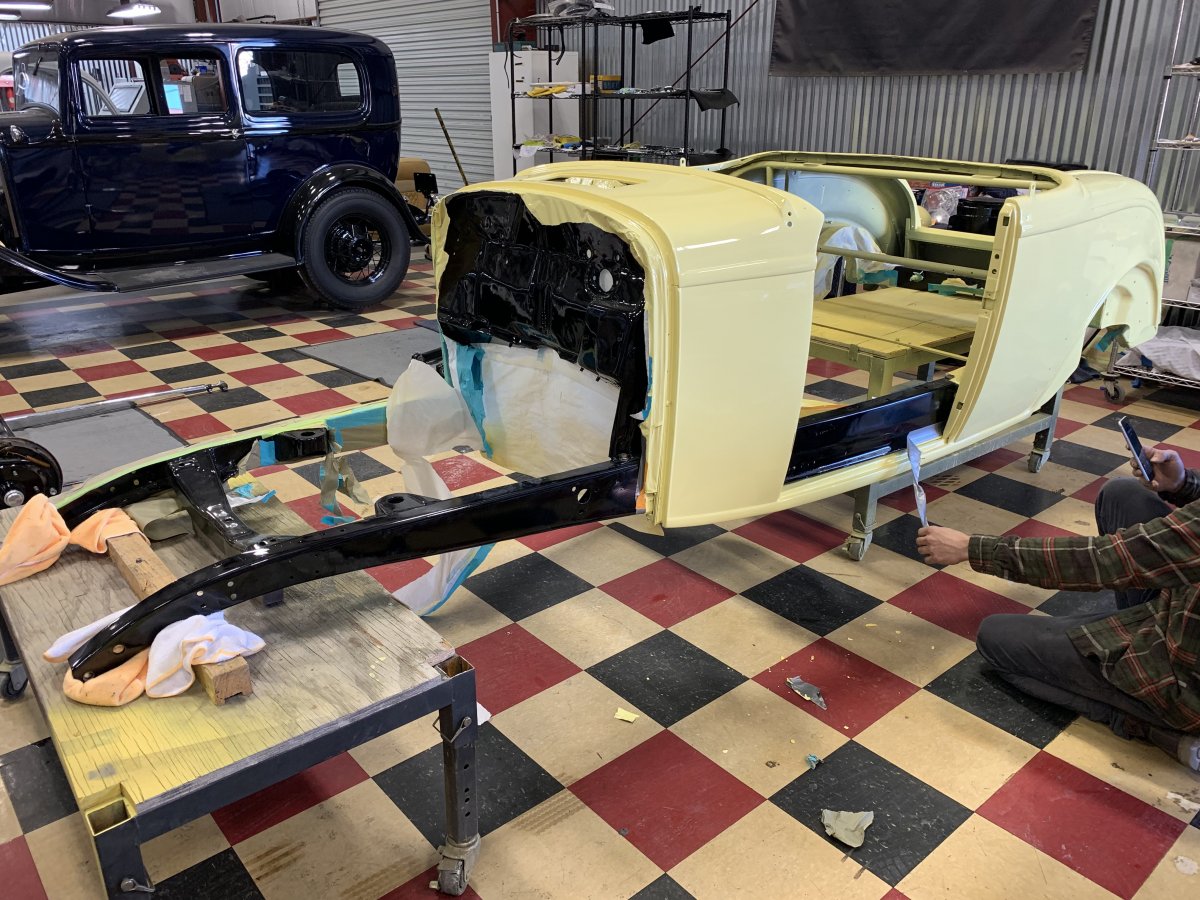

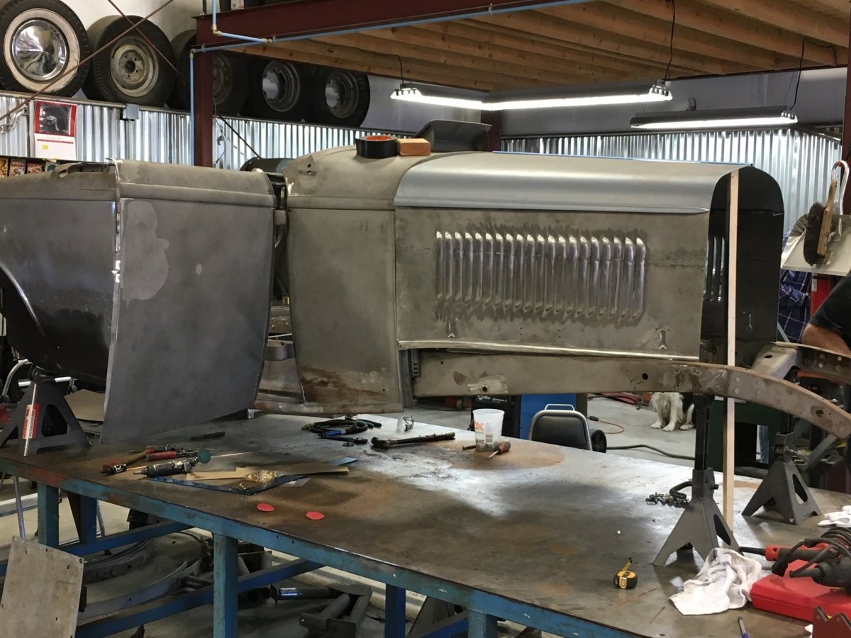

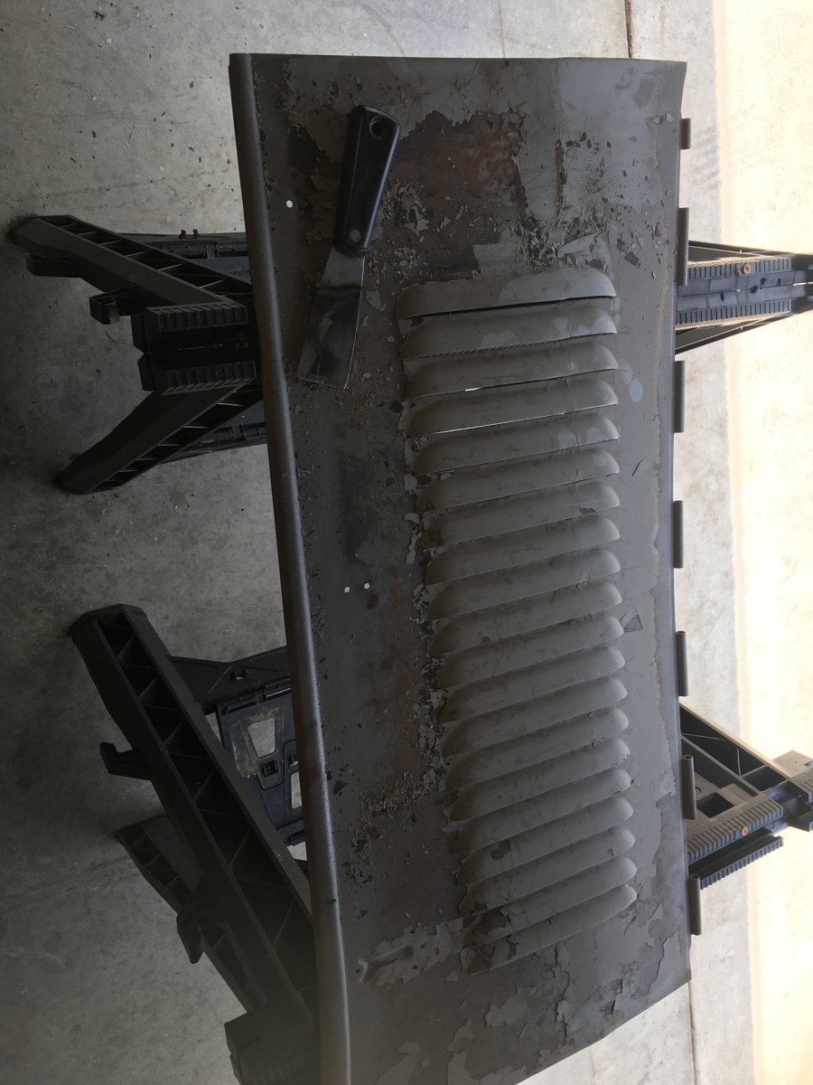

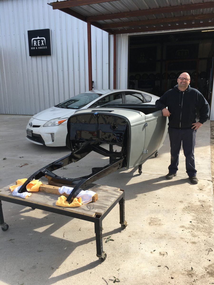

    I don't think they figured it out. The hood sides are taper sectioned because the front of the frame came out square with the firewall. Look at the gap between the frame and the bottom of the hood side at the firewall. Notice that the forward loovers are longer than the back ones. 4AB747AD-FBEE-432C-BB0E-055DFD1CE94D.jpeg

    So by saying it doesn’t fit, your referring to this gap at the bottom of the back of the hood side? Between the hood and the frame? DC137195-02B7-4BDA-93CB-B5E79E34BEA0.jpeg

    The frame was mounted to the body at an angle. I shoud know. I took it apart. There were stacks of washers and nuts and pipe fittings at the wheel well which proped the back of the frame up and angled the front down. The frame is now mounted flat to the body. One of the genius styling tricks was to angle the front fenders down. It made the car more aggressive and faster looking. It will look different with the fenders angled up.
    At this point, I would pie cut the frame at the firewall.

    So your saying if the body isn’t mounted on the frame with taller mounts in the back, in fact shimming it higher, the rest of the forward sheetmetal won’t align correctly.
    And if you were to approach this instead of putting taller mounts in the back you’d modify the frame.

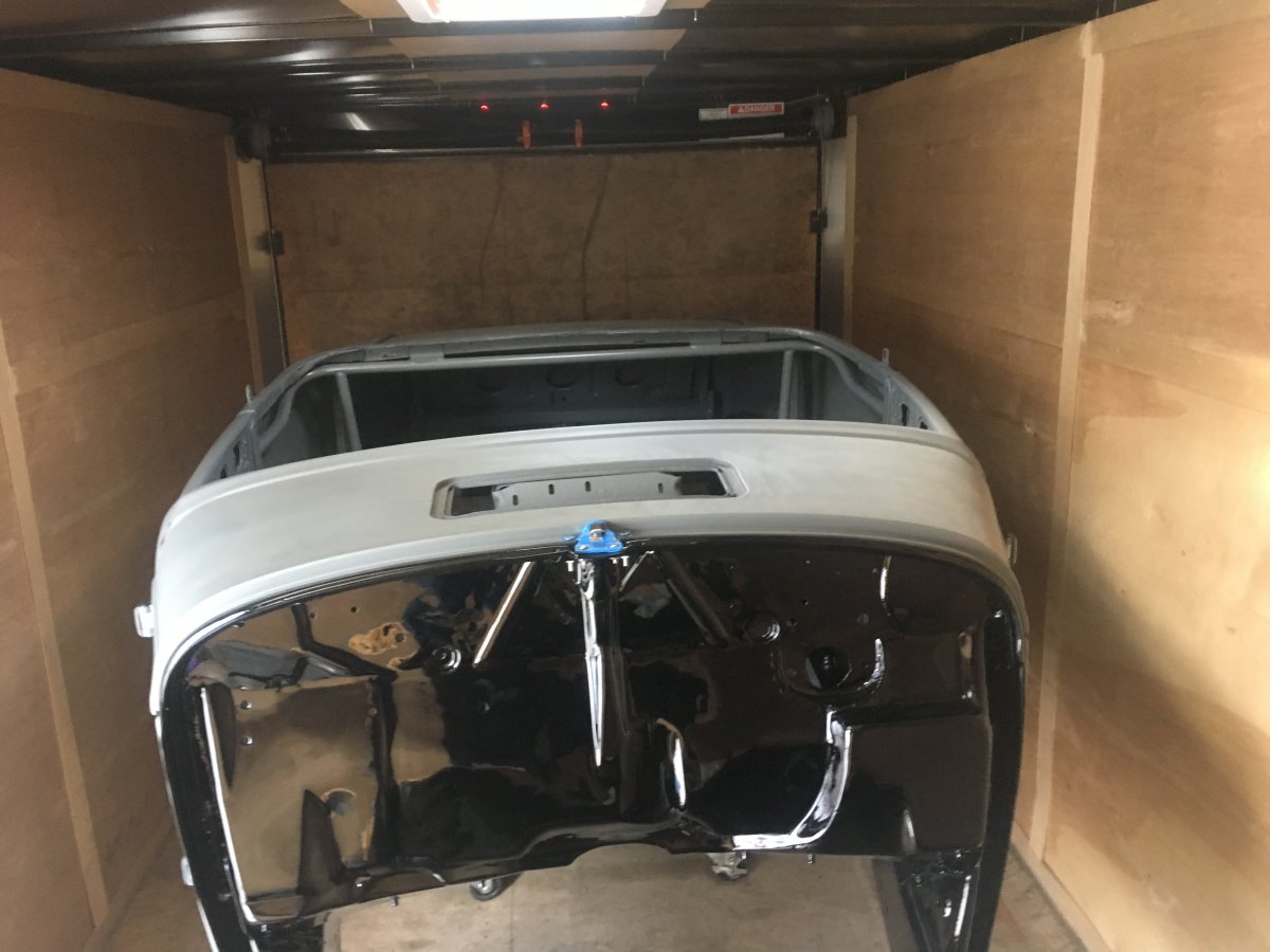

  24. 669E1203-0474-4DF2-9B3E-03A992B225E3.jpeg EDD4E0C8-A3F8-4FDC-A535-0E9DA10F7B0B.jpeg F53EFA28-2437-4C5E-BCA7-F998311945E8.jpeg F5983E3F-CB90-4D93-9BFC-0D6644177FC8.jpeg 53C358B2-36EC-4DD6-9F1E-C90226C9A384.jpeg F27BDFC7-D307-4D26-8247-573D848A6E0E.jpeg D3D8D301-CA3D-4EA7-AD33-8D2E76C0C6C9.jpeg F8A0820F-F4D2-480C-86A8-893ED2D7066E.jpeg 5616CAAD-6030-42B6-A8C4-41F658210F44.jpeg 43175D6A-3E61-49F8-9CB5-7C3209100918.jpeg AC5526B4-522D-46F4-9ED6-731EAA33EAEF.jpeg AF0A4260-5E11-40AF-B8CF-A695F70E4CD3.jpeg D4F936CA-E4D8-4EB9-805C-7C27F2E3A435.jpeg C4A72A79-E9BF-4FF7-8881-CA68949DC0D8.jpeg 233BF8BC-4CA3-4E4D-89BC-8257B1AEAC84.jpeg 64003C88-41B7-4328-A136-26B4ADC41C55.jpeg 812FBE54-803C-4963-8E2E-F27BF4CC9E53.jpeg 0D9D0992-49A0-477B-A4F5-2D95DAE2EB21.jpeg 038CA89A-B4FA-4D3B-BA27-BEF2505B7098.jpeg EE1A6AAD-49F8-4E29-A082-A6DF2CD5FA0E.jpeg Here we go! Houston, let’s move the rocket.
