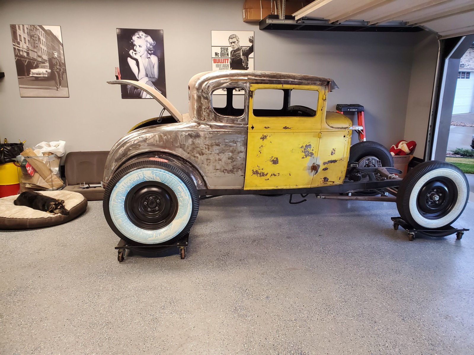

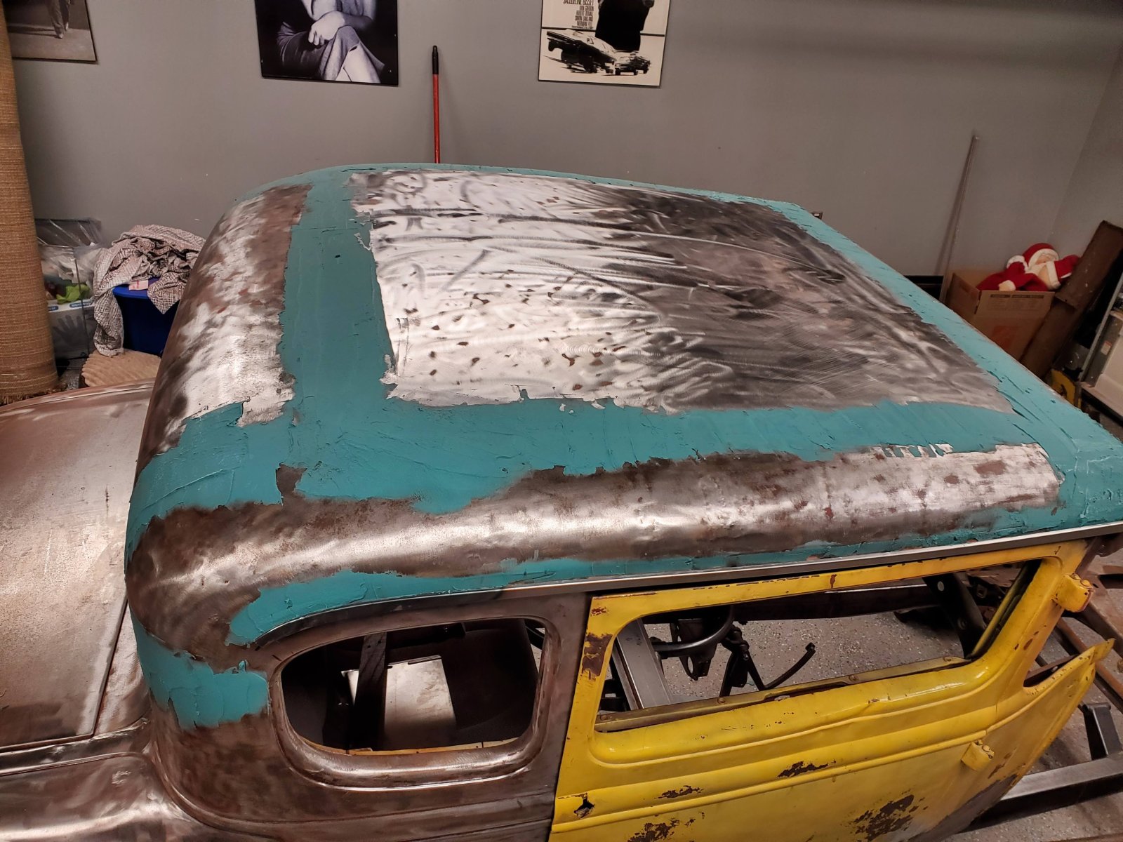

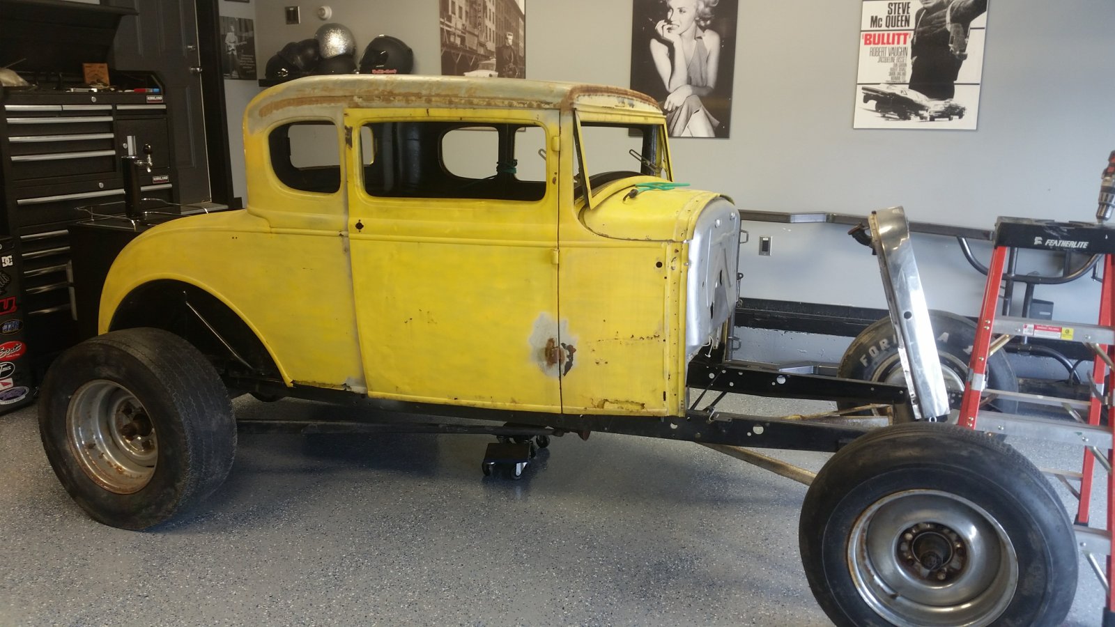

    Taking a closer look at what lies ahead... The older gentleman I bought the car from mentioned he picked it up back in the early '90s. He had plans to restore it, but life got in the way, and the car ended up getting shelved, waiting for its day to shine. As time went on, he realized he probably wouldn't get around to it, so he put it up for sale. I was the first to call, followed by a flood of others (his phone actually died from all the calls!). Being old school, he told me that since I was the first to show interest, I had the first shot at checking it out.
    The workday couldn’t end fast enough, and as soon as I was done, I headed straight to his place to strike a deal.
    The car had already been chopped and the roof filled before he owned it, but he didn’t have any history on when or who did the work. He did say that the car was supposedly used as a prop in a movie filmed in Edmonton, but I haven’t been able to confirm that yet.
    IMG_20160304_104748.jpg IMG_20160304_104755.jpg IMG_20160304_104802.jpg IMG_20160304_104813.jpg IMG_20160304_104824.jpg IMG_20160304_104834.jpg IMG_20160304_104845.jpg IMG_20160304_104859.jpg IMG_20160304_104906.jpg IMG_20160304_104913.jpg

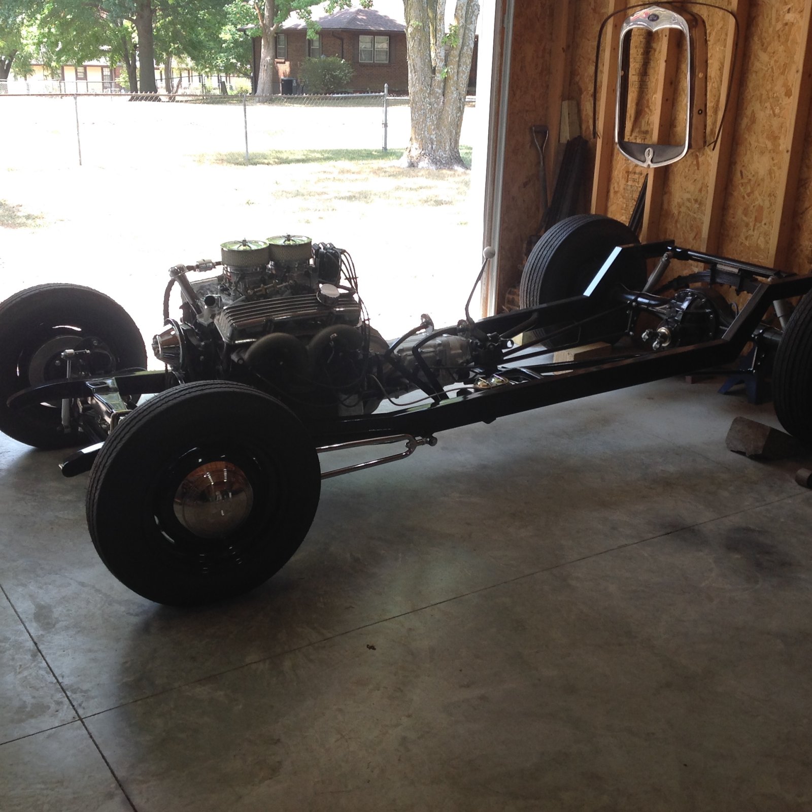

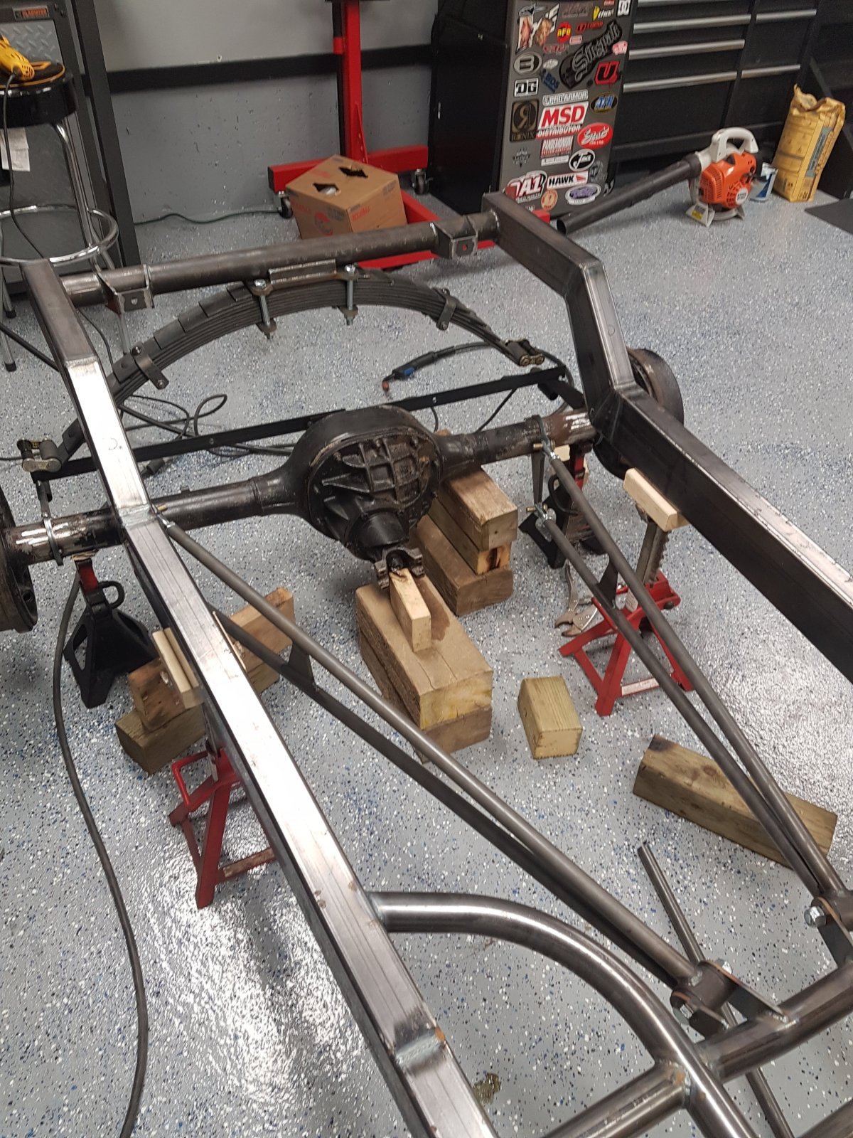

    @VAPHEAD really came through! This frame is amazing, and his attention to detail is second to none. I was heading down to the Montana border to pick up more parts, and Eric went above and beyond—working with a super tight deadline—to make sure the frame was shipped out in time. Big thanks, Eric! Frames Ahoy!

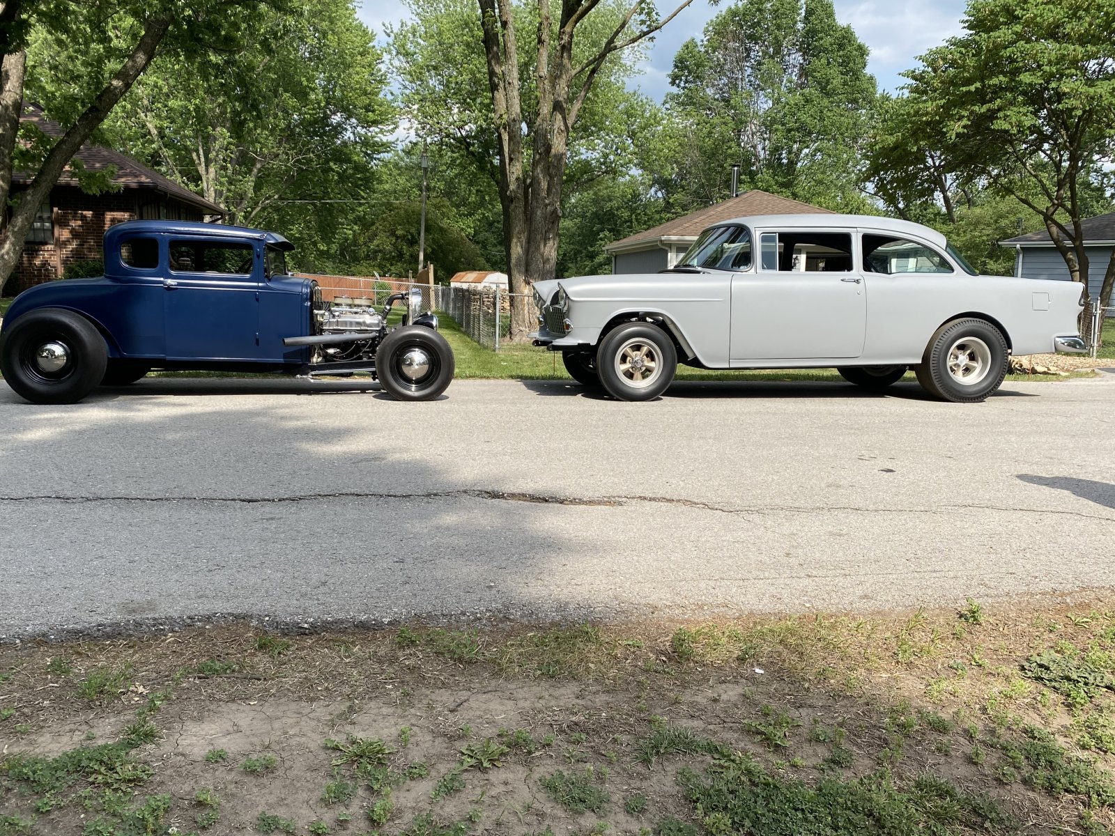

  12. There’s a very wicked 55 Chevy lookin for you.

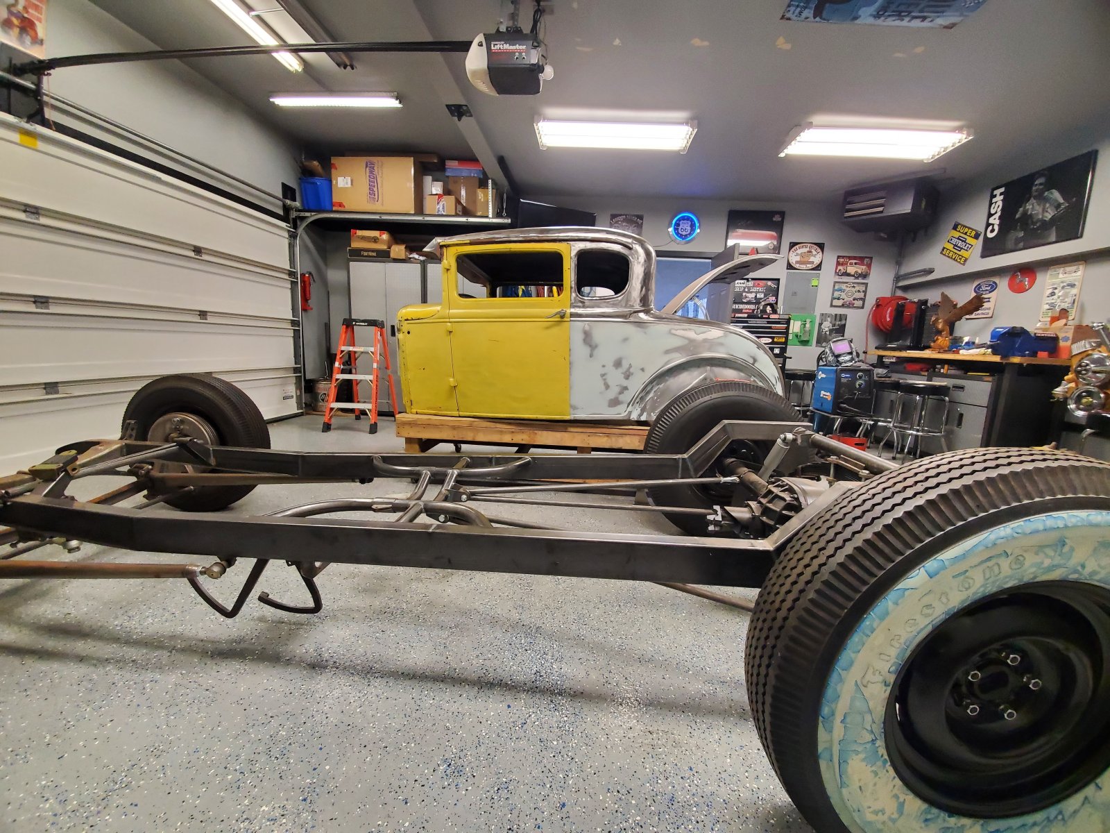

    First test fit on the new ch***is :):):)
    20180203_173439.jpg 20180203_173454.jpg 20180203_173511.jpg 20180203_173527.jpg 20180204_210953.jpg 20180204_211014.jpg 20180327_084525.jpg

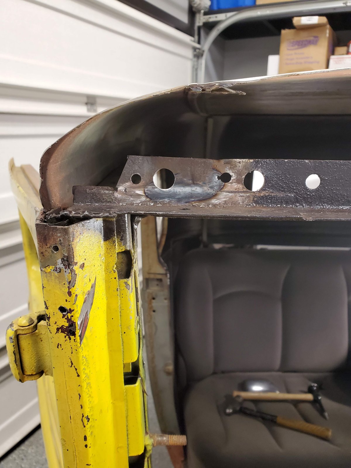

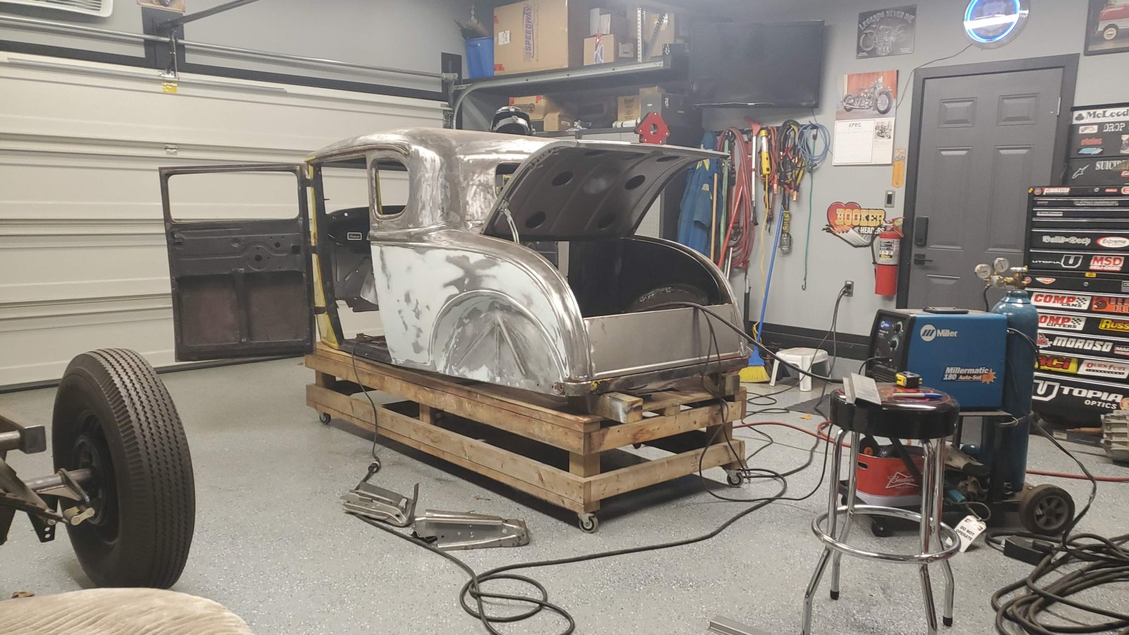

    Like mentioned, I am playing catch-up with this build thread. Please enjoy the photo dump and ask any questions along the way!

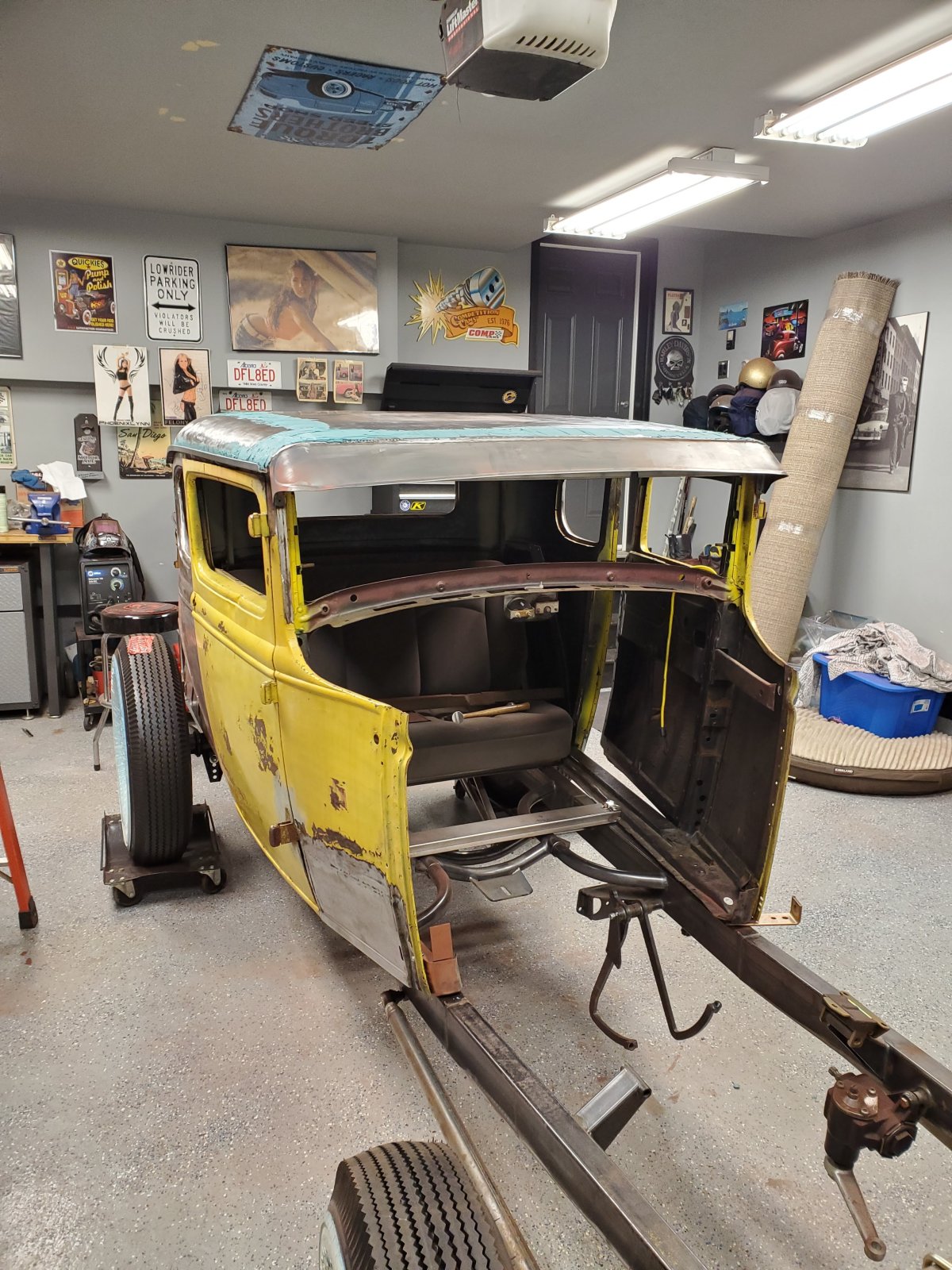

    It was time to dig in with getting this body straightened out. My dad built me the rolling dolly and I sketched a 2" grid along the surface for ***istance with squaring the body... Worked slick and I highly recommend trying it!
    First on the list was replacing the rear subrail section and wheel wells.
    20180921_192632.jpg 20180921_192623.jpg 20180921_192640.jpg 20180921_192645.jpg 20180922_164526.jpg 20180922_164554.jpg 20180922_164606.jpg 20180922_164831.jpg 20180924_131915.jpg 20180924_131921.jpg 20180924_131926.jpg

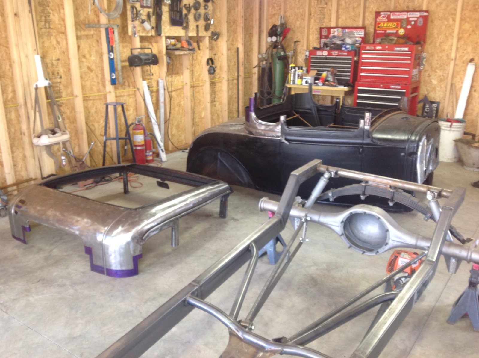

    IMG_0118.jpeg IMG_0174.jpeg IMG_0484.jpeg You will be pleased with that frame. We used the Riley swept frame with our 30 coupe.

    I'm sure I will, the build quality is definitely top notch! Your coupe looks great, nice job man! Did you install a rear panhard bar? Been hearing mixed reviews about running a buggy spring without a panhard...

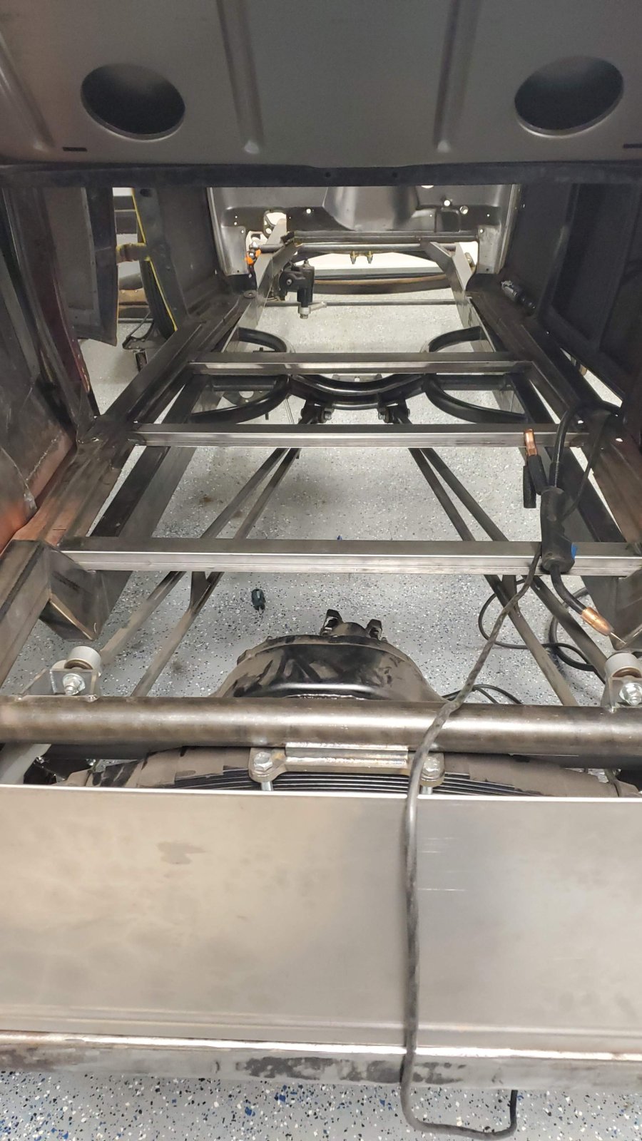

    Time to fabricate some body mounts and get my fuel situation figured out. For body mounts I used some 3/4" poly that I had available at work.
    20221029_113353.jpg 20221029_115609.jpg 20221029_115615.jpg 20221113_195948.jpg 20221106_121521.jpg 20221111_120353.jpg IMG_20221111_115434_01.jpg
    Now we're getting somewhere! Time to see how this 327 fits :D:D
    20221222_141502.jpg 20221222_141513.jpg 20221222_141626.jpg 20221222_164739.jpg 20221222_201249.jpg
    20221224_160137.jpg 20221224_160144.jpg 20221226_171829.jpg 20221226_171841.jpg IMG_20221223_210551.jpg
