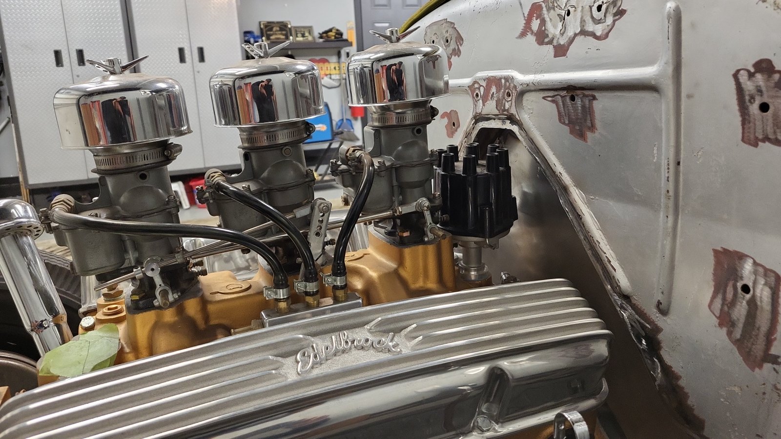

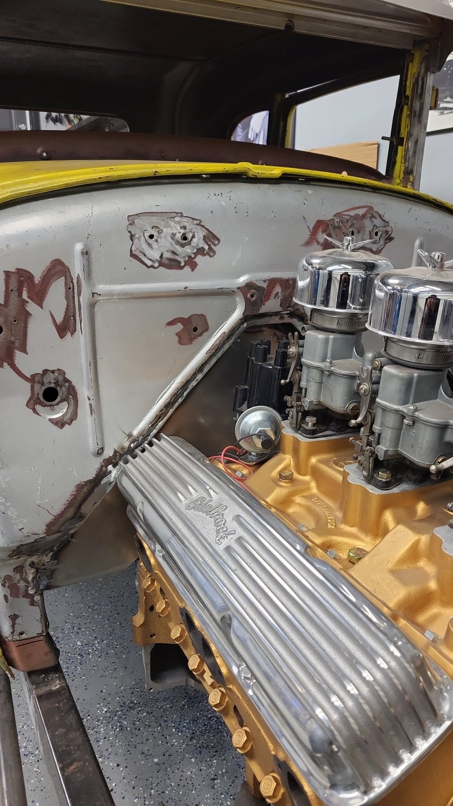

    Back to the Coupe! Not sure how this happened, but I didn’t plan on recessing the firewall for the distributor. The body’s definitely positioned right on the frame, and moving it back any further would look ridiculous. Oh well, time to break out the grinder and get custom :cool: PRO: Room for a future nailhead??? :rolleyes::p
    20230303_122049.jpg 20230303_122052.jpg 20230303_122101.jpg 20230303_122107.jpg 20230303_144459.jpg 20230303_144546.jpg 20230303_155310.jpg 20230303_155315.jpg 20230303_155319.jpg
    Much better!

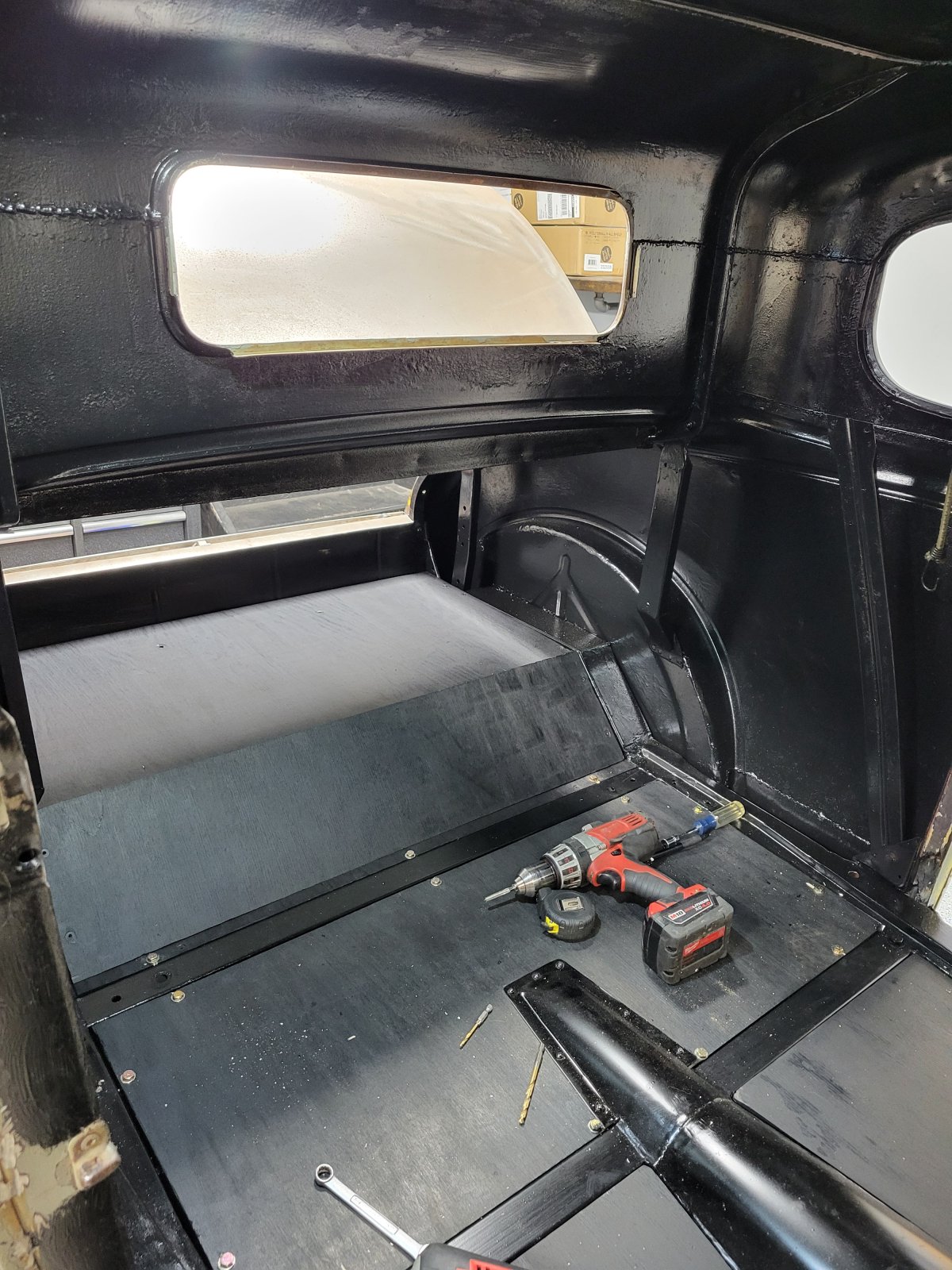

    Back on the saws to get this floor together... Time to call dad lol! Went with marine grade 3/4" plywood for the floor and normal 3/4" for the bulkhead (more on this later).
    20231203_121922.jpg 20231203_121931.jpg 20231203_121936.jpg 20231227_212221.jpg 20231228_203631.jpg IMG-20231228-WA0000.jpeg

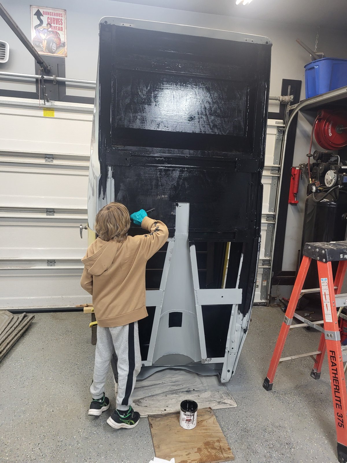

    Our nephew came over for the weekend to learn a thing or two. Perfect—put him to work! Gotta start 'em young if we're gonna keep this Hot Rodding tradition alive!

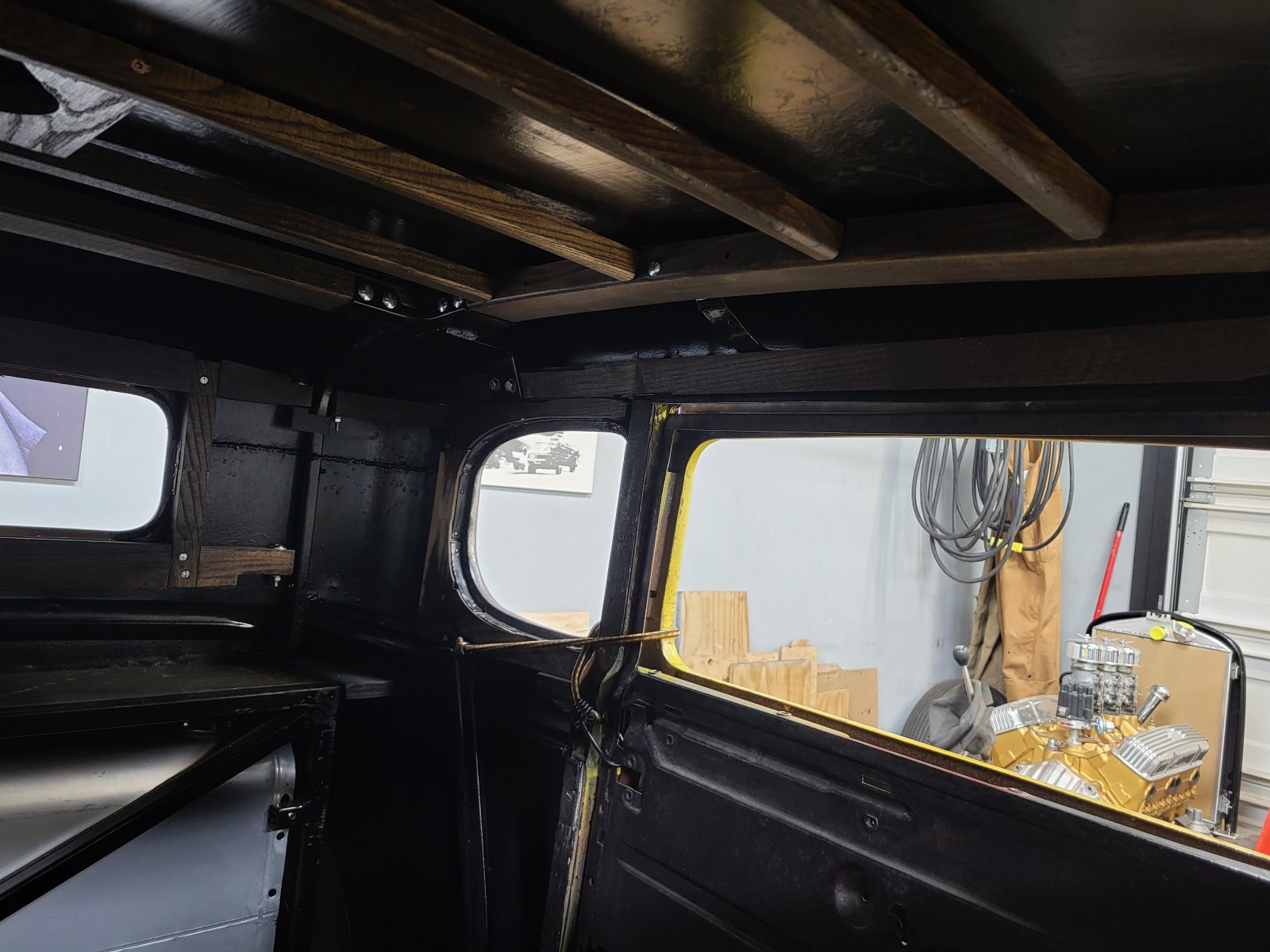

    Getting the reproduction wood kit from Snyder's Antique Auto stained and installed. Can't say enough good things about the quality of these pieces. WOW! Thanks Snyder's! I'll be back!
    20240106_140322.jpg 20240106_140328.jpg 20240106_141332.jpg 20240106_151503.jpg

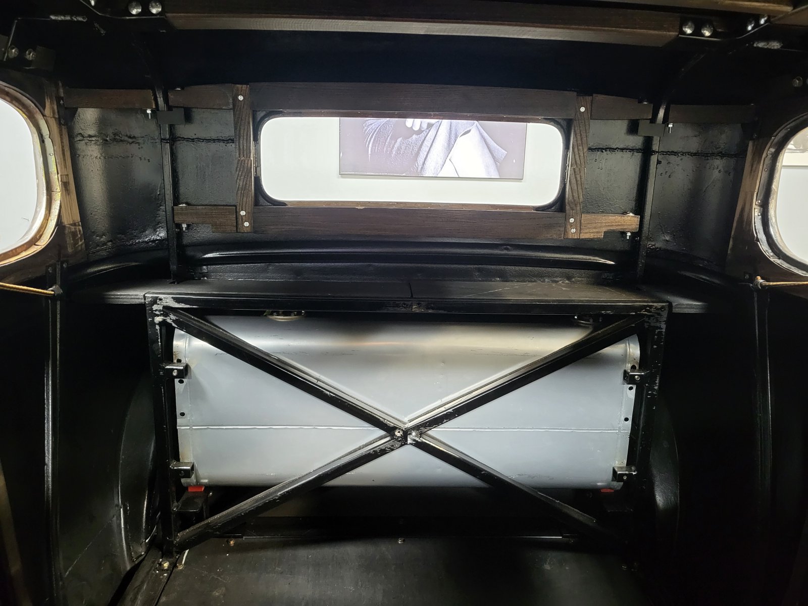

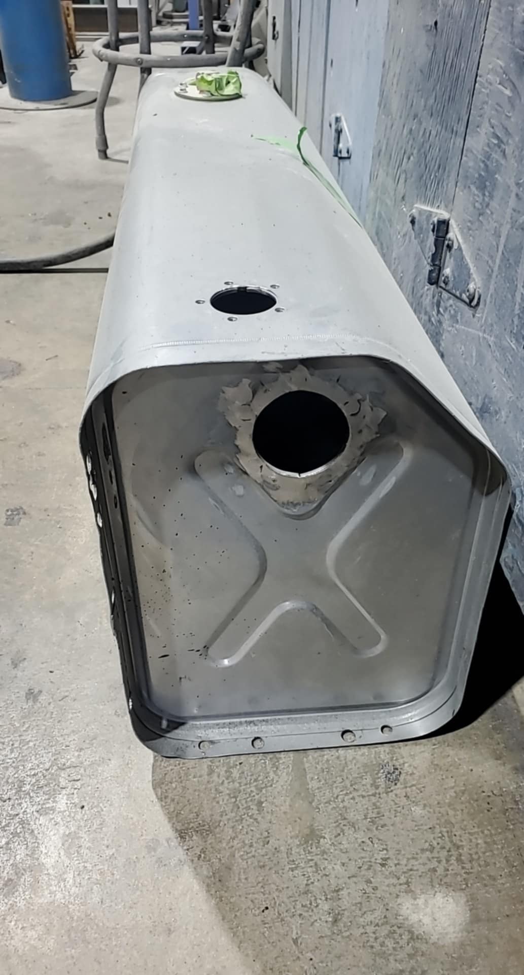

    Forgot to show this earlier, but here’s the fuel tank setup I built. It adds a ton of support to the body and gives me a solid spot to mount a bulkhead.

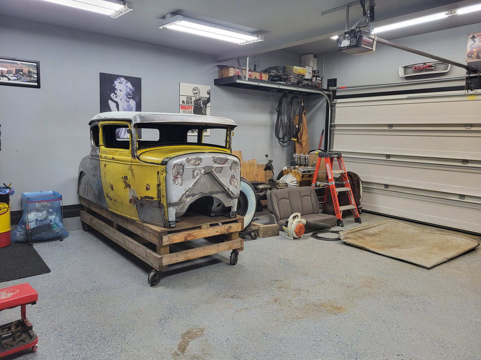

    Had the nephew over for some garage time! First, we pulled the body off the frame—hopefully for the last time. He wasted no time and got to work painting the bottom of 'his future Coupe'—his words, not mine. LOL! :p
    View attachment 6190634 20240209_111007.jpg 20240209_111016.jpg 20240209_113036.jpg 20240210_103329.jpg 20240210_111359.jpg 20240210_130526.jpg 20240210_130545.jpg 20240210_130600.jpg
    Back on the dolly... This is where things get interesting ;)

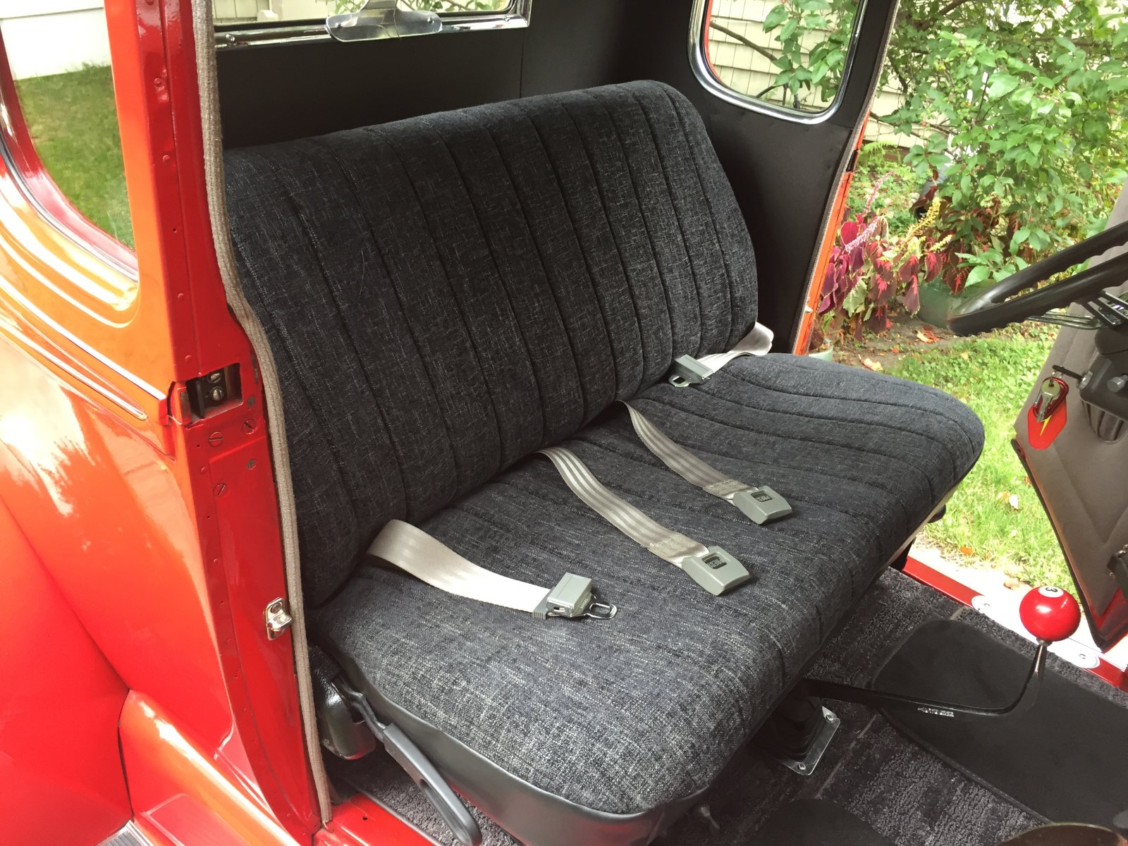

    Those mini van seats are comfy, have one in our Coupe! Great to see you and Dad spending quality time together (there’s that “Family” thing again). Sad to see that you lost a fur kid, you know why they All go to Heaven. Coupe’s coming along great, Carp. IMG_1991.jpeg

    Thanks for all the kind words, Carp, I really appreciate it! I’ve heard great things about these seats, so I’m looking forward to breaking it in and digging a groove into it. It’s always a blast spending time with Dad—gotta keep that ‘Family’ thing going strong. And yeah, losing any animal is tough, but we know they’ve got a good spot up there. Thanks again!

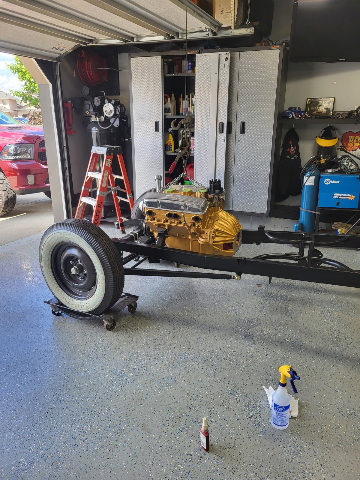

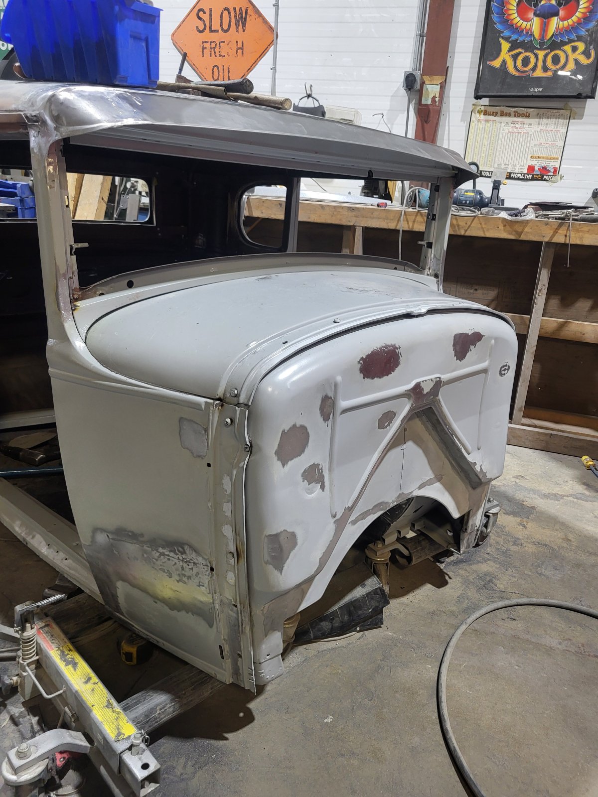

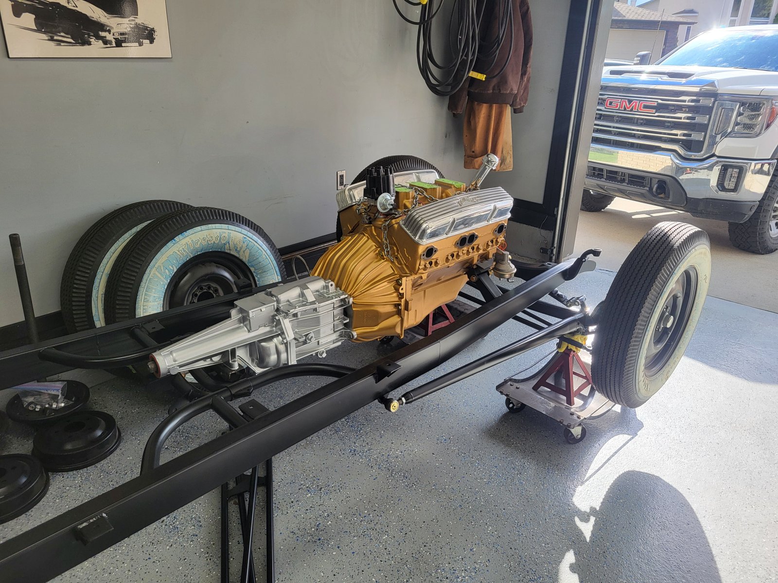

    With the body off getting all dolled up, it's time to tear down the ch***is and get some paint on it. I set up a spray booth in the garage and hit it with Rustoleum semi-gloss thinned with acetone. I think it came out pretty slick! The plan is to run it like this for a few years, work out the kinks, (nailhead maybe) then pull the body again and go for a powdercoat on the frame.
    Marilyn approved :cool:
    20240330_154309.jpg 20240426_165709.jpg 20240426_165722.jpg 20240427_110101.jpg 20240427_161158.jpg 20240427_161205.jpg 20240427_161218.jpg IMG-20240430-WA0007.jpg 20240623_121932.jpg 20240623_134719.jpg 20240623_135934.jpg 20240623_183211.jpg

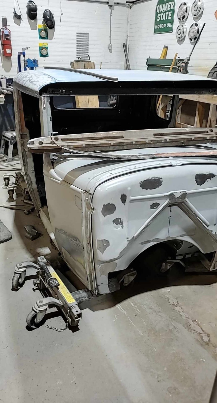

    Tweety

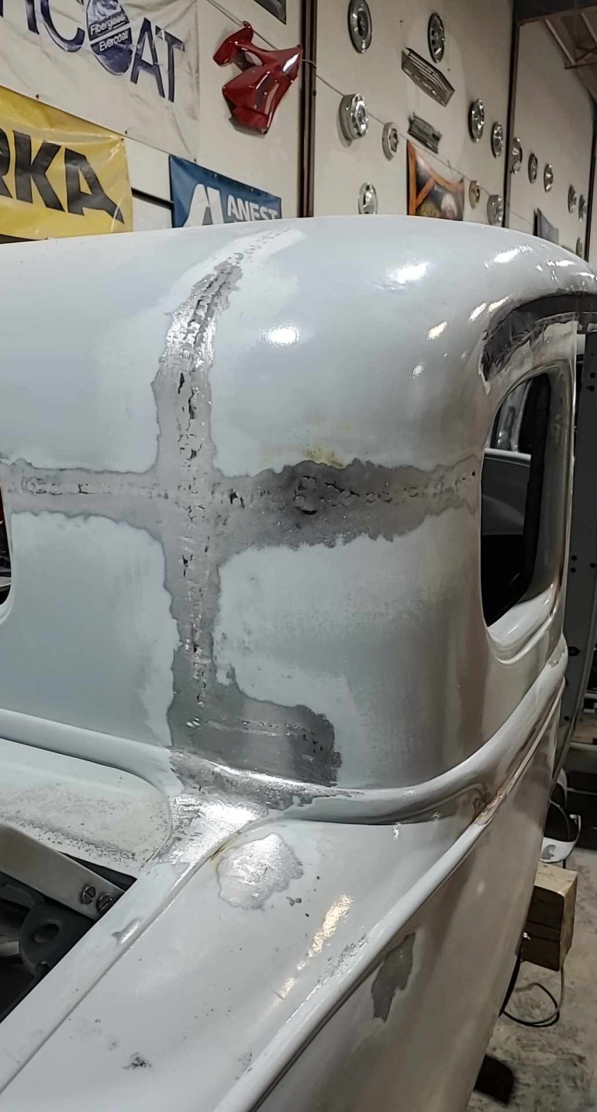

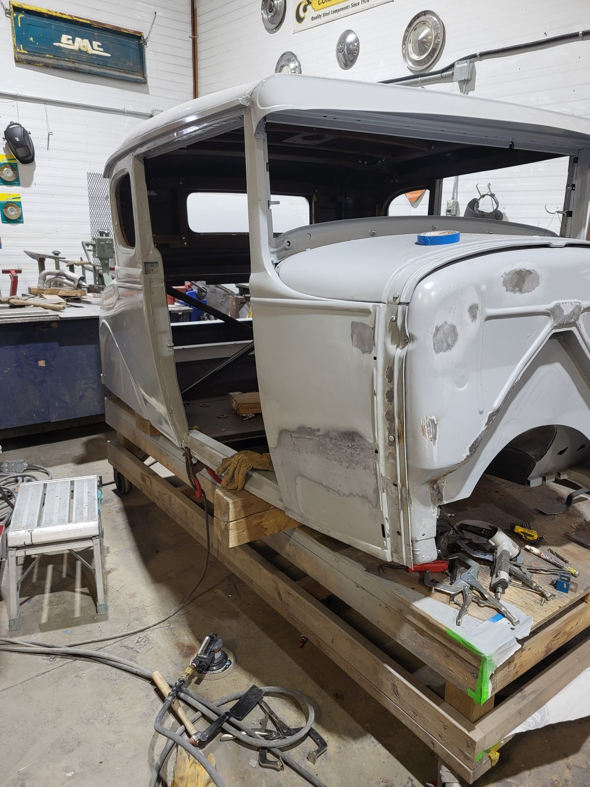

    20240510_155659.jpg Meanwhile, over at the body shop, things are moving! They hit the body with epoxy as soon as it arrived. Now it's time to circle back and fix up my amateur bodywork. Regrets? Not a chance! I learned a ton and enjoyed every second of it. Plus, I’ve got a whole new level of respect for anyone who can nail bodywork—it’s no walk in the park, that’s for sure.
    IMG-20240329-WA0001.jpg IMG-20240329-WA0002.jpg IMG-20240329-WA0004.jpg IMG-20240329-WA0006.jpg 20240404_133450.jpg 20240404_133455.jpg 20240404_142756.jpg 20240404_142803.jpg 20240404_142807.jpg 20240412_155219.jpg 20240412_155222.jpg 20240412_155226.jpg 20240412_155230.jpg 20240412_155232.jpg
    Messenger_creation_b9c9a93e-18d2-4403-975e-2a2319ee5f07.jpg Messenger_creation_18489716-a510-4555-aa80-aed1afeb1e5d.jpg Messenger_creation_fe9d82be-8131-439a-83bc-2b61ec122313.jpg 20240430_171955.jpg Messenger_creation_611e601e-91a5-4ff2-9b2c-6bec561a4444.jpg Messenger_creation_38dbddbc-5e8f-43ea-96c2-3ffe09d4f2aa.jpg Messenger_creation_90fbe162-4f92-452d-a972-5ac0d35f0b5d.jpg 20240510_155705.jpg 20240510_155710.jpg 20240531_110853.jpg 20240531_111211.jpg 20240531_111226.jpg Messenger_creation_2f4c7c0b-8bb4-4cbf-825c-30a3940dfa7c.jpg

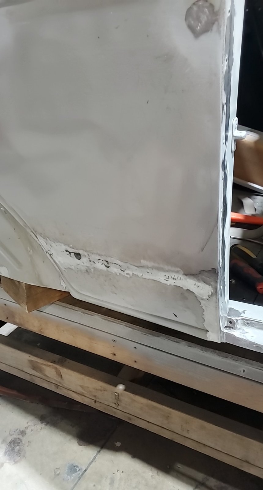

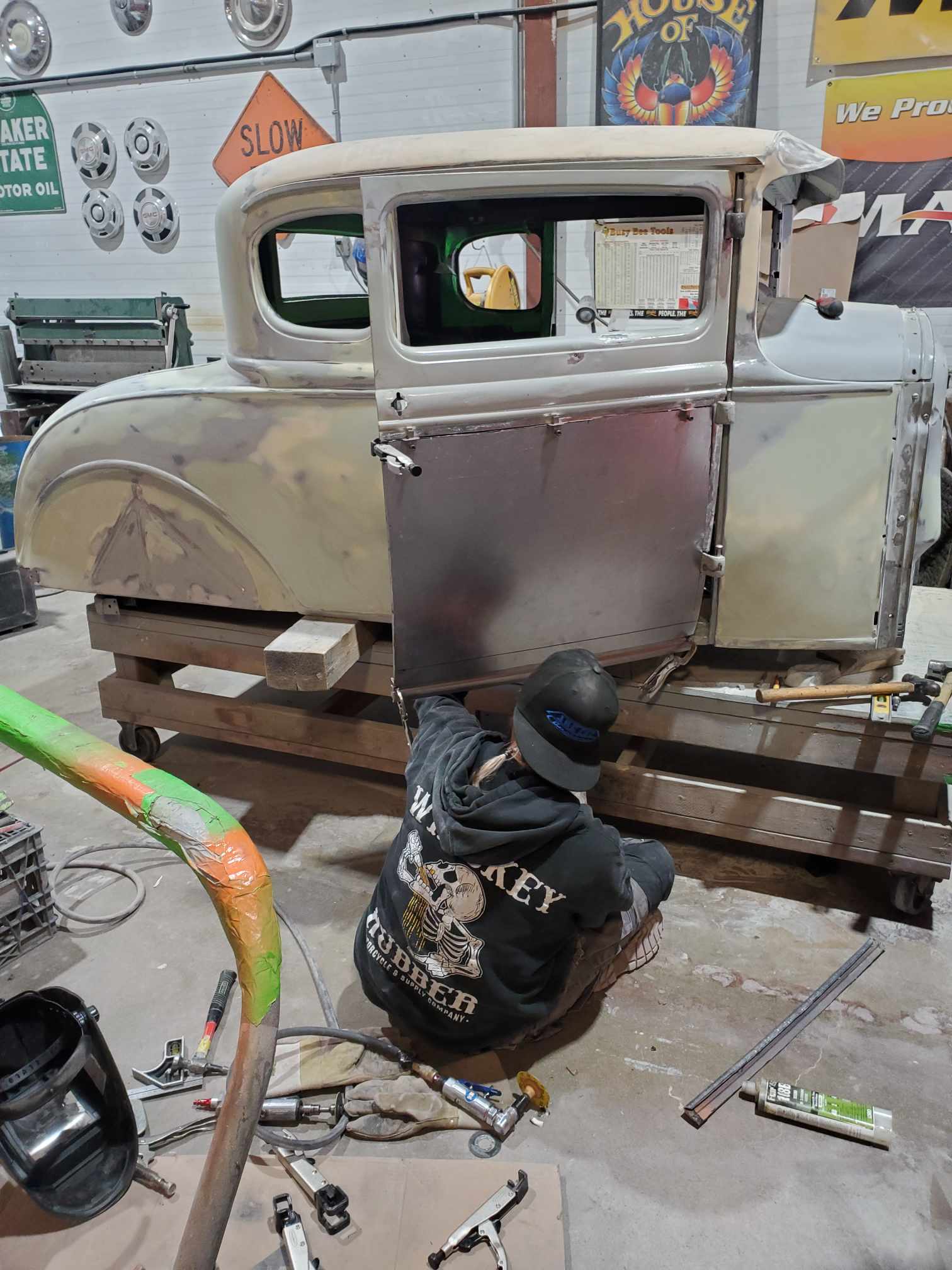

    P***enger door was pretty rough. Bit of work with the slip roller and and boom we have a door skin :cool:
    20240830_110106.jpg 20240830_110121.jpg 20240830_114531.jpg Messenger_creation_577F778D-34DA-454A-933D-91D0FEDF4B44.jpeg Messenger_creation_C36DB311-F1DC-4AEB-B1AA-1DC612B576B9.jpeg Messenger_creation_25BF60FA-B045-4737-B7E4-9B6ADFC0228A.jpeg

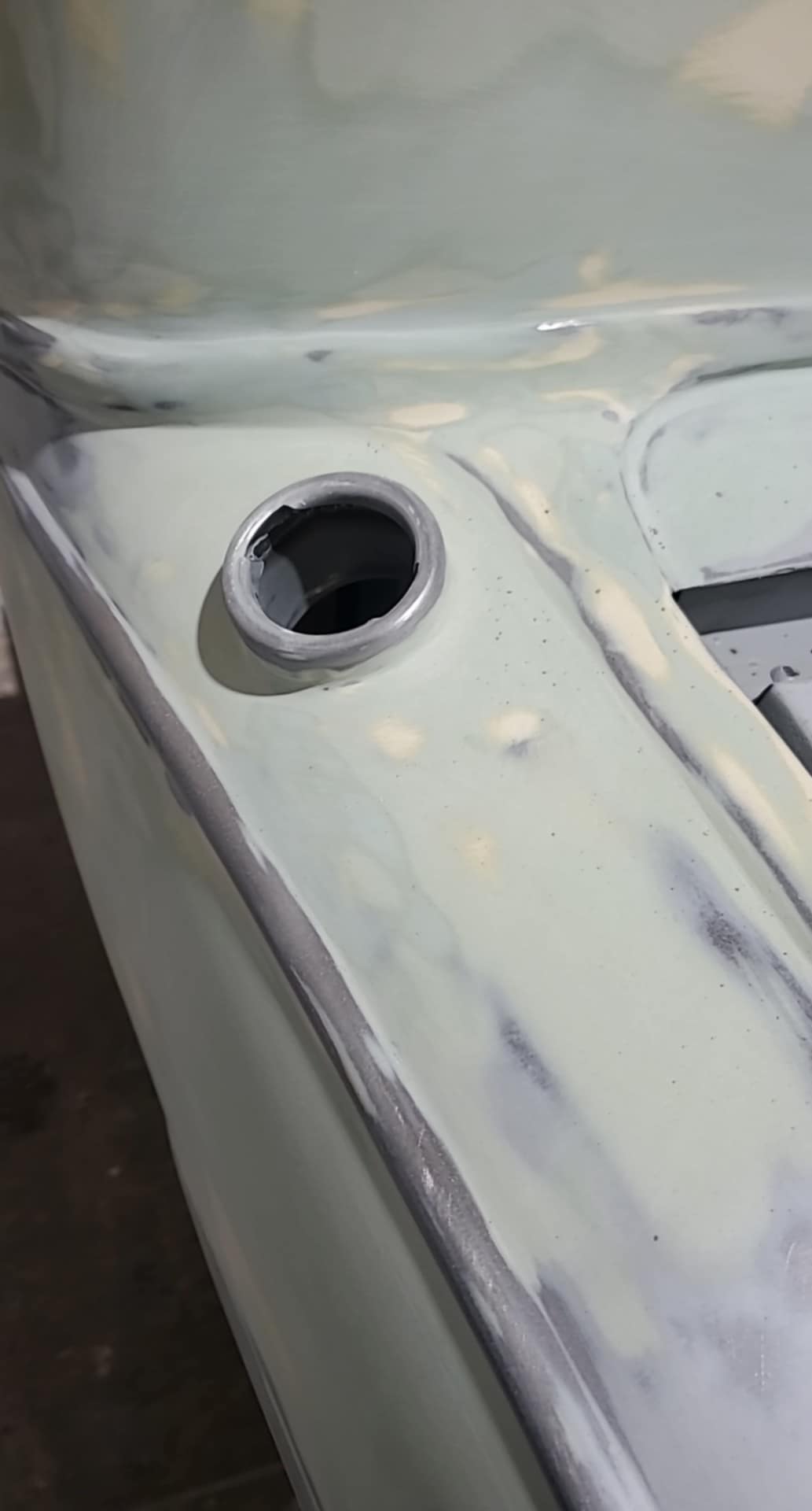

    Made the decision to move the gas filler neck to the outside of the car. As it moves along I've realized that it deserves a beautiful interior to match the exterior!
