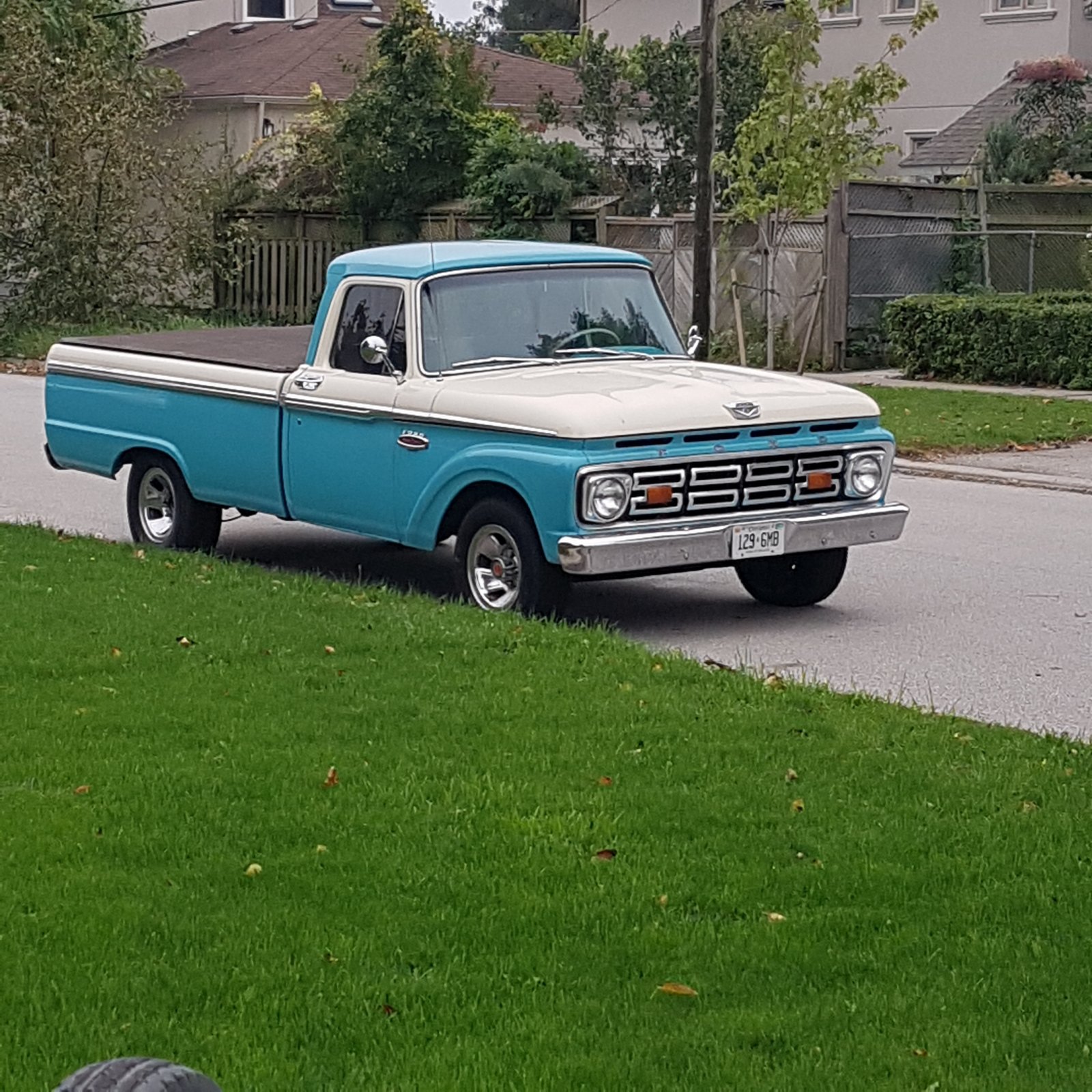

  26. Replaced the straight axle in my 64 f100 with a 65 twin I beam ,drives like a Cadillac never a problem with tire wear .
    I have had 6 ford trucks and Van's over the years and twin I beam never an issue . 20181008_112520.jpg

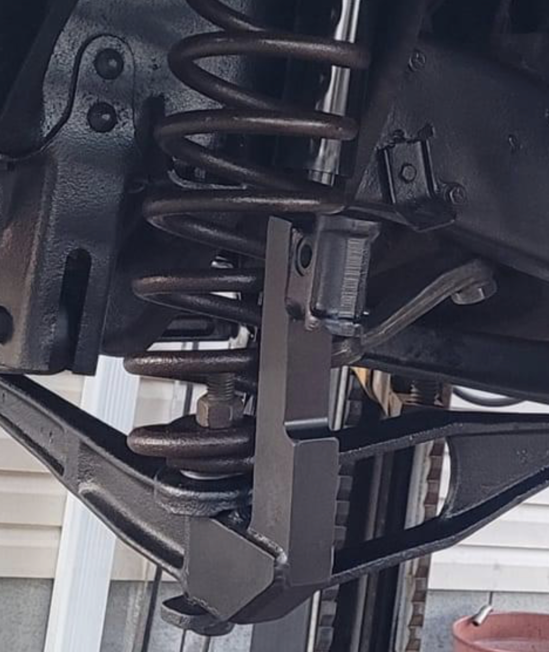

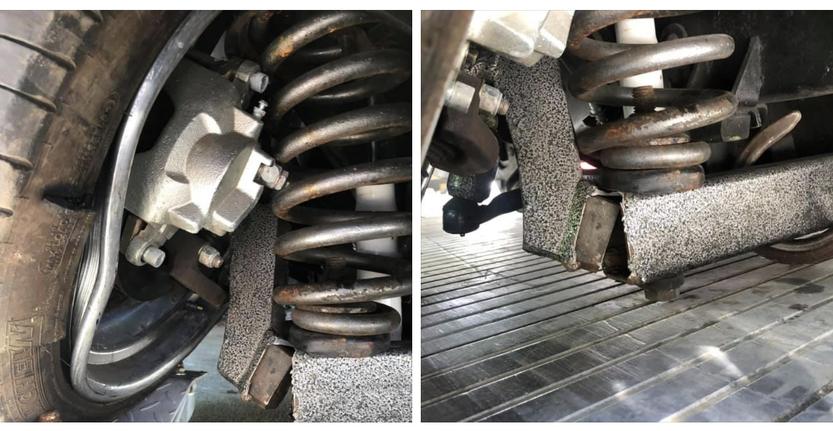

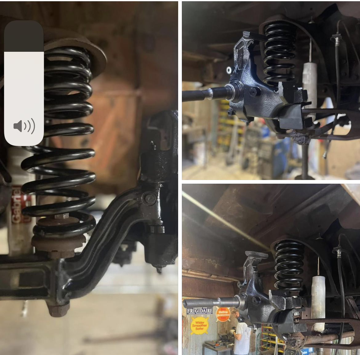

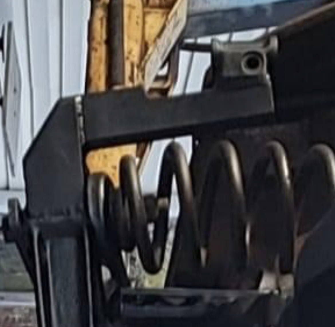

  28. Fabricated beams are out there.
    Beware.
    D4B4973C-F8EE-4909-AE99-10A7B3826E64.jpeg 4461190F-B8A4-4304-AC4C-CA01AED9FED4.jpeg 6B1D9778-B769-4A78-B1F2-9E37459D8D8D.jpeg
