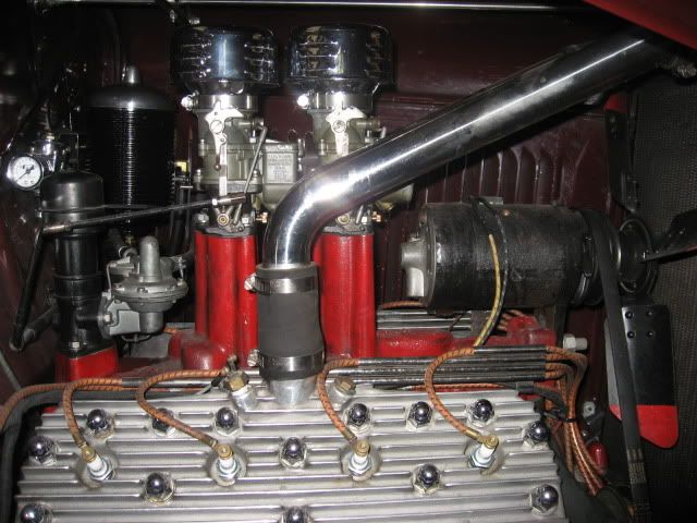

    I have a pair of Stromberg 97's on a Thickstun PM-7
    I spent the afternoon setting up the carbs with a balancer that indicated the intake vacuum.
    Bit of an odd thing was happening, I could get a steady reading on the rear carb but the front one diminished whilst the gauge was on there! Happened quite quickly, but happened as regular as clockwork.
    The motor has been running quite lumpy recently, hence the need to setup again.
    What could the reason be for this strange reading?
    I have one slightly tappy lifter (Adjustables) but the only thing I could think of was a intake gasket leak.
    Would this give the indication I have outlined? Or could it be a problem in the carb itself?
    Any help greatly appreciated before I start to take it apart.

    I have had the front carb apart, all checked out fine, fresh seals and gaskets.
    Couldn't see that the intake was leaking anywhere.
    What did I find that made a difference?
    The front slow running stop screw had gone missing!
    The rear stop was still in place, but I guess that the linkage was settling once the stop at the back was reached!
    The carbs both balance up now and I have an equal reading on both!
    Now to double check the timing (again!) but its back to chirping the tyres again!
