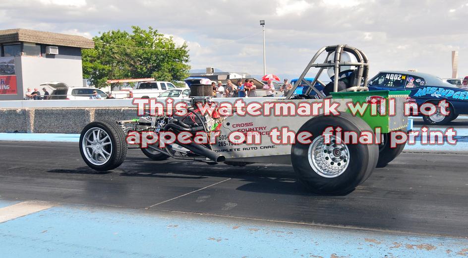

    It might be cheaper per gallon, but not when you tune for it.
    Alcohol requires more fuel to run the same distance or measured to the air entering the engine.
    The stoichiometric air/fuel ratio, which is 9:1 for ethanol, is 14.7:1 for gasoline.
    It pulls more heat from the surroundings when changing from liquid to gas (runs cooler).
    It also is more forgiving to tuning, since it's ratio is closer and it is less likely to detonate.
    I will tell you, when you start going quicker (9s, not 10s) and have it dialed, it does take some time to cool down between rounds and when they hot lap you, it can add up to running hotter than you want.
    This is from ten years ago, SBM, alky NA, tiny radiator. My friend's altered.
