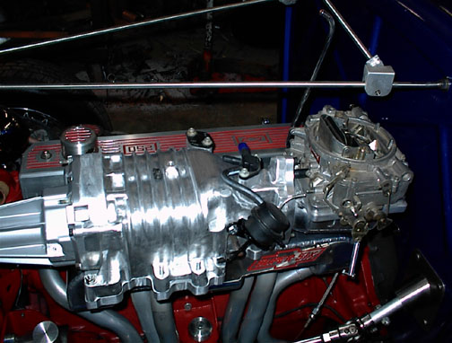

    Eaton superchargers can be mounted any way that works. Upside down sideways ,whatever.They DO NOT have to be pointing down! They can be run wet or dry.Eatons all have rear or side entry - Not suited to 4 barrel Carbs. WRONG!! see attached photos. The nose drive can be easily shortened or lenghtened. Allowing whatever placement is needed. Belt slippage if a problem(not likely) can be addressed by going to more grooved pulleys (available up to 16 grooves). The (attached) piped over version is an M-90 making 460 HP on a 292. TJM73s picture could be piped from each blower to a dual quad manifold without the box. Another opinonated expert says that if you can't afford the 3K for the blower you can't afford the rest of what you need to work well. Any engine will hold 6-8 lbs. of boost. I have customers who have been running 10 lbs. on stock engines for years with no problems.If you can fabricate this could be done for as little as $400.00. Lord save us from the experts

    Well said Gemini. It can definitely be done if the person doing it is rich on talent but not on cash. The install on the car pictured obviously took some serious fab work and some real talent to mount those blowers, fab that air box, and plumb the system. Impressive work especially considering how clean it is.
