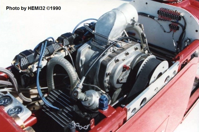

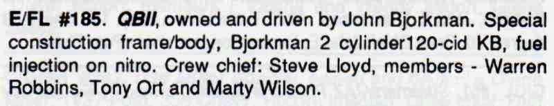

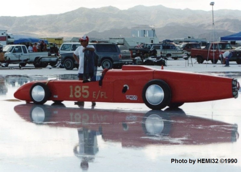

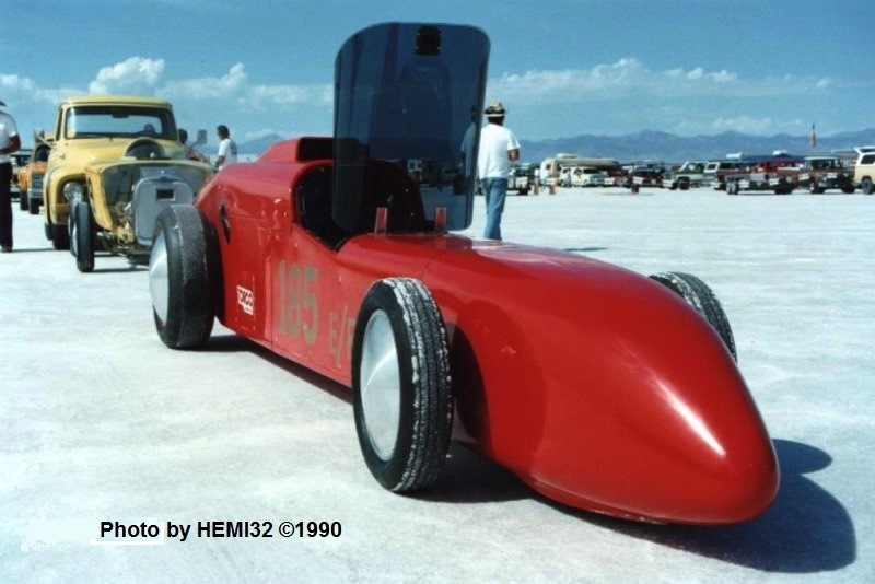

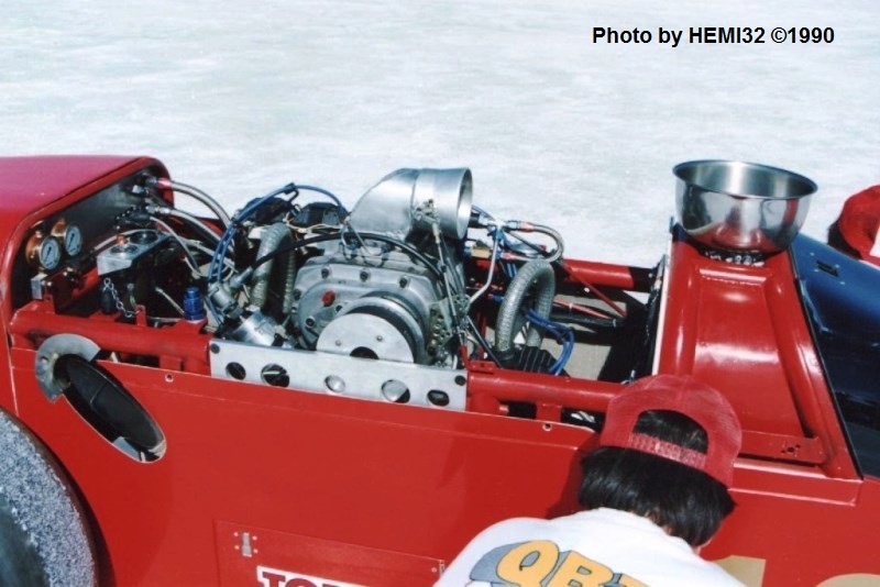

    Here's a few snapshots of John Bjorkman's "QBII" E Fuel Lakester on the salt in August of 1990 (i.e., at the 42nd Bonneville Nationals):
    Its "Two Cylinder (Keith Black) HEMI" sounded really pissed! :D

    Intake manifold looks way too small volume wise provided the blower can make enough volume for boost..Imagine severe pressure spike when intake closes..I bet it would run very well w/out the huffer..

    How come so many plug wires for a two cylinder?
  19. I was wondering the same thing, where the hell do all the wires go?

    This car ran at 1990 Bonneville as a fuel lakester. I have video of it running in the pits that I was selling a couple of years ago. It sounded like a huge Harley and was mated to a Cad El Dorado trans. He had handling problems and ran at near 170 mph. a real piece of work.

    I don't think you sent me the video. The V2 is such an odd fire engine, and loud, that at low speeds it sounds awful to me. But as the RPM climbed is smoothed out and sounded fine. Especially when Glen announced the speed. It runs standard fuel Hemi V8 magnetos. So it has lots of extra wires. The unused leads just go to ground. I don't think you would want to grab the frame when the engine is running. I wounder how they handled that?

    Ground is ground, no different than going through a spark plug..?

    That's the plan. I am just not sure if you could get involved in the path to ground by grabbing the frame. I guess not or it would be very hard to tune the thing when it's running. I know I wouldn't much like grabbing a spark plug wire. I have a pacemaker and not supposed to get close to any ignition on a running engine.

    The unused plug wires are grounded by installing the sparkplugs in an ionized chamber with sufficient pressure to fire properly. This is how we ran the four cylinder hemi with 8 cylinder mags.

    The KB2 appears to have some kind of crank trigger ignition without any extra plug wires. The pretty engine on the trailer has lots of extra wires. The whole ionized chamber deal is new to me. I thought you would just tap a plate on the frame for spark plugs and run the wires to them.
  28. I don't know why you would have to have pressure on there plug they will fire just fine at atmospheric pressure. The mag doesn't know if there is compression or not it is just a dumb generator.
    I wonder why you couldn't adapt a Joe Hunt Harley type mag head to the Chrysler drive, and fire it like a hawg, Both cylinders always firing all the time, one on intake and one on exhaust.

    Ionized, however, seems 'sound'...I'd hate to be around 50KV fired plugs just sparking off a plate... 'ZAZZZ'... Yeah, please put a box around all that!
  30. If you rubber mount the engine you could hang the box or plate off the motor and isolated from the frame. All that is a 20 dollar cure for a 10 cent problem. its a 2 cylinder motor and they sell magnetos for 2 cylinder motorcycles.
    here is a trick that we use around here for late model motors that have to be computer controlled. The Pontiac quad 4 for example uses a crank trigger, but you can snag a magneto for a 4 cylinder Yamaha and belt drive it. No reas0n why that would not work the V twin hemi, snag a mag for a twin cylinder bike jap if that floats your boat and belt drive it, Done deal and no whacky off the wall solutions to deal easy peezy.
