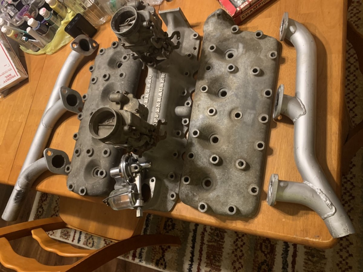

    Soo I pulled the heads off my little Flatty to put my new heads on... and I seen two of the holes have 050 pistons and the other 6 have 060.... not sure where to go from here... lol I had it cackling over and the pistons fit tight in there holes but it’s driving me nuts now that I know... any ideas fellas? IMG_8370.JPG
