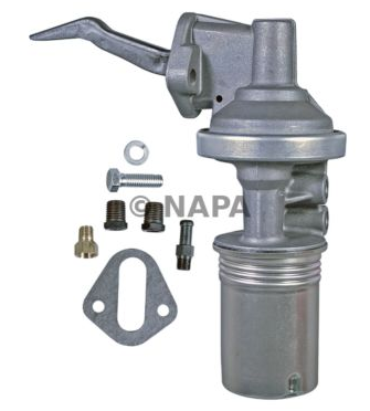

    No, it's a mechanical style with the "canister" filter on the bottom of the pump. upload_2015-6-4_15-24-26.png

    Definitely a belt and suspenders approach but all of my builds get a filter coming out of the tank and between the pump and carb. I prefer the metal canister type under the car and the clear type under the hood where you can see if there is trash in it. I also run the dual inlet gas line on my Holley carb that is tapped for 1/8" pipe tap and screw in a small pressure gauge so I can tell if there is a pressure problem.

    most of the crud you will see in todays gas is the chemicals they put in it ( detergents and octane chemicals ) when it evaporates , a second filter will help but it should be a finer mesh than the primary , a modern fuel injection metal filter would work in that spot better than a paper element filter as thats the micron size of the primary filter , the thing is with a fuel injection filter is they have to have pressure behind them as they are a slight restriction and need it to push the fuel thru it it doesn't like to have a suction applied to it as it will cause a vapor lock style condition from the vacuum because of it .
    they do make small micron filters for non Fi units that work for carbs . that are a smaller physical size . I do not like gl*** or plastic anywhere near heat or metal specially with gas inside it .
