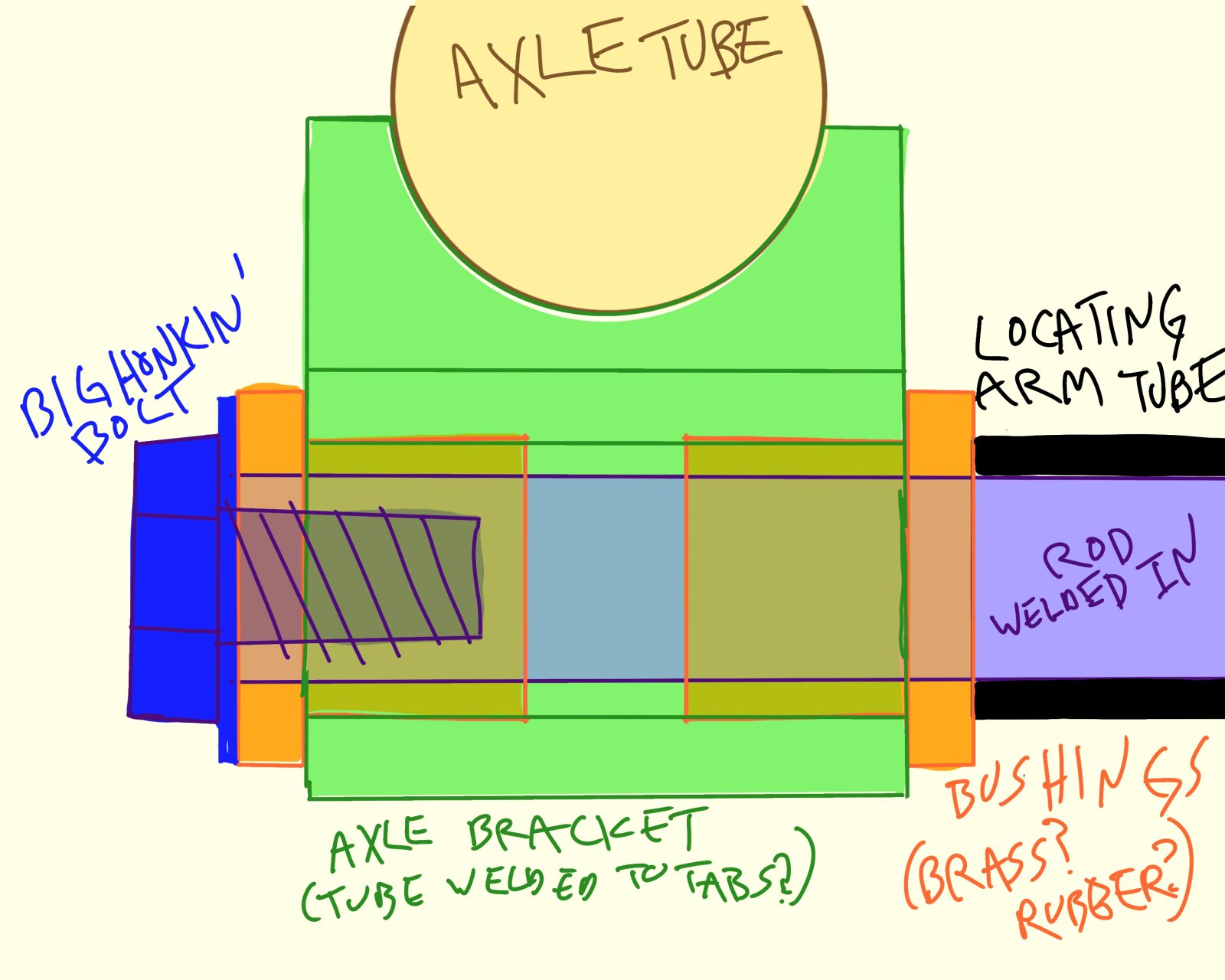

    Pardon the sketchy drawing.
    I've been reading up on airbag set ups and the pros and cons of different rear suspensions. This popped in my head as a way to do a two link and allow the axle to freely articulate with relying on flexing arms. Basically just let the arm pivot at the axle with a long enough axis to prevent axle twist.
    I can't be the first person to have this thought and I'm sure there's some reason I haven't seen something like it.
    Thoughts? Suggestions? Links to "Simpsons did it first"?

    This isn't intended to aid in lateral locating, just to keep the arms from binding when one wheel goes up and the other down. A panhard bar or watts linkage or such would still be needed.

    Basic thought on the 'big honking bolt'.
    No matter how tight you have them they would come loose with the twisting of the suspension.

    I thought about that while sketching. Prolly a threaded rod and castle nut would be better.

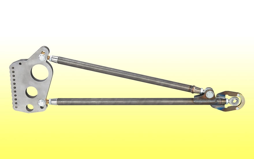

  28. Andy
    Joined: Nov 17, 2002
    Posts: 5,390
    Andy
    This really works great. Simple, cheap, equal traction, and no bind. Anti squat and anti dive. The off center bar equalizes the frame twist and loads the right wheel. This is the latest version but I have used several variations. I did a thread on it. P1060980.jpeg
