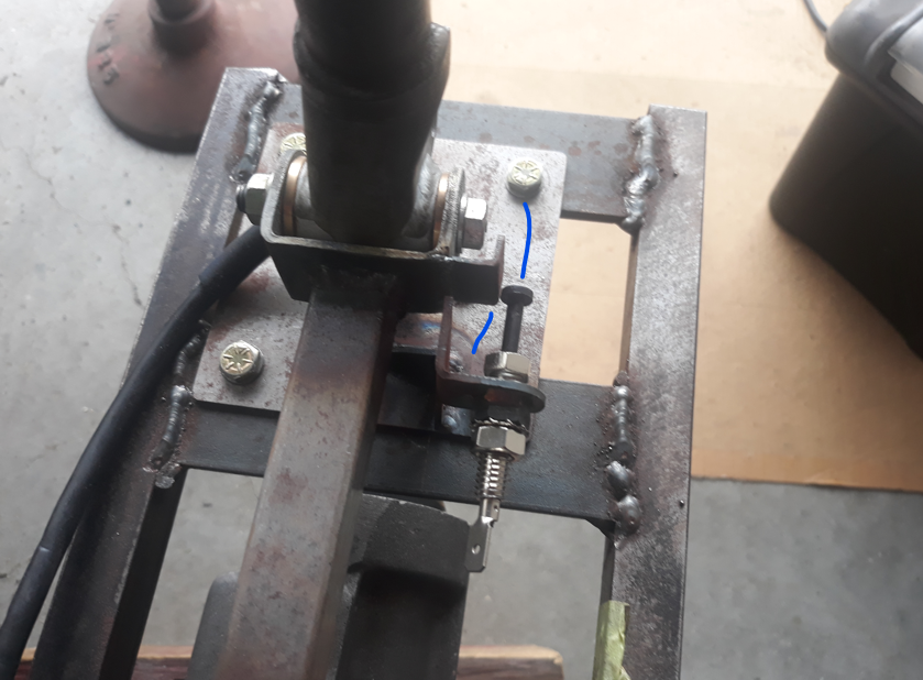

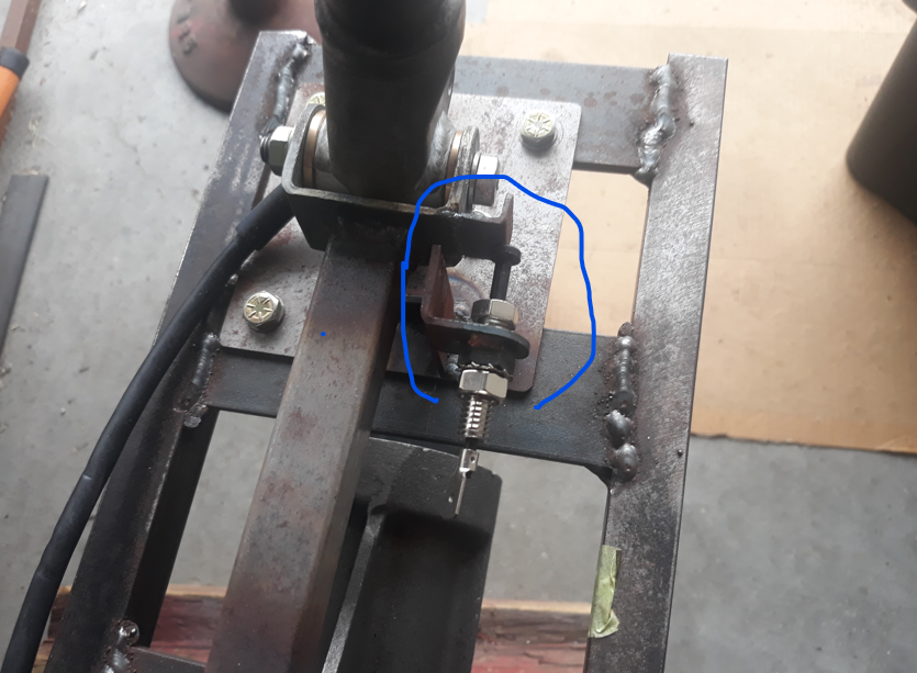

    A switch would be easy to hide under a shifter boot on the floor.
    Just weld a tab on the side of the lever, so it catches a micro switch when engaged in reverse.
    Here's a grounding switch on a O/T remote shift I am making [this one is designed to break the ground on the reverse lockout solenoid when in 1st gear]
    Also note: the tab is bent [L shaped] so it cannot catch behind the "mushroom head" of the switch
    In 3rd
    Note all the bracketry is to dummy set up the shifter outside the car
    The other method is a latching ****on on the gear shift [push-on, push-off] but connect a piezoelectric buzzer to this so it beeps in reverse ,and you know to switch it off.
