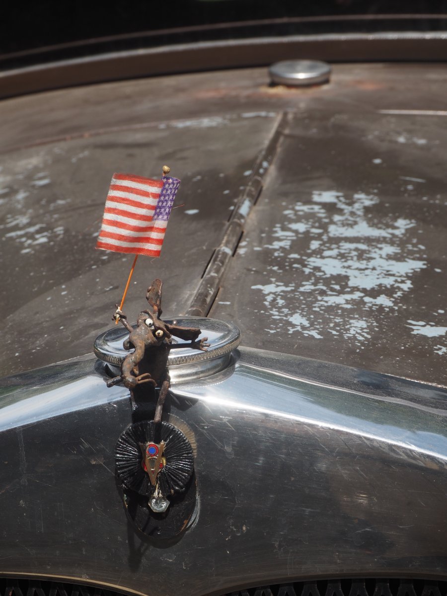

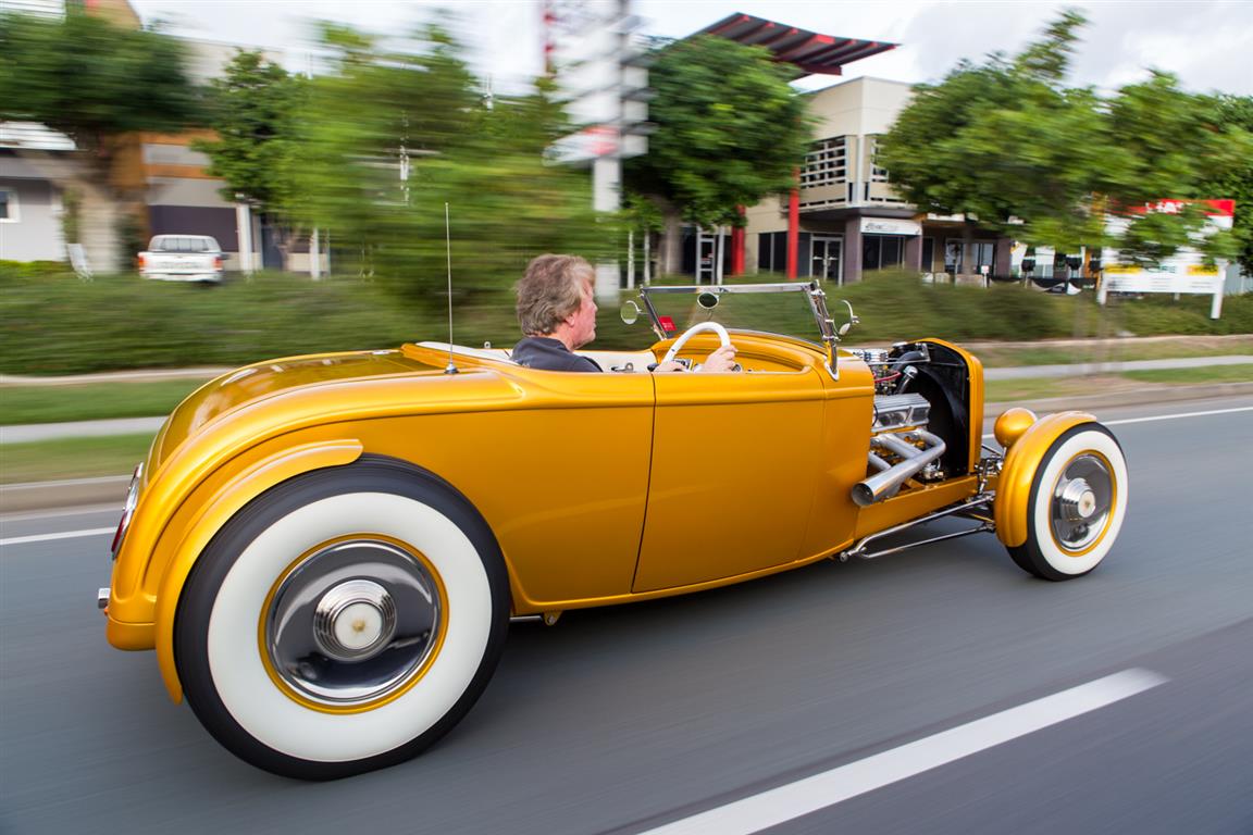

    On my 32 roadster which is very light I run 18-20psi front and around 15psi rear. Mine rides harsh also because we need to do rear spring work to soften the ride but the lower pressure helps to cushion the ride. I am running bias ply all round. 2U3A6611 (Medium).jpg
