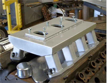

    Here are several..Some by Matt..
    Duane
  28. Wow, they are gorgeous!
  29. mercjoe
    Joined: Aug 17, 2006
    Posts: 1,443
    mercjoe
    Those are incrdible. What Matt are you talking about ?
  30. strombergs97
    Joined: May 22, 2006
    Posts: 1,888
    strombergs97
    saltflatmat...Lakeheaders..Minn..Matt..I got the 241 (4x2)...392 (4x2 inline) and the Desoto (4x2)..The log SBC 4x2 was built by the same person that built the others..I'm having 6x2, 392 being built plus a Flathead with interchangable tops..
    Thanks for the comment on my work..
    Duane.
