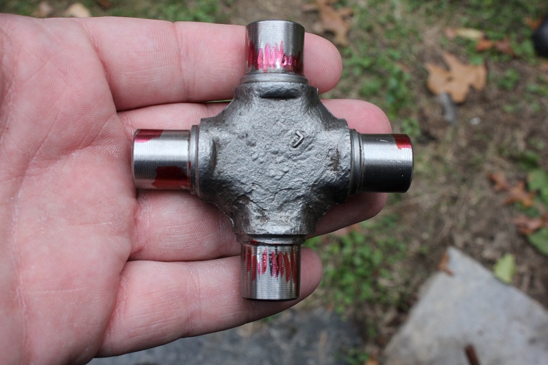

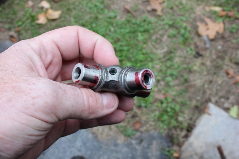

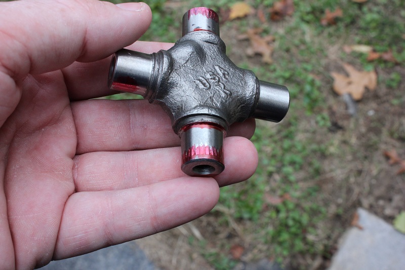

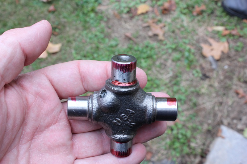

    There are some unusual wear patterns on the u-joint in a 1940 ford car. The car has a 350 with a 400 turbo in it there are also some vibration problems. The vibration problem is only during coasting while the car is in gear and not while the car is in neutral and coasting but in gear and coasting. I am nearly positive that the vibration is not there while accelerating but I am not 100% positive about that. The rearend in the car is a 8" ford from a 70's era granada. I am not sure if the vibration is the result of the u-joint wearing or caused by another underlying problem the angle of the rear axel is 2 degrees pointed down this is all of the information I can think of to provide to help solve this.
    Here are some pictures of the offending u-joint I marked with a red marker all of the wearing patterns on this ****er u-joint. To explain a little about what you are seeing of the many angles the easiest way to understand what you are seeing is the galling (gouging) is on the axel side of the u-joint the other side has some shiny spots on it and the shiny spots are on the driveline side of the u-joint. the wear patterns are 90 degrees apart from one another so that means the wear on the driveline side is not facing you when you hold the u-joint in your hand but the wear on the axel side is facing you when you are holding it in your hand and looking at it. There is some wearing on the very ends of the u-joint too but I think this is probably normal. The u-joint that was removed last year had wear patterns exactly like this but I did not think much of it at the time.

    It may be that your car just don't have angularity for the U-joint to work as it is should. U-joints with less than ideal working angularity often exhibit the wear you have there. The bearings just aren't getting worked through the cycle as they need to be for long service life.

    I dont know what the actual torque I put on them was but I took a wrench and tightened the nuts up then I stuck another wrench on that and torqued them down at the advice of the gut that built the driveshaft.
    The u-joint has gouges on the driveshaft side where the u-joint was tightened and the small roller bearings gouged into the actual metal. The wear on the driveshaft side is not bad but just shiny spots. I dont want anyone to think that all 4 sides of the u-joint are gouged deep take a close look at the pictures and you can see what I am talking about.

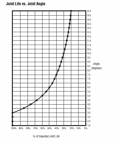

    i believe your vibration and u joint troubles might be two separate issues.
    1. the u joint wear is brinelling caused by a lack of a u joint working angle, make sure the u joint and drive shaft are NOT parallel. a working angle of .5 of a degree is an absolute minimum.
    2. the vibration on coast could very well be a loose pinion nut or a lack of preload in the pinion bearings. changed the yoke or seal lately?

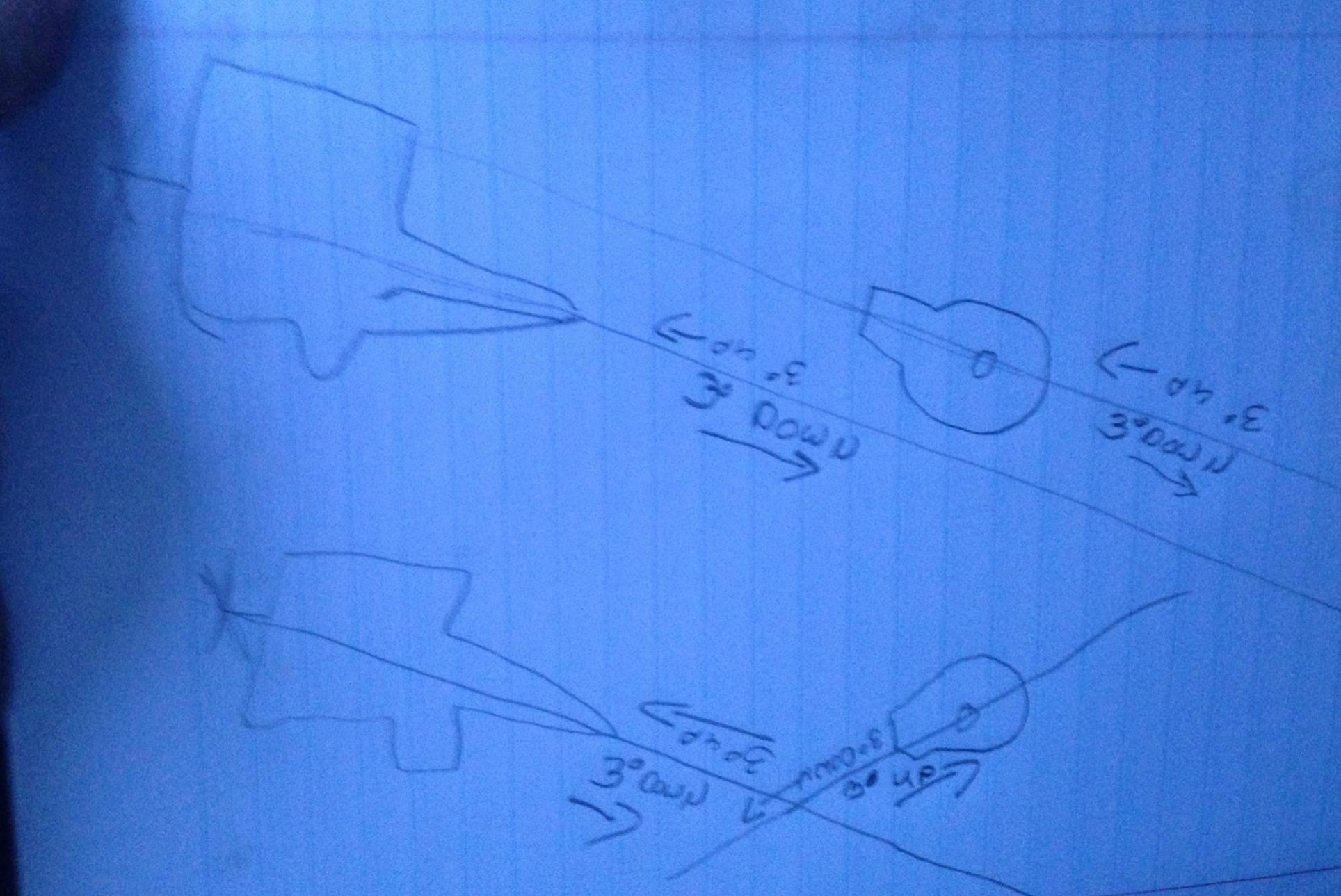

  28. There is no way that your rearend should be pointed down ... your setup is out of phase.
    With your car's suspension loaded the imaginary line of your crankshaft/output shaft (they are a straight line) and differential shaft should be parallel.
    You can put your inclinemeter on your oilpan to block mating surface to get your forward angle.
  29. This Up, down ******** drive me ****ing crazy!
    Makes me want to set myself on fire ( thats pretty crazy huh?)
    Notice in the top sketch the lines are parallel.
    Parallel means both are going the same direction - exact same direction.
    Since we all like to say "engine down" implying toward the rear then the pinion is also going down toward the rear.
    Notice in the lower sketch the lines intersect.
    Intersect means they are heading in different directions (not 180*) and will eventually cross if extended both ways.
    Once again:
    Since we all like to say "engine down" implying toward the rear then the pinion is going up toward the rear.
    And BTW either way will work correctly if the ujoint working angles are set equally.
