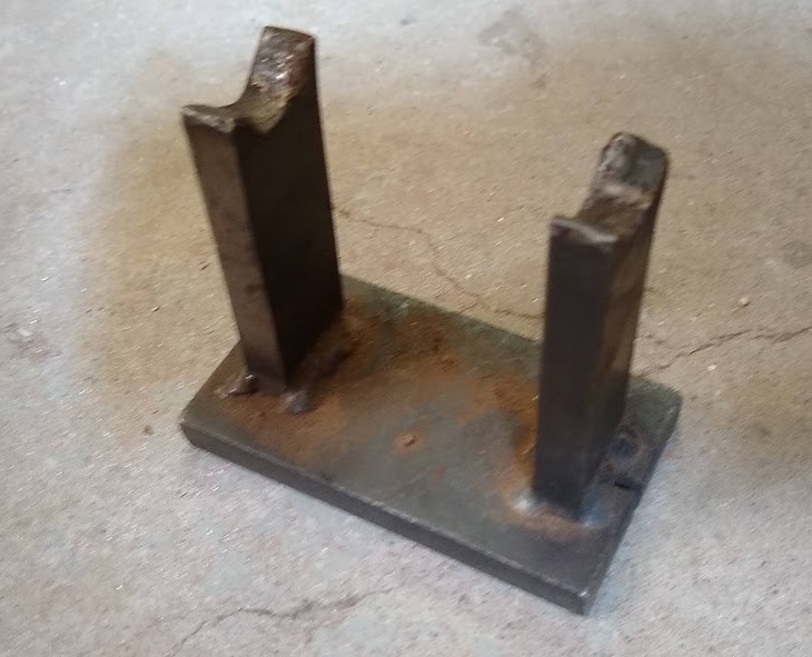

    Depends on the driveshaft, if it's easy to hold I do them in the vise, if not I lay it on the floor and use a couple sockets and a hammer. I also make sure to file the holes where they get burrs from removing the old joint.
    I made a little stand to hold up the cross when dis***embling the joint.

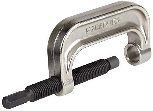

  11. 62SY4
    Joined: Oct 30, 2009
    Posts: 102
    62SY4
    from Irwin, Pa
    Haven't messed one up (hammer and block of wood method) since buying one of these... Much easier.

  15. I have used all the above methods over the decades, then one day I got one of these....
    loudbang, pitman, Boneyard51 and 2 others like this.
