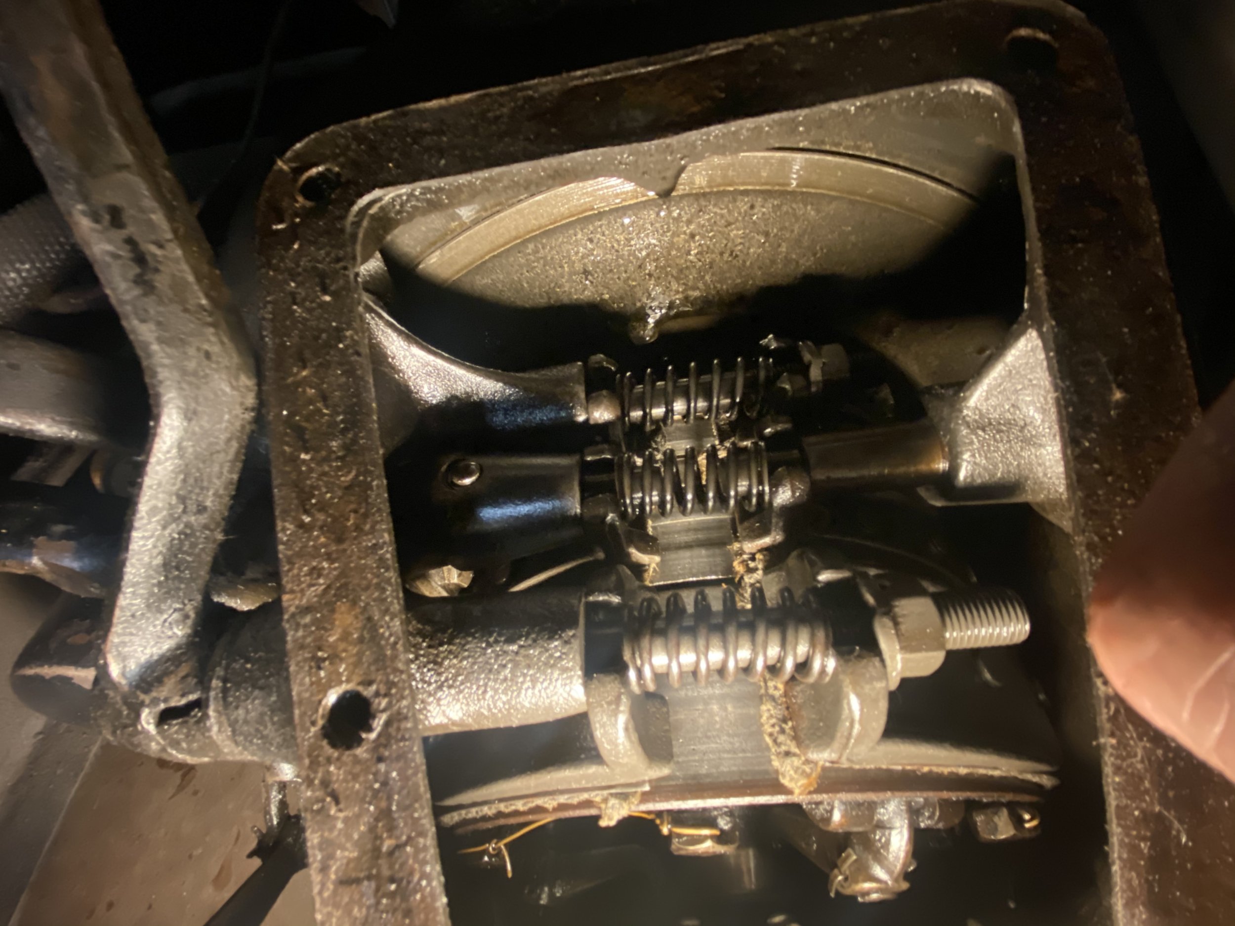

    Above is the Model T Planetary transmission. For those of you that do not know how these work, it’s a 2 speed transmission with brake and reverse.
    Ok.....
    There are three drums, starting from bottom to top,
    Brake band.....(it’s big on ‘26 and 27’s.
    Drive band Hi-Lo
    Reverse band
    When the pedal is mashed those bands lined with either cotton, kevlar or wood, grip the drums giving, hi gear, low gear, braking or reverse.
    The linings look OK to me.
    My drive drum does have a deep groove and is damaged probably by being run with no fabric ( metal to metal). This is not unlike running the rivets into the brake drum.
    It might be ok. We’ll see.
    Oh this drum set up connects to the flywheel through a set of planetary gears.
    Oh, I had that open to change the oil.
    It’s a good idea to saturate the transmission bands with oil at oil change. I poured in 3 quarts here and 1 quart in engine cap.
    I’ll have to open the top pet **** to confirm oil level.
    Mode Ts do not have dip-sticks.

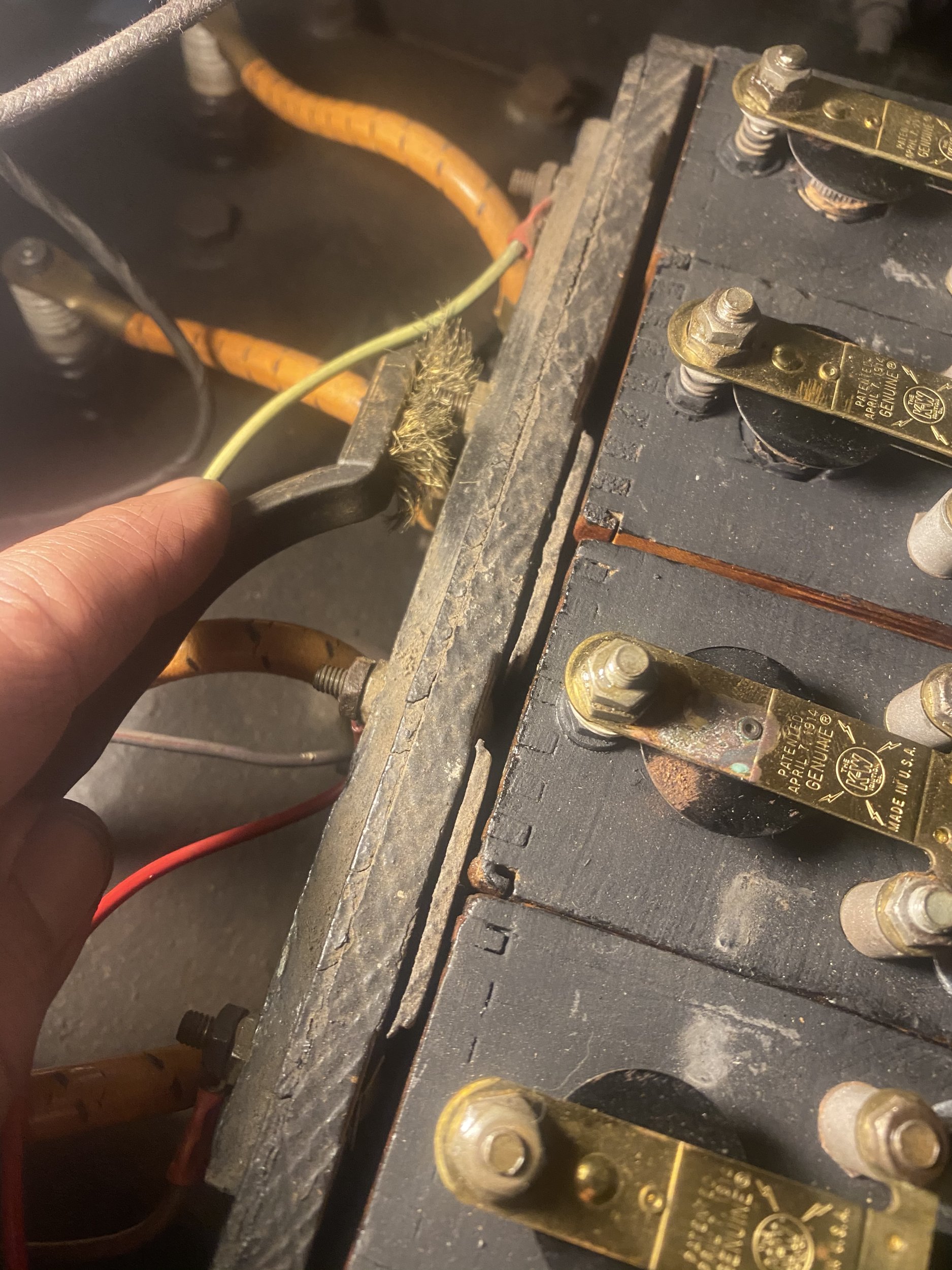

    Here I have my brush cleaning connections.
    I started at the plugs and worked my way to commutator. (Timer)
    In a way, the Model T engine is not unlike the Ford Modular engines with a coil per cylinder.
    Things do come back around.
    I’m not happy with some of the connections here.
    It’s not tightening up, I’ll have to look into that.

    After cleaning the plugs and coil box up, I was able to run the car for about 4 seconds, then nothing.

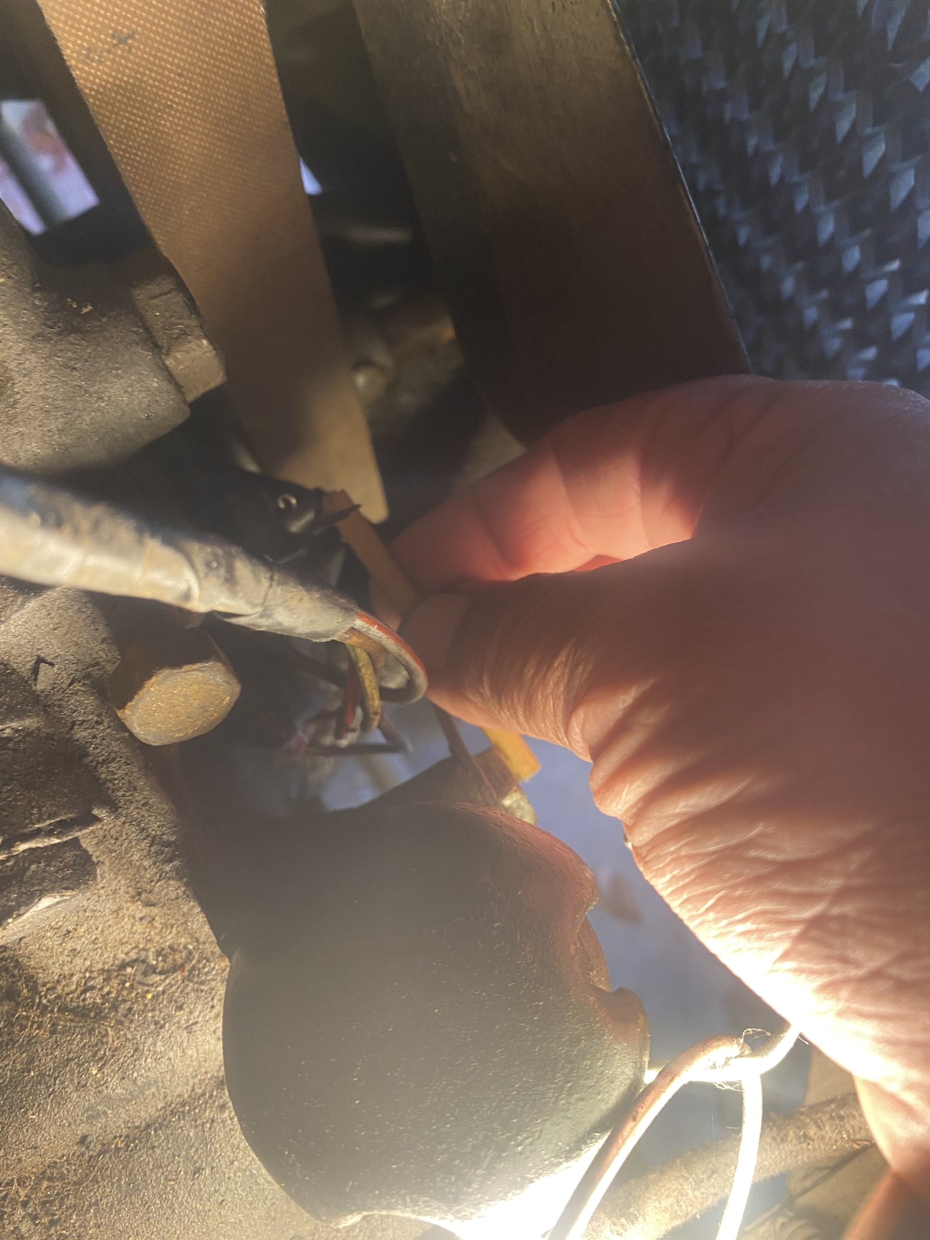

    Next I went to the commutator or timer. The connections there were horrendous. I spent quite a while cleaning posts, and filing nuts.
    After I was done cleaning up the commutator connections, I expected it to run.
    No go.
    I’ll have to get back into it today.
    I’m not real happy with the commutator wiring. It looks to small, about 14-16.....
    I would prefer 12 or even 10.
    When too small a gauge wire is used, there’s no margin of error.
    I may have to order or make up a new timing harness.

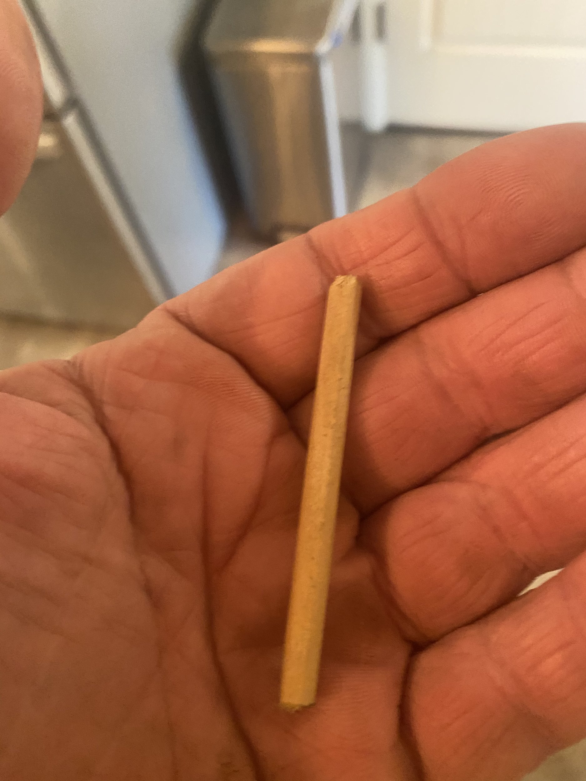

    I did have a first changing the oil.
    It's the first time I have ever seen freaking rocks come out of the oil pan.:confused:

    Might want to run a little something (diesel, kerosene?) thru to rinse things out!
    Like I said, sympathetic fiddling.:)
    Those are probably carriage bolts and the wood is soft around the square hole.
    Outback and F-ONE like this.

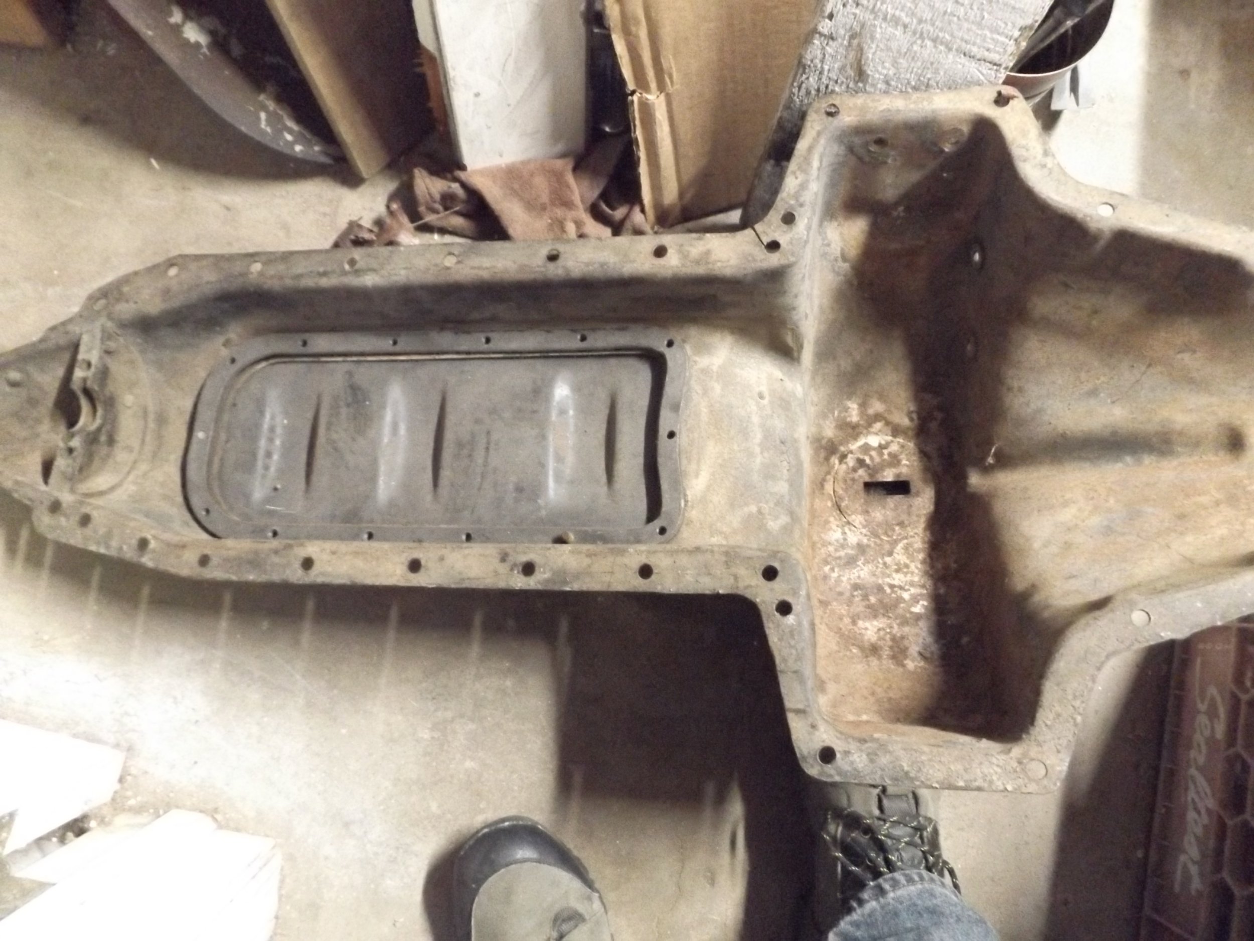

    If you see rocks in the oil you may want to drop that inspection cover in the pan. DSCF2218.JPG

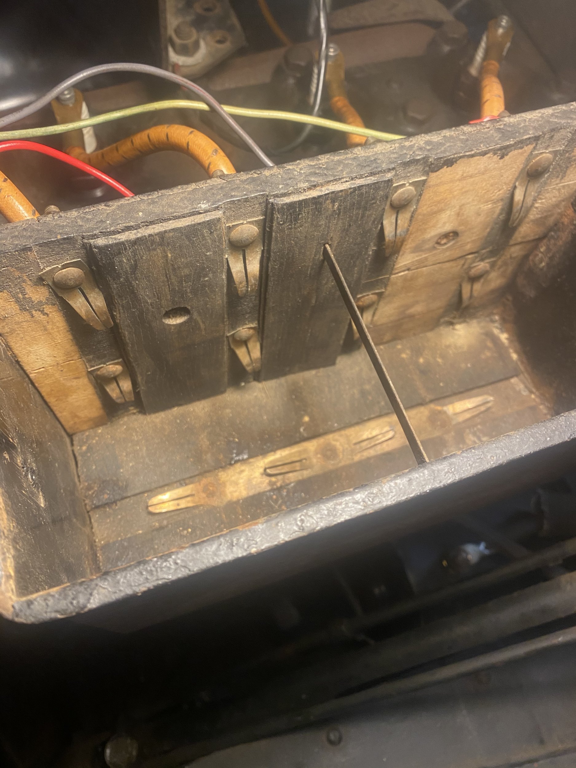

    I’m going to see if they’ll come loose. I do have some penetrating oil on the nuts.
    If they don’t come loose or they wallow wood I’ll have to pull the box and rebuild it with some new wood pieces.
    Sympathetic Fiddling!!!

    If I have to pull the coil box and rebuild it, I’m going to pull the plugs and get some kerosene or diesel and turn than crank, pull the inspection cover and clean.
    I guess I’m trying to say this is going from “getting it to run” to “sympathetic fiddling”.

    Call up Lang's and get the gaskets so that pan removal/inspection/replace project only takes a few hours. Fairly sure every piece of the coil box is also in their catalog. Bob

    I’m going to pull the coil box and rebuild it. It looks like the commutator harness and plug wires is going have to come with it.
    I’ll put on the bench and see what can be saved.
    Since my oil was so dirty full of debris I’m going to drop the pan clean it out.

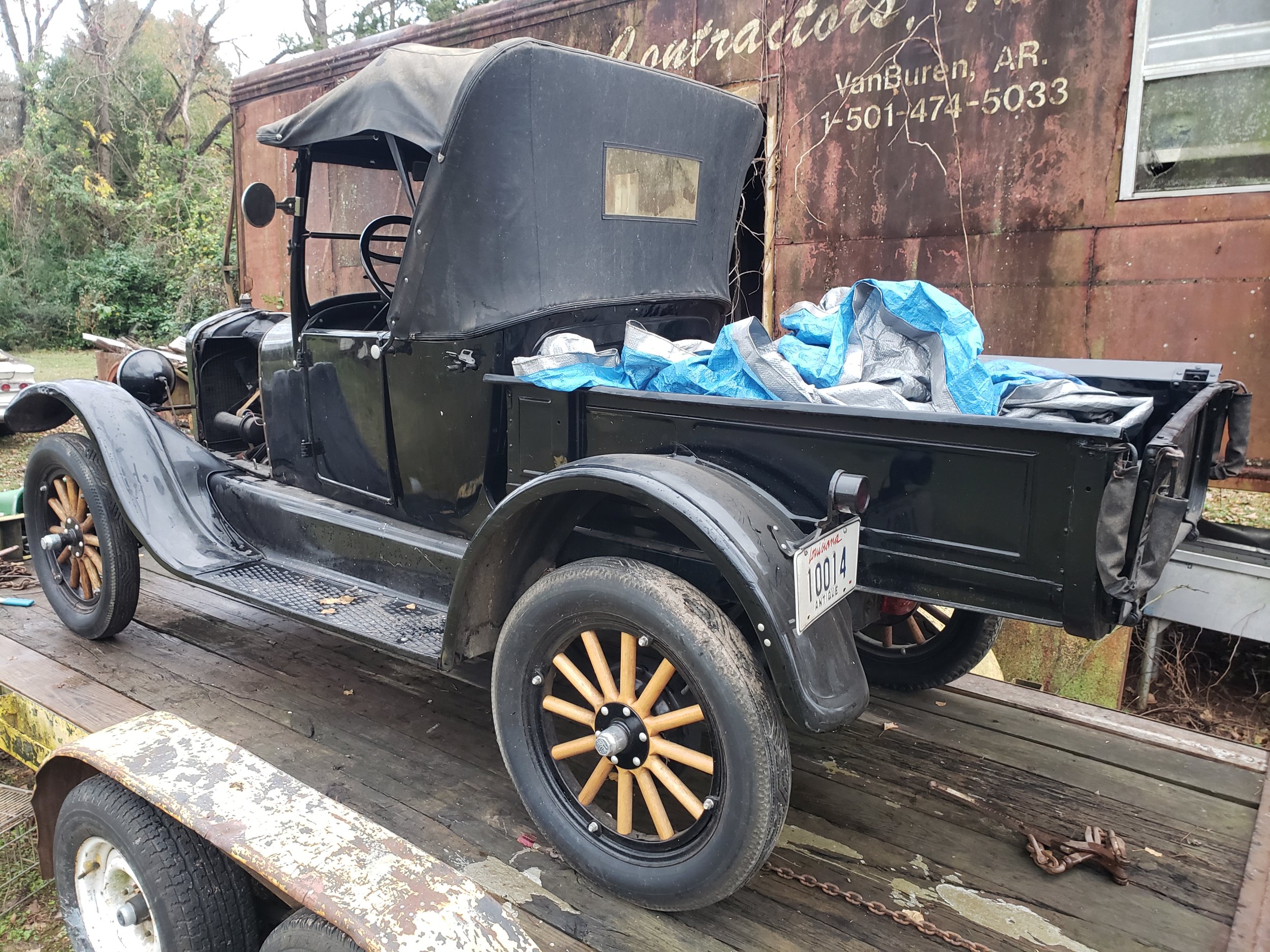

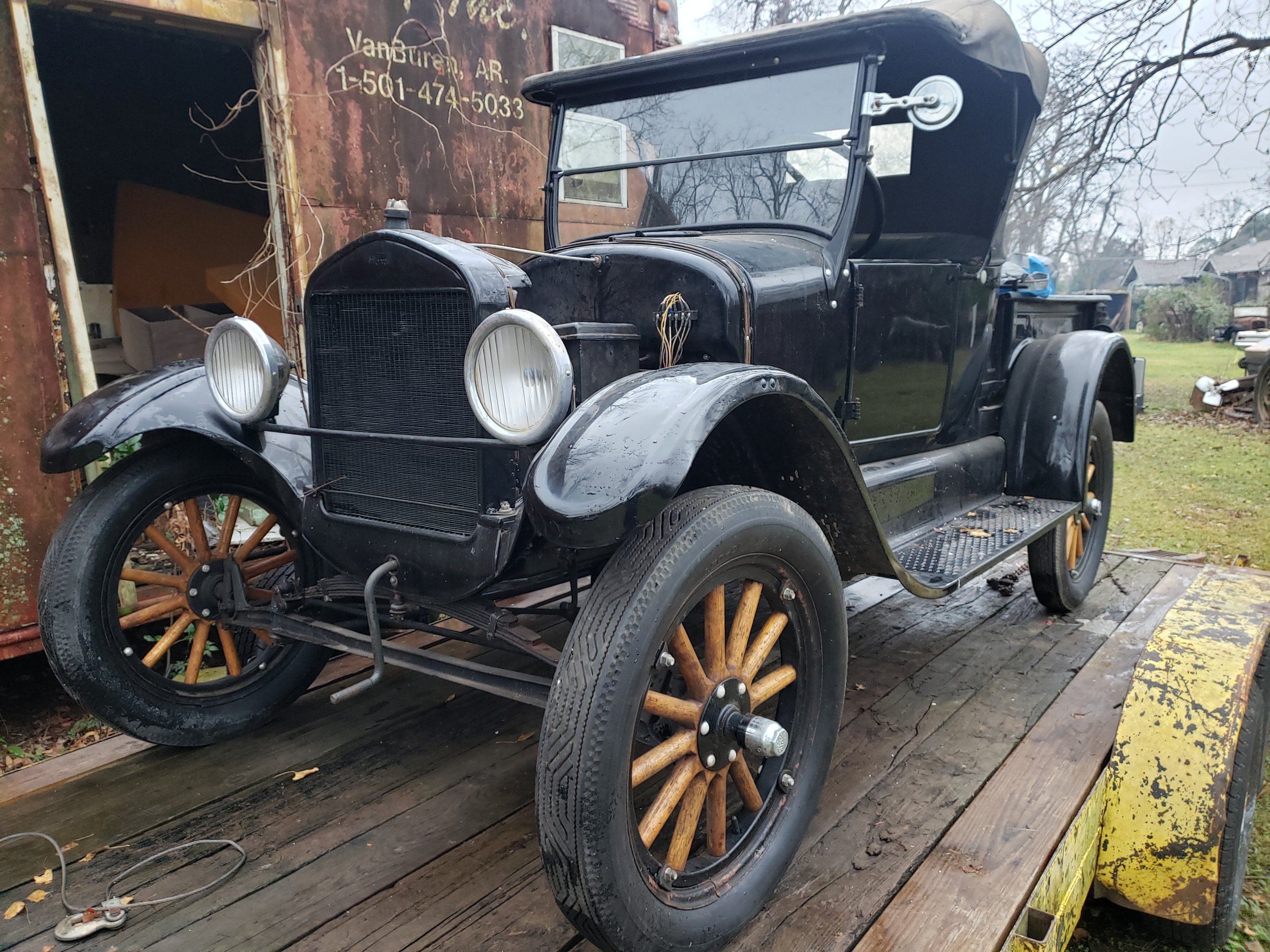

    D94EED3A-0FF7-45BD-8BE2-2A11A298737F.jpeg My stuff came in from Lang’s.
    It’s an original starter blank off plate, a bendix blank off with all new screws and gaskets.
    Now I can properly remove the starter for a future rebuild.
    Upon further inspection all 4 wheels are history.
    They are done.
    On the back as I had the rear wheels up, I could rock the back drivers wheel 1/4 turn. I thought the brakes were not holding. Then I noticed the hub was stationary. Yep..... there’s 1/4 turn of slack in loose spokes.
    On one of the “good wheels” on the front I noticed some flaky paint on one of the spokes at the hub.
    So, I started picking at it. I could have bore my index finger through it. It’s rotten.
    They’re done. It’s a wonder the car made it on and off the trailer.
    These are demountables with the steel felloe. That’s a good thing. Although I could build a spoke press and install new spokes, the truth is I’m not a wheelwright!!!!
    We’re talking about the same money. For the same money, maybe even cheaper, I can send the wheels off and have them spoked by a professional.
    It’s $ 185 to 200 bucks a wheel. That’s not bad.
    That’s what I ‘m going to do. It may take 6 months but I’ll have new wheels that can actually go down the road.
    There have been ModelT fatalities due to collapsing wheels. Many more wrecks due to the same issue.
    This is something you do not mess around with.
    The option of wire wheels.....
    Converting a T to wires from wood is prohibitively expensive for me right now. This means new hubs adapters and all that. It’s probably a wise upgrade but I do like the wood spoke wheels.
