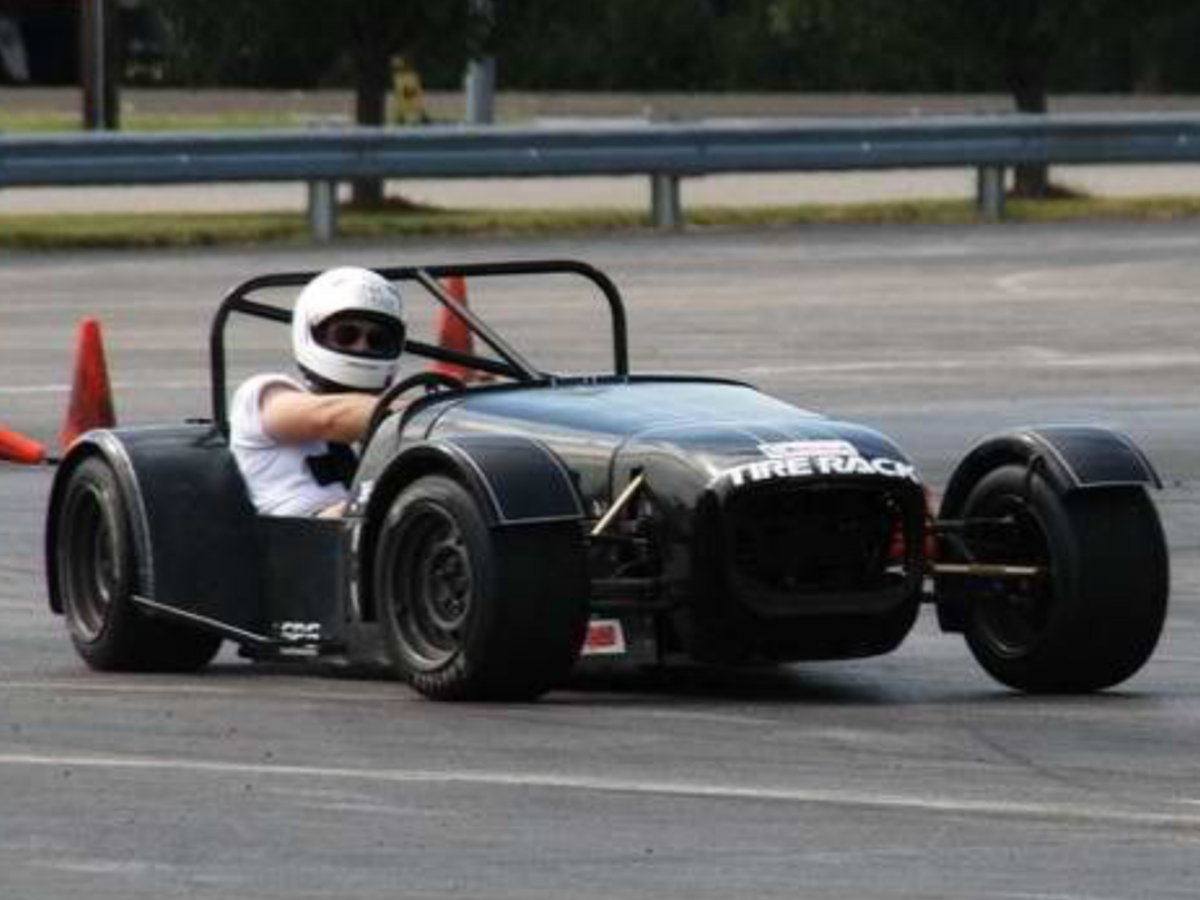

    Lotus made them from 1957 to 1972, and then licenced the design to Caterham, who haven't been able to prevent numerous others from building clones.
