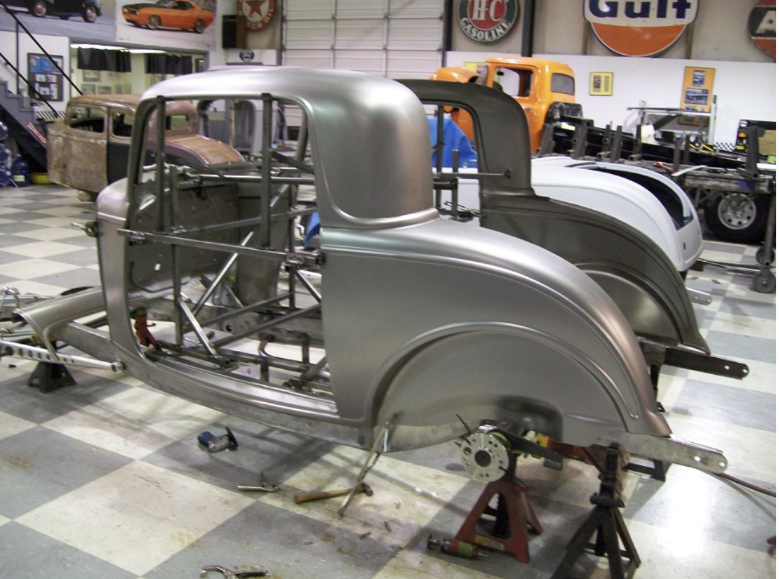

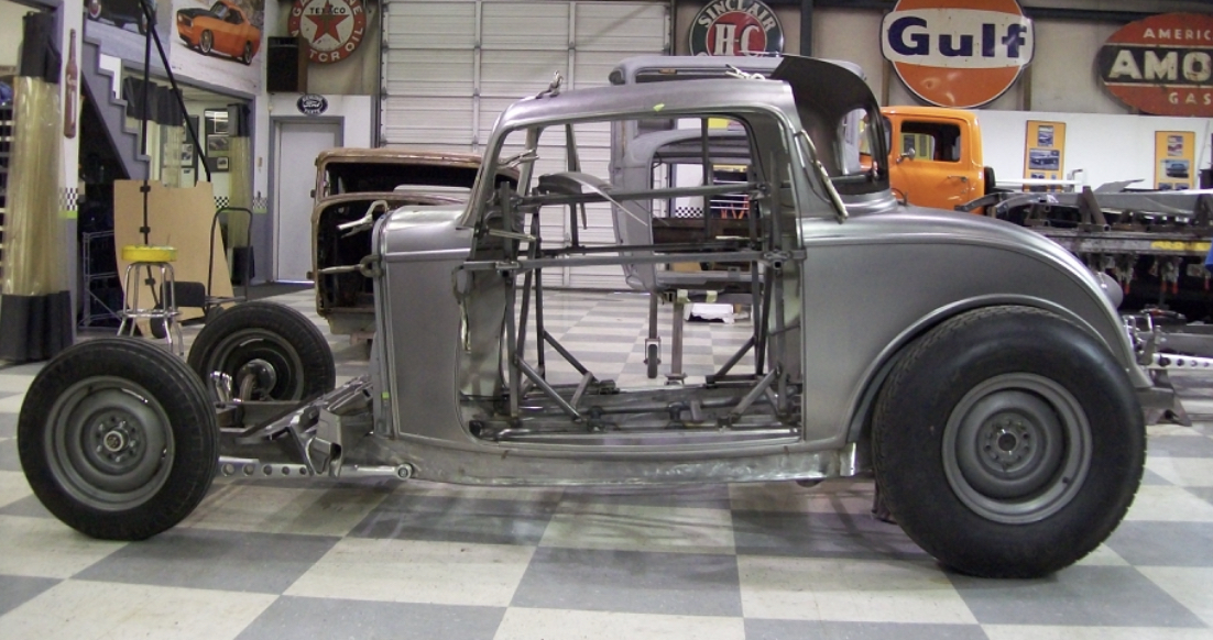

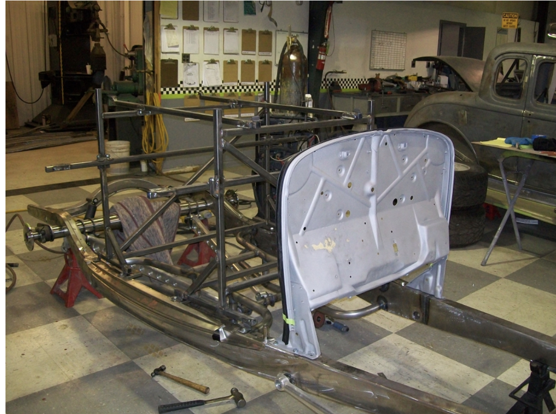

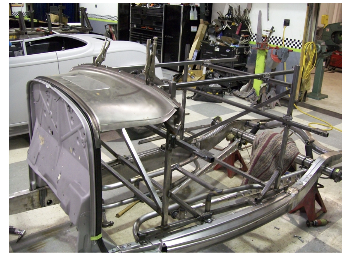

  15. I’ve helped with a couple roadster ***emblies and 1 3w.
    The roadsters are a cake walk compared to the coupe. I made a jig to locate the width of the body in the door openings and top of the cowl from another 3w.
    mount the firewall the the frame. Then sub rails and cowl top. Uni- sides then rear body.
    398AF570-EBF3-4D4A-A06B-BFCD3C1202FB.jpeg 14286CEC-E0E9-4100-84CC-C614394902D0.jpeg 7A9DA434-4436-43C9-8F9B-FC96B4628C22.jpeg
  16. We ***embled the shell, then added the jambs and braces. Lot and lots of clecos
    Tabs we tac welded to the deck lid and doors to attach them with clecos before any hinges were used.
    The deck lid alignment was fun. Like the OE ford, sometimes the deck lid contour needs tweaked. A way to hold the qtrs open or spread them to keep decent deck lid cap was needed.
    I had left by the time it was all welded up. But it was chopped before ***embly that added another level to construction

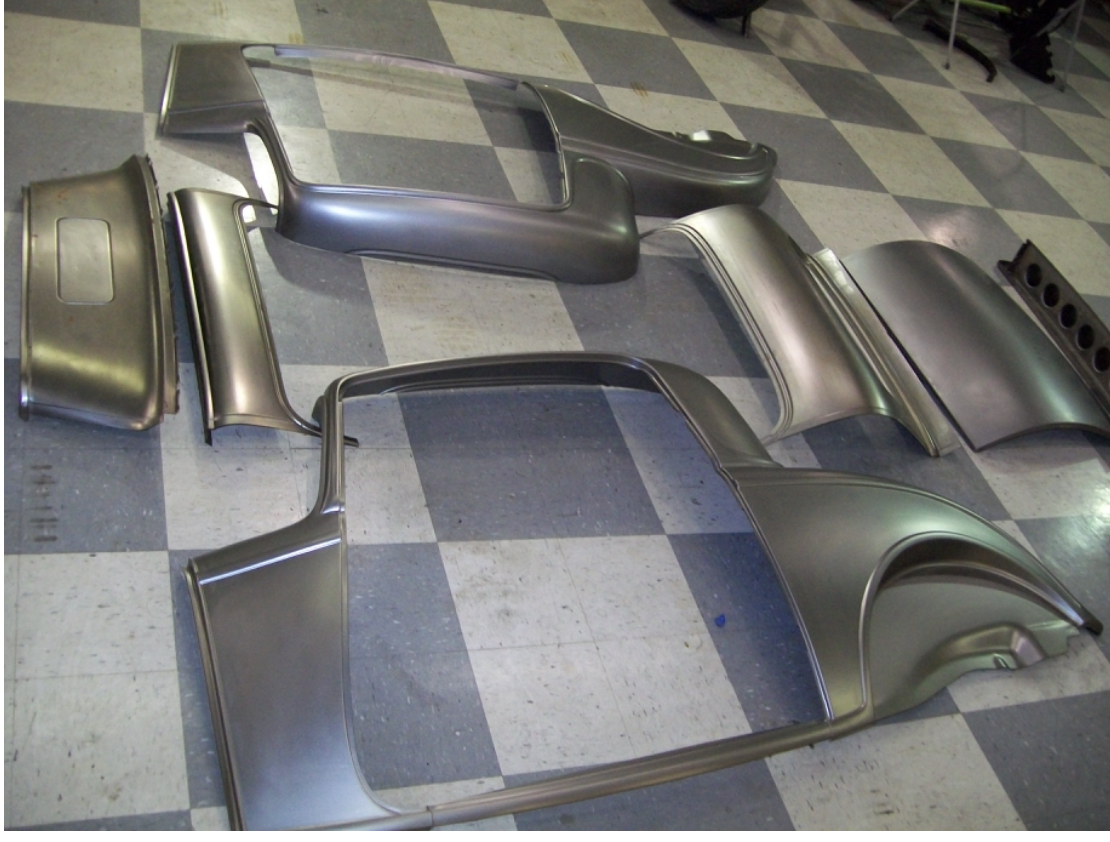

  18. Here are the outside pieces minus the doors.
    Vic Walter likes this.
  19. If referring to me I’m just a body man that has been lucky enough to work at a couple cool shops. Plus, at the time of these pics, a couple decades of repairing heavy hit cars, re-skinning a couple muscle cars and not smart enough to understand limitations. (Too dumb to be scared)
    The last thing I’d ever want to do is run a shop. Those guys are crazy.
    The 3w was chopped, I started it but the other guys finished it as I had started teaching at the time.
    There’s a couple ways to chop em. Lean the A-post back or stretch the door top and roof. Leave the upper hinge or lose it.
    Chopping the A and B post areas without braces is different than ***embled. Easier to metal finish but then ya figure out the jamb cuts.
    The doors are ***embled, so that’s the same.
