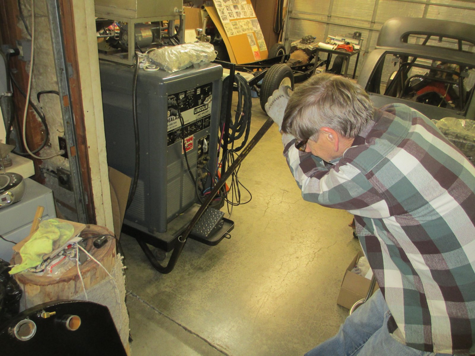

    Dave, I over bend tube all of the time. I have a couple 900 lb Welders that I can stick one end under, and slip an early Ford solid drive shaft into the other end, and pull. Depending on the tube size and thickness, you can normally take a little of the bend out.

  5. Dave G in Gansevoort
    Joined: Mar 28, 2019
    Posts: 3,816
    from Upstate NY
    So basically just muscle a little bit out. Okay I can do that! Yeah I've got heavy stuff in my shop. And there's always a tree out back with 2 big trunks (a bifurcated tree, yup $10 word...), that I could stick it between and tug.

  8. You probably will never get it straight again but like Marty here I have tweaked them a little bit when I have gone too far.

    My welding table has a 2x4 steel channel horizontal crossbrace that can hold a multi bend bar. I let only the offending bend and it's tail stick out, and I slip a cheater bar over or inside all the way to the bend. I'm only 165 Lbs., but by bouncing a few times, I have taken out up to 2 degrees more than once.
