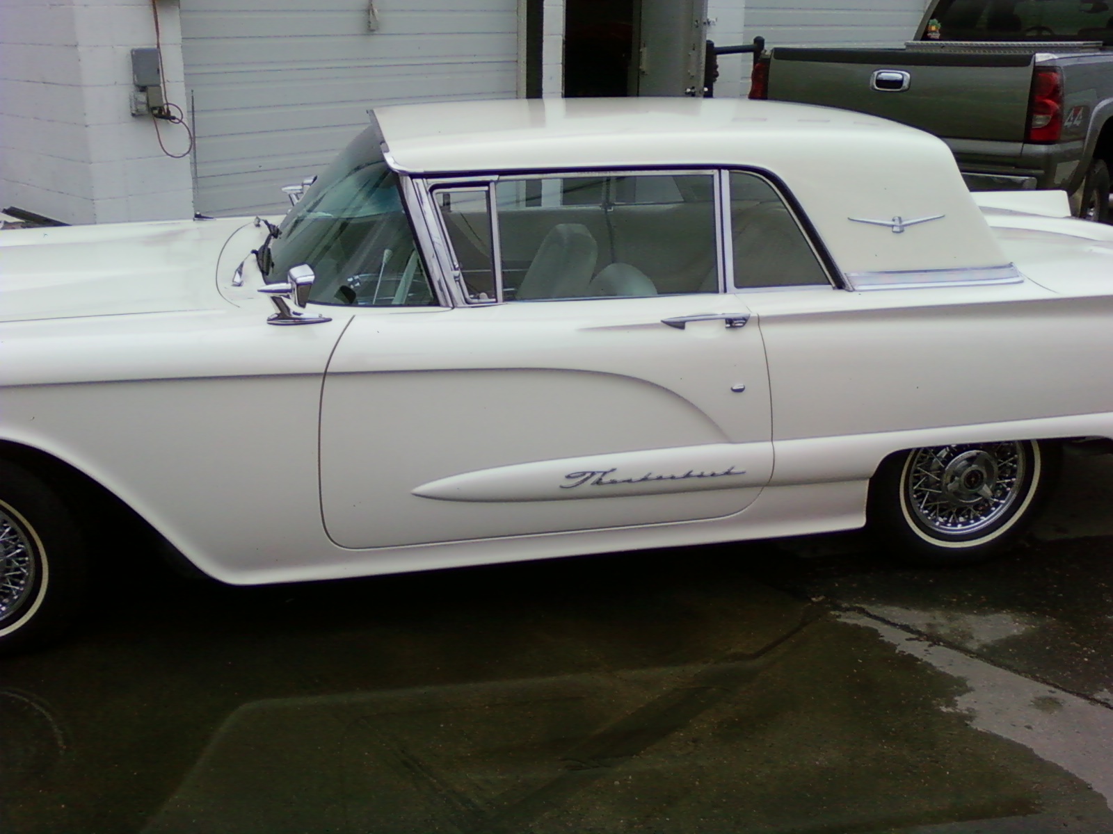

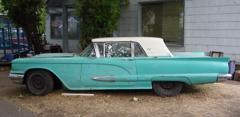

  5. froghawk
    Joined: May 9, 2008
    Posts: 857
    froghawk
    Yikes! Glad you like the idea, but I guess it does open up a can o' worms doesn't it. The only possible donor I can think of for that drip rail, etc., area might be the '58-'59 T-bird, which, I think, is more angular than the '59 Galaxie in that area, but may still not have a tight enough radius.
    The drip rail on the '58-'59 'Birds (aqua car's a '59) meets the sail panel trim (shown in separate pic) where it effectively continues along the top of the trim, then down off the back edge of the trim piece. The '60's (white car) a little more normal, with a drip rail that continues all the way down to the belt line.
    Wish I had the metal-working skills/knowledge to match the idea, but hope that helps, anyway.
  6. Ford blue blood
    Joined: Jan 4, 2009
    Posts: 781
    Ford blue blood
    58 - 60 Bird drip rail molding looks like it will do the trick!
