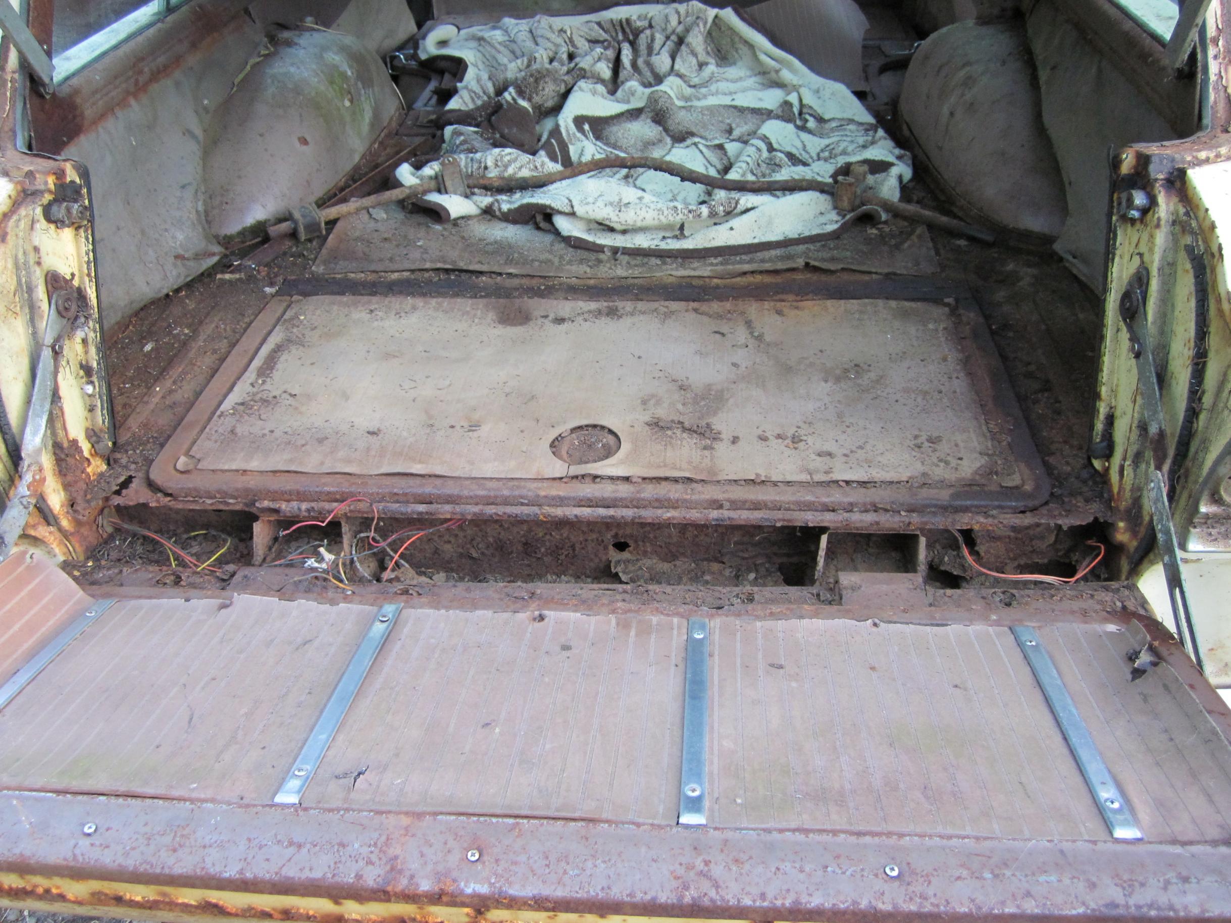

    I need input... I would appreciate hearing from any Ranchero guys... I saw a few pin holes in the flat panels that make up the corner bed floor and didn't think to much about it since flat sections are normally not problems repair areas... then the rotisserie adds new dimension that borders on a very stupid design... the same section is a ribbed on the bottom (show in the previous post) and flat on the top which means it is a double panel.. any moisture lays in the channel so a little rust ends up being a major issue... now my questions begin with: a) are wagons built the same way (since I own one I'll drive down to look if I don't get a response)... b) does any one produce repro replacement panel... c) does anyone know of someone who has saved these panels off a donor Ranchero/wagon that would be willing to sell or trade... I know that they can be fabricated and that will happen as a last resort...
  8. SquireDon
    Joined: Aug 8, 2010
    Posts: 605
    SquireDon
    from Oregon
    The same section in my old '58 2 door Ranch Wagon parts car is ribbed in this section. Maybe the Ranchero had this smooth panel over top of the ribbed wagon panel section?

    I will take photos of my wagon tomorrow... the Ranchero is flat and wagon is ribbed but the Ranchero panels might be close enough to use on wagons too... again anyone with leads to a donor would be appreciated... I have parts to trade if they don't normally won't sell parts... any input appreciated
  25. exStreamliner
    Joined: Apr 7, 2009
    Posts: 1,553
    exStreamliner
    20 yrs of dust... but, it still shows that panel under the Ranchero top panel... contour for Ranchero insert is not the same

    The whole top of the bed floor must be ranchero specific the wagons had the rear seat hinge/ mount
    now at this point if you put in a rear fold down seat that would be ok with me..
