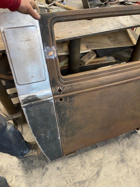

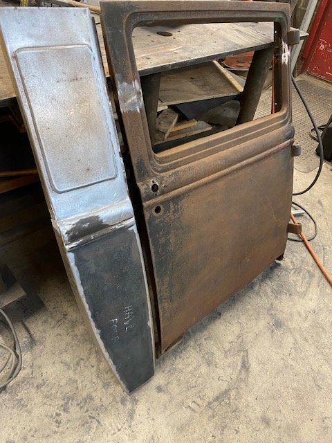

    I took the doors and pieces back to my shop and finally got a chance to work on them.
    I trimmed the back door skin from the 4dr to shape and used the opposite jamb section from the other door to creat a jamb section of the back corner of the cab. image19.jpeg image18.jpeg

    I trimmed the jamb to match the front door shape, then welded it to the "back" door.

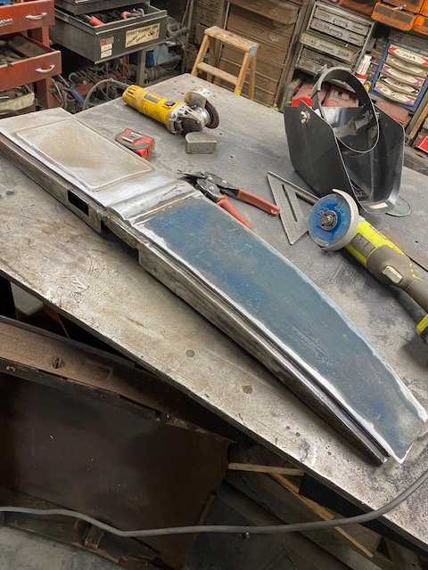

    I then cut a piece of sheet metal to the arch of the door to create a return for the back of the cab to attach to. image12.jpeg

    I cut off the the part of the "door" above the bead and made a new section, putting a raised area in it to mimic a 29 model A pickup. folded the sides and welded it in. image9.jpeg

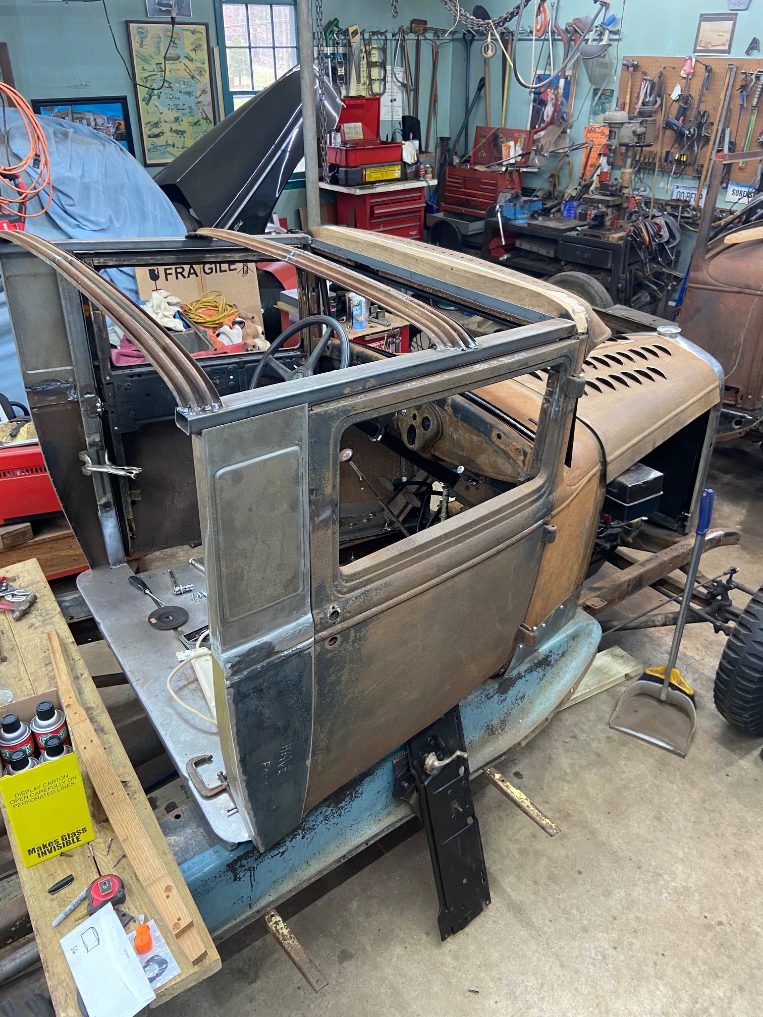

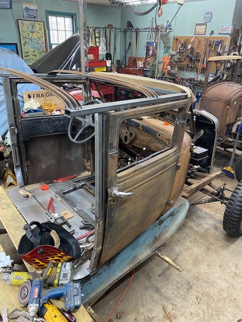

    stopped by Charlie's to drop off the parts for test fit. put one door on and clamped the quarter to the post. I need to do a little t******* before I weld it in but it looks like it will work. image0-4.jpeg

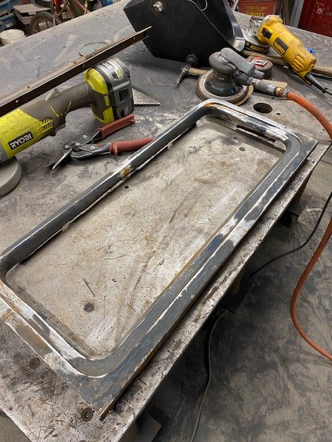

    two visitors today, Charlie dropped off the hood for me to louver and Mark came by and laid them out. image0-4.jpeg image1-2.jpeg image2-2.jpeg two rows per side. ten on the inside row and 8 on the outer side.

    once Mark-ed out, I cut thin slices with the grinder and a thin cut off wheel. the hand made tool slipped into the groove on the face side of the hood and the chisel tool punched the louver from the back side. image3-2.jpeg image4-3.jpeg image5.jpeg

    With a little hammer and dolly work and cleaned up with a file the hood is done.

    we also trimmed up the cab corners for fit and made some measurements for the back of the cab. image0.jpeg
