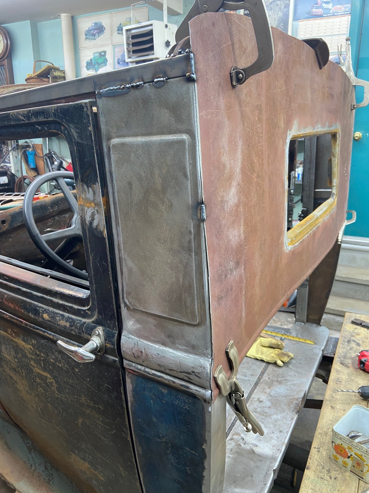

    I cut the panel in half to eliminate the step and squared it up. I ran a bead along the long edge. image0-4 copy.jpeg
    bchctybob, Deutscher, TFoch and 7 others like this.
  8. tb33anda3rd
    Joined: Oct 8, 2010
    Posts: 17,588
    tb33anda3rd
    I trimmed it at the lower edge of the bead. this section will be the upper part of the back of the cab and the bead section will over lap the lower panel. image1-2 copy.jpeg
    bchctybob, Deutscher, TFoch and 9 others like this.

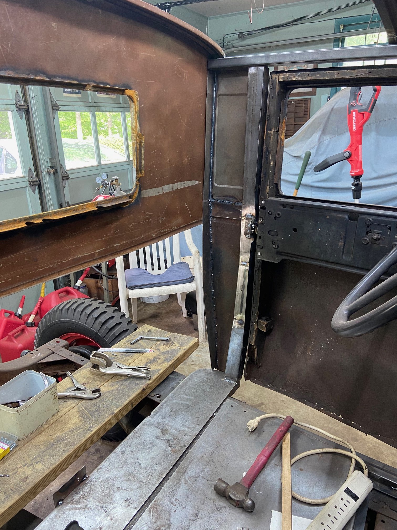

  9. tb33anda3rd
    Joined: Oct 8, 2010
    Posts: 17,588
    tb33anda3rd

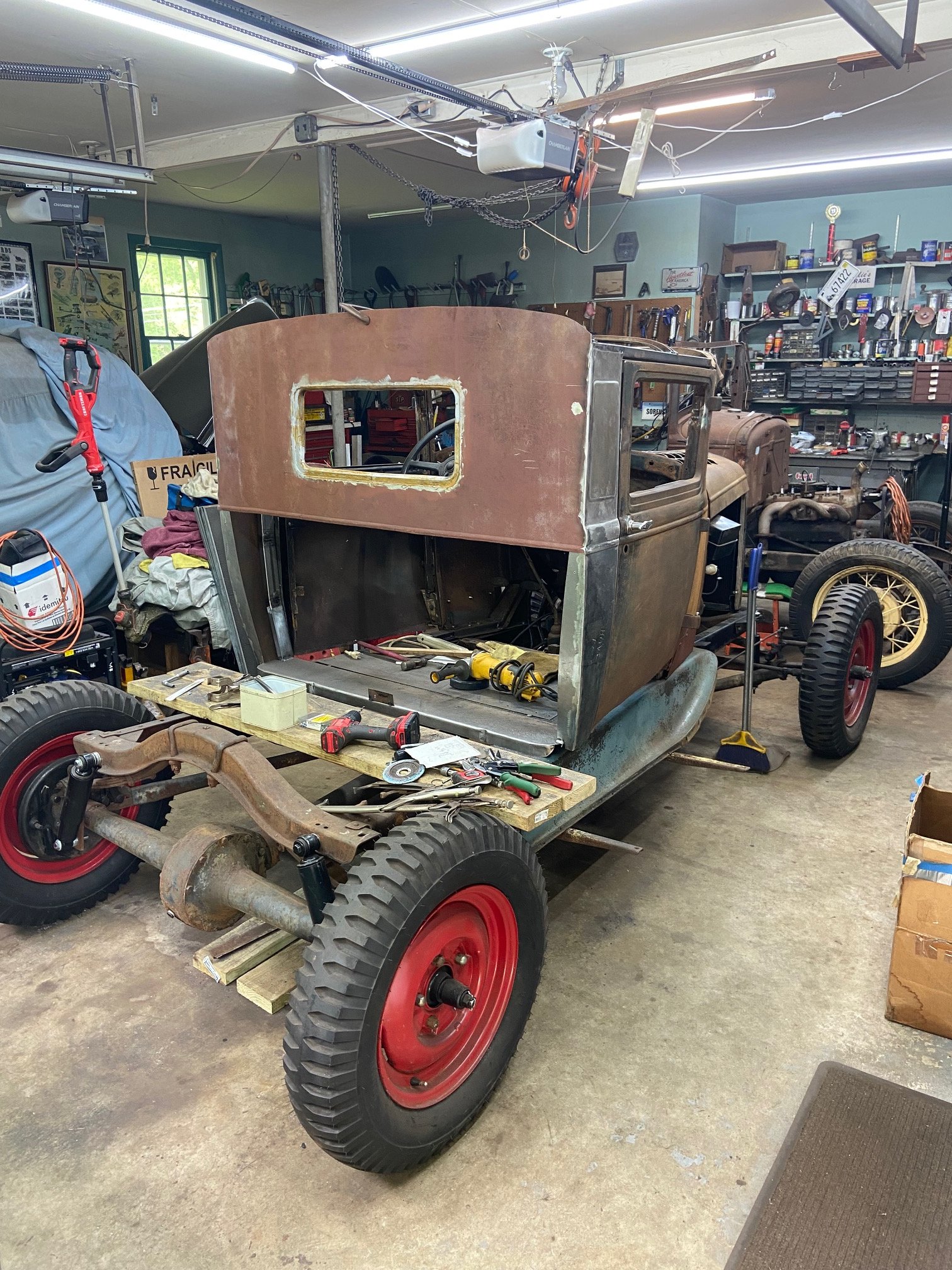

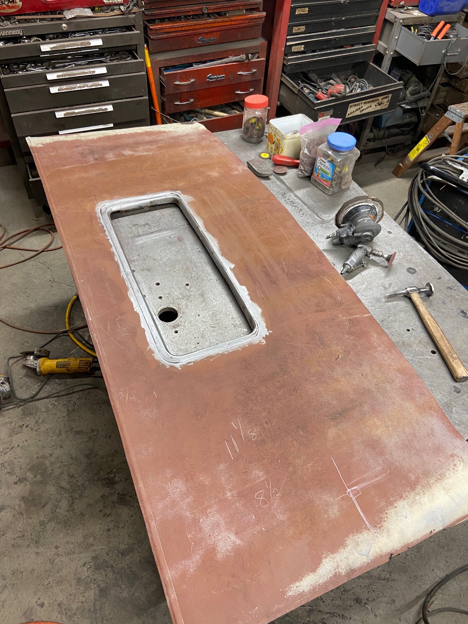

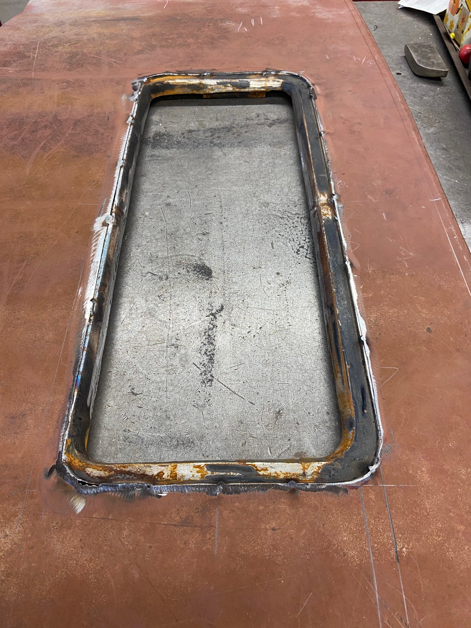

    image2-2.jpeg I then planned out the location of the rear window. the bead will line up with the small lower bead of the side of the cab and I measured up off of that to place the rear window. the window is centered in the cab and centered up and down with the side windows. I then cut out the hole to weld the rear window frame in. image2-2.jpeg
    bchctybob, Deutscher, Stogy and 9 others like this.
  10. tb33anda3rd
    Joined: Oct 8, 2010
    Posts: 17,588
    tb33anda3rd

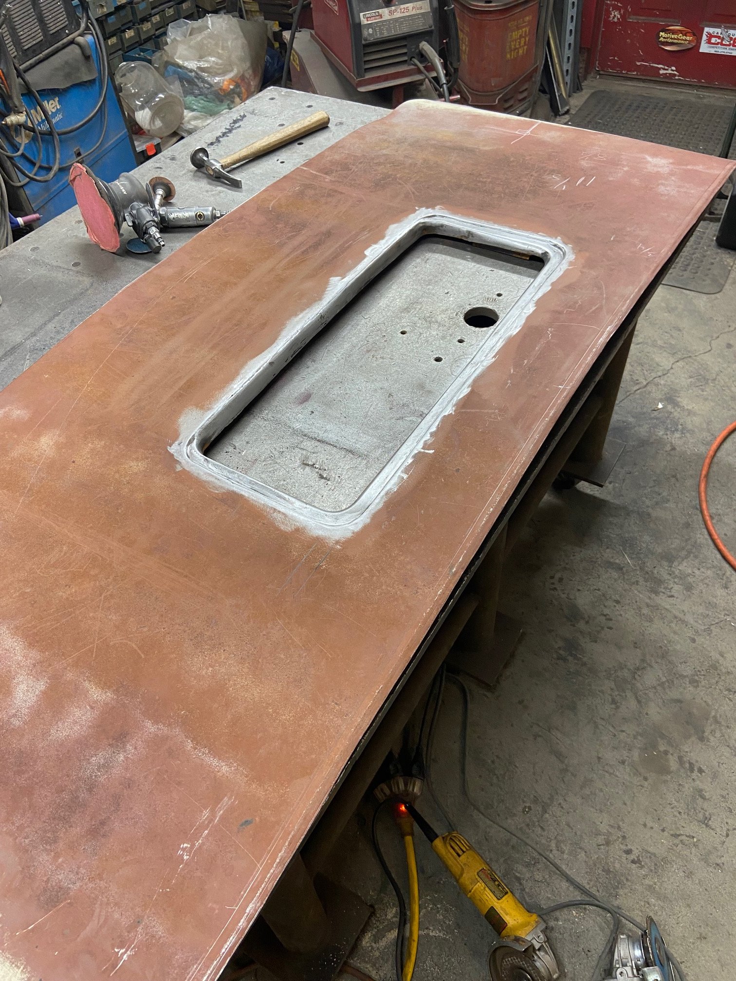

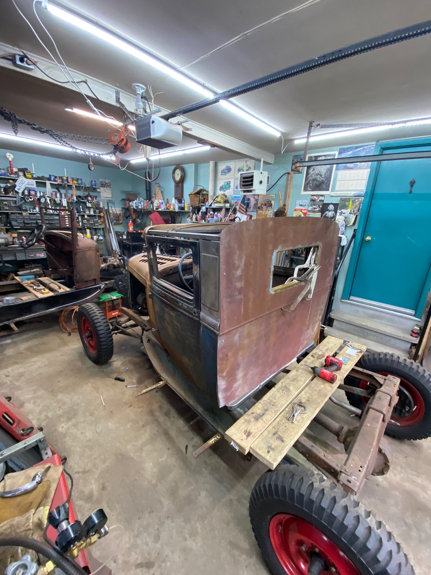

  14. tb33anda3rd
    Joined: Oct 8, 2010
    Posts: 17,588
    tb33anda3rd

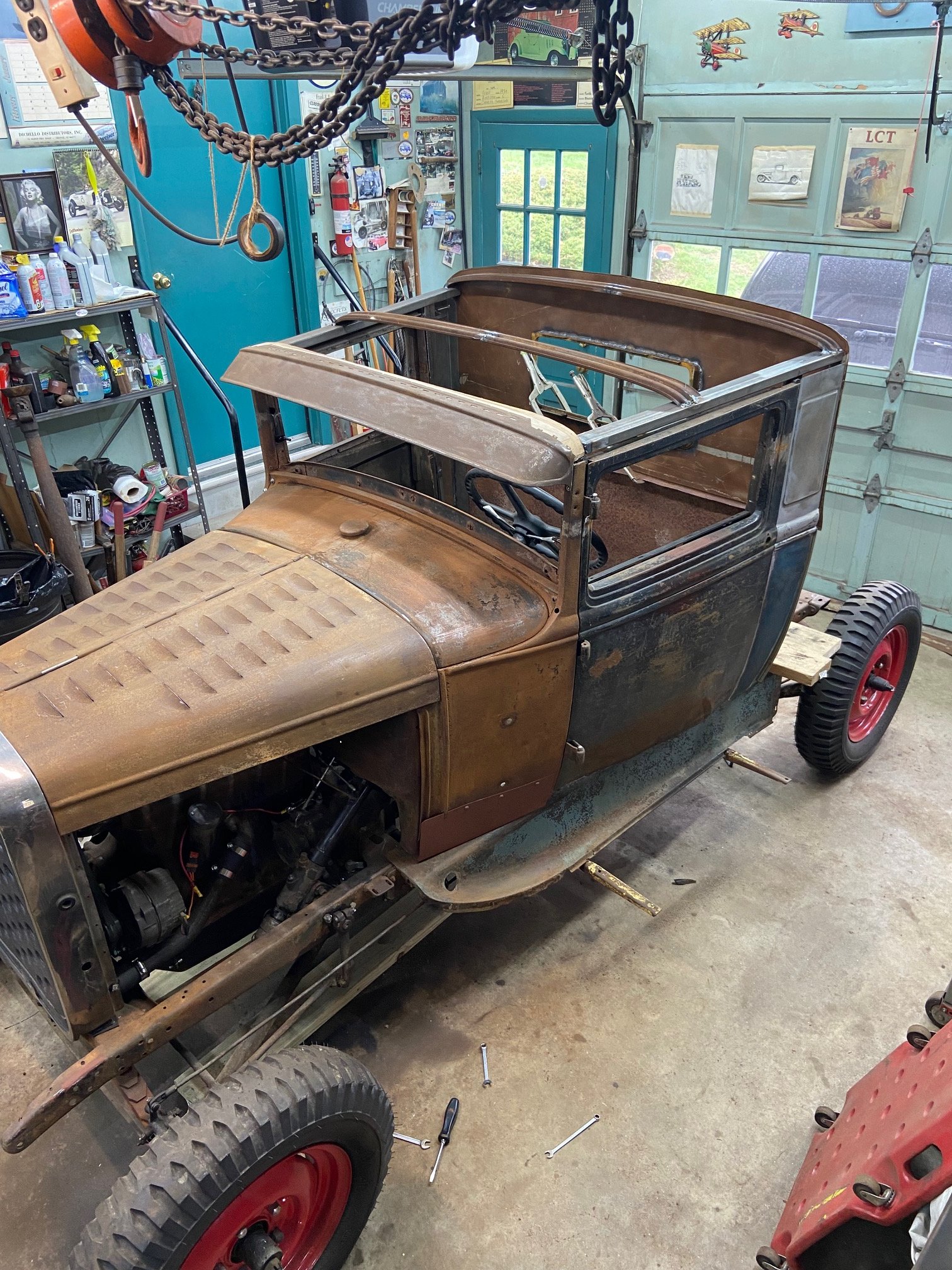

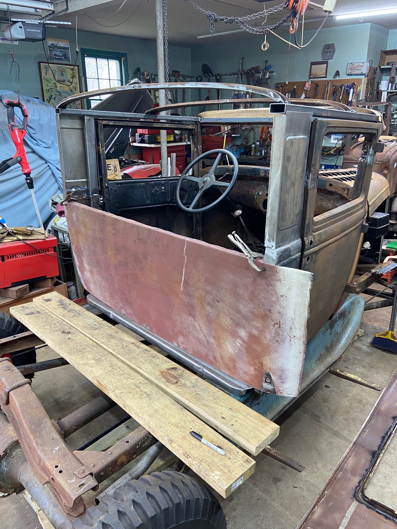

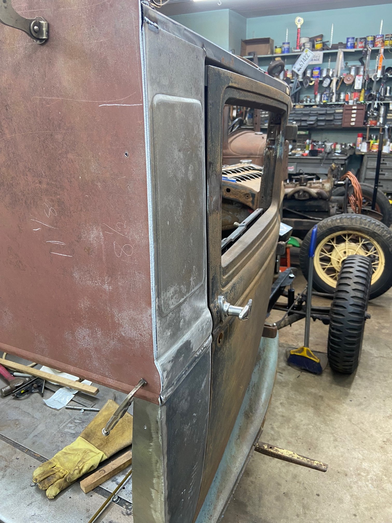

    went to Charles to test fit and trim. I measured wrong and the bottom section came up short. I will have to weld a piece on.:confused: image0.jpeg
    dwollam, bchctybob, Deutscher and 4 others like this.
  15. tb33anda3rd
    Joined: Oct 8, 2010
    Posts: 17,588
    tb33anda3rd

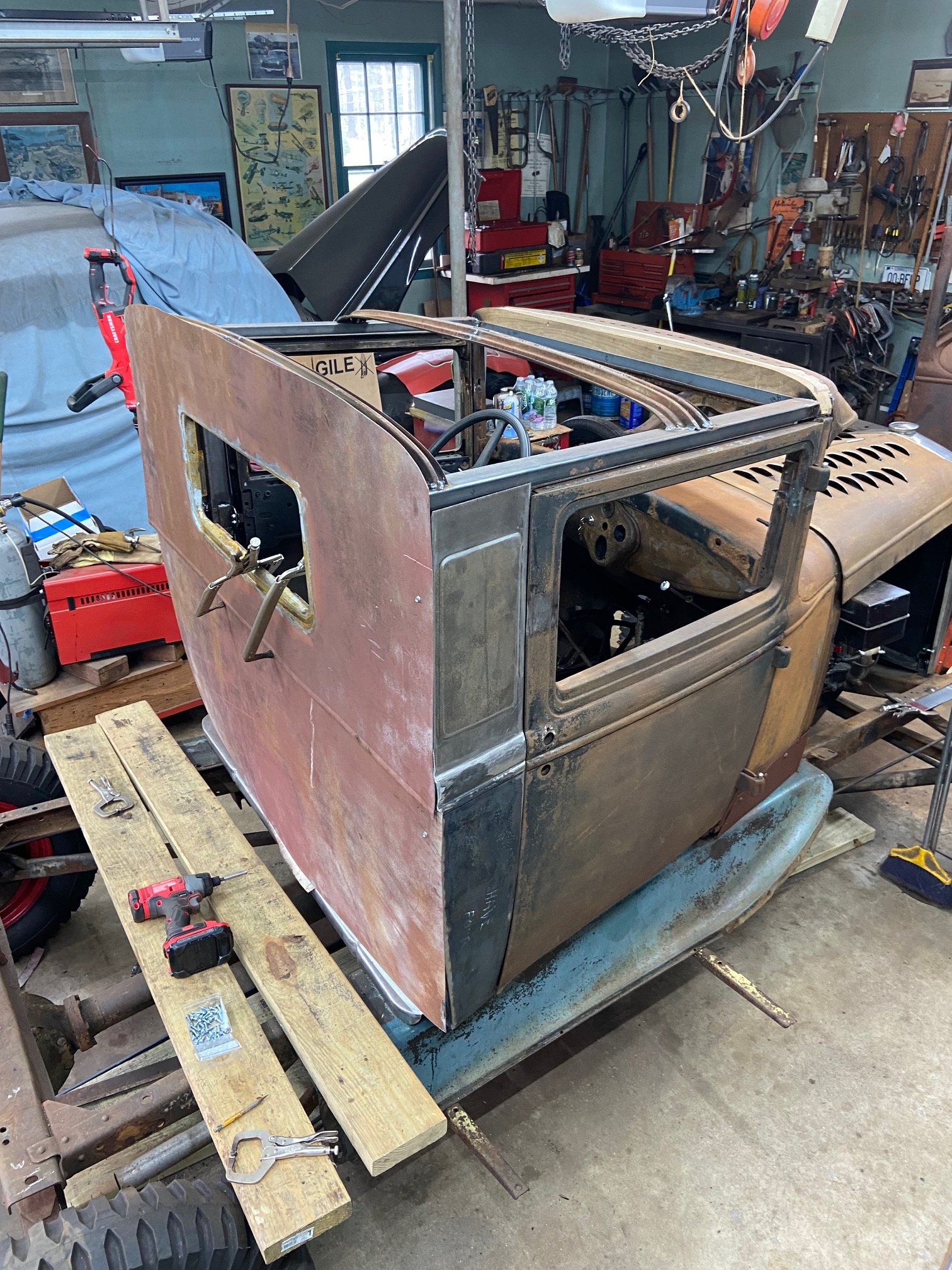

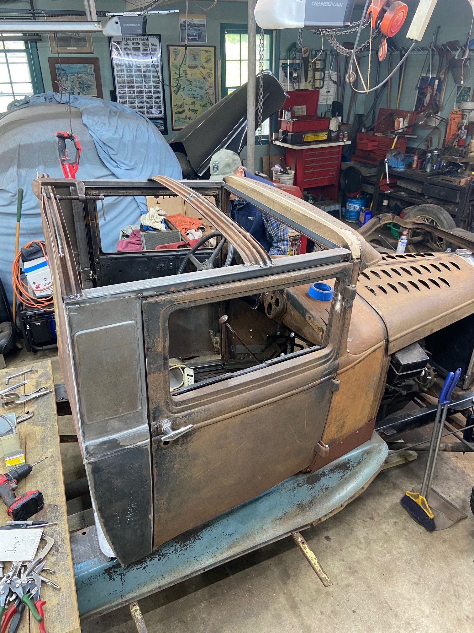

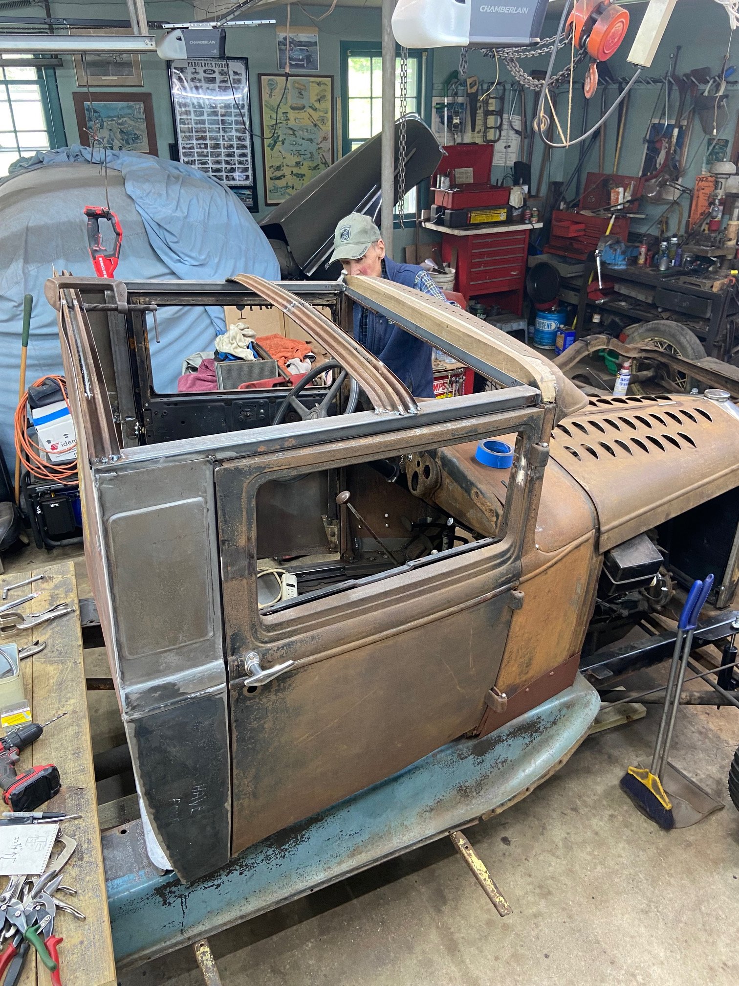

    I aligned the bead of the top section with the cab corners and marked them to be trimmed. once trim we screwed them in place temporary. image1.jpeg image2.jpeg

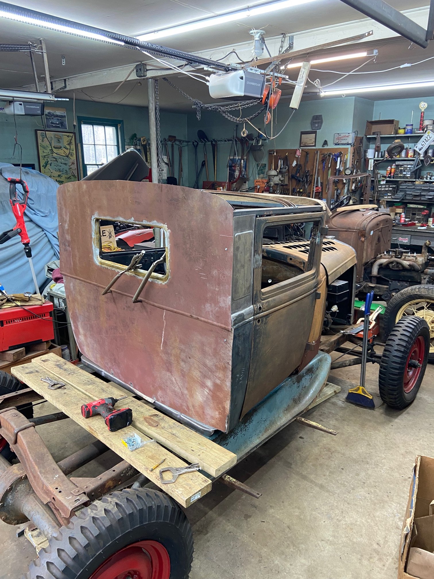

  16. tb33anda3rd
    Joined: Oct 8, 2010
    Posts: 17,588
    tb33anda3rd

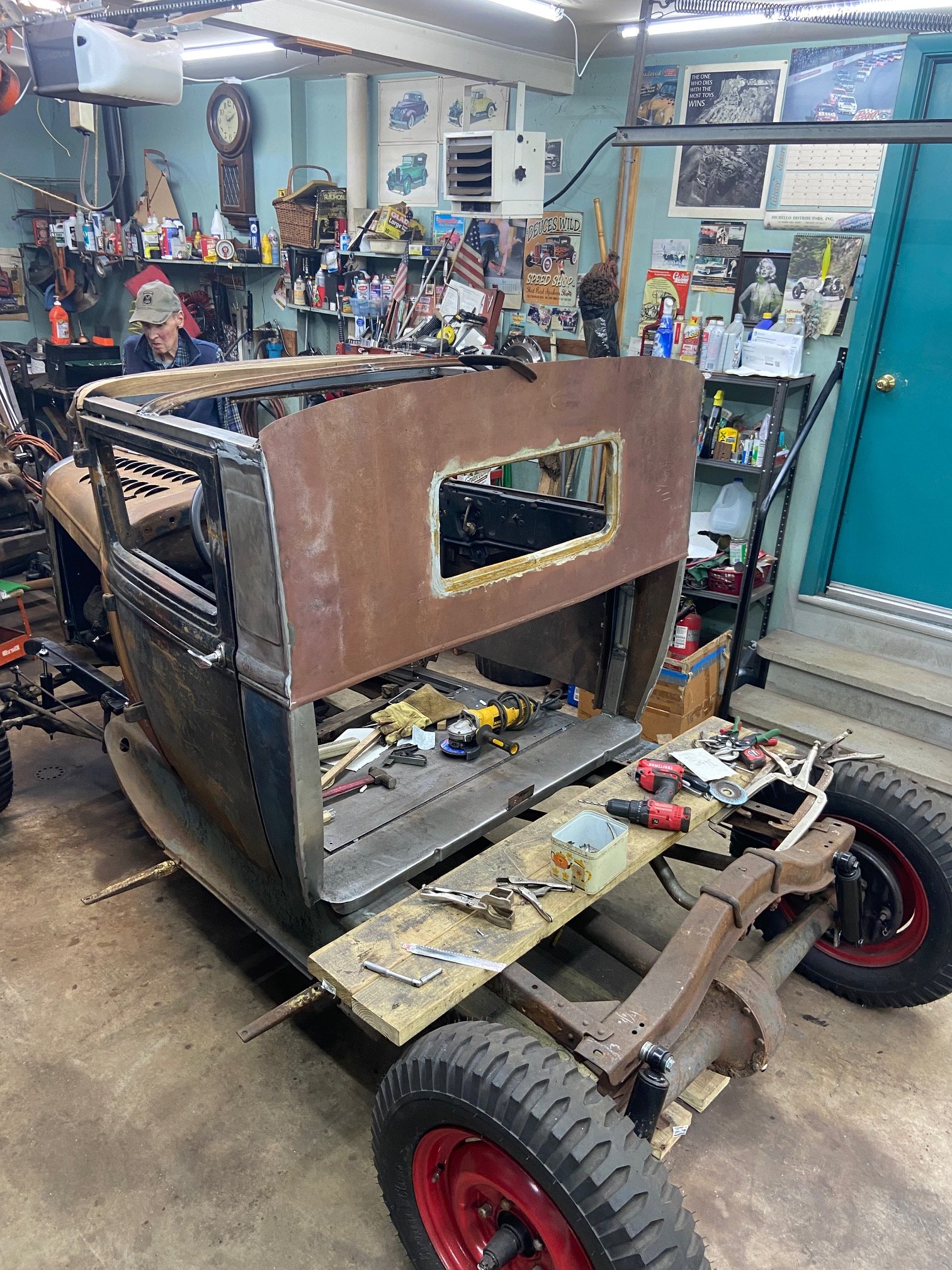

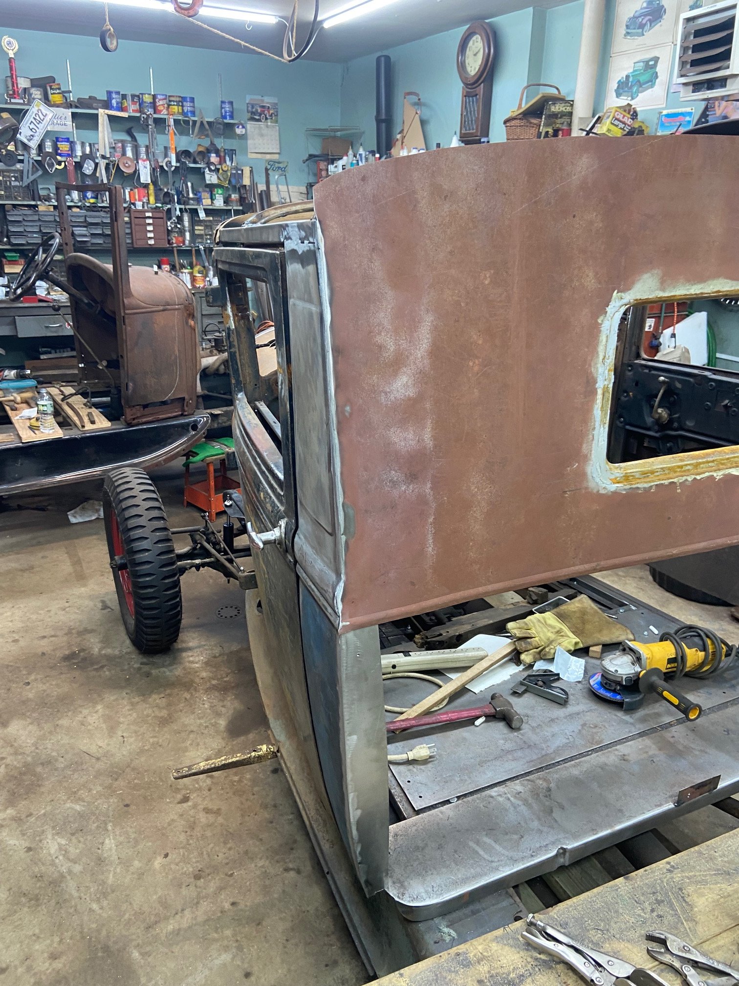

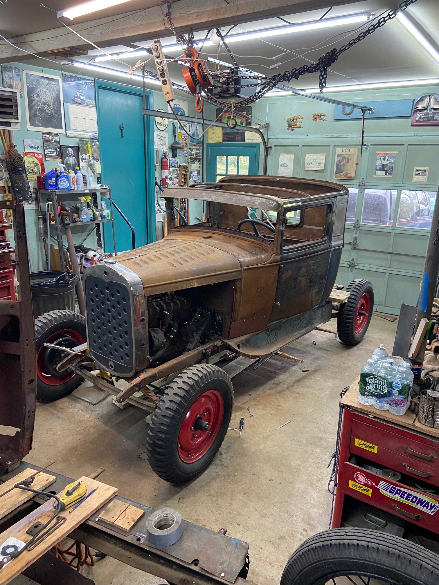

    nothing is in final, all the tin will get fitted and trimmed once all the parts are made. it will come back apart but this mockup is starting to look like a truck. image3.jpeg

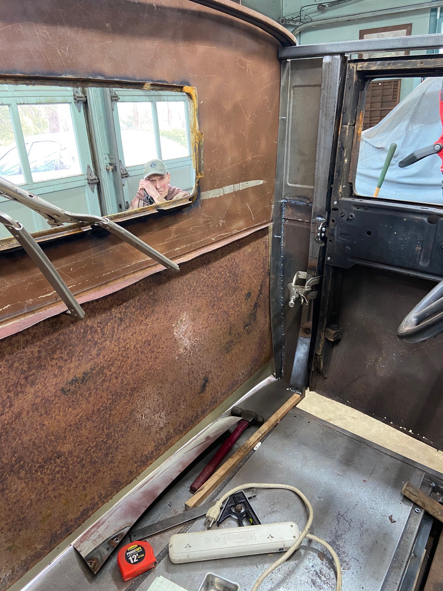

  19. Johnny Gee
    Joined: Dec 3, 2009
    Posts: 14,420
    Johnny Gee
    from Downey, Ca
    Outback, dwollam, bchctybob and 3 others like this.
  20. tb33anda3rd
    Joined: Oct 8, 2010
    Posts: 17,588
    tb33anda3rd
    he was eyeballing the alignment;)
    he likes the color of the back of the cab.

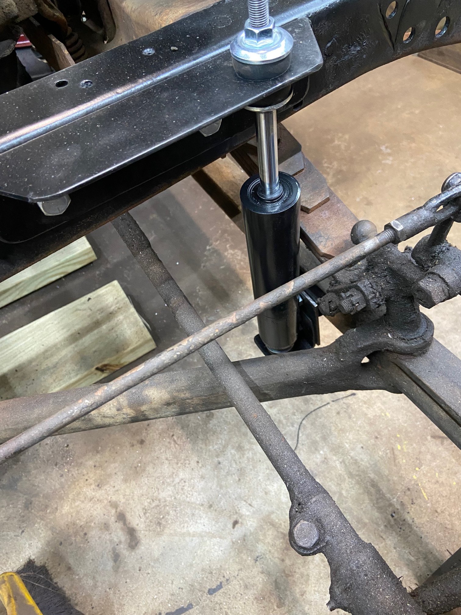

  25. tb33anda3rd
    Joined: Oct 8, 2010
    Posts: 17,588
    tb33anda3rd

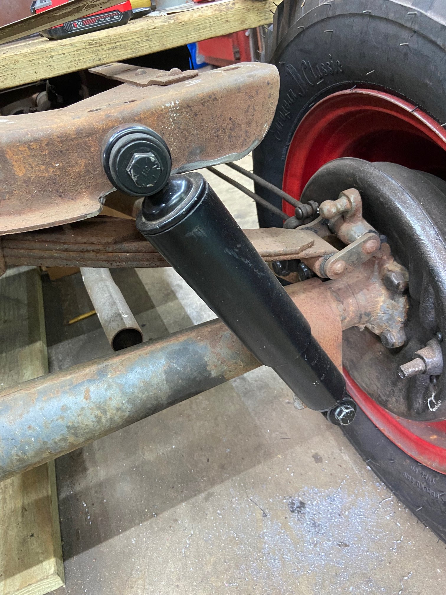

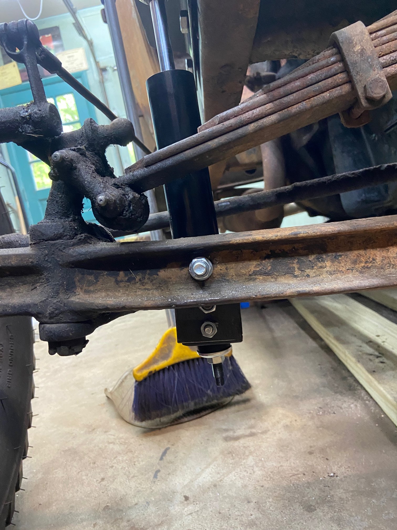

    spent the day with Charlie, he has been busy since I last was there. He made and installed all four shock mounts. image17.jpeg image16.jpeg image14.jpeg

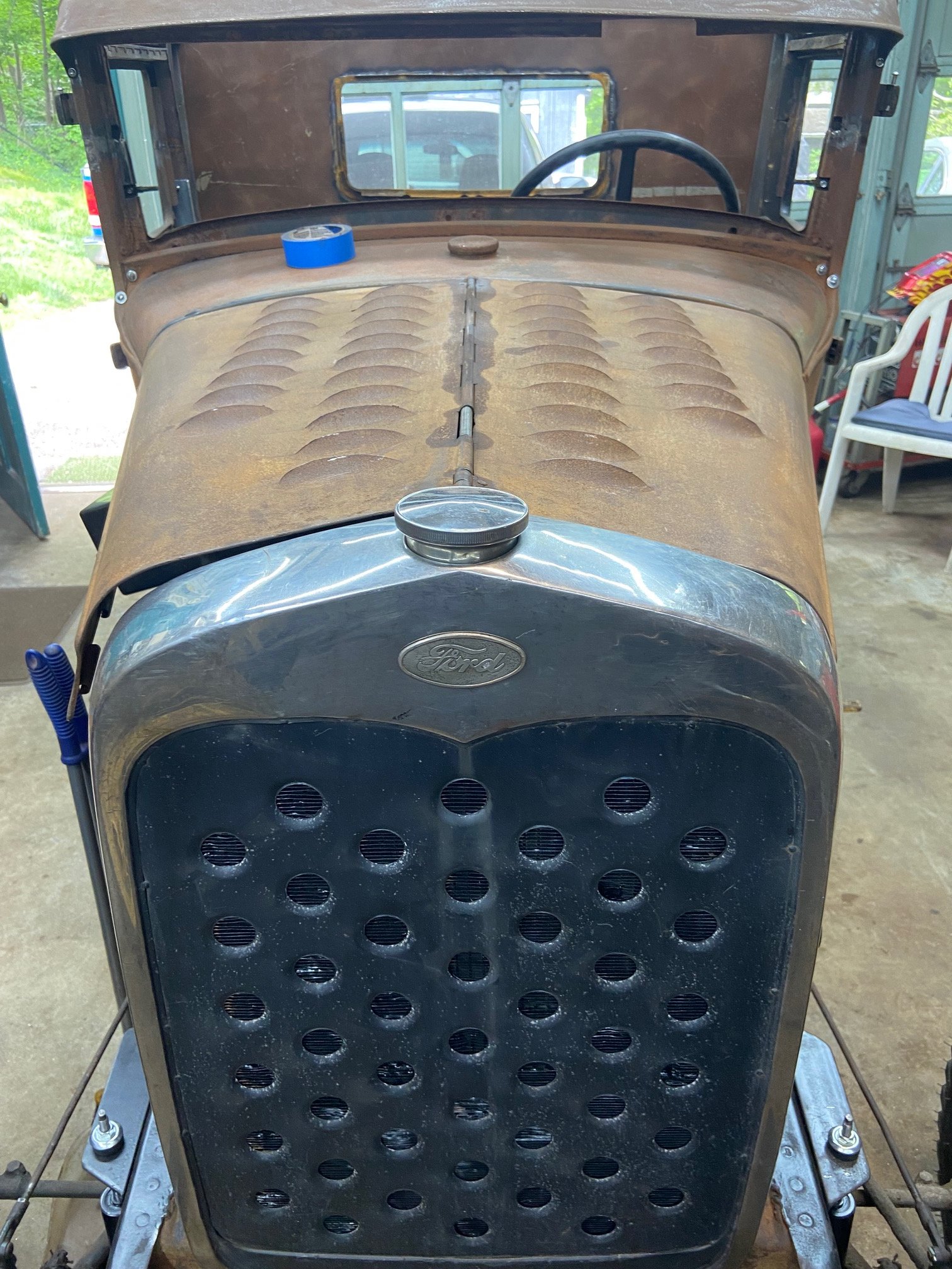

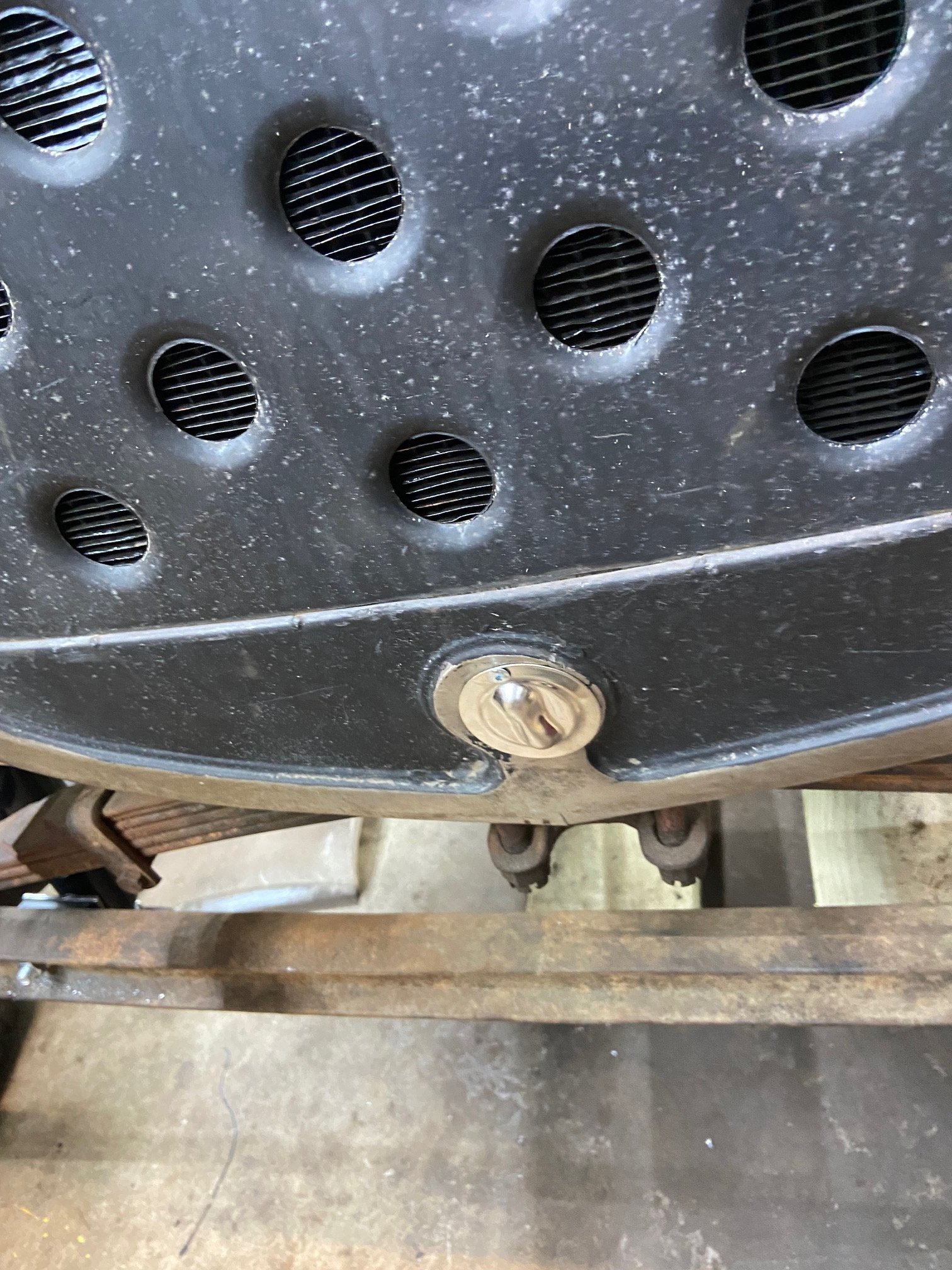

    we also finished up, the grill shell. it was missing the front receiver for the hood hinge. we riveted that, and the crank hole cover in. I also banged a couple dents out of it and put the Ford badge on. we also replaced the hood hinge tube. image2.jpeg

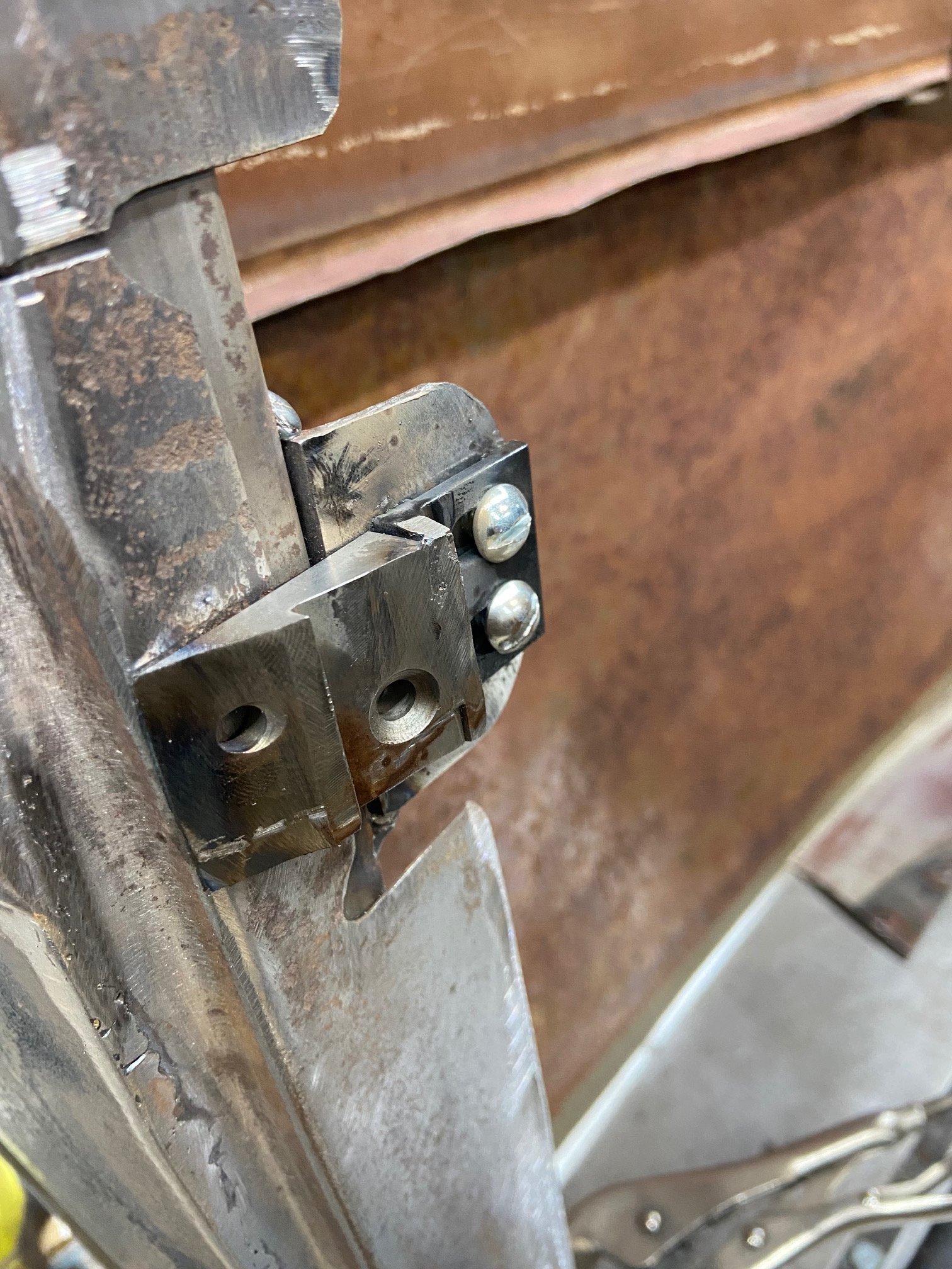

    we also came up with a solution for the door latches. they would not latch without turning the handle, no matter how hard it was slammed so we added a wedge to the front of the catch we had used. it is a mismatch of parts but we made it work and the doors close effortlessly. image15.jpeg

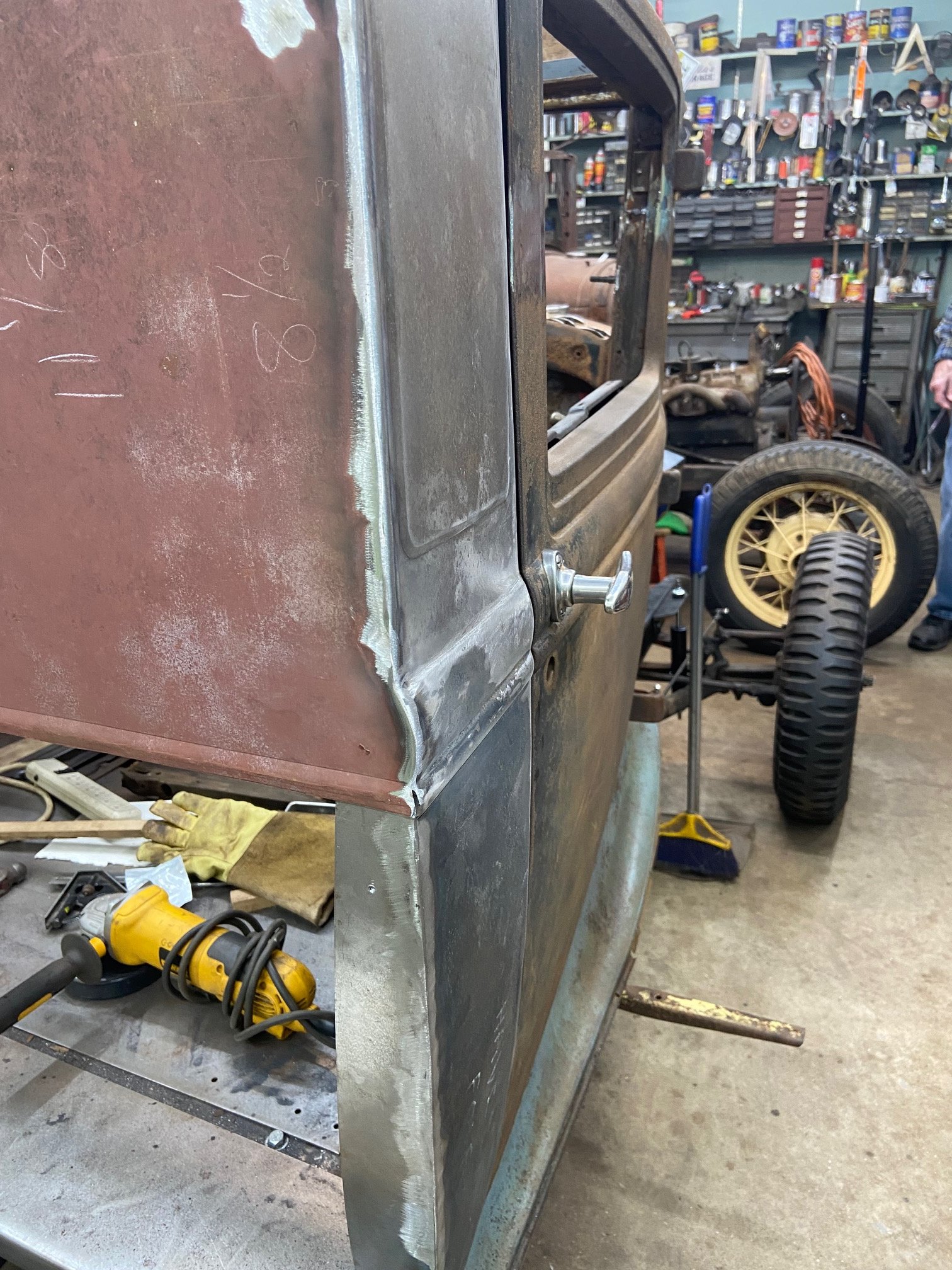

  29. tb33anda3rd
    Joined: Oct 8, 2010
    Posts: 17,588
    tb33anda3rd

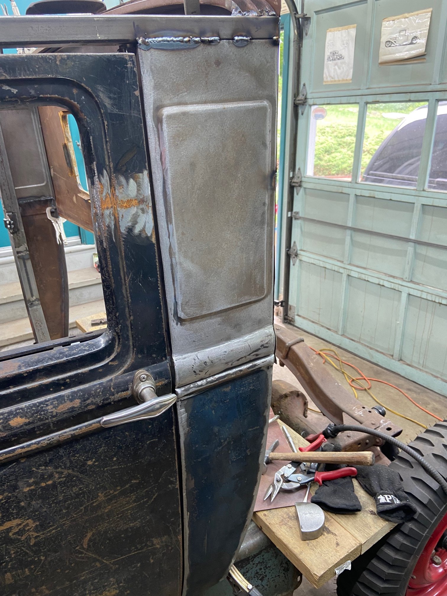

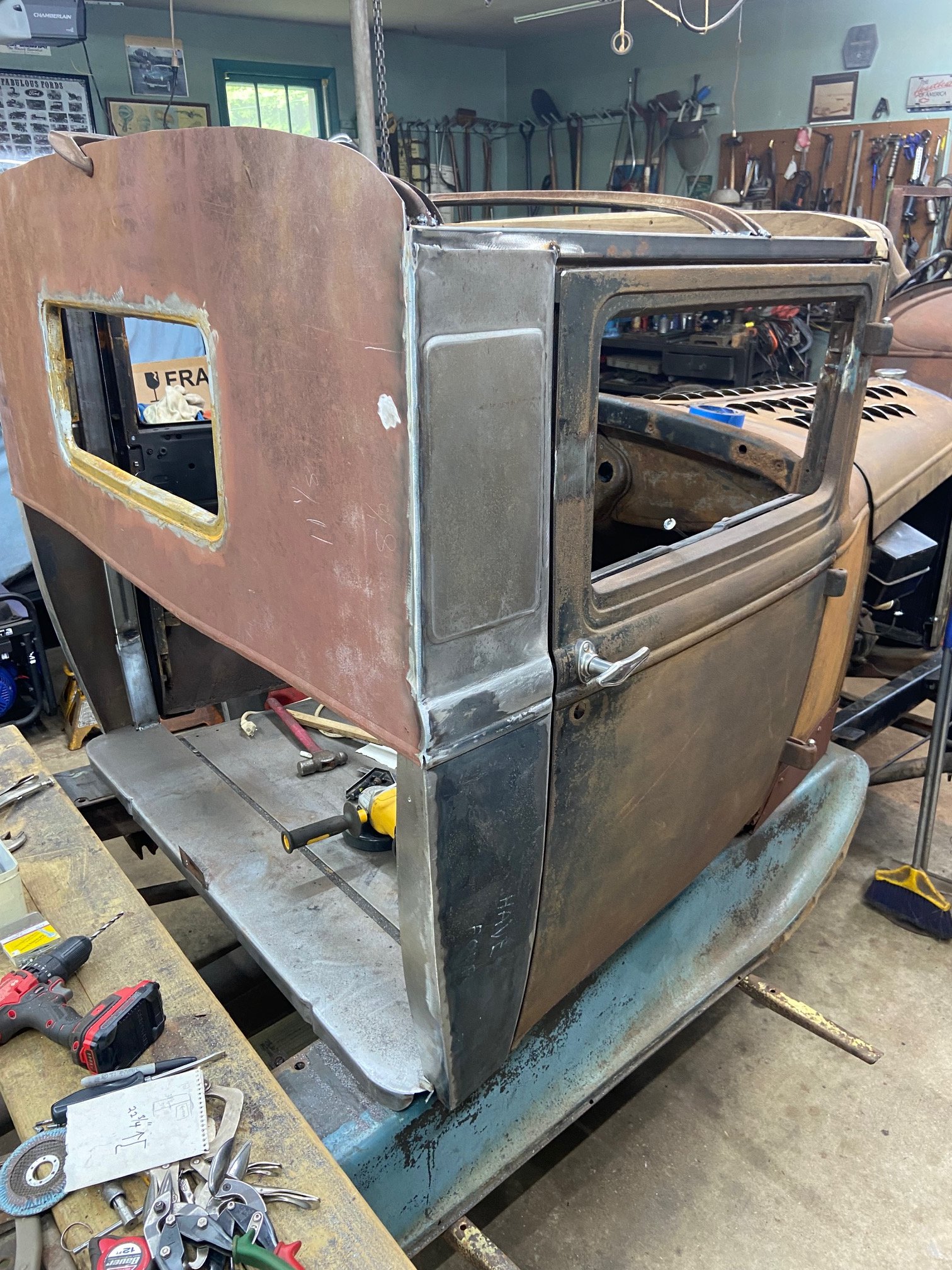

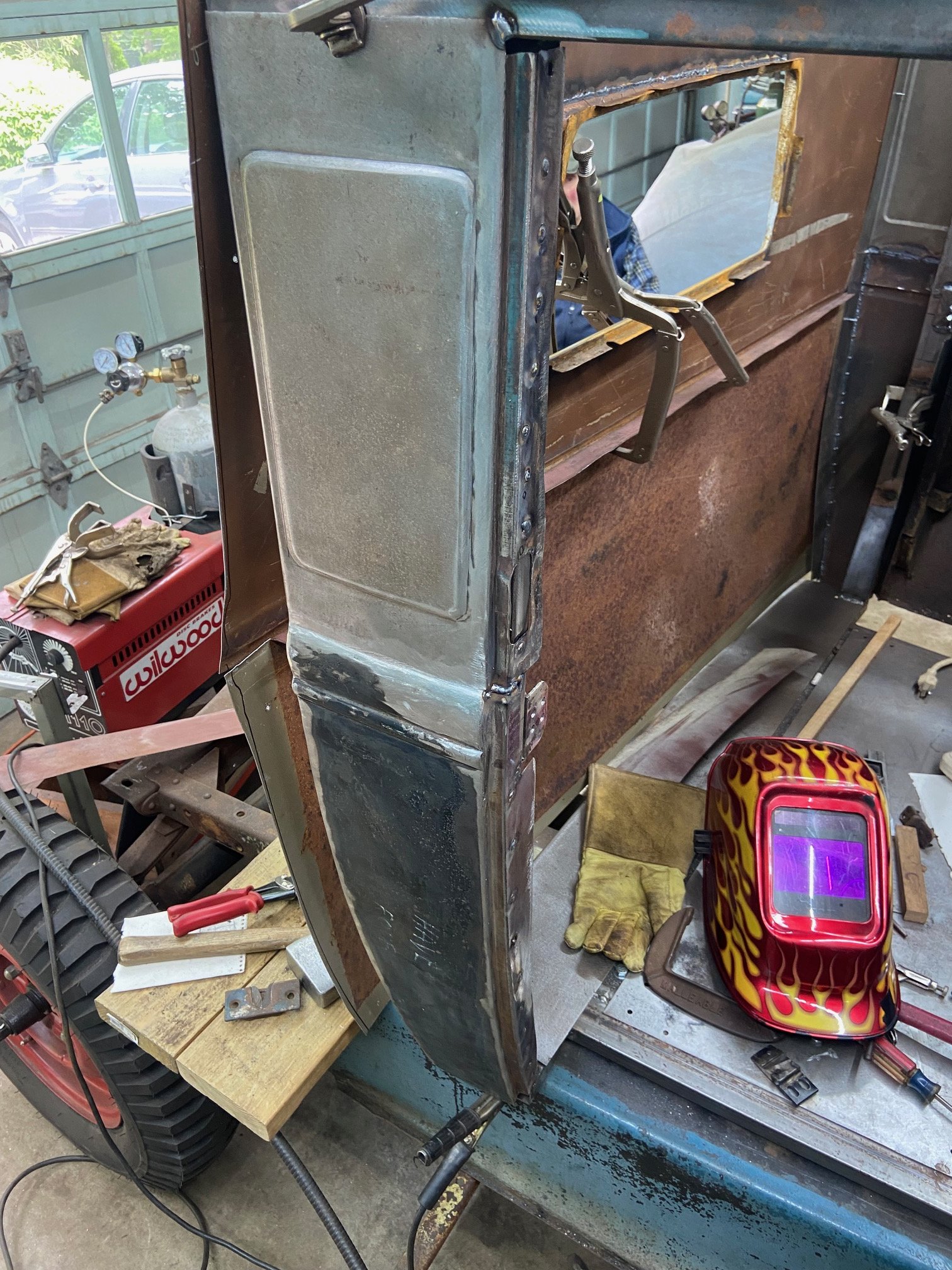

    once the cab corners were in I centered the upper half of the back of the cab, trimmed it to follow the cab corners and used the grinder to fit it. image12.jpeg
  30. tb33anda3rd
    Joined: Oct 8, 2010
    Posts: 17,588
    tb33anda3rd
