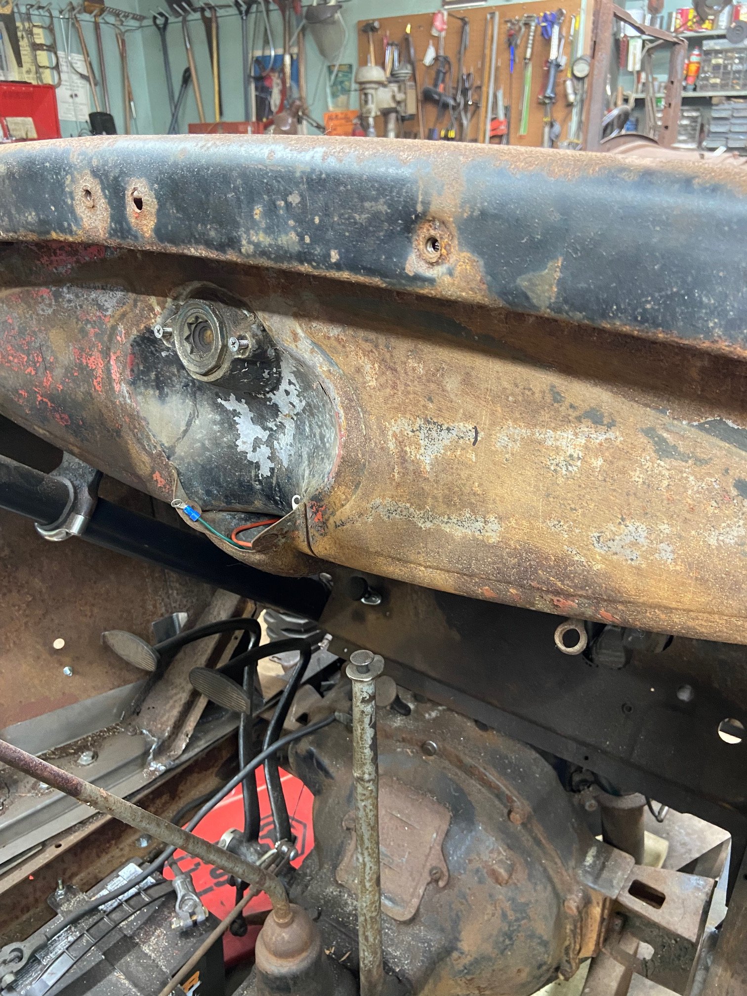

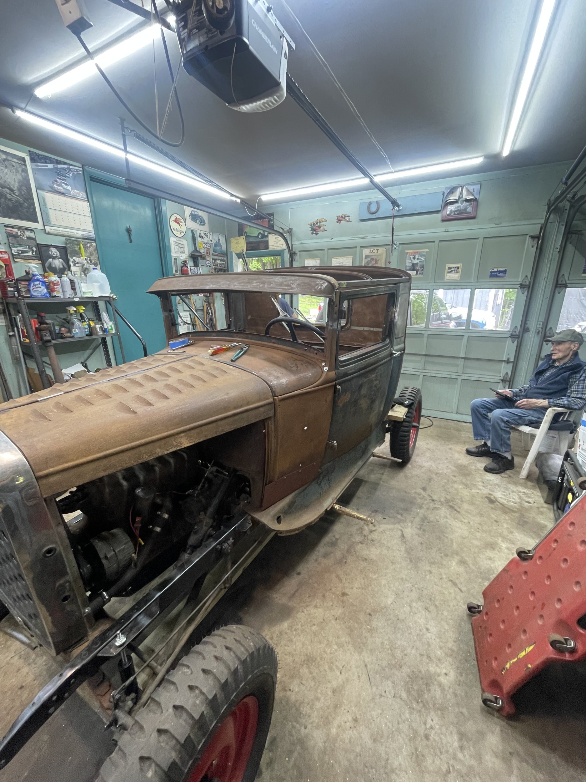

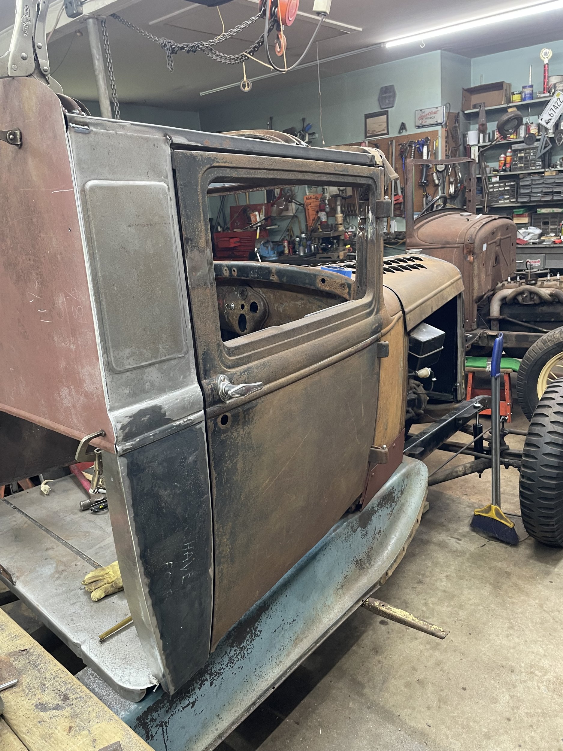

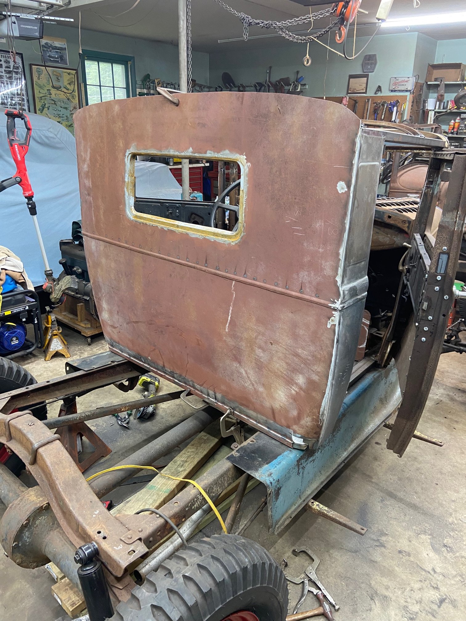

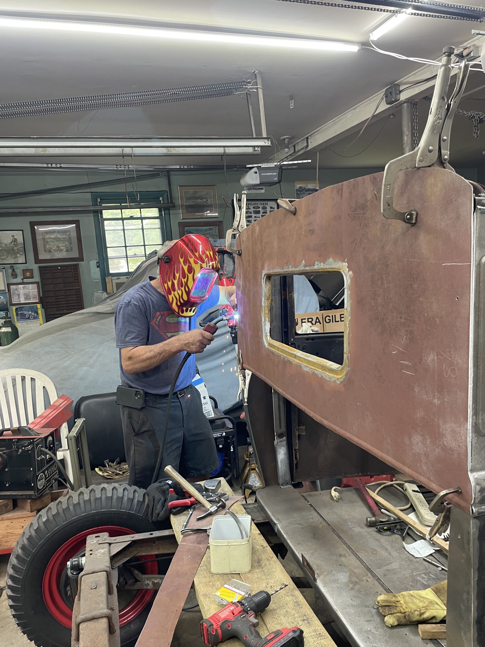

    I took a ride to Charlie's yesterday afternoon to see what mischief was going on. Sure enough , Slackers were slacking. Well at least two of us were.:rolleyes: IMG_7980.jpeg IMG_7983.jpeg IMG_7981.jpeg IMG_7982.jpeg

  3. Metal workers credo..."measure once, cut twice, learn to weld". ;)

    ....your welding hood is on fire....

  5. tb33anda3rd

    it has a magnifying lens in it, I wear cheaters. my eyes get a work out trying to adjust.

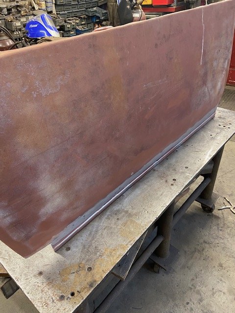

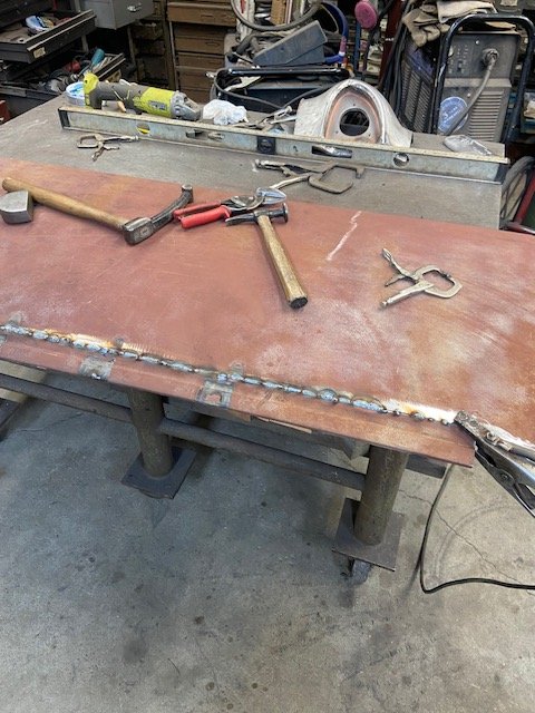

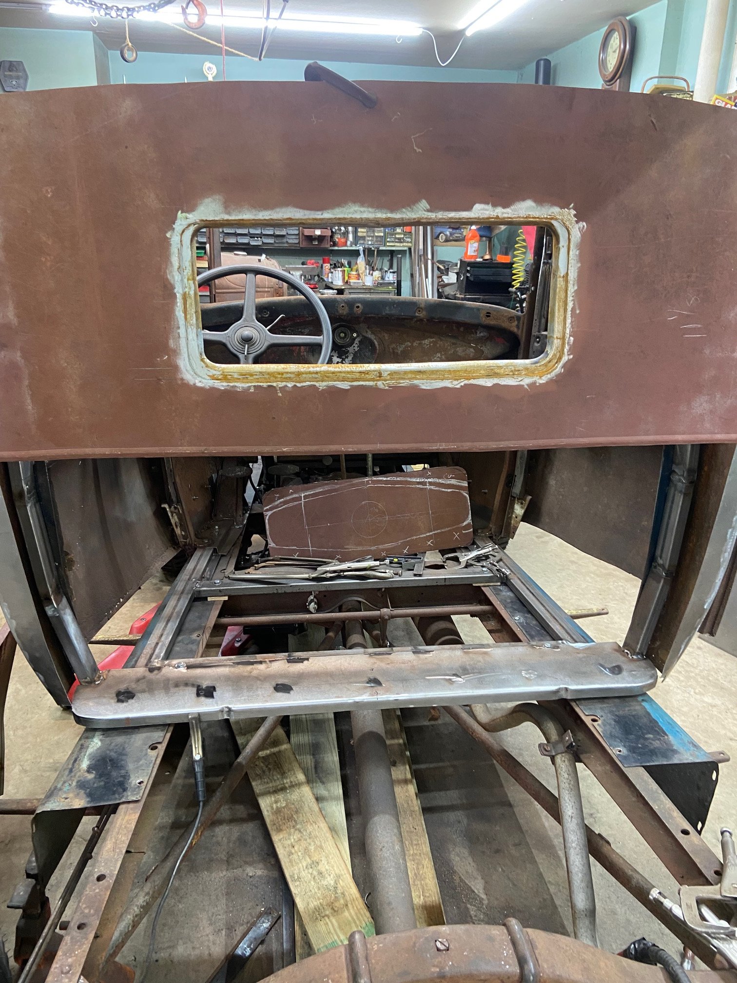

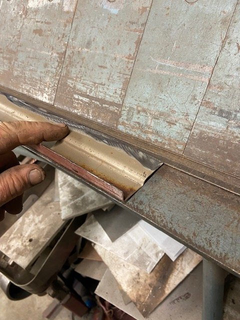

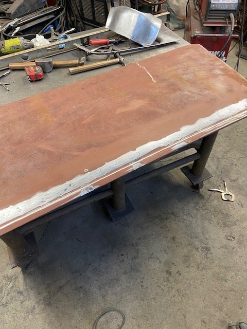

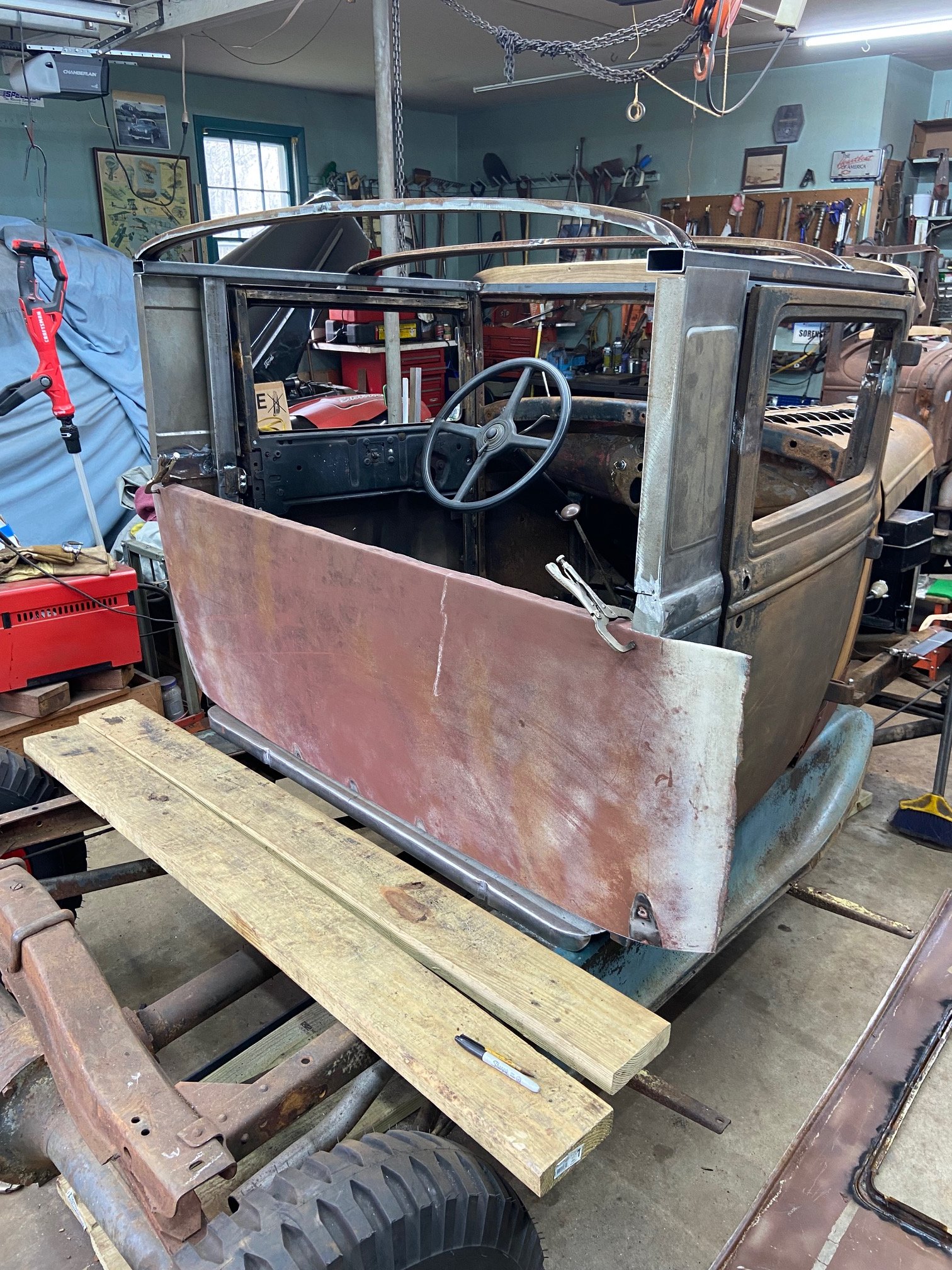

    I fixed my screw up . I bent up a bead on another piece of the donor roof then bent a flange along the bottom. i welded it to the bottom of the back of the cab panel at the correct height. I will finish off the cab corners after the back is welded in. image5.jpeg image6.jpeg image4.jpeg

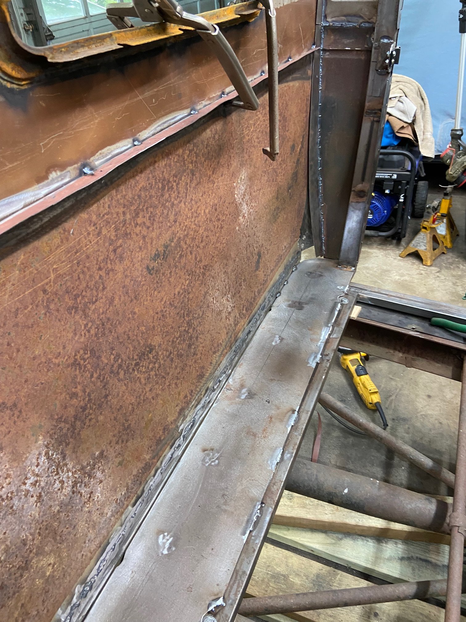

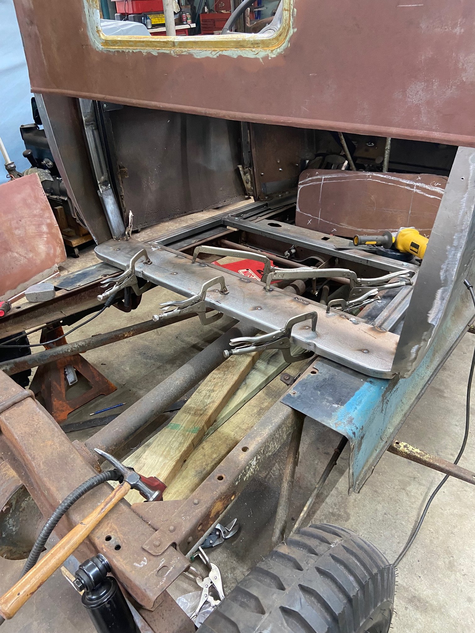

    had a chance to spend the day with the slacker. we fitted up the rear floor pan and the lower back panel. image10.jpeg image9.jpeg

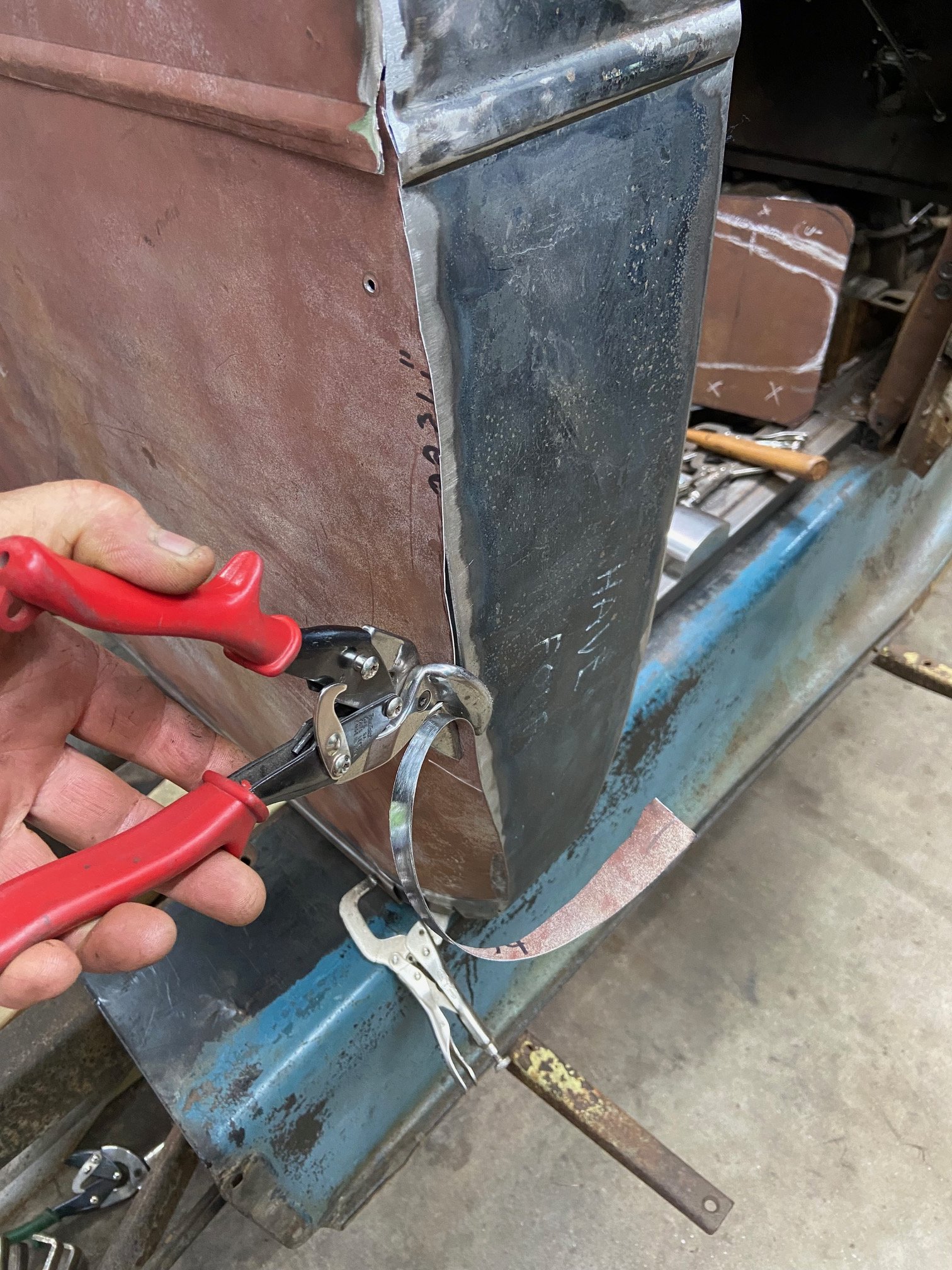

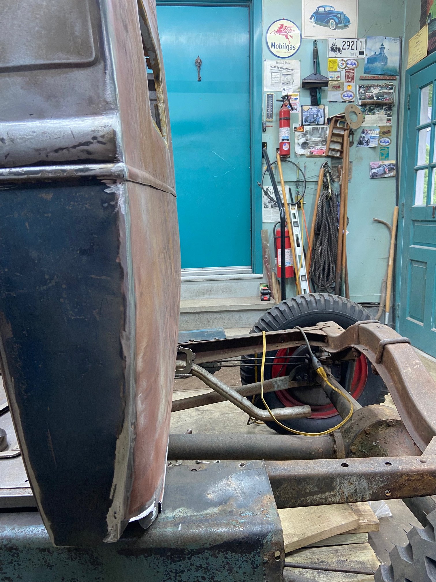

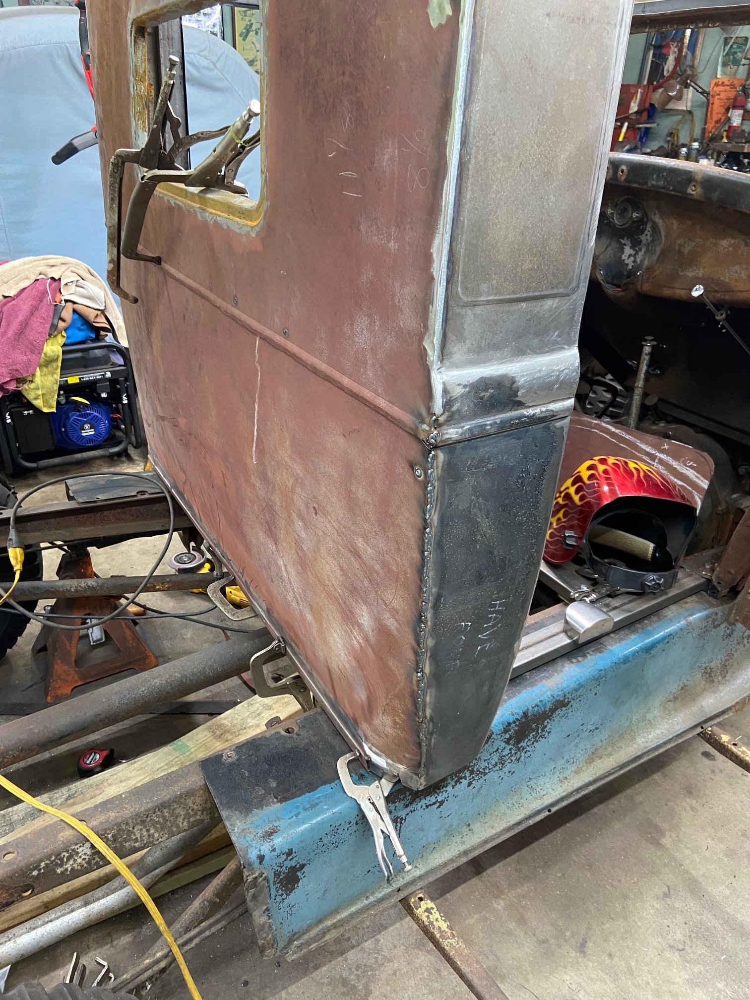

    we then fit the lower panel. I had to work the outer edges with a hammer and dolly to create the start of the cab corner. image8.jpeg

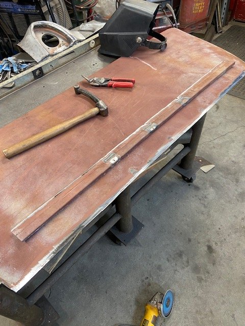

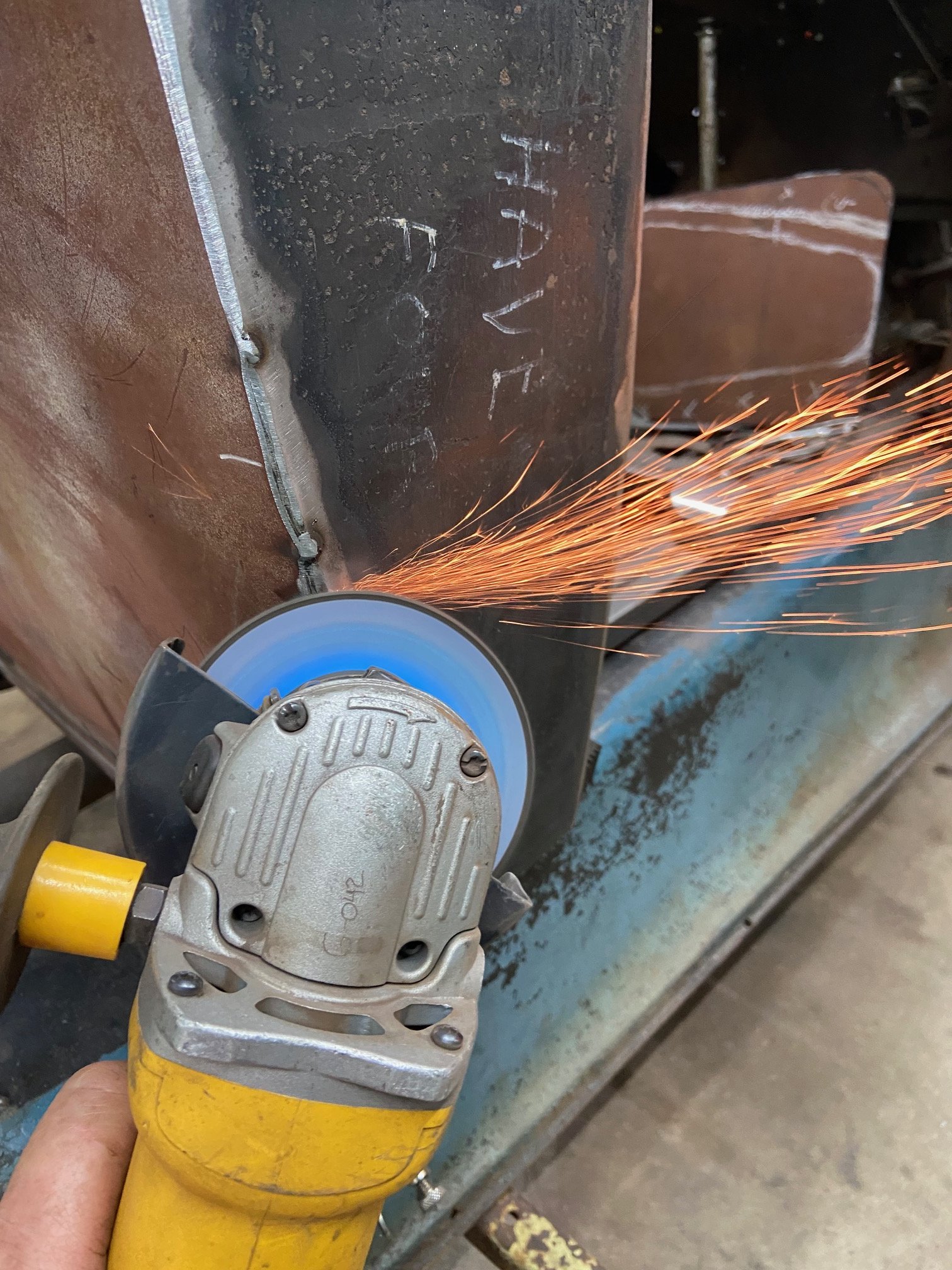

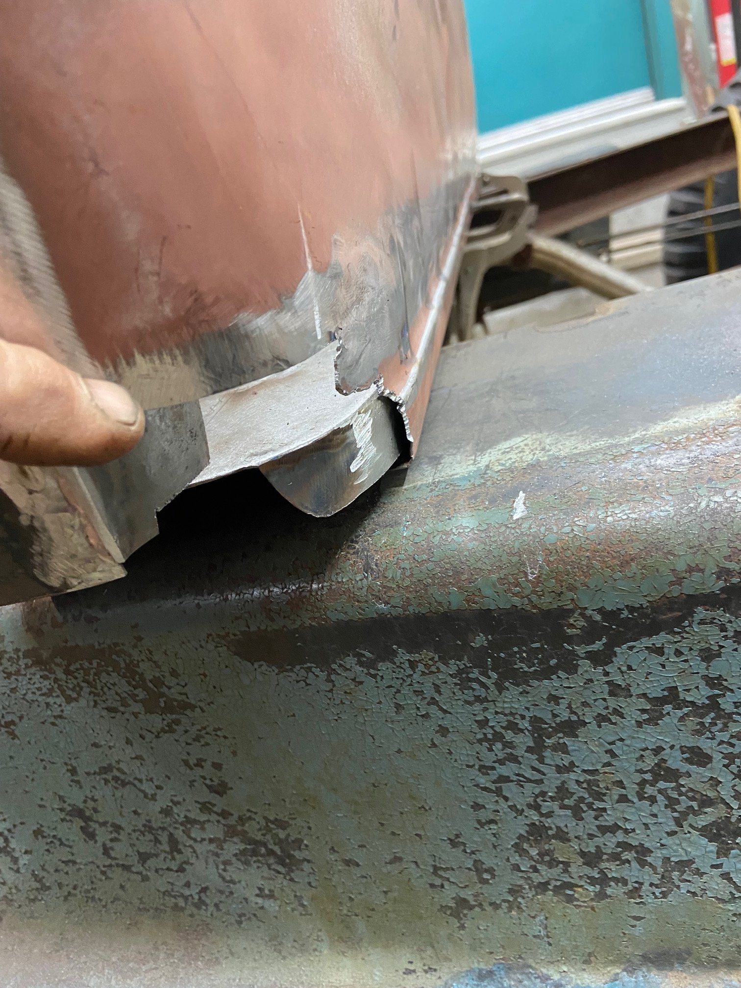

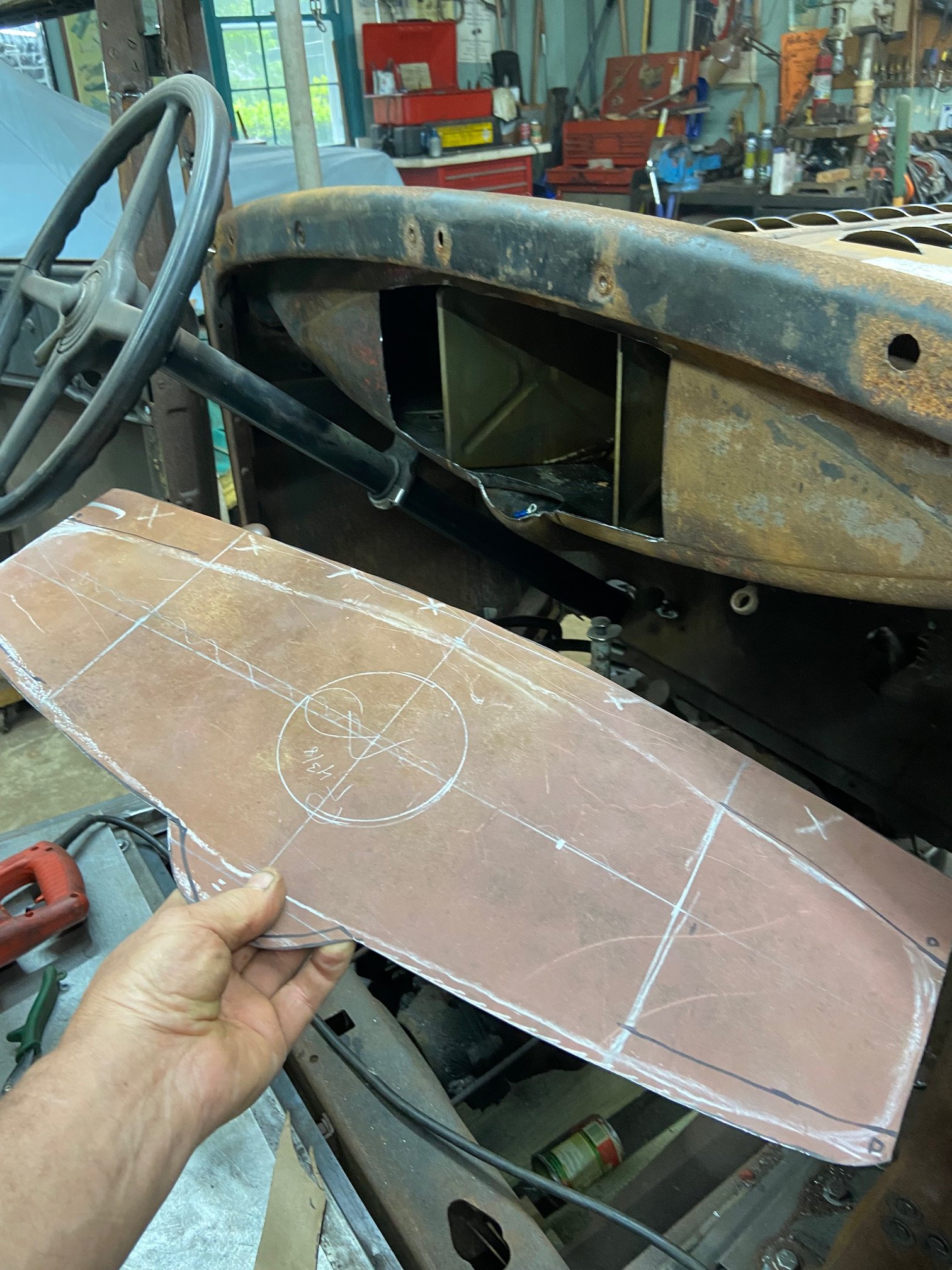

    to finish the cab corners I need to make a couple filler pieces . I made a template . image2.jpeg

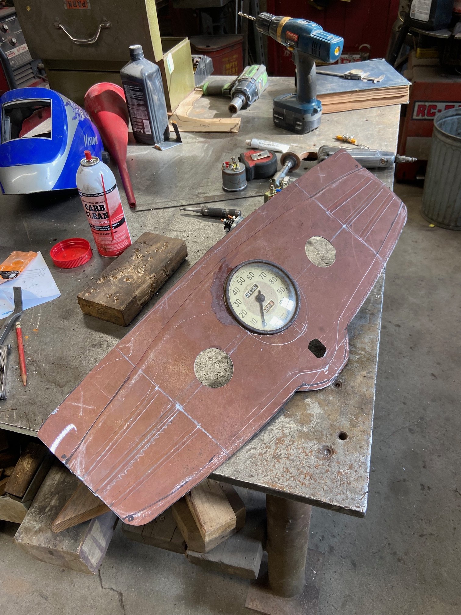

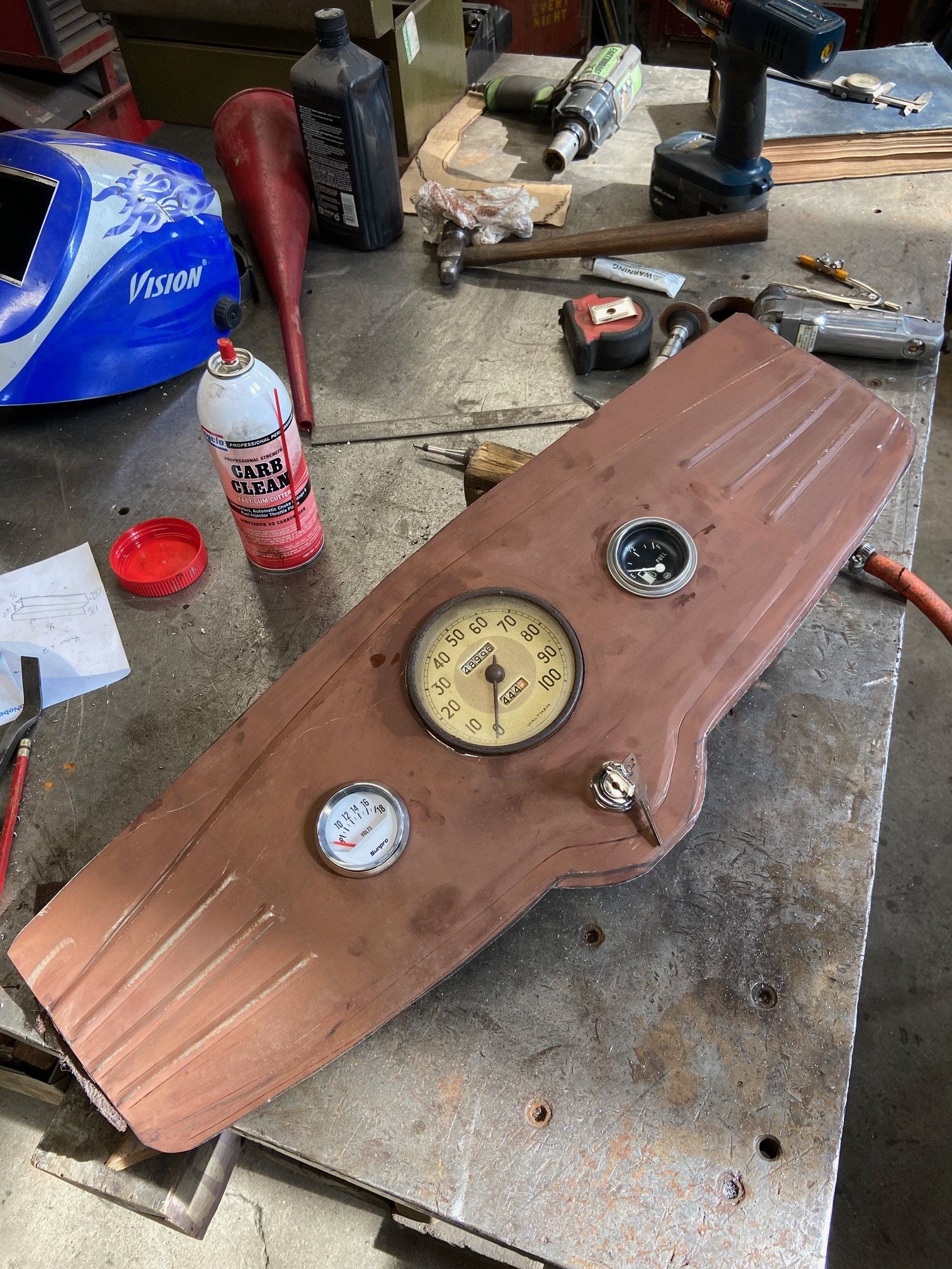

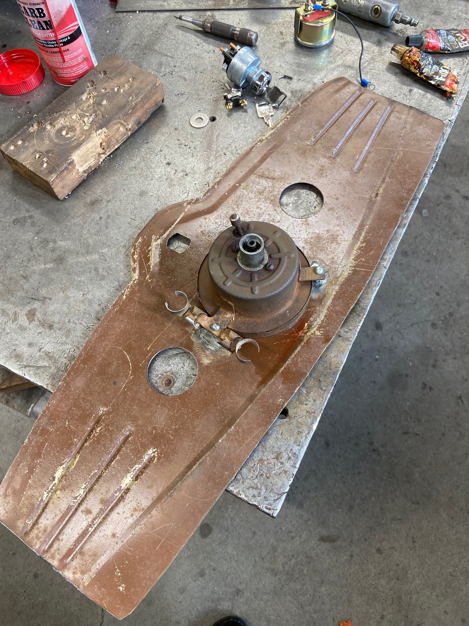

    we cut the tank open to make room for a full set of gages and made a new dash panel . image1.jpeg
    Okie Pete, Deutscher, dwollam and 5 others like this.

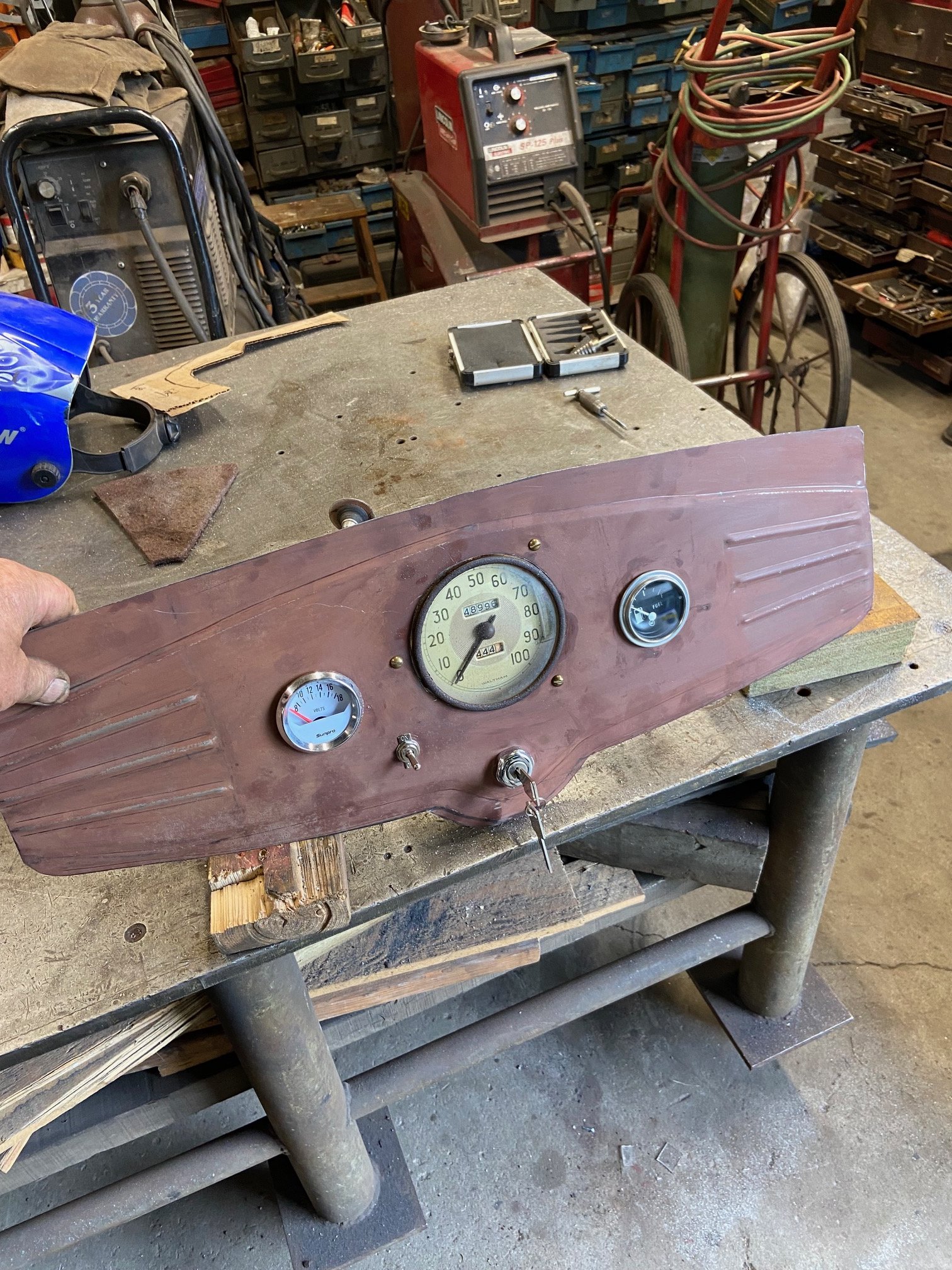

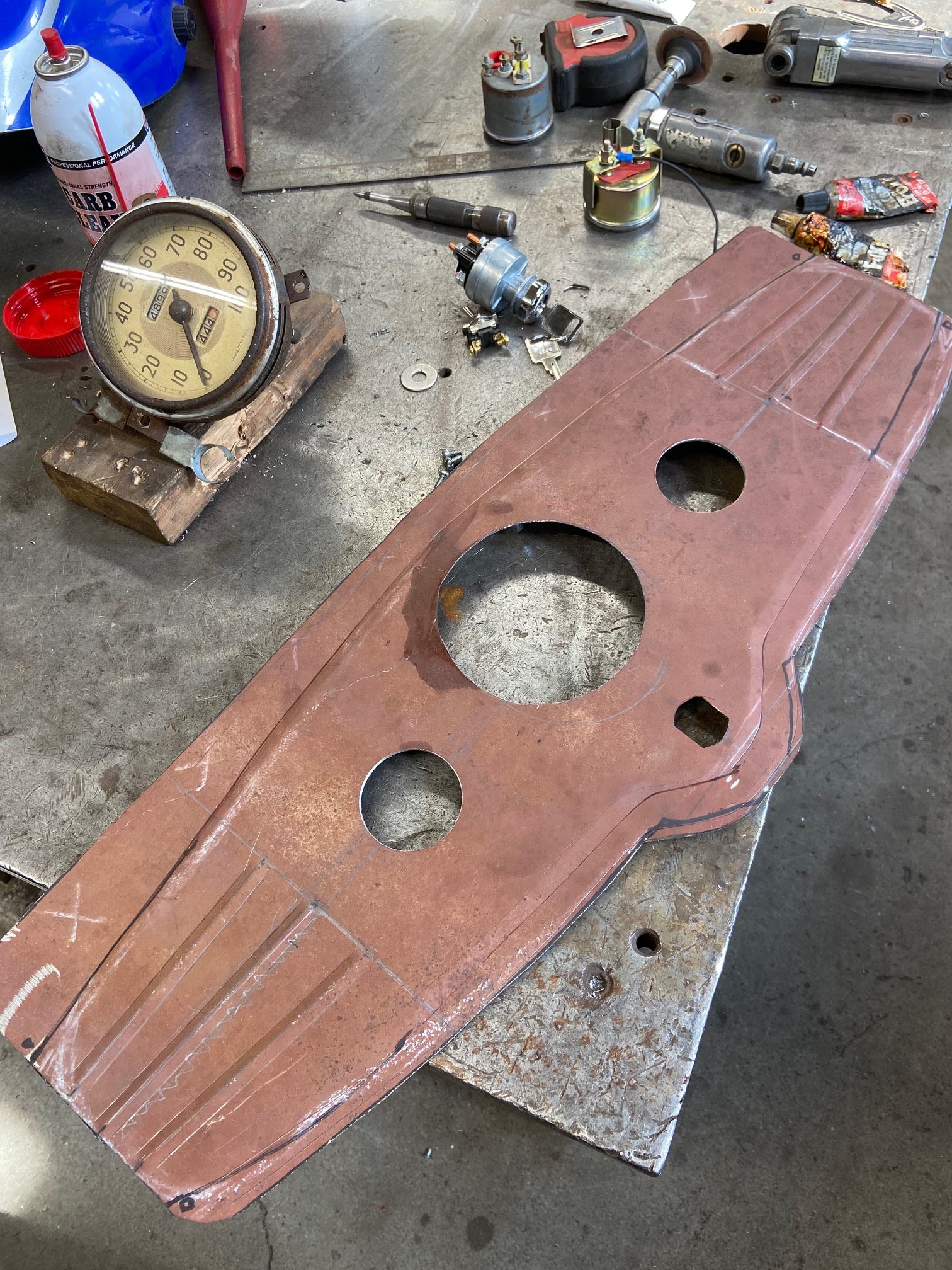

    Charlie laid out where he wanted the gages and I cut the holes for him. I added a few beads and stepped the original shape into the panel. image4.jpeg image3.jpeg image2.jpeg image1.jpeg image0.jpeg
