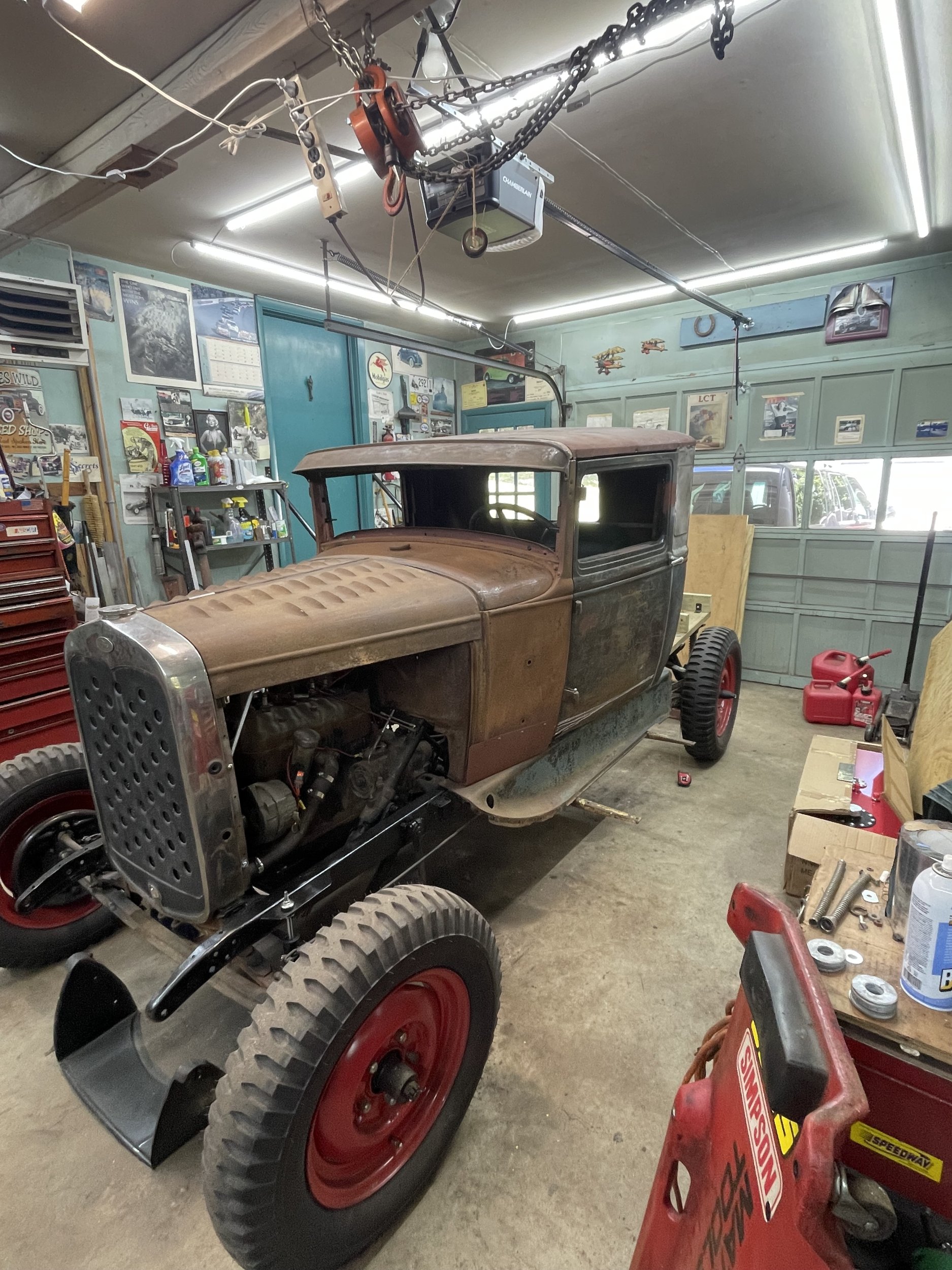

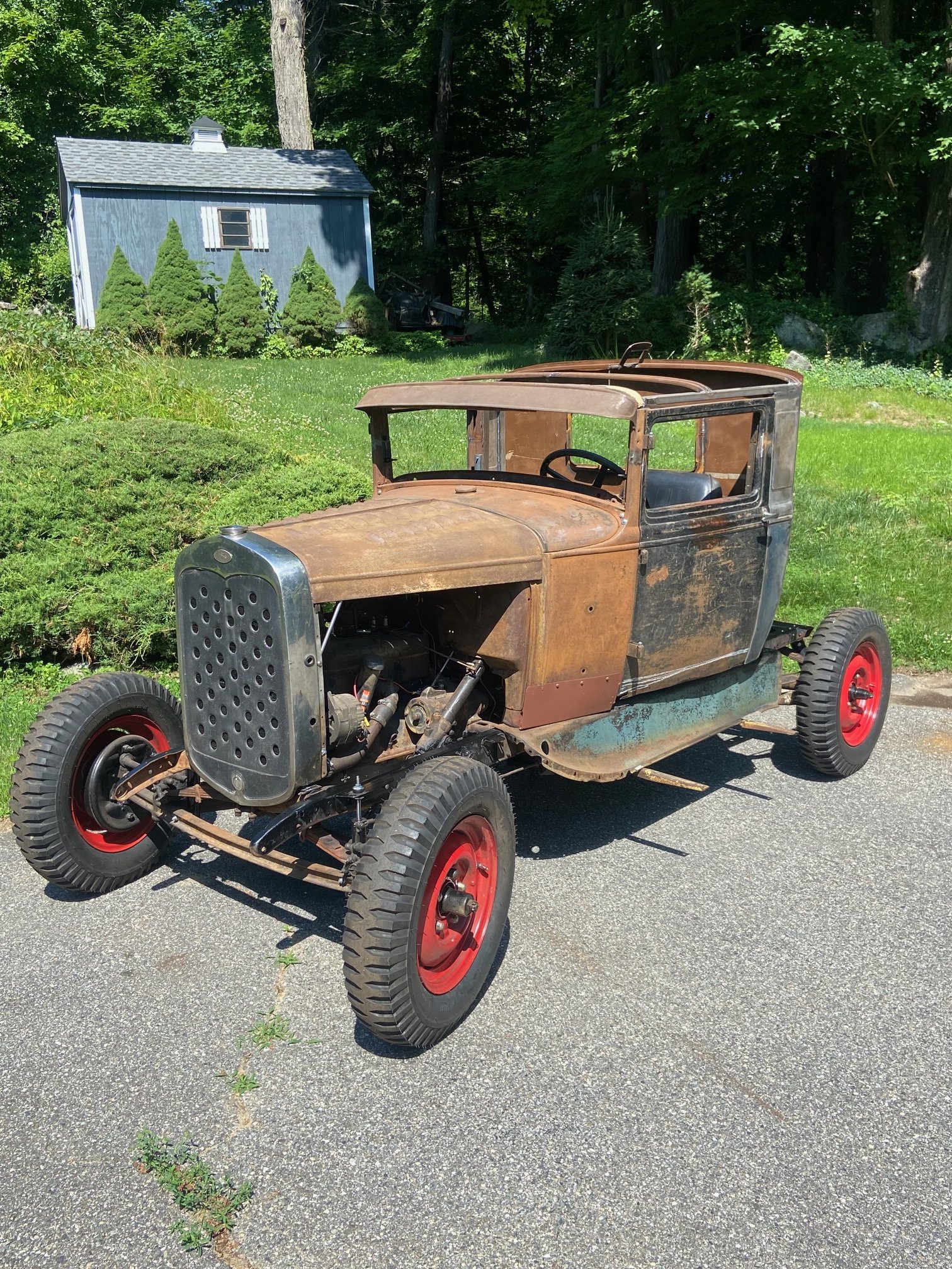

    went to the slacker's to get some stuff done today. started by moving #1 ch***is out to the shed so Charlie has room to build the bed. had to get a shot of it outside. image1.jpeg

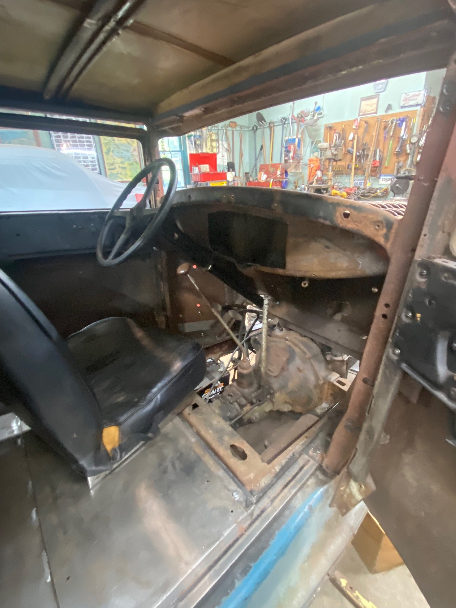

    image6.jpeg image7.jpeg image8.jpeg then made sure everything clears. Charlie will take it back out and paint and wire everything. we plan on replacing the tek screws with nut-serts

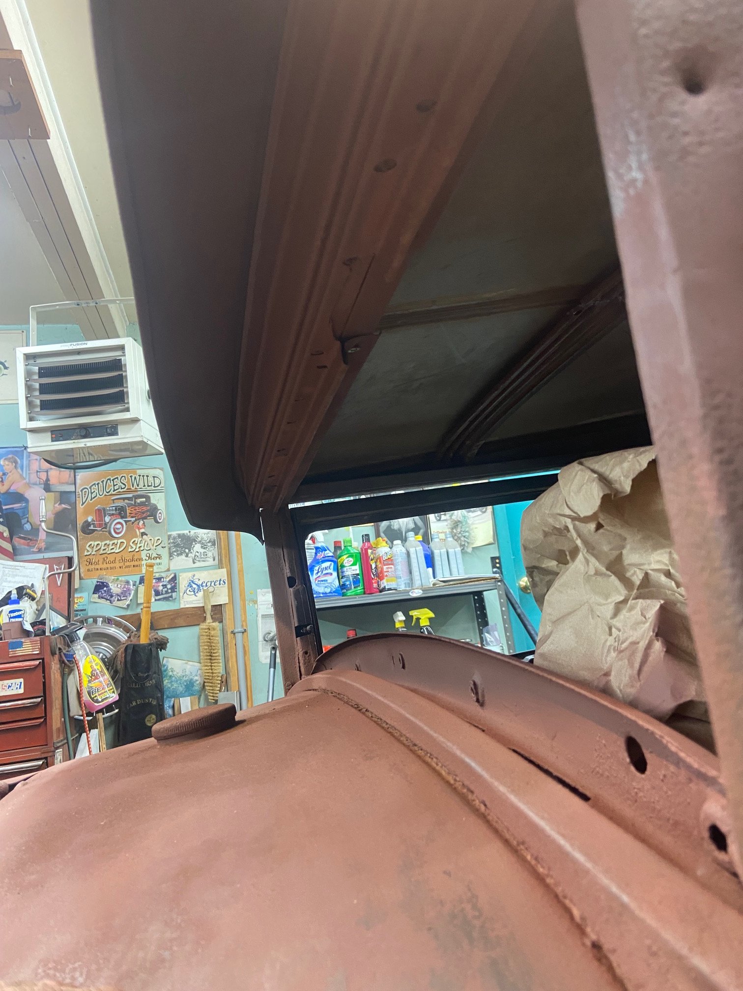

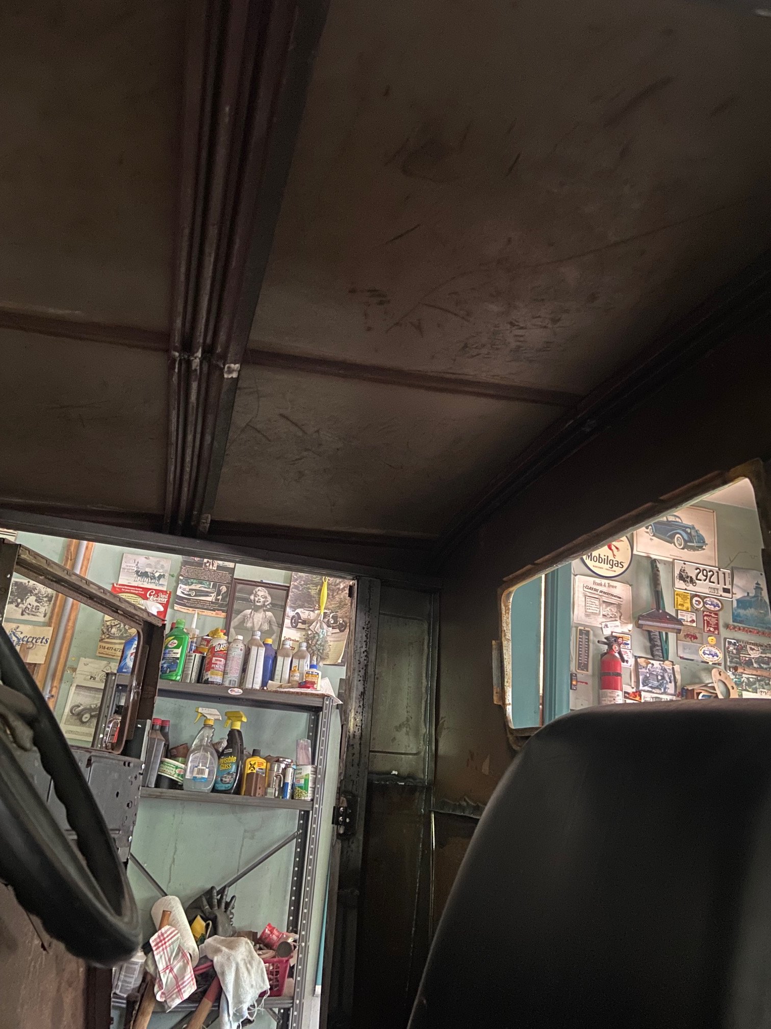

  5. tb33anda3rd
    Joined: Oct 8, 2010
    Posts: 17,583
    tb33anda3rd

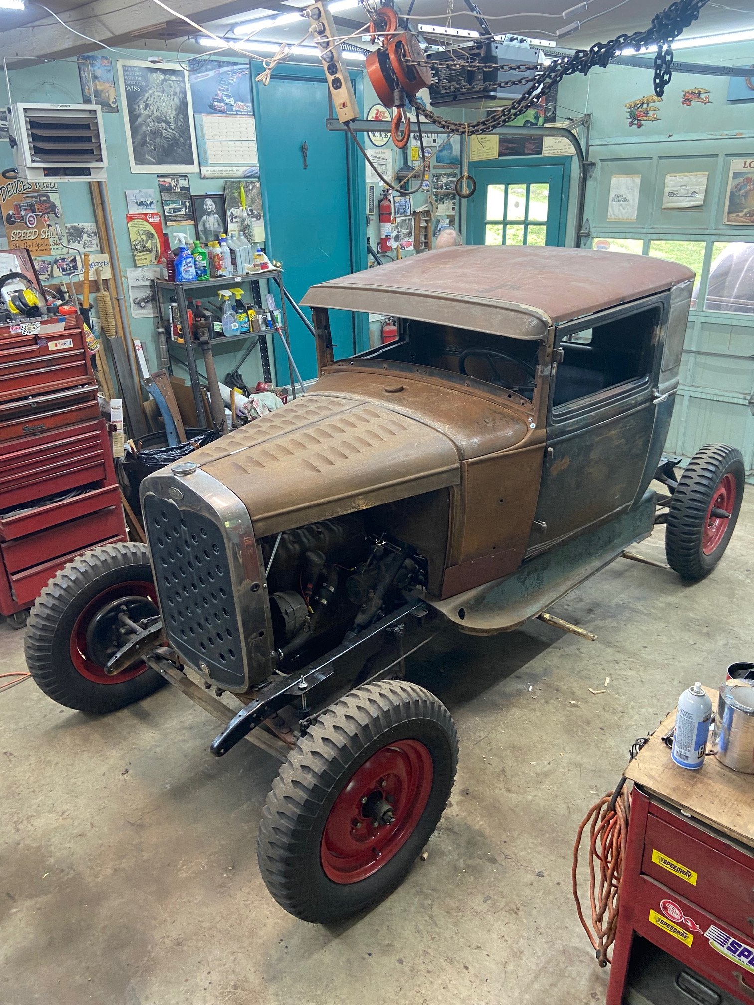

    after lunch we decided to get the roof started. I started by bending the back panel and forming it around the roof rib. image0.jpeg image1.jpeg
    Okie Pete, TFoch, Deutscher and 6 others like this.
  6. tb33anda3rd
    Joined: Oct 8, 2010
    Posts: 17,583
    tb33anda3rd

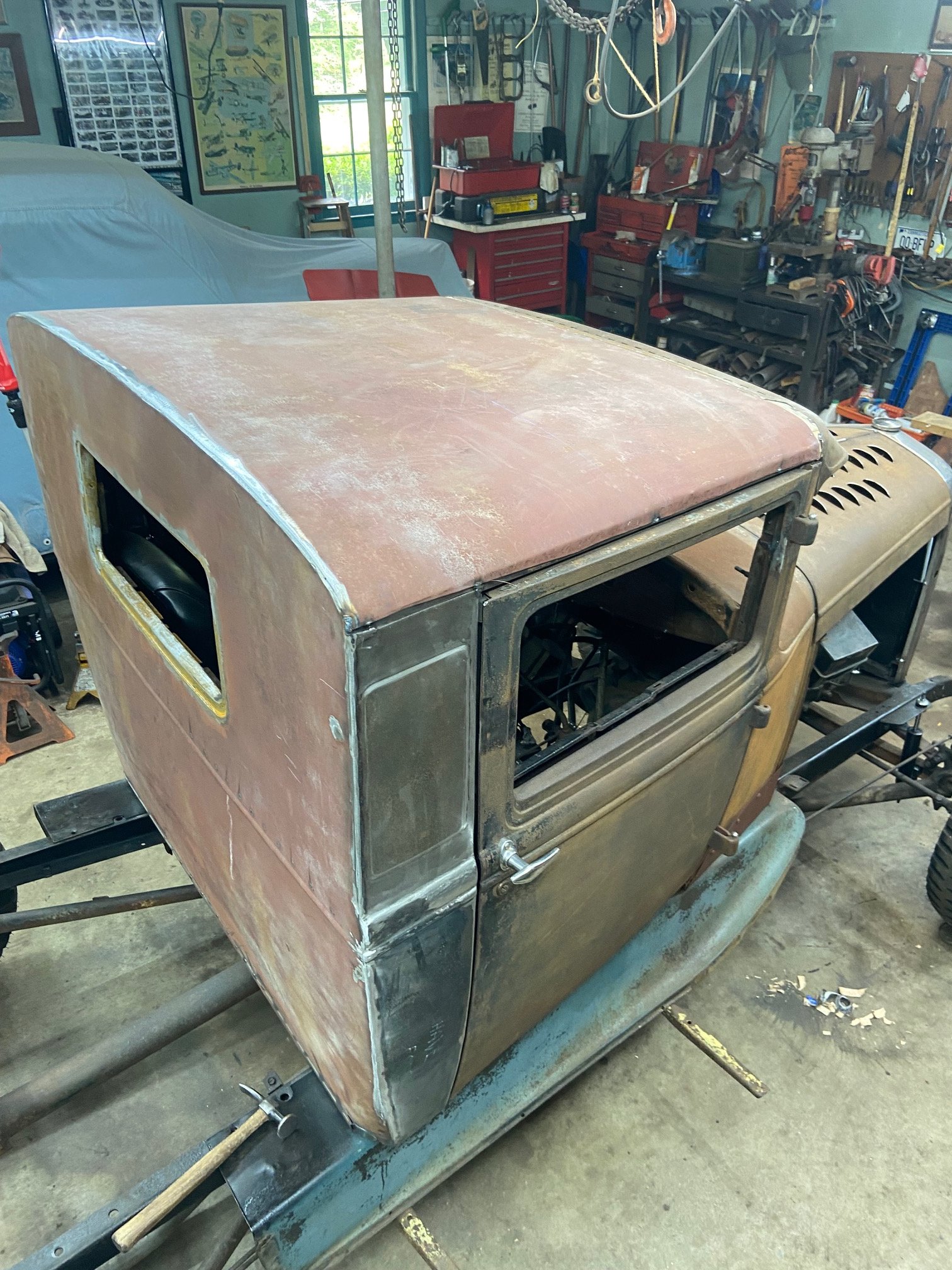

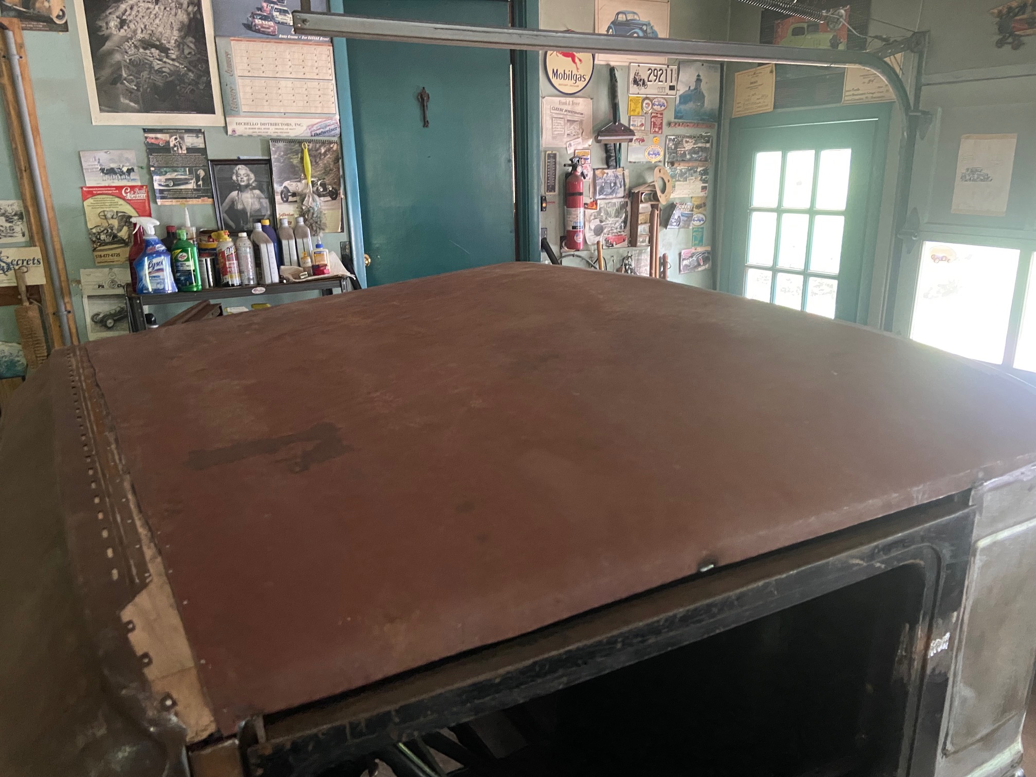

    trimmed the roof panel to fit as good as I could, it was actually about three inches shorter than I wanted but this was the biggest piece left of the salvaged '65 suburban roof. I welded it across the back and nailed it to the windshield header across the front. I folded the sides over the side rail. image2.jpeg

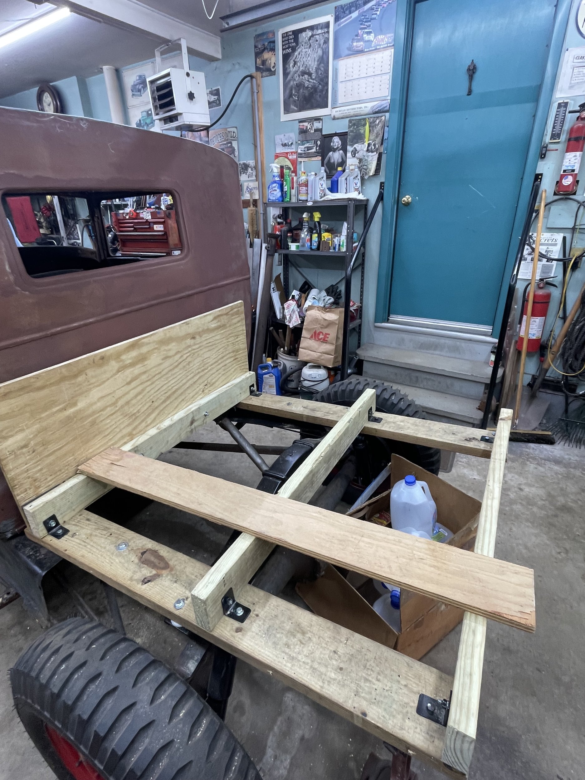

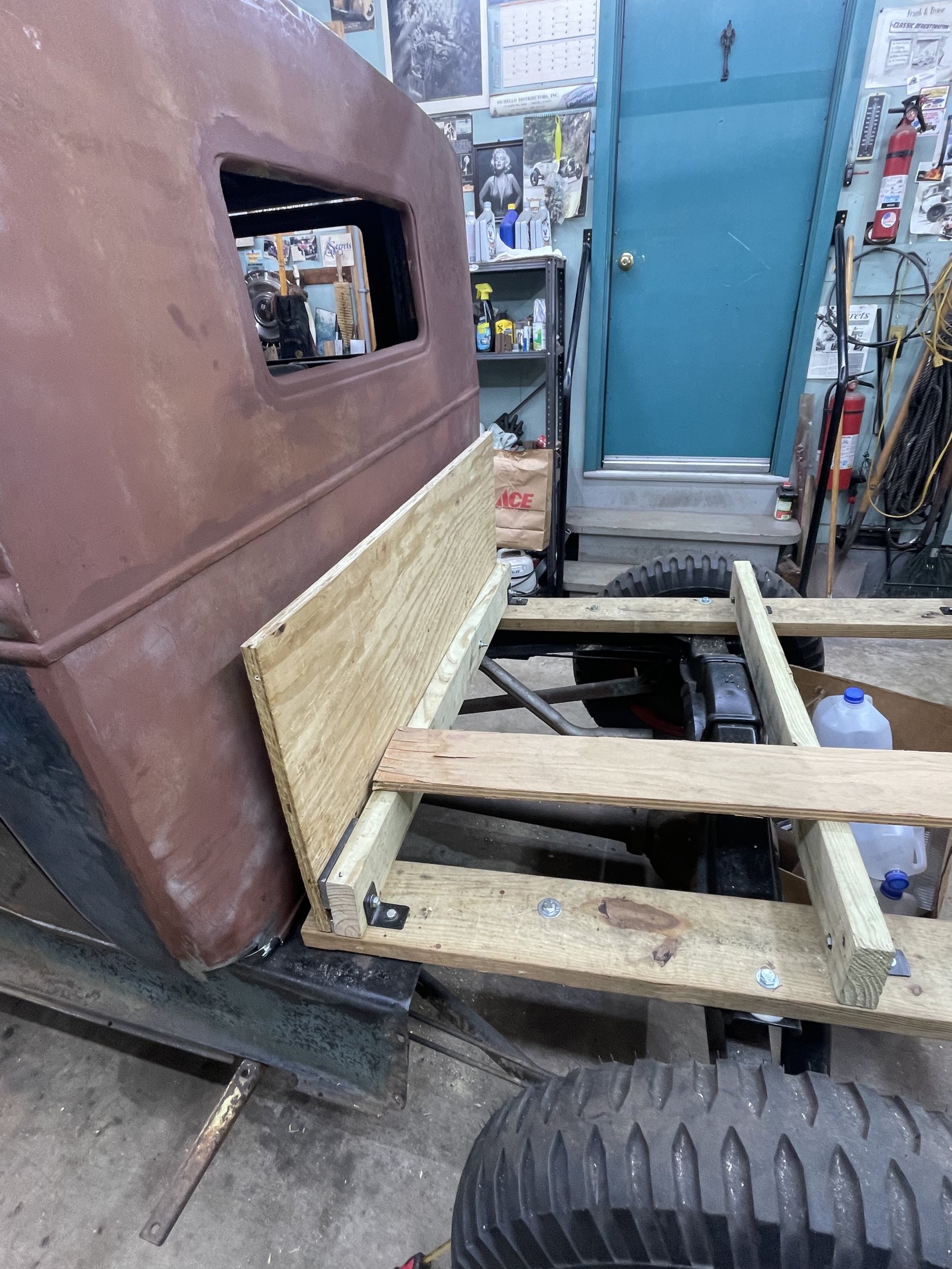

    I stopped at Charlies to help him square up the bed. we made some head way.
    Okie Pete, TFoch, Deutscher and 5 others like this.
  20. This is a great shot. The proportions for the box look about right. Fun, fun, fun.
    tb33anda3rd likes this.

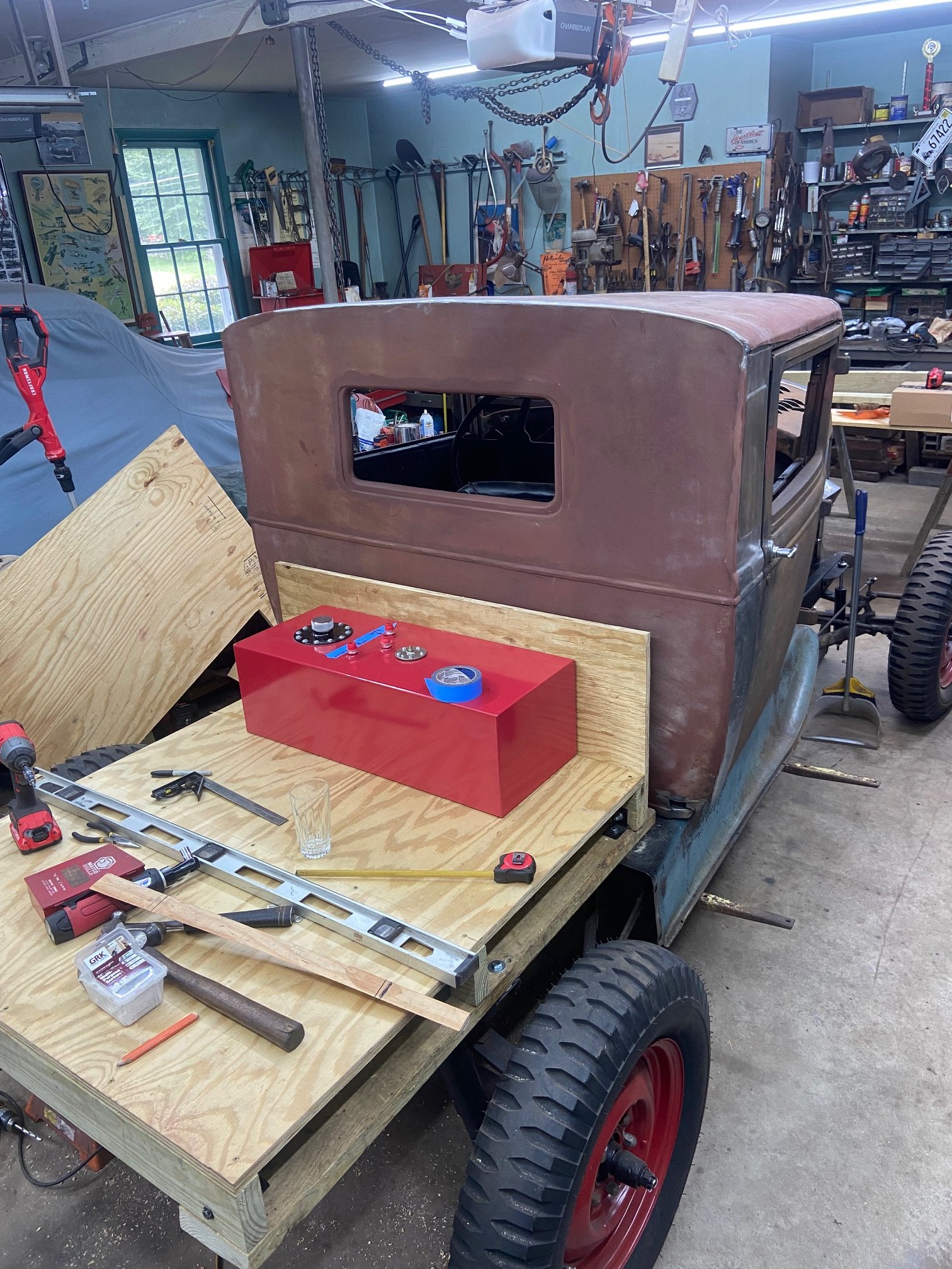

  25. tb33anda3rd
    Joined: Oct 8, 2010
    Posts: 17,583
    tb33anda3rd
    Charlie has been busy, he primed the weld spots and bed then started mounting the fuel tank. image0.jpeg
    Okie Pete, TFoch, dwollam and 5 others like this.

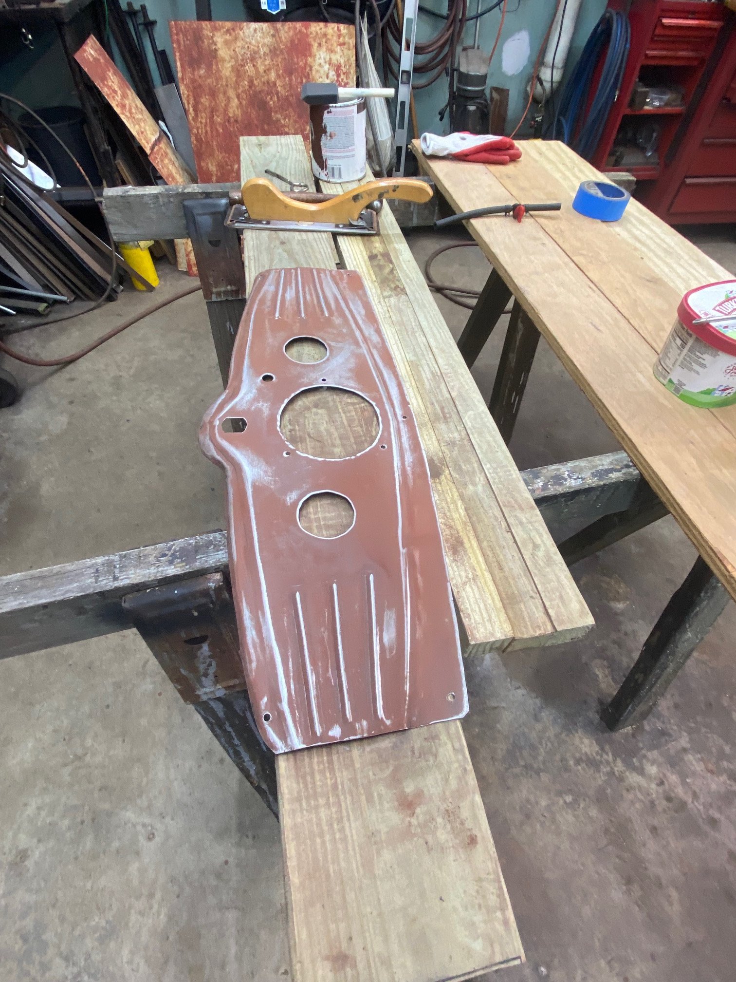

  27. tb33anda3rd
    Joined: Oct 8, 2010
    Posts: 17,583
    tb33anda3rd
    I am not sure how he plans to paint it but he took the dash panel out, removed the gages and prepped it for paint. image1.jpeg

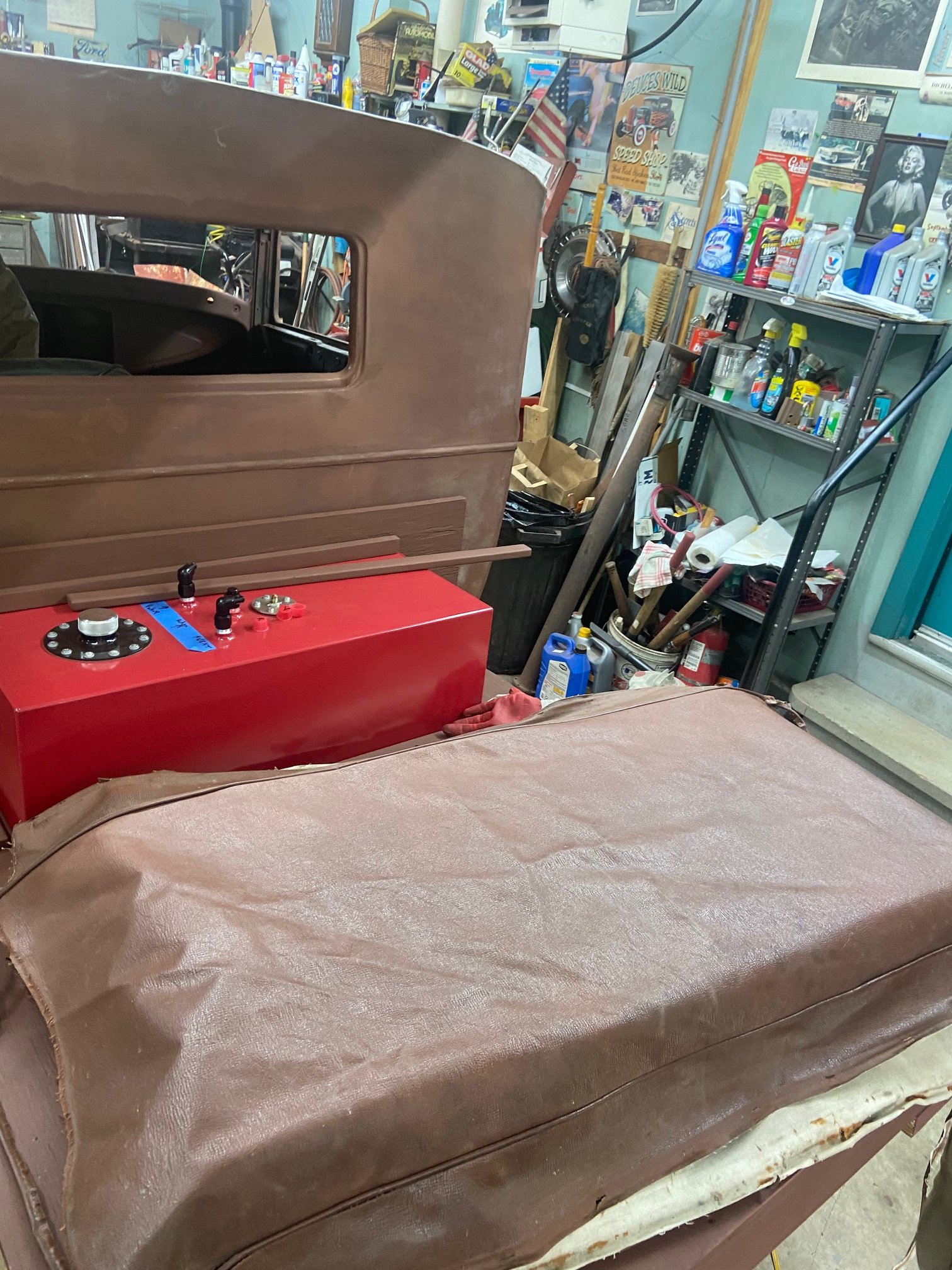

  28. tb33anda3rd
    Joined: Oct 8, 2010
    Posts: 17,583
    tb33anda3rd
    Charlie was given some foam by a friend and I brought over some old material I took out of a 1948 suburban that should work to make a seat. image0.jpeg image1.jpeg

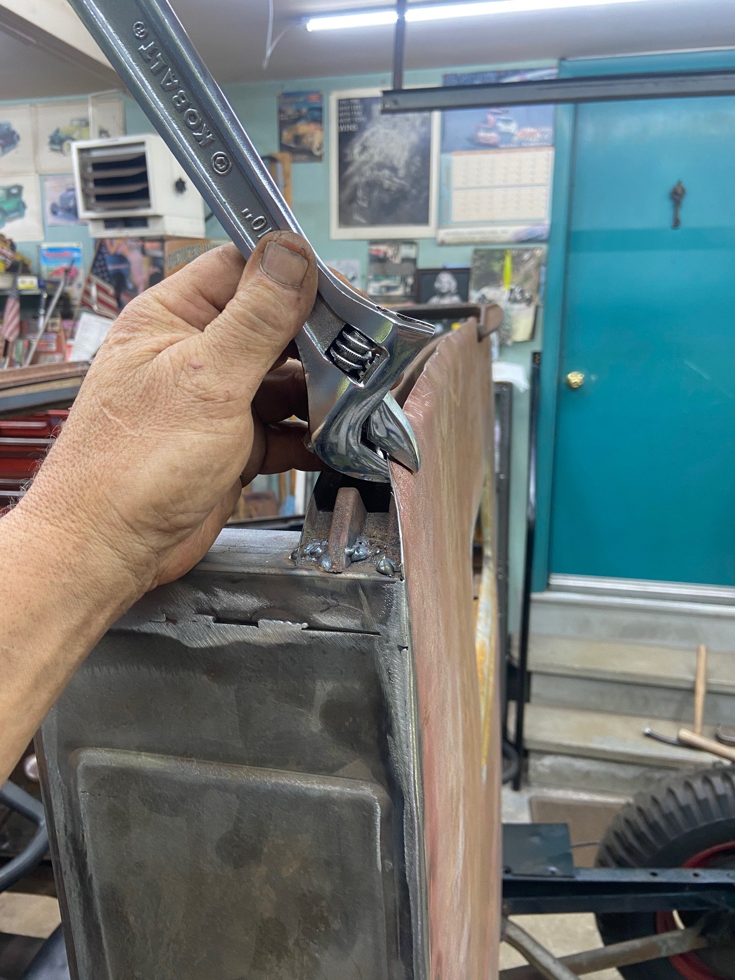

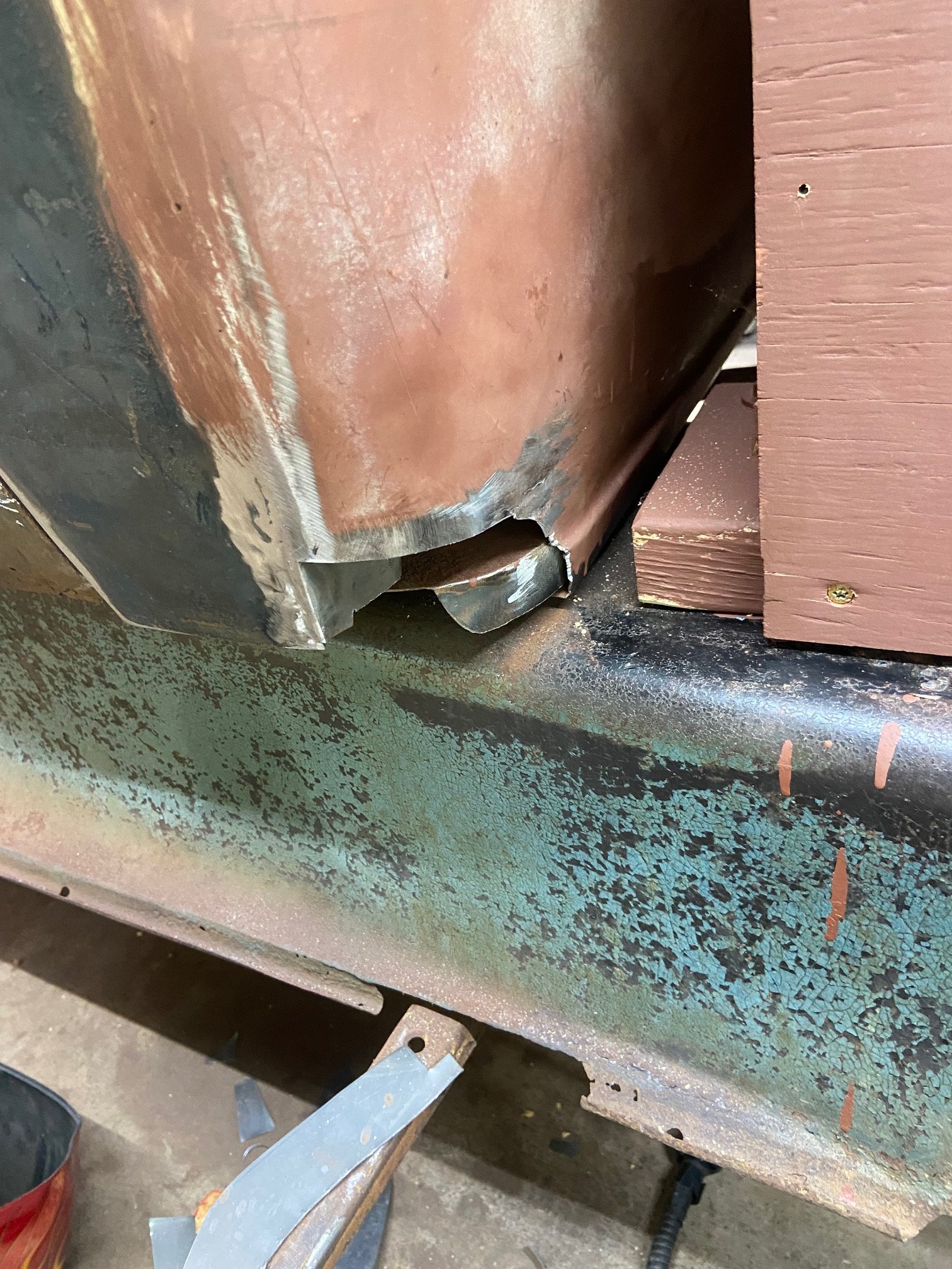

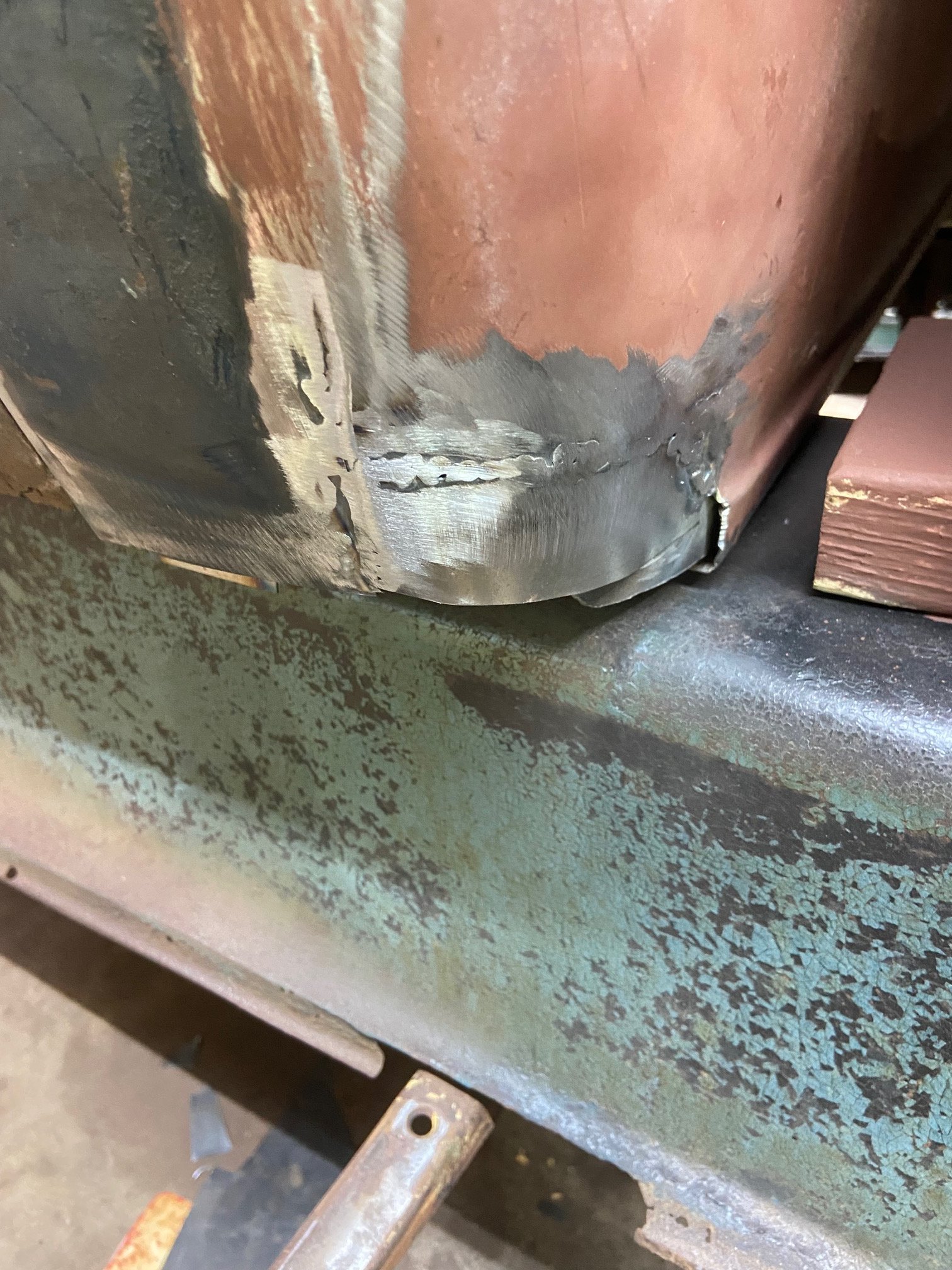

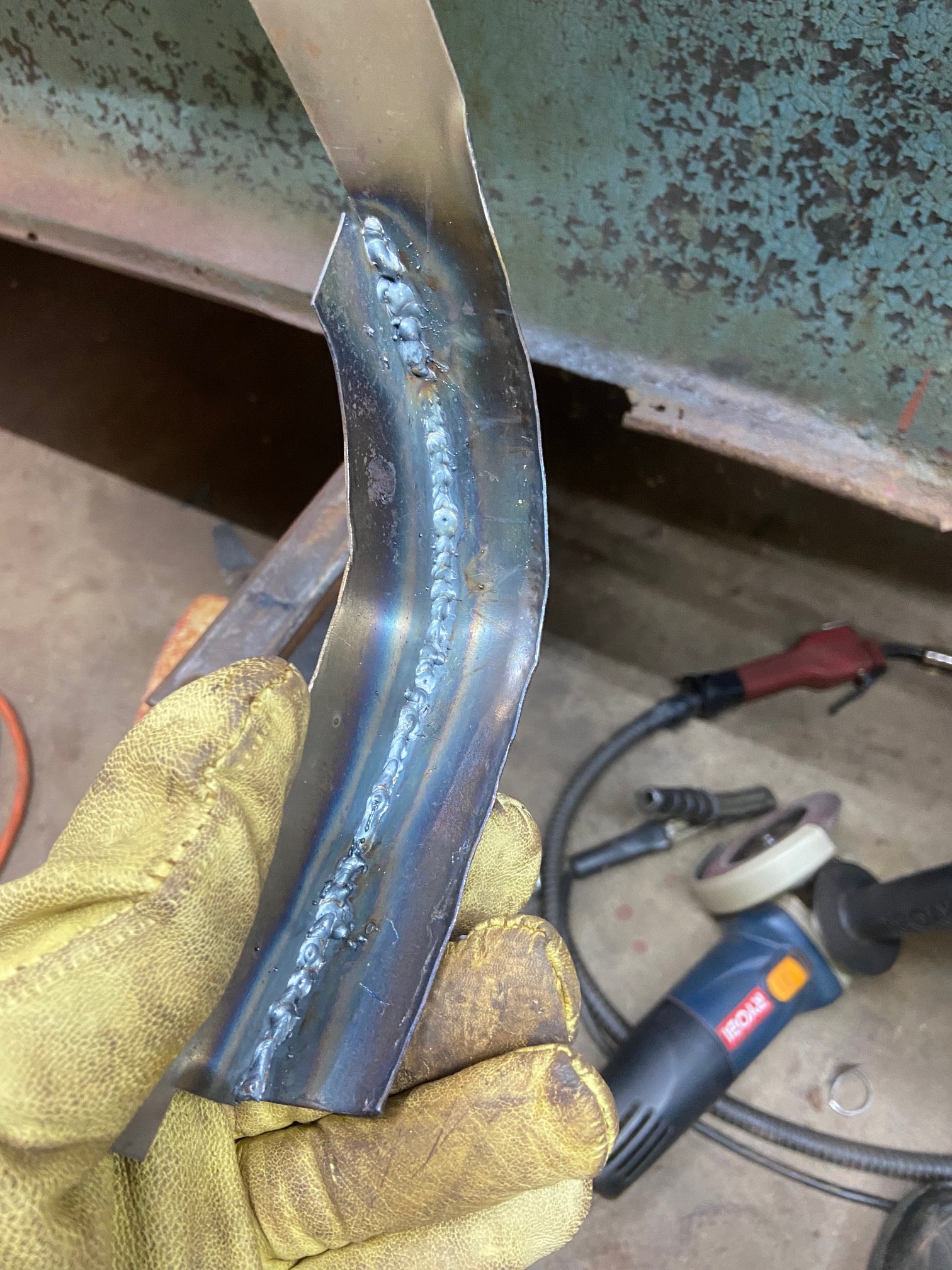

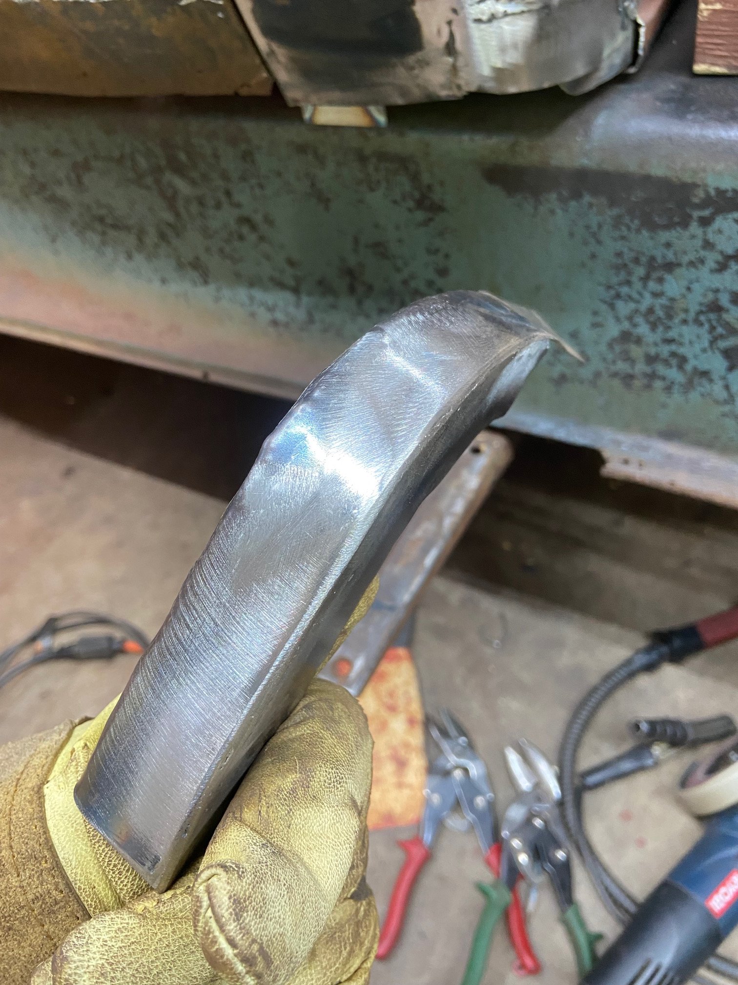

  30. tb33anda3rd
    Joined: Oct 8, 2010
    Posts: 17,583
    tb33anda3rd
    worked on the cab corners for the slacker today. image7.jpeg image6.jpeg image5.jpeg image4.jpeg
