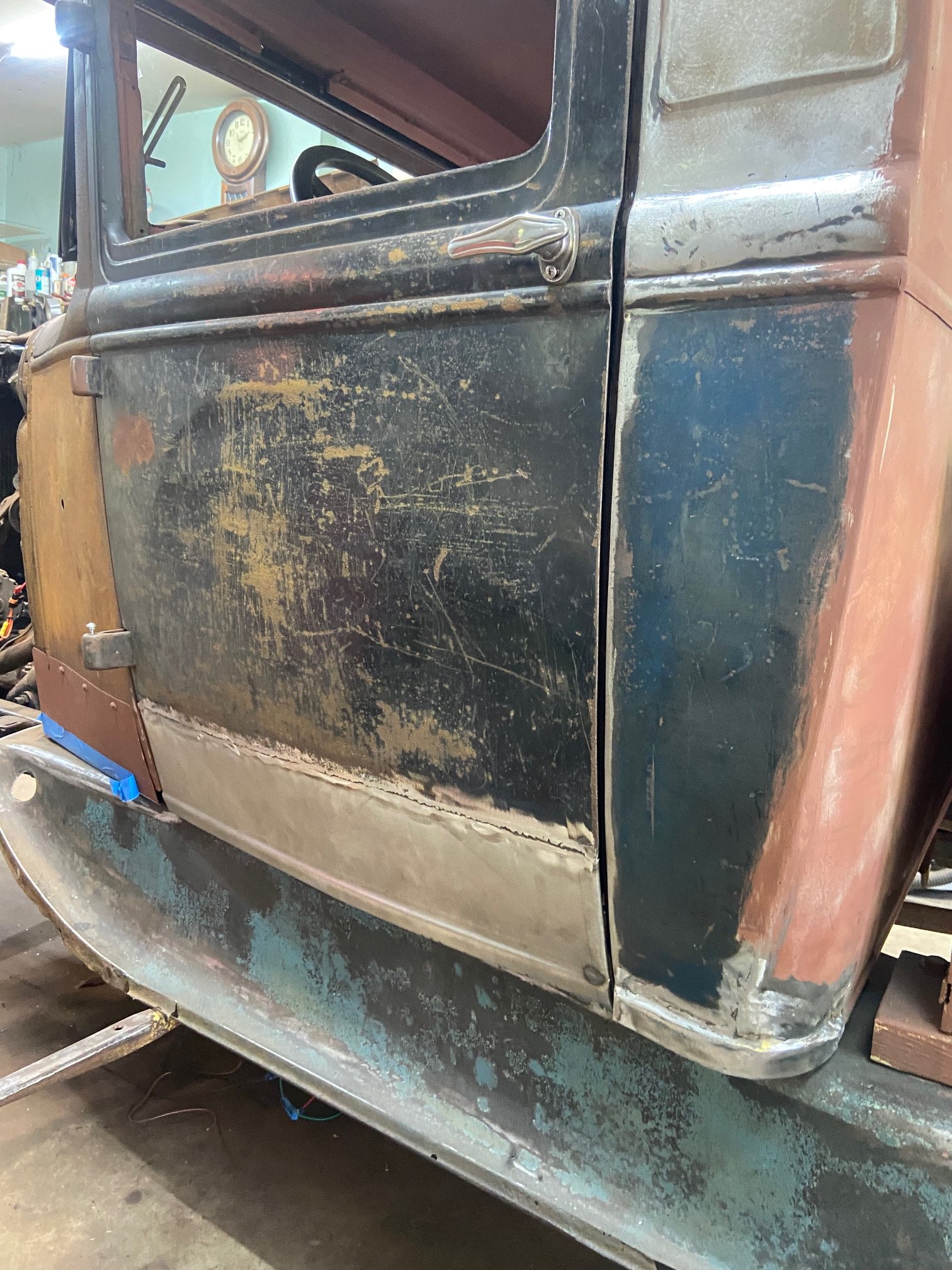

    Posts: 17,595

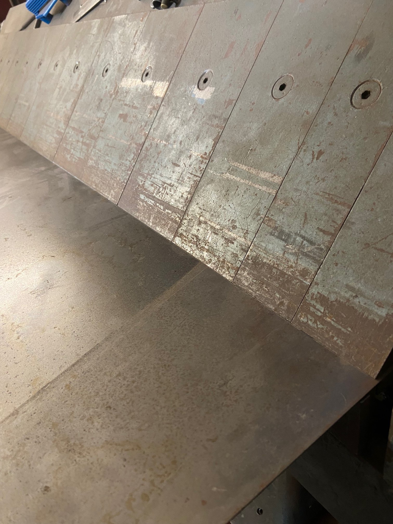

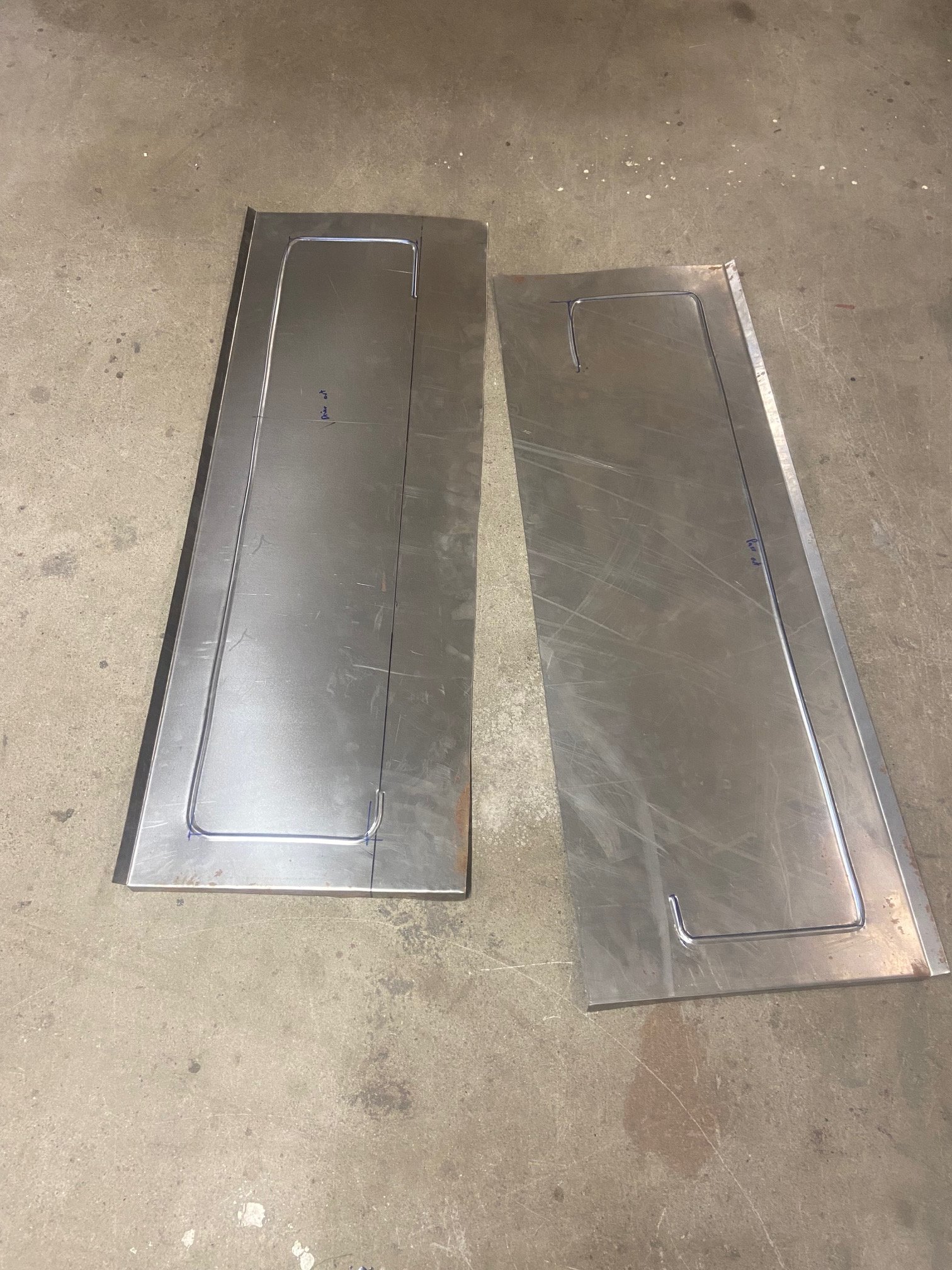

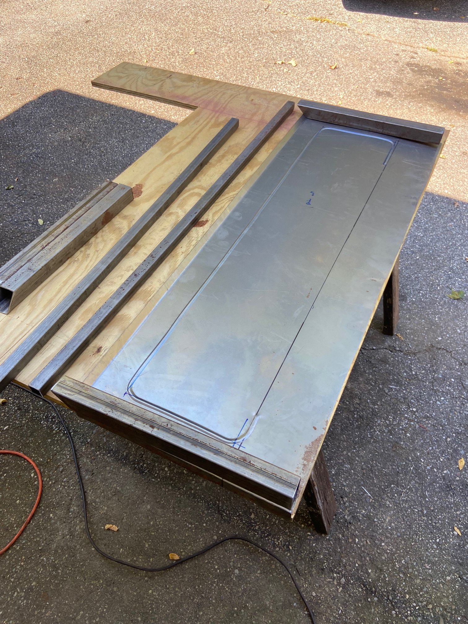

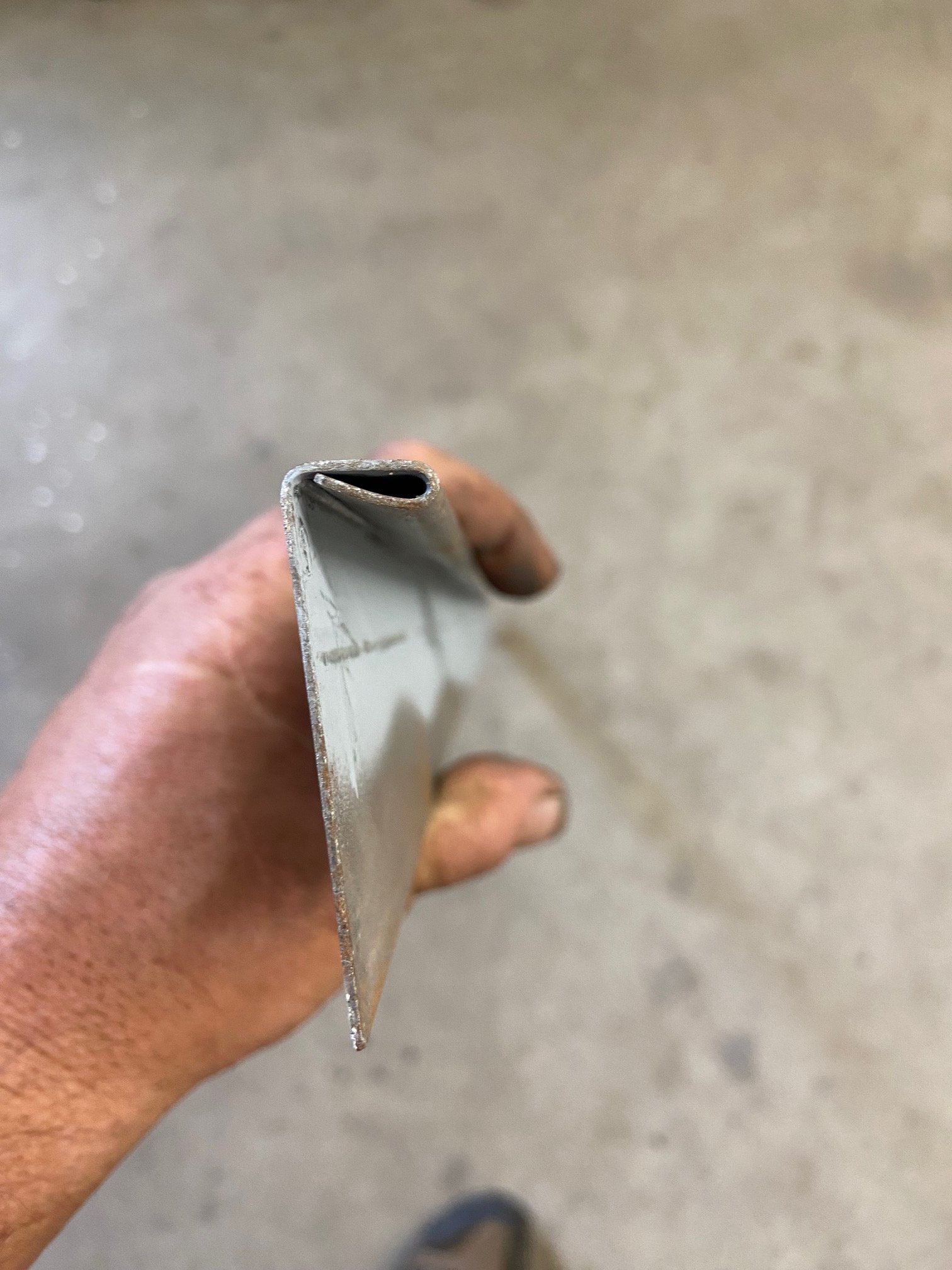

    made Charlie some patch panels for the doors at my shop. image4.jpeg image3.jpeg image2.jpeg image1.jpeg used my break to bend the bead and return then used the shrinker to put the arch in it.

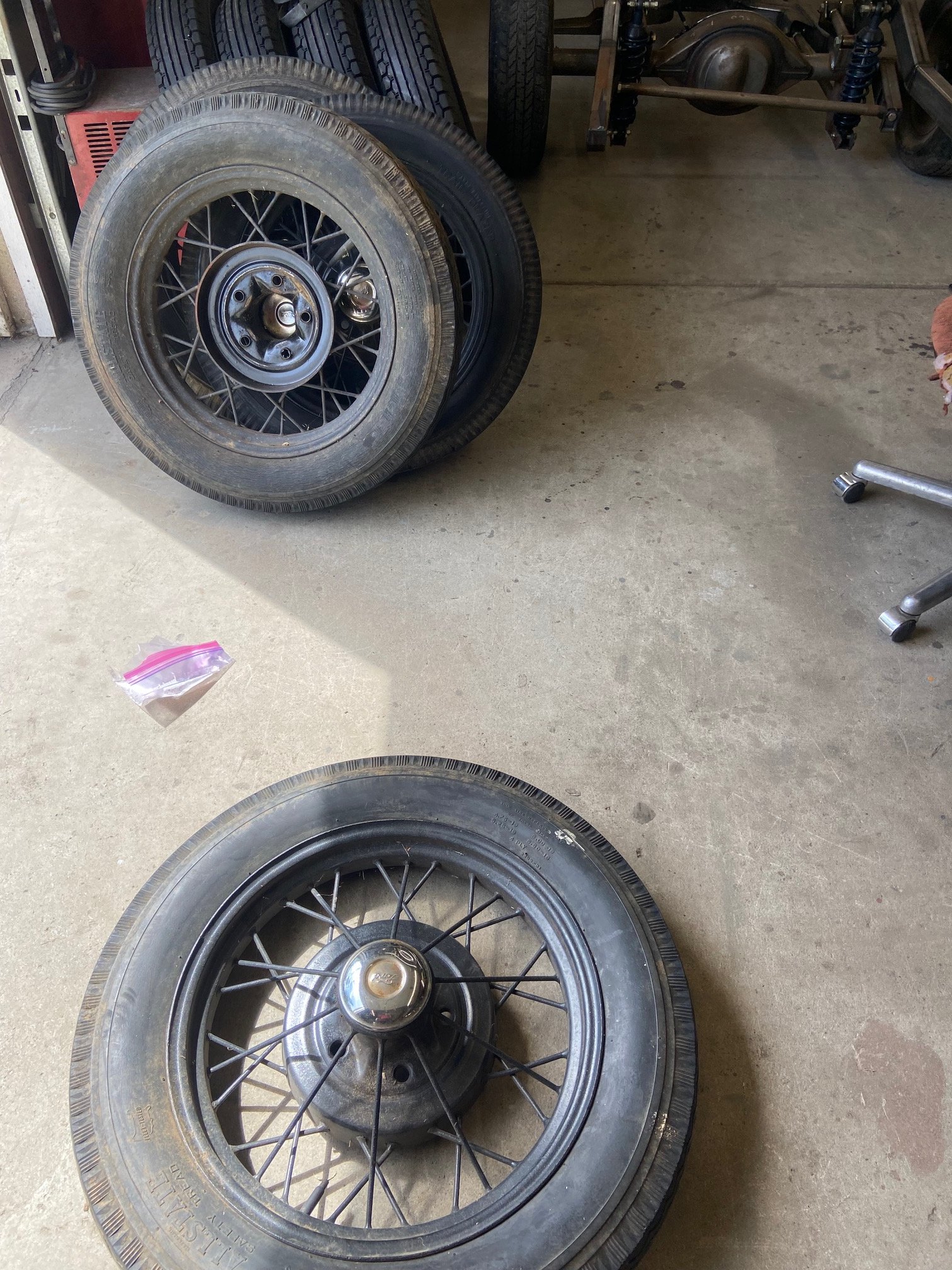

    we also mounted up a set of tires on A rims. we went through all our old tubes to find four good ones. image0.jpeg

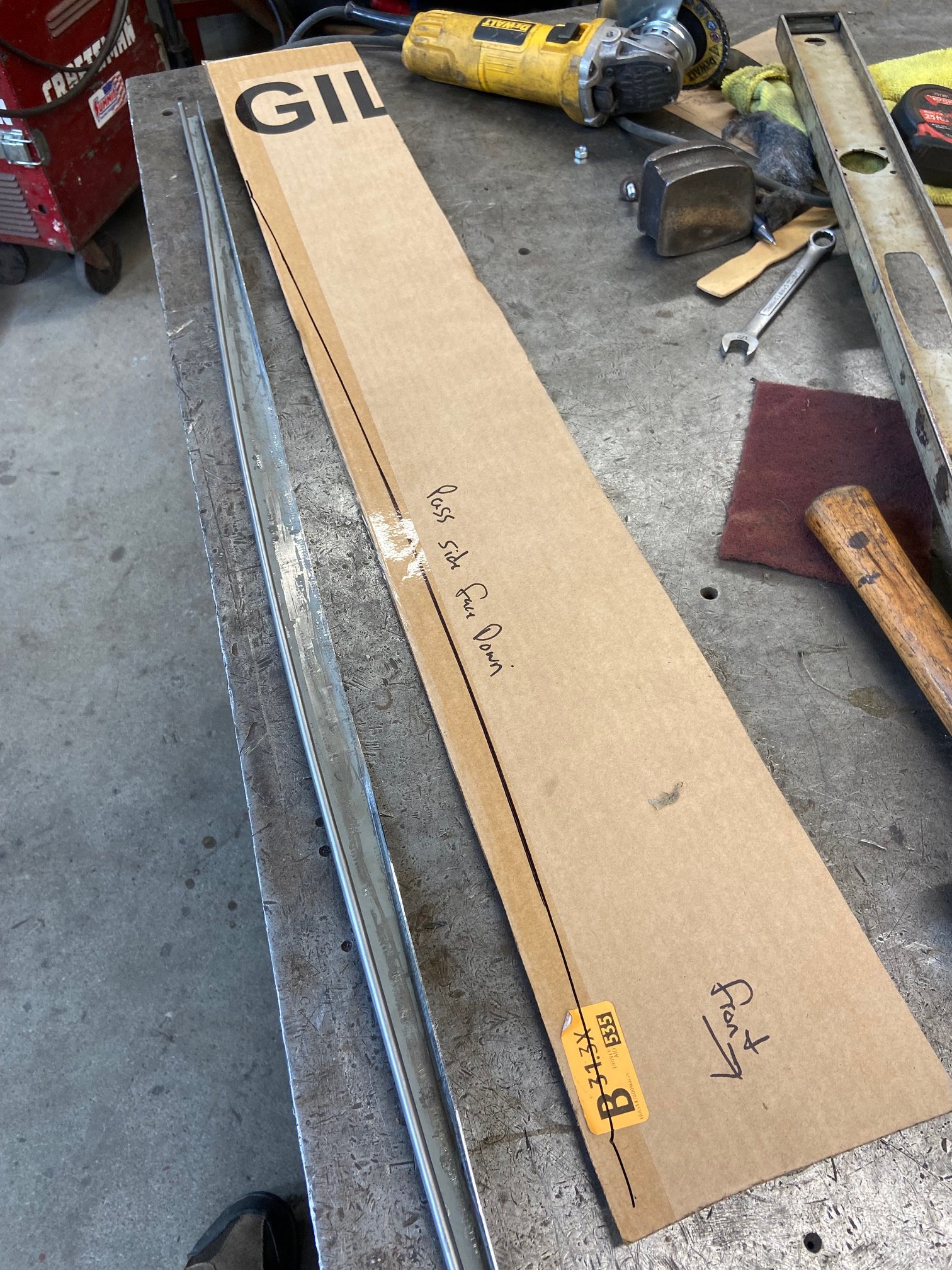

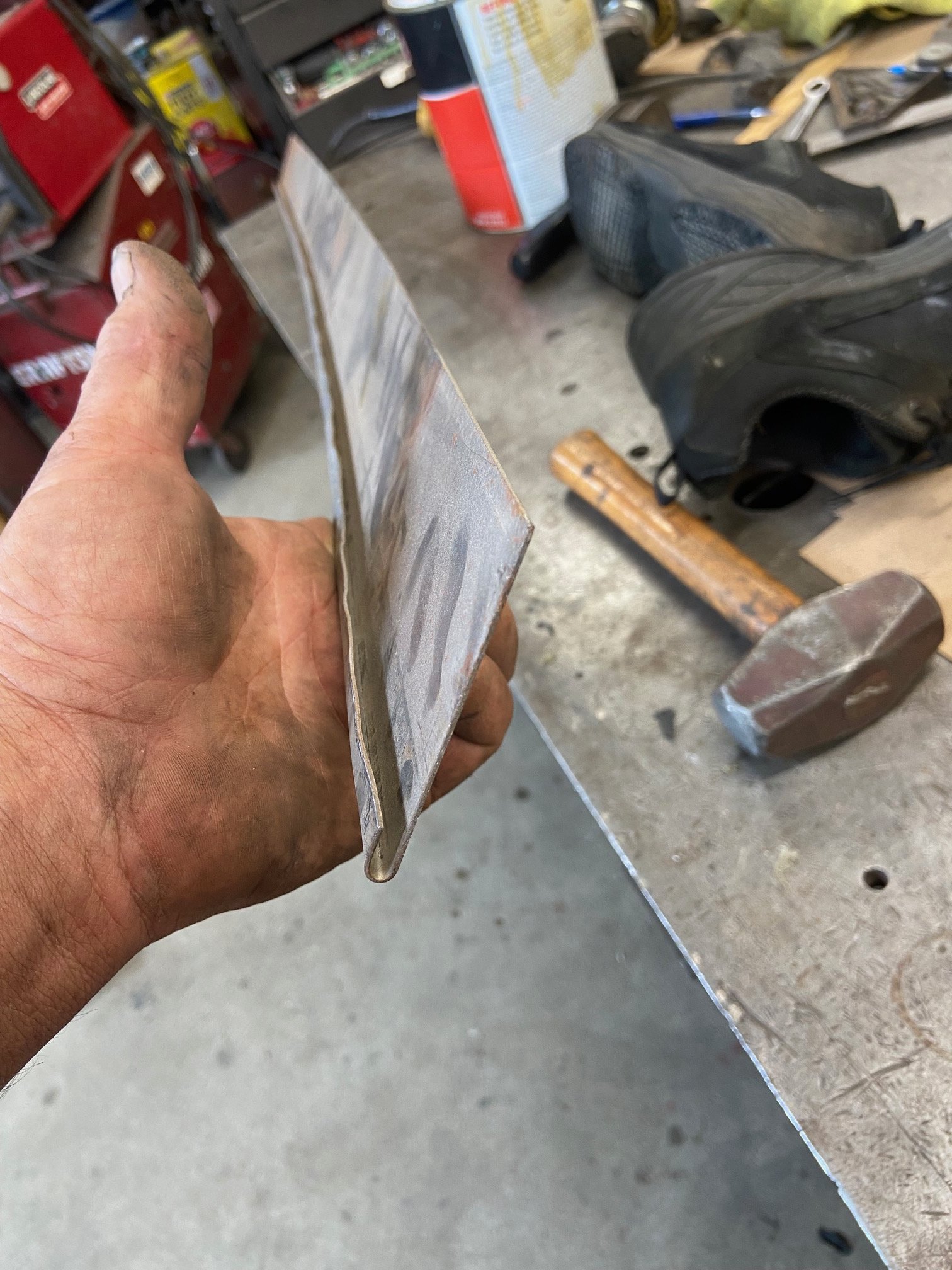

    I also made a set of rain gutters. I had made a stencil of the shape of the door and used it as a guide. I folded the outer side over, then bent the return, used the shrinker and stretcher to shape it to the door stencil, the folded the flange straight across that will get welded along the roof over the door image0.jpeg image1.jpeg image2.jpeg

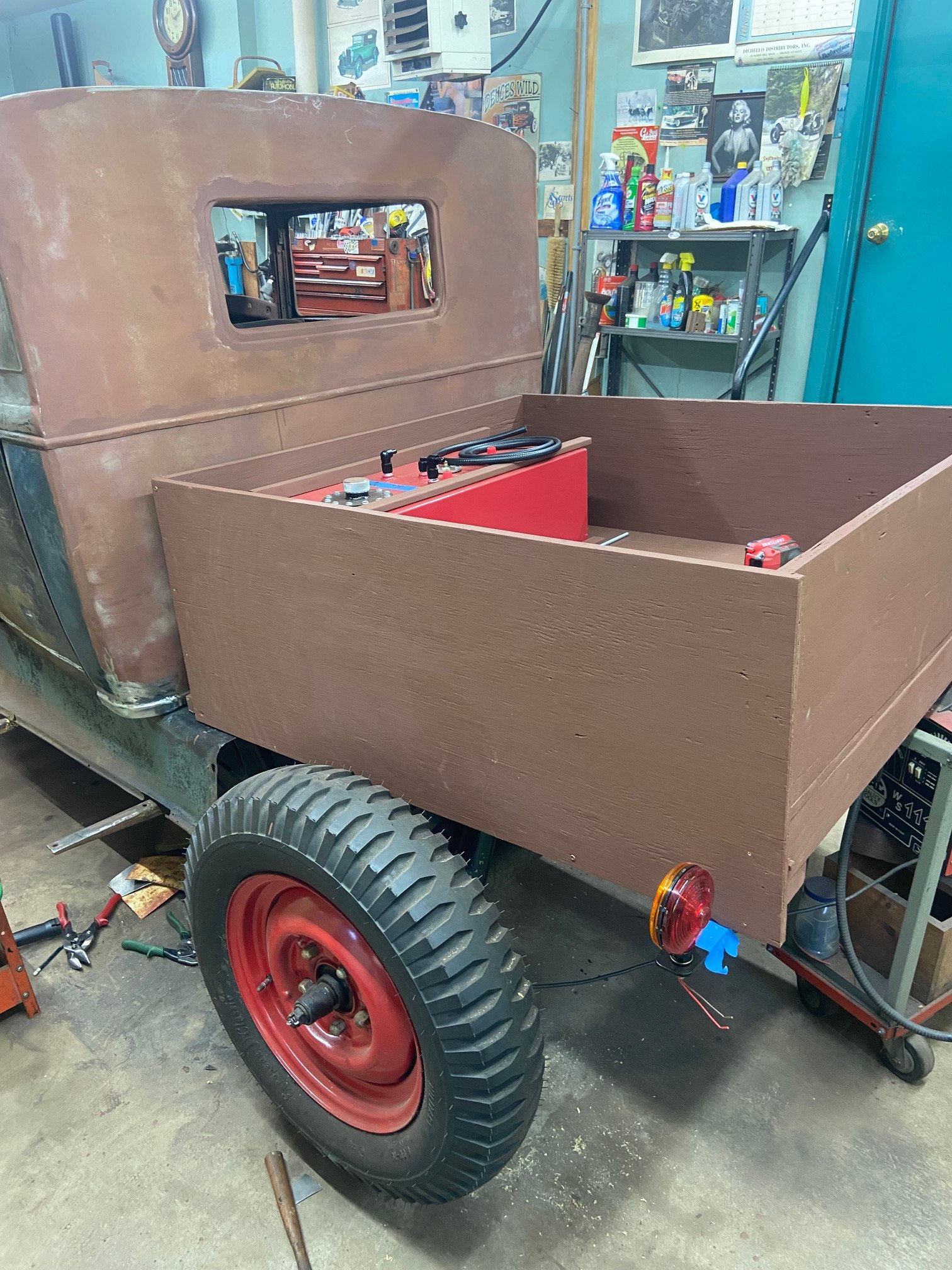

  7. I am withholding judgement on the box.

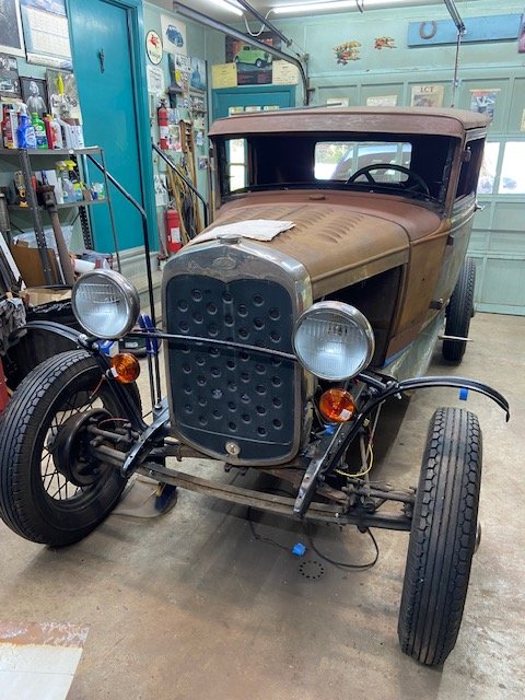

    Charlie has been busy, I stopped by today to check out his progress. he got the head light bar and lights mocked up and wired them to the original A switch. image0.jpeg
    tires and rims really changed the look

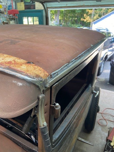

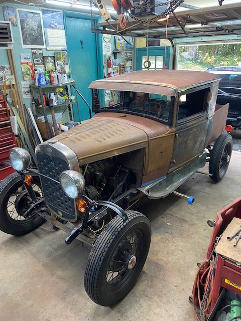

    I started by welding in some visor extensions to fill the gap in the roof. image1.jpeg
    Stogy, winduptoy, ct1932ford and 9 others like this.

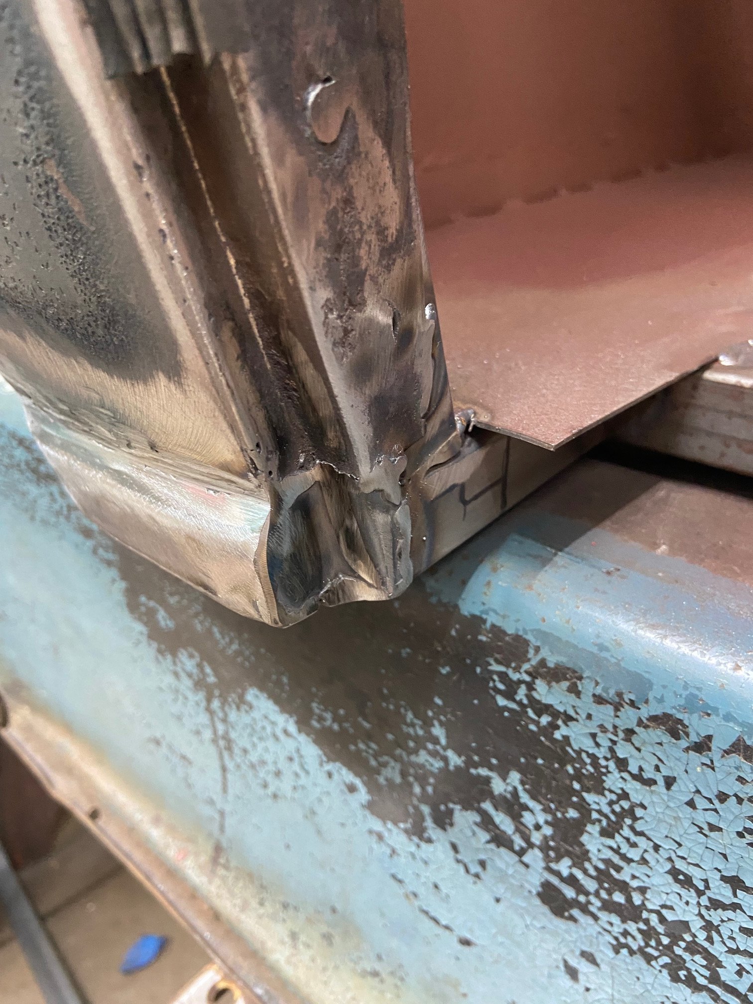

    I also welded on the rain gutters I made .

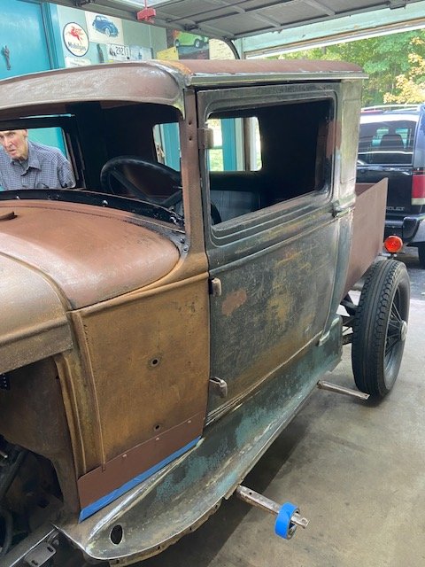

    Charlie painted the windshield frame and glued the gasket on so we installed it. image3.jpeg

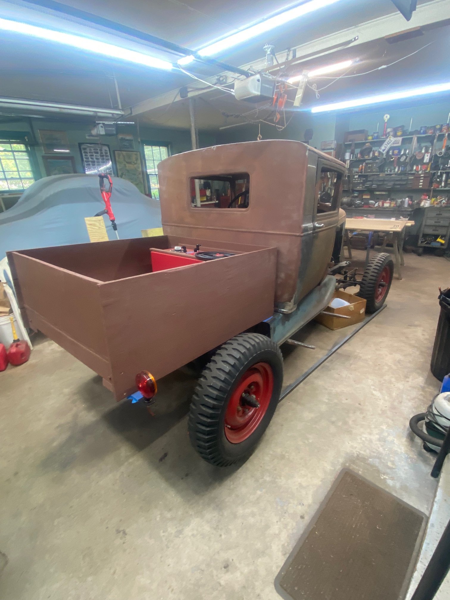

    I like the new tires and rims but I liked the vibe of Charlie using "what he had" . Charlie is going to sell them and use the cash for parts he can use.

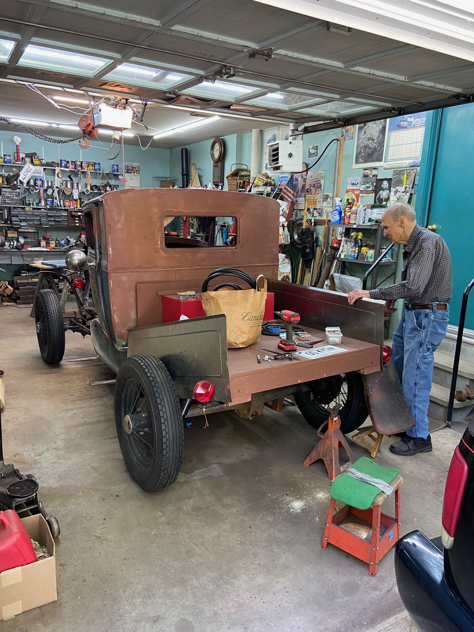

    bent up some bed sides per the slackers drawing. plan to get over there Friday.

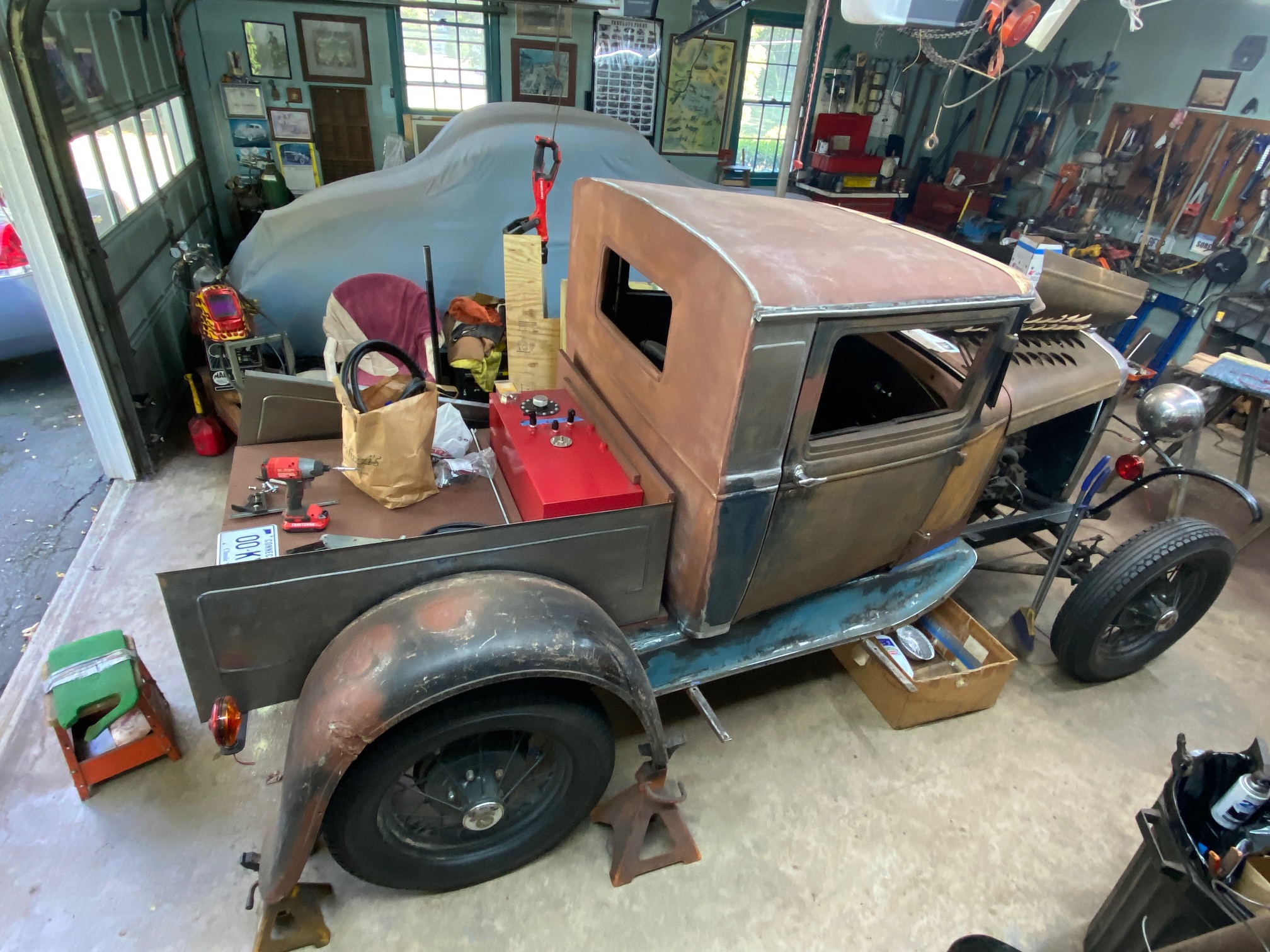

  19. tb33anda3rd
    Joined: Oct 8, 2010
    Posts: 17,595
    tb33anda3rd
    then we decided to add some stake pockets, so we cut some square tube to size. image2.jpeg also will add another piece to extend the angle and weld a length of tube to the edge to finish it off.

  22. Grumpy ole A
    Joined: Jun 22, 2023
    Posts: 433
    Grumpy ole A
    It’s looking better every time you show us pictures of y’all’s progress.

  24. tb33anda3rd

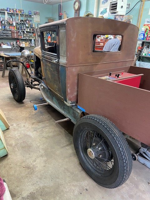

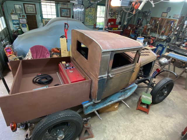

  25. Now I feel I can judge the box - vast improvement. Keep up the great progress.
    Outback, Stogy, cactus1 and 1 other person like this.
  26. tb33anda3rd
    Joined: Oct 8, 2010
    Posts: 17,595
    tb33anda3rd
    I read all the responses and "likes" to Charlie, he really enjoys fact that other people are enjoying the build. your "holding judgement" made him reflect on how the bed was coming out, he found the metal from a previous build and decided to change the bed.
    FYI I agreed with the change, we would have found a way to make it look fine, but the metal is a better direction.

  27. Hot rodding the original design- build concept. Try something, change it if it doesn’t suit. You all have a good sense of proportion.
