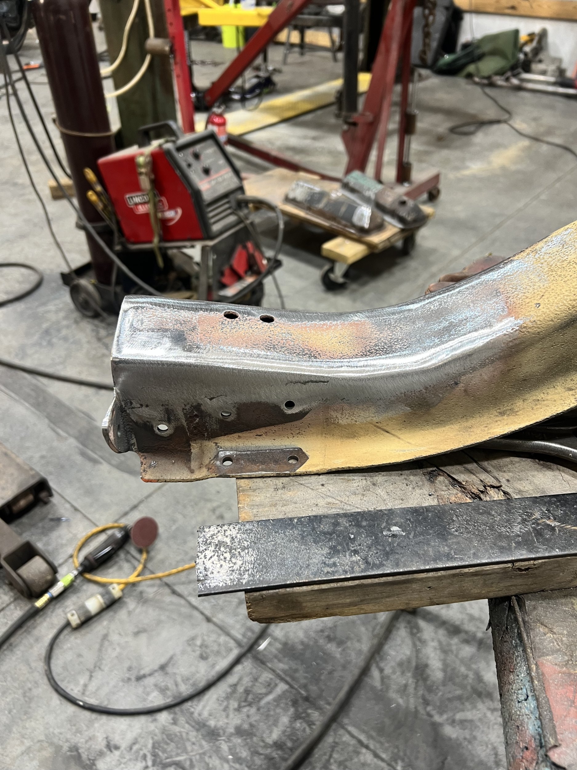

    Working on getting this old quick change in the car. I thought I could keep the stock 32 crossmember and spring ,but not any clearance . So I’m gonna pull the body and swap to model A stuff. IMG_6298.jpeg IMG_6301.jpeg IMG_6302.jpeg IMG_6303.jpeg IMG_6311.jpeg IMG_6308.jpeg View attachment 6334847 View attachment 6334848 IMG_6298.jpeg IMG_6301.jpeg IMG_6302.jpeg

    Put your spring in the front and it will work fine.
  4. Brian Berger
    Joined: Feb 2, 2024
    Posts: 65
    Brian Berger
    Spring in front of axle? Not behind? That would make the rear axle back way too far. Wheels would be off a mile on the body,it’s already back a bit IMG_6135.jpeg

    Also the rear frame has been pie cut at one time as it was close to the crossmember with the stock 32 banjo

    What you need is a model A cross member and a model A spring.
  7. Brian Berger
    Joined: Feb 2, 2024
    Posts: 65
    Brian Berger
    I have one it’s in the pic. I thought it would work without it. This my first 30’s car.

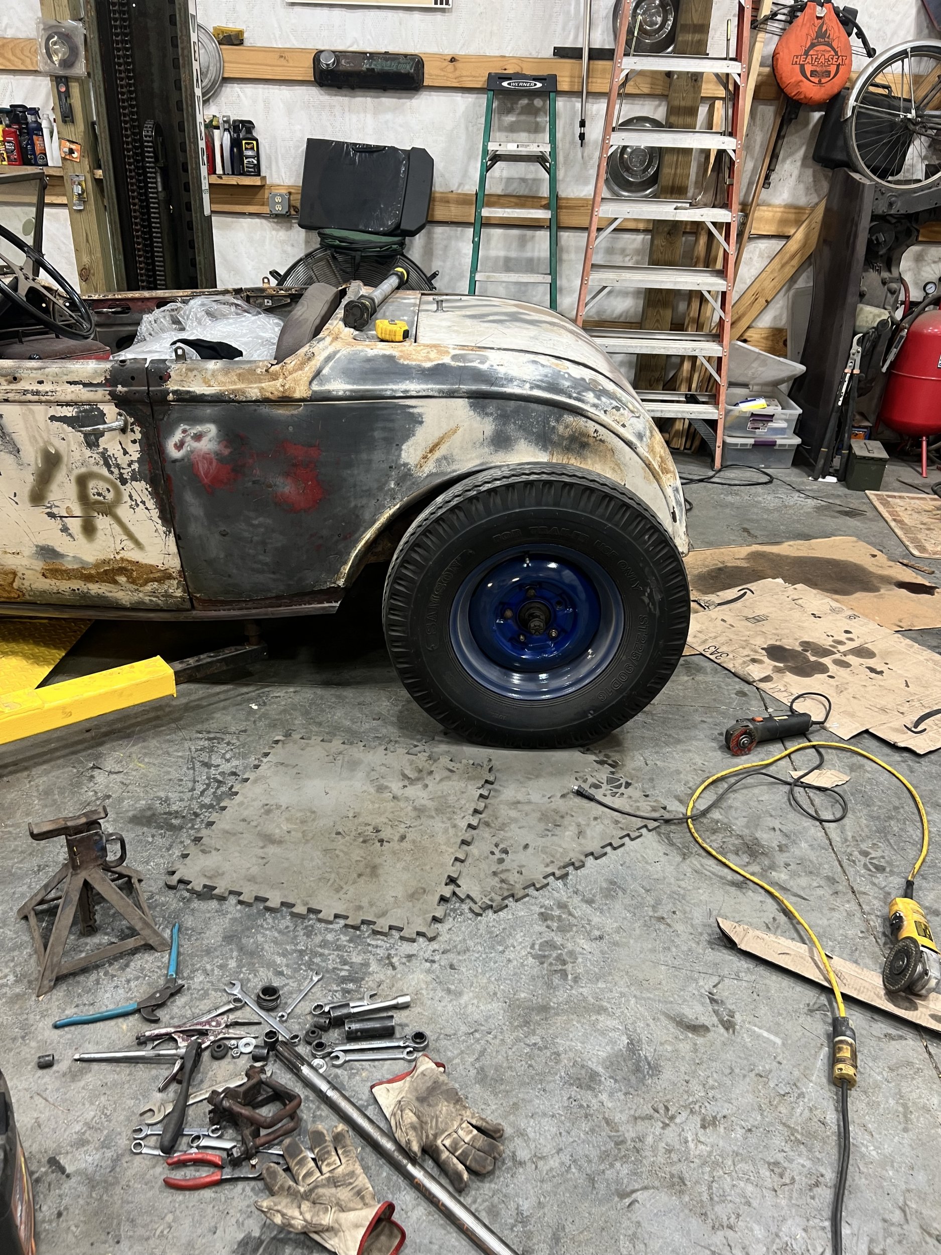

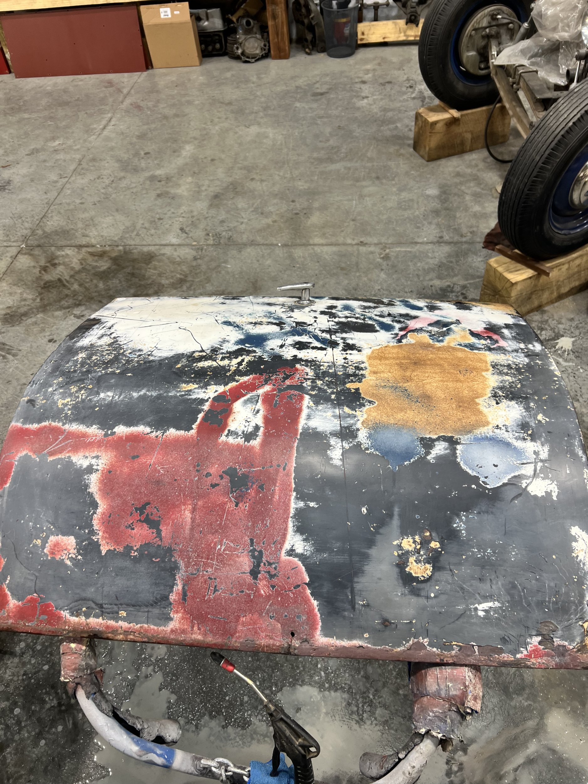

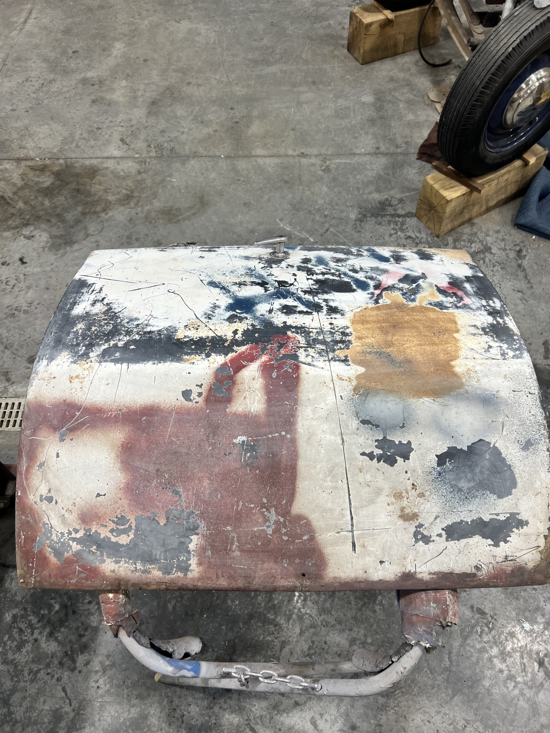

    IMG_6347.jpeg Getting ready to pull the body I took the trunk off and washed it with an SOS pad. I’ve never hit it with water yet. Not really sure it’s been washed in a very long time. I think some of this white paint is house paint. Lol. It comes off easy. I’m trying to be gentle. The body is pretty rough on this old thing and has been all torch welded together so I have no plans to restore it. Just continue to improve I hope! IMG_6348.jpeg

    I like the "As Found" look, the world has plenty of shiny finished '32's.

    Been a lot of work to swap this rear axle to the quick change. Split the body and frame today so I can swap the rear crossmemeber. It will be worth all the effort ! IMG_6358.jpeg IMG_6361.jpeg IMG_6359.jpeg IMG_6365.jpeg IMG_6366.jpeg IMG_6367.jpeg

    Tack lots of cross braces on the frame so it doesn’t get crooked and warped when you remove the 32 crossmember.

    Got the Model A crossmember mod done and got the old quick change in. IMG_6532.jpeg IMG_6531.jpeg IMG_6535.jpeg IMG_6544.jpeg IMG_6546.jpeg IMG_6545.jpeg IMG_6547.jpeg IMG_6548.jpeg

    The white isn't 'paint' as we know it, It's called White Wash, Which back in the day was common, It was the byproduct of Acetylene generators, People had them in there basement, An plumbed through house for lighting etc.
    Colt, as in the gun company made them also..

    The stuff came off with just water. Lol. I gave it an SOS bath. I think it turned out killer IMG_6396.jpeg IMG_6397.jpeg IMG_6398.jpeg IMG_6402.jpeg IMG_6401.jpeg IMG_6403.jpeg
