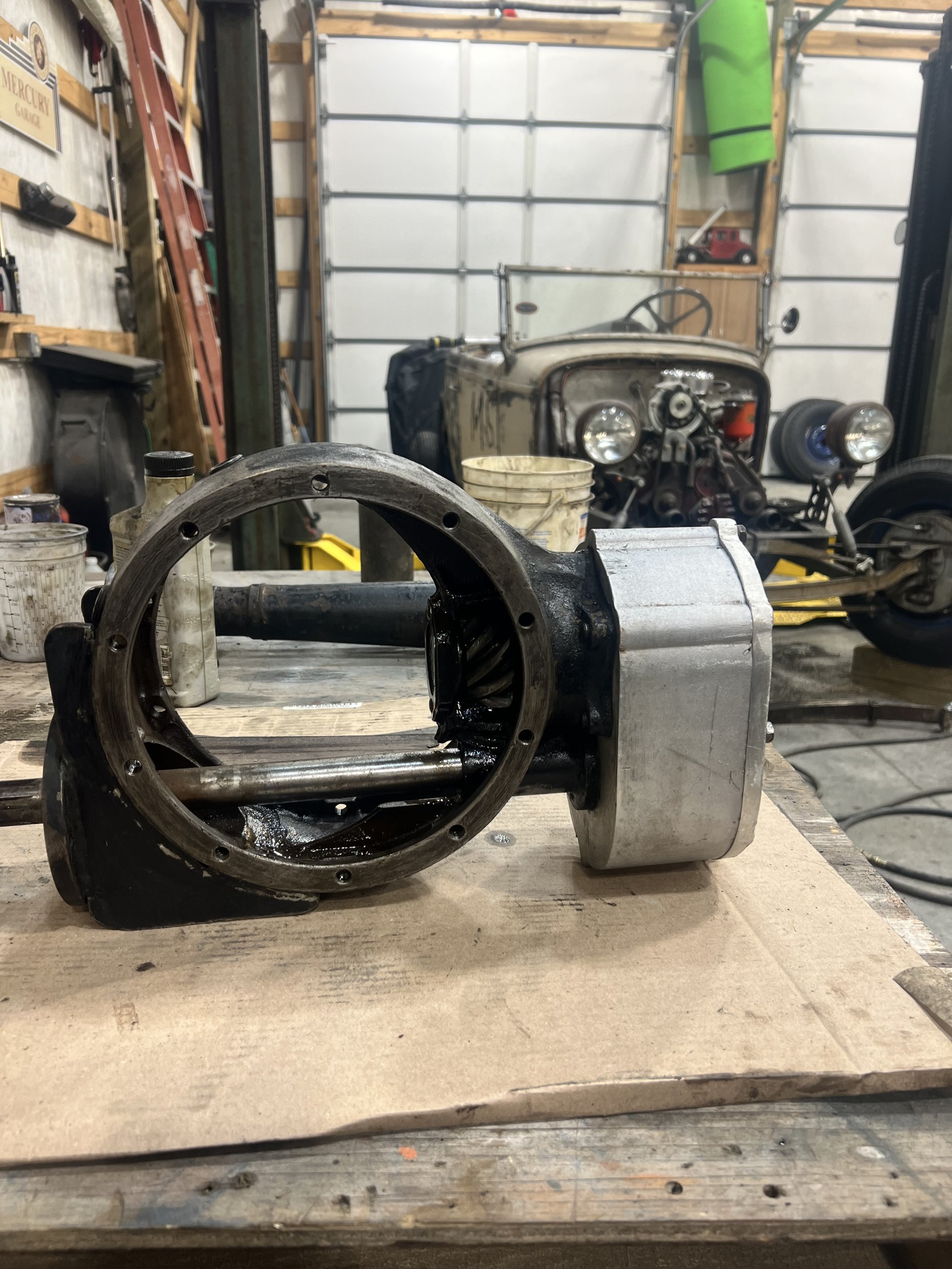

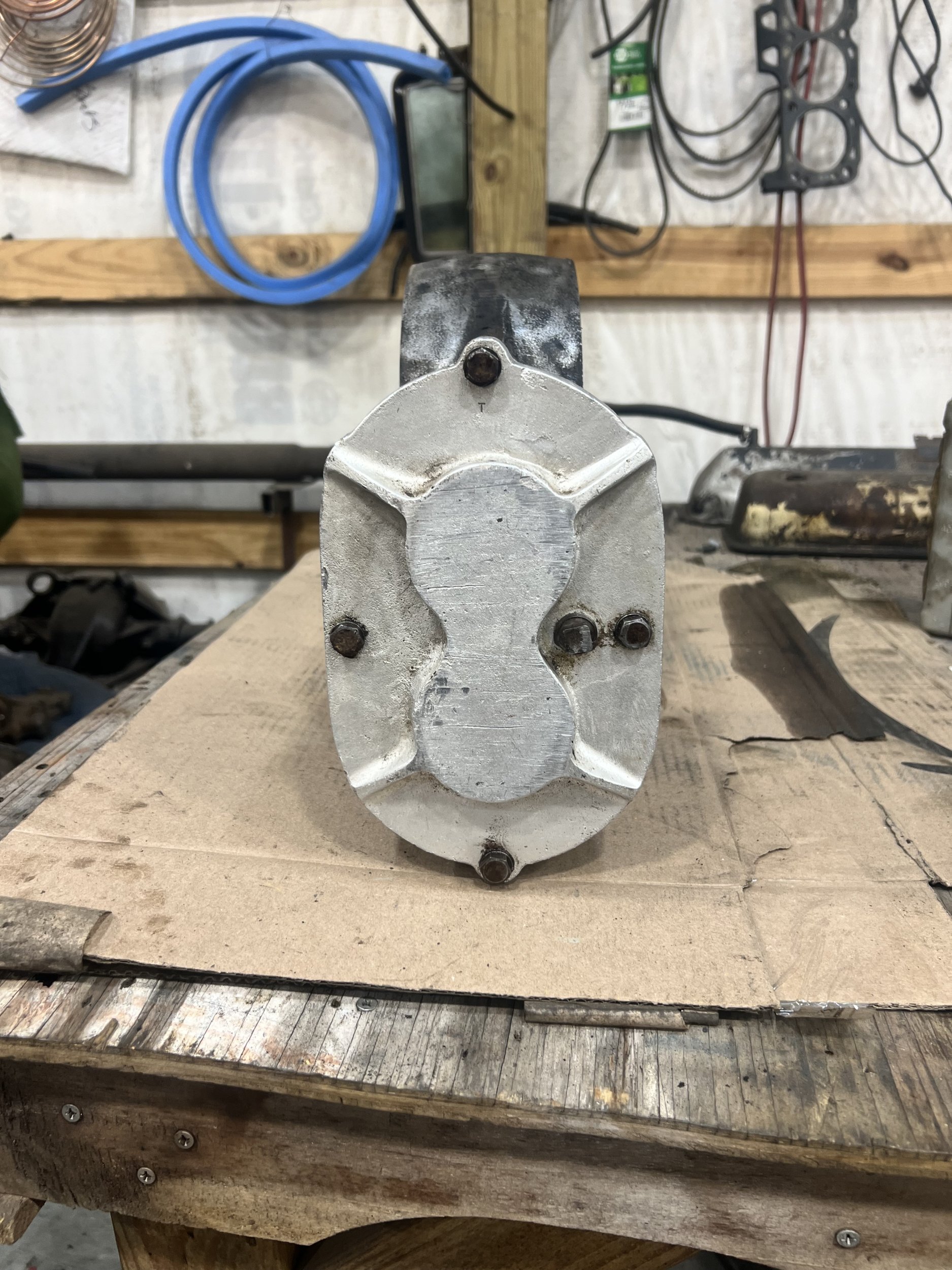

    Got the wishbones shortened. Now to finish the torque tube and driveshaft, then will be 34 radius rods kn the front and fix the steering issues. IMG_6560.jpeg IMG_6562.jpeg IMG_6564.jpeg IMG_6563.jpeg

  4. Hopefully you plan on using a lot stronger material to align the TT pieces that what I see in the mockup. I would be using some 1/4" thick angle iron to keep things as rigid and aligned as possible. I would tack around the whole cir***ference and probably weld 1" beads - alternating back and forth from one side to the other. Welding loves to warp things - everything you can do to reduce the warping is a good thing!

    I have several stock torque tubes in different lengths. Would cutting a stock one at the rear flange, then removing the section to make it the correct length and rewelding the rear flange be stronger and less welding?
    tb33anda3rd and Grumpy ole A like this.
  6. Hell of a lot easier job that trying to graft a section in the middle and hope that you can somehow align the two ends. Given how a TT pivots in the front, my biggest concern is for the front roller bearing race area to be in correct alignment and centered with the driveshaft that runs inside of that roller bearing - the rest (generally - other than length, orientation of radius rod mounts, etc) isn't as much of a concern (it can be a bit off).
    Another situation is when using a solid style driveshaft (later era rears) - ones that use a bearing in the middle of the driveshaft - that makes all the alignment issues all the more difficult. You don't want the alignment between the front, bearing, middle bearing and pinion mount such that it is attempting to "bend" the driveshaft due to things not being well aligned.

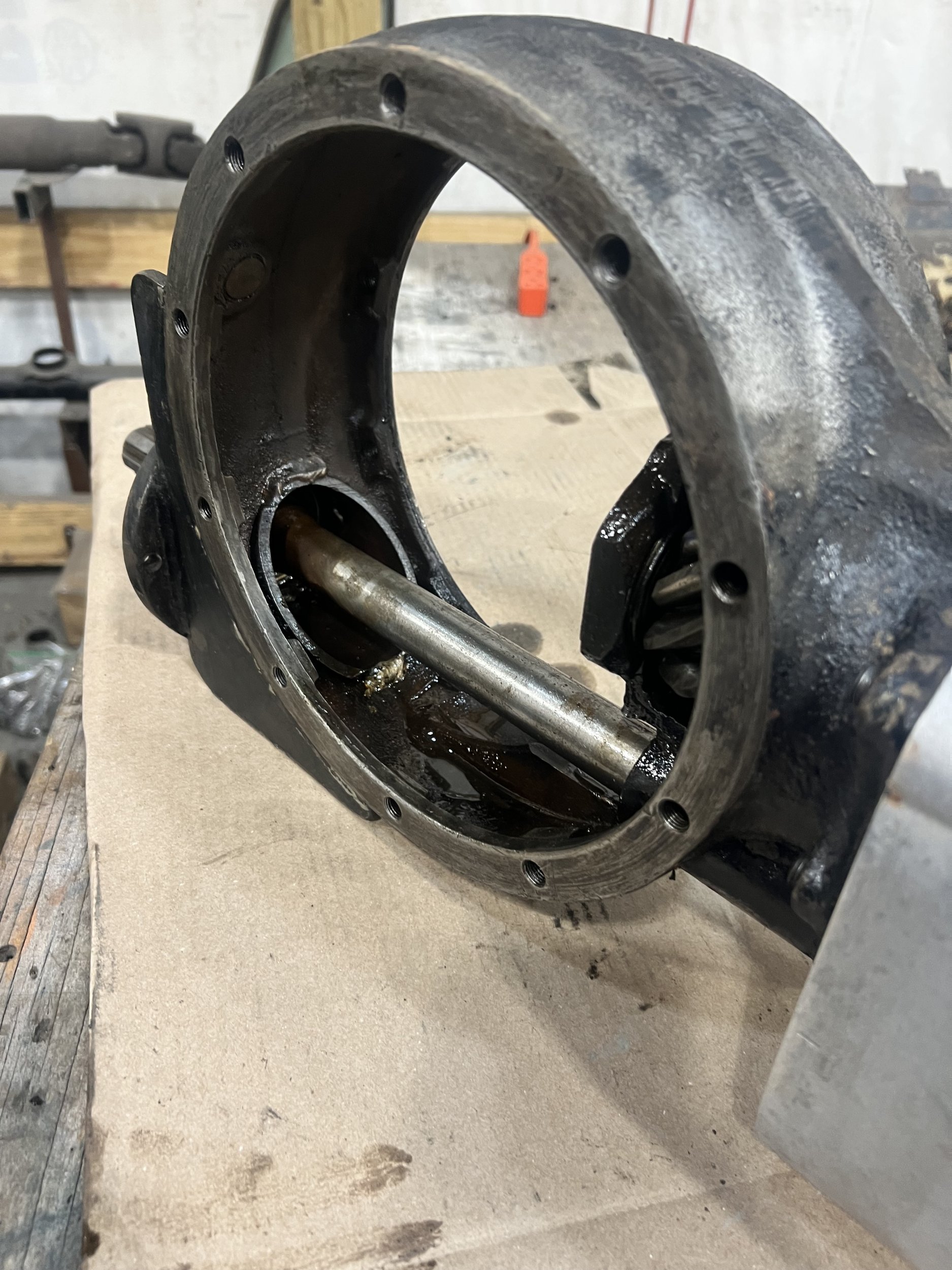

    Well all the work is done just needs cleaned up. I ended up using a different torque tube to keep the rear bearing,it was shortened at the rear. Got drive shaft cut and machined and all the other stuff done. I learned IMG_6646.jpeg IMG_6644.jpeg IMG_6649.jpeg IMG_6645.jpeg IMG_6647.jpeg IMG_6648.jpeg a lot about banjo rears on this project.

    All the measurements worked out perfect and it fit great. I used some 3/8 angle when I welded the actual tube I ended up using.

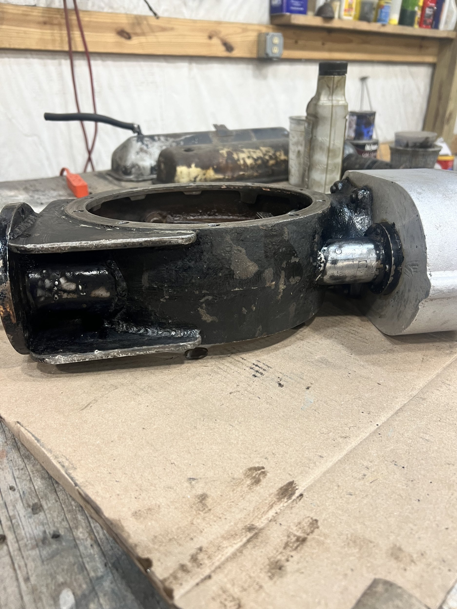

    Looking good but I have a question about the drain plug on top.

    When they built the quick change back in the day they flipped the housing ‍,I can drain out the rear of quick change. I know I should have drilled a new drain plug and I might still .
